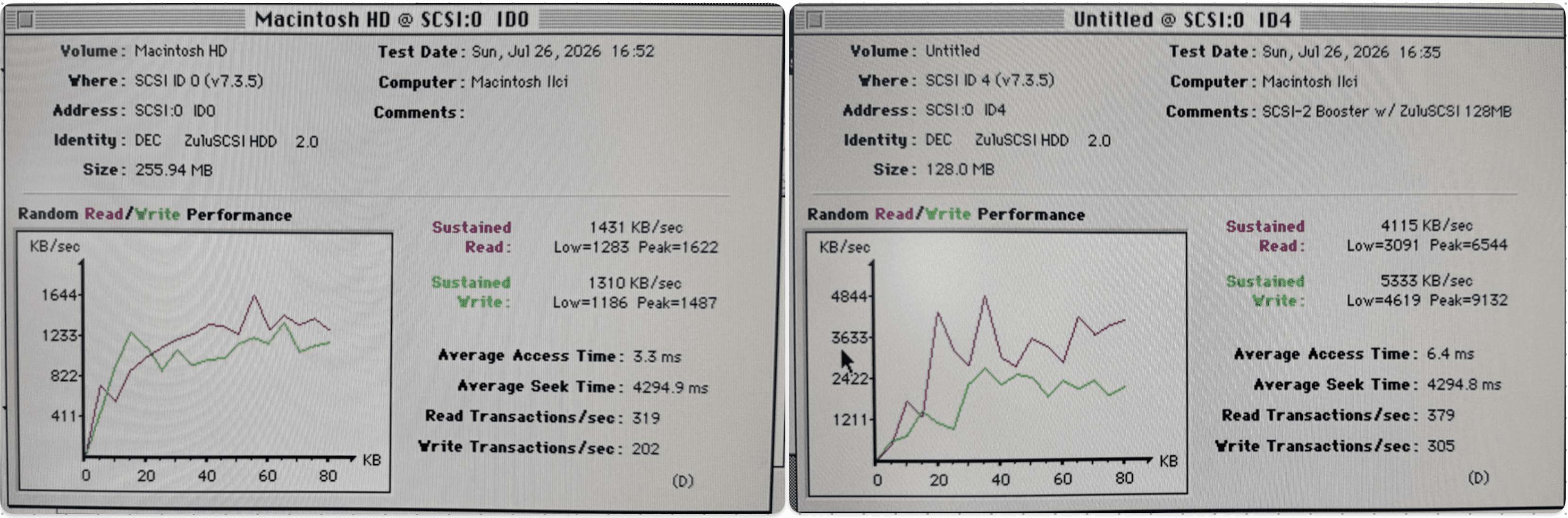

A speed test of one of those SCSI-2 Boosters would be nice.
Probably use a RAM disk on the Rocket itself, but across NuBus would be nice too.

My hope was that the SCSI Booster would boost SCSI throughput, but based on the most recent replies, it would appear those hopes may have been dashed. Quite unfortunate.
Well, at least I can say I am beta-testing the SCSI Booster. I've not seen comments from any other ASIC Rocket owner who also owns the Booster clone, so I guess I am the only one out there. (Or only one who has tested his Booster and/or cares to share knowledge.) But that's OK. I've beta-tested hardware and software for years. If the feedback I provide can make products better or otherwise inform would-be buyers, then that's mission accomplished in my eyes.

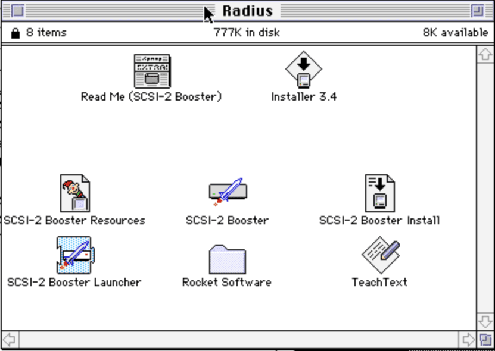

Good news. I was able to contact Petar Puskarich several months ago and confirmed he had the manual and software. Things fell by the wayside, and I only recently revisited that conversation with him. He very kindly took action and uploaded the SCSI Booster Driver to Macintosh Garden as DL#9 here:
Content of DL#9 looks like this...
I've not tested it yet because I have my monitors at the office and my IIci here at home.
The Read Me you see above contains the following info (which says nothing about it NOT being able to boot while in RocketWare (accelerator) mode (implying that it just might be bootable)...

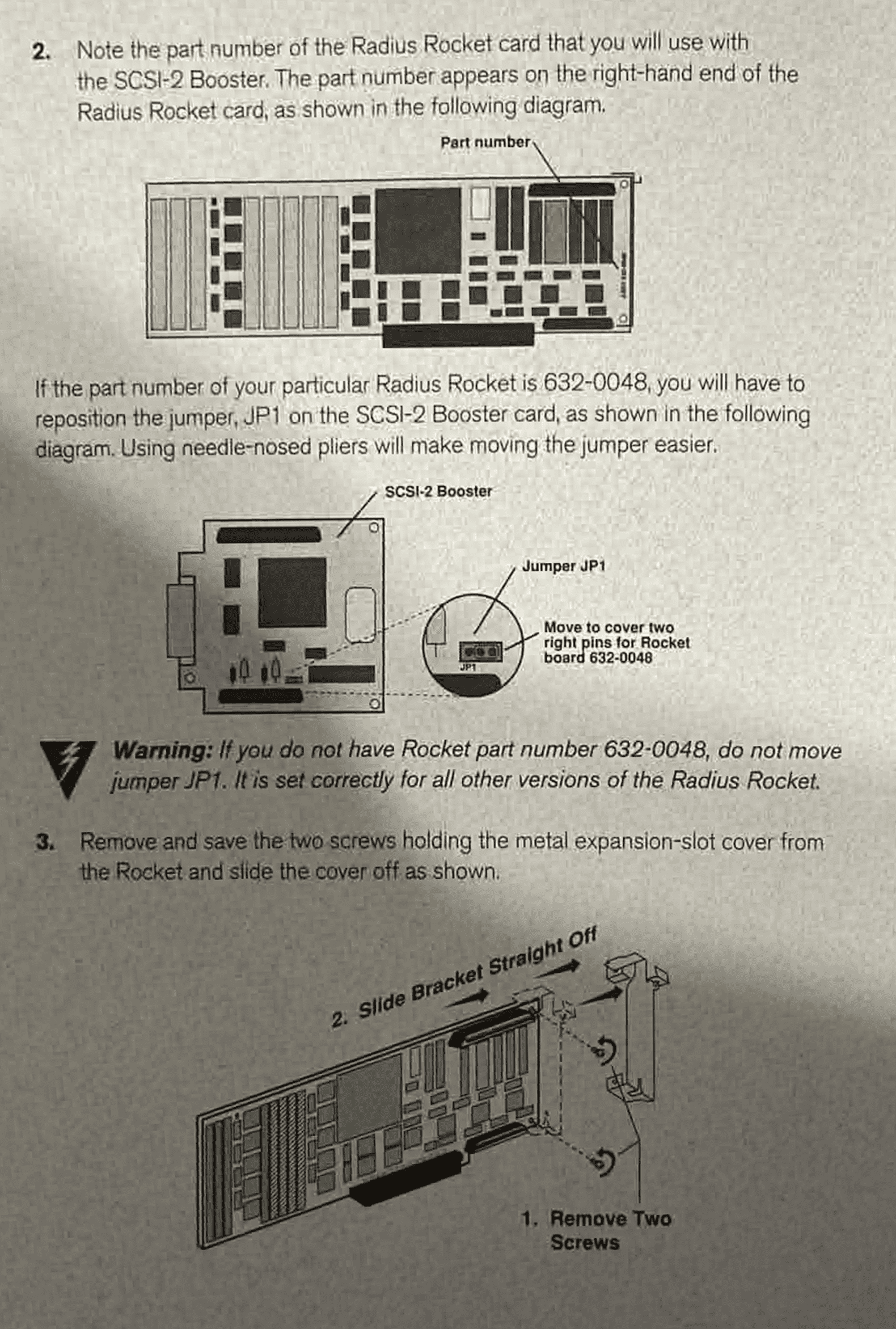

SETTING THE JUMPER
As specified in the QuickStart card and elsewhere, if you are using Rocket part number 632-0048, you must reset the JP1 jumper on the SCSI-2 Booster board (see diagram in the QuickStart card for details). If you do not reset this jumper, and you are using the 632-0048 Rocket, the SCSI-2 Booster will not function with RocketWare or RocketShare.

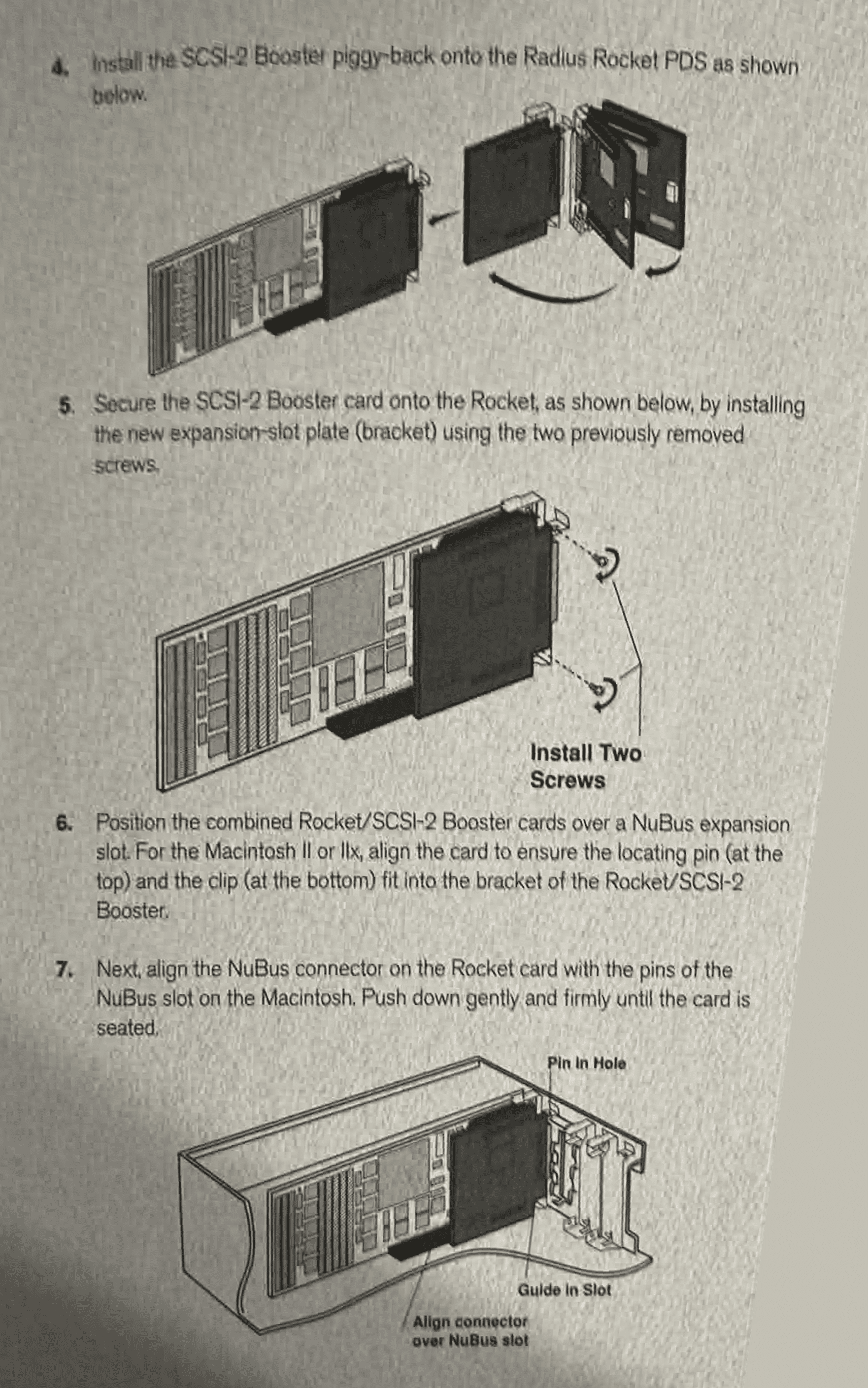

Photos of product box and manuals provided to me by Petar. He said he will try to make good scans of the manual (rather than the quick photos below), but I don't know when that will happen, so I've provided these for now.

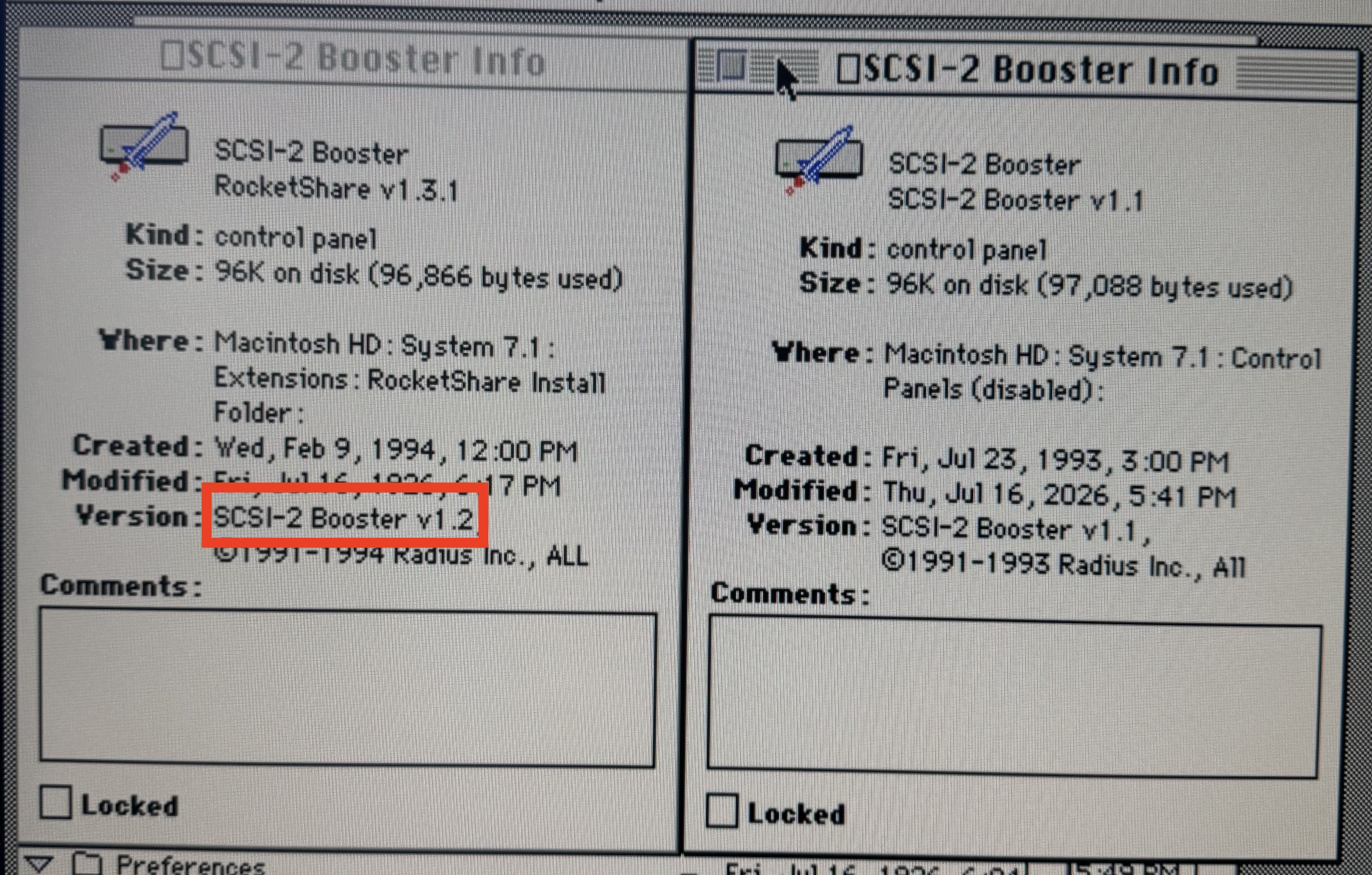

FWIW, deep in the RocketShare v1.3.1 Installation Package there is even a v1.2 of the SCSI-2 Booster Control Panel. It is several months younger than v1.1, but there is no README file providing any details for it.
It is meant to be installed in the Rocket Disk and I am not sure if it will work on the host side. But maybe it is worth trying.

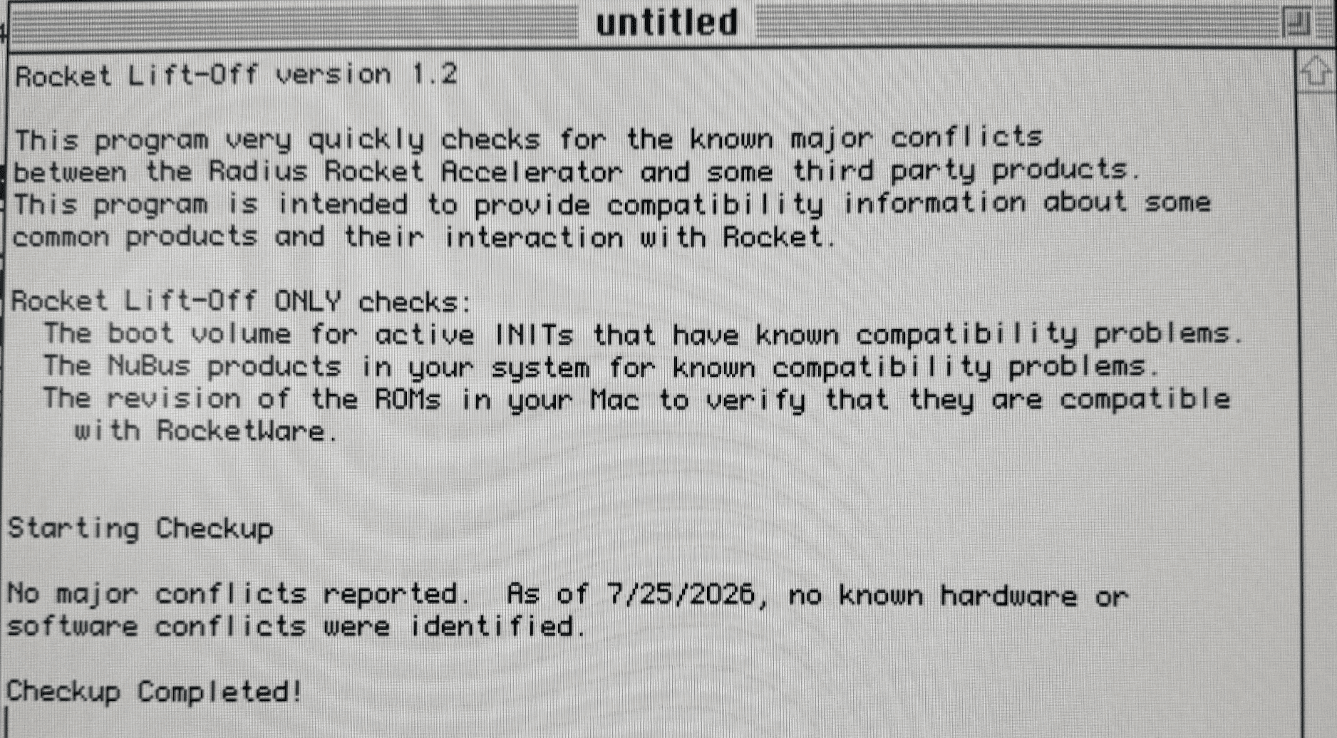

  • Before the Rocketware installation, I did run the Pre-Check named "Rocket Lift-Off"

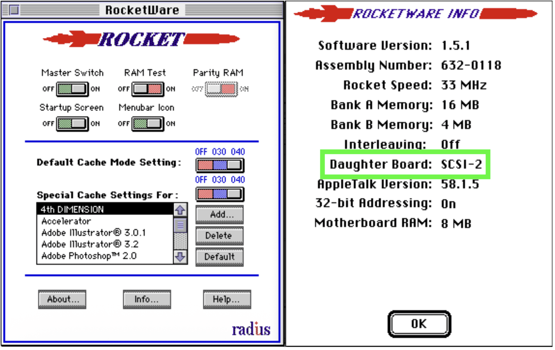

  • Rocketware v1.5 "Easy Install" plus v1.5.1 patch does provide:
    • Extensions: Rocket Launcher v1.3, Rocket Cargo v1.0F
    • Control Panels: Rocketware v1.5.1, QuickCAD v2.2, QuickColor v2.5
  • Rocketware Control Panel does confirm the Booster installed ...

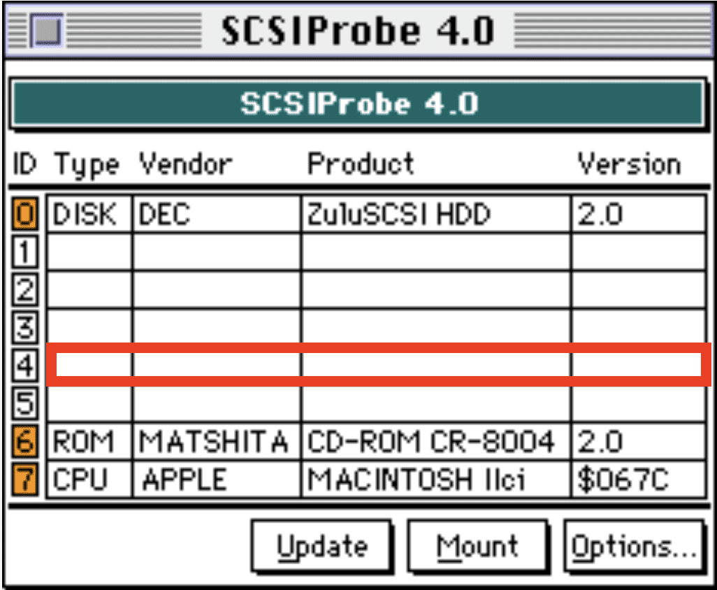

  • But the System does not see the HDD attached to the Booster:

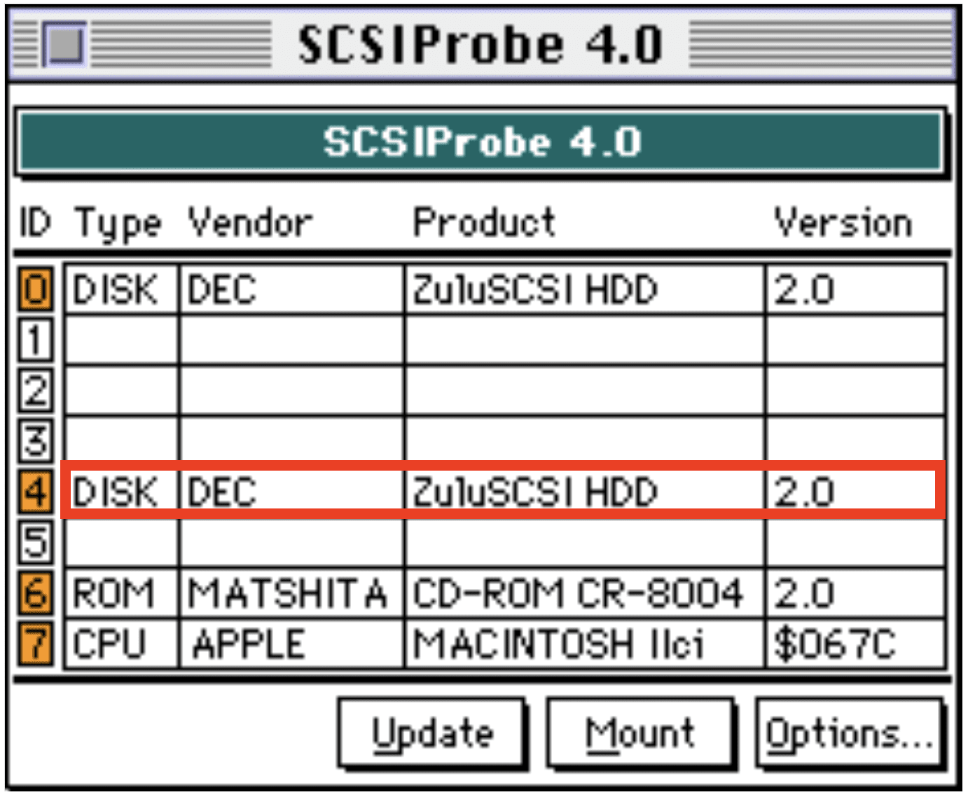

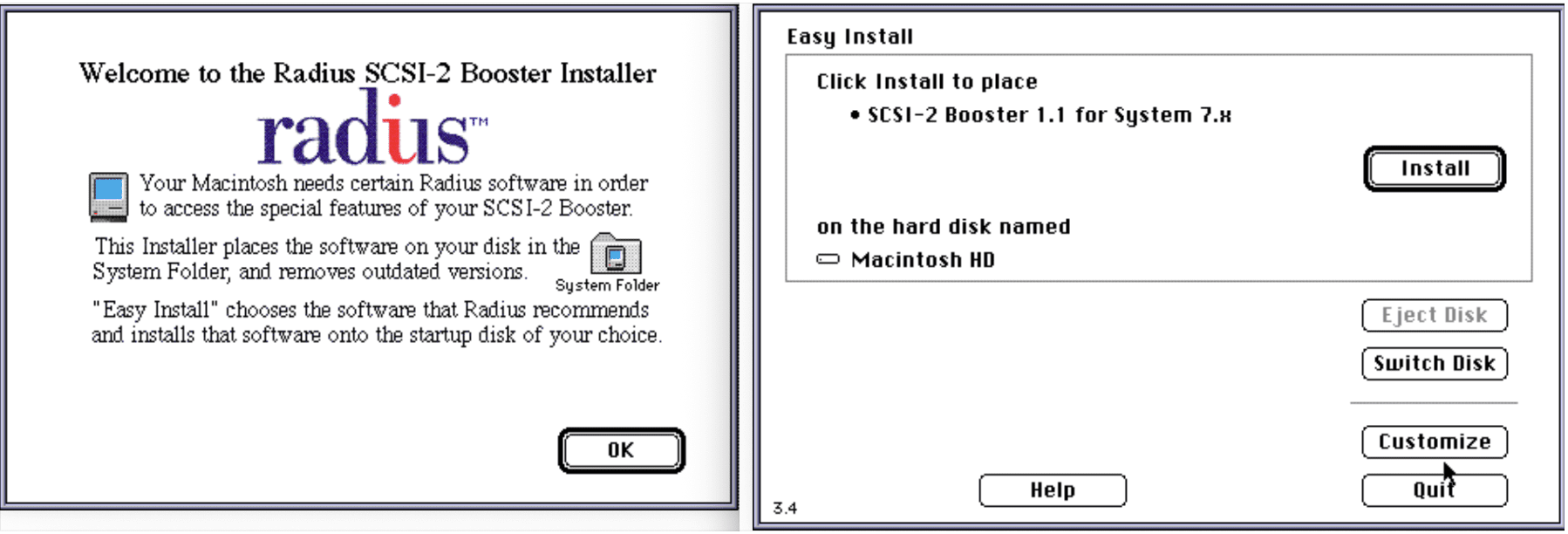

  • Next: SCSI-2 Booster Software Easy Install
  • We get
    • Extensions: SCSI-2 Booster Launcher v1.1
    • Control Panels: SCSI-2 Booster v1.1
  • Now the System does see the HDD attached to the Booster
  • Comparing the Disk Performance with FWB HDT v2.0.6 gives us:
Sustained Read Performance [KB/s]Sustained Write Performance [KB/s]
Mainboard SCSI14311310
SCSI-2 Booster41155333
To sum up:
  • Yes, the SCSI-2 Booster does indeed boost the SCSI Performance, when compared to the Mainboard.
  • The Booster Software is necessary.
Next steps (note to myself):
  • Make sure HD4 has the same size as HD0. Redo measurements.
  • Right now, the Disks were formatted with Apple HD SC Setup v7.3.5. Do more tests with other Disk Drivers. Have a look at synchronous transfer settings and other Fast SCSI features.
  • Have a look at SCSI-2 Booster v1.2
