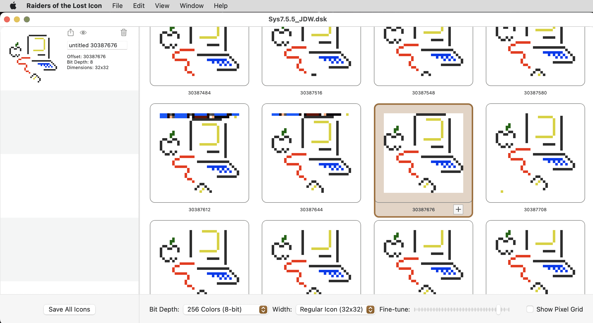

I'm especially having fun with Raiders of the Lost Icon. Here's a screenshot showing an icon extract I made...

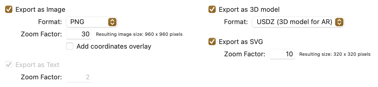

And the Export options are fabulous!
@OneGeekArmy is awesome!
One thing I did find though is that the *.usdz file exported (of the Picaso Mac above) was only 1,499 bytes, and when I double-clicked it, Xcode launched, but Xcode shows it to be blank...
I then went to an online USDZ file viewer, but it too showed the exported file as being blank.
There is also a *.txt file that was exported, but despite being 4,160 bytes, it too is blank.
The PNG & SVG exported just fine, however.
I've attached a ZIP archive of all the exported files.

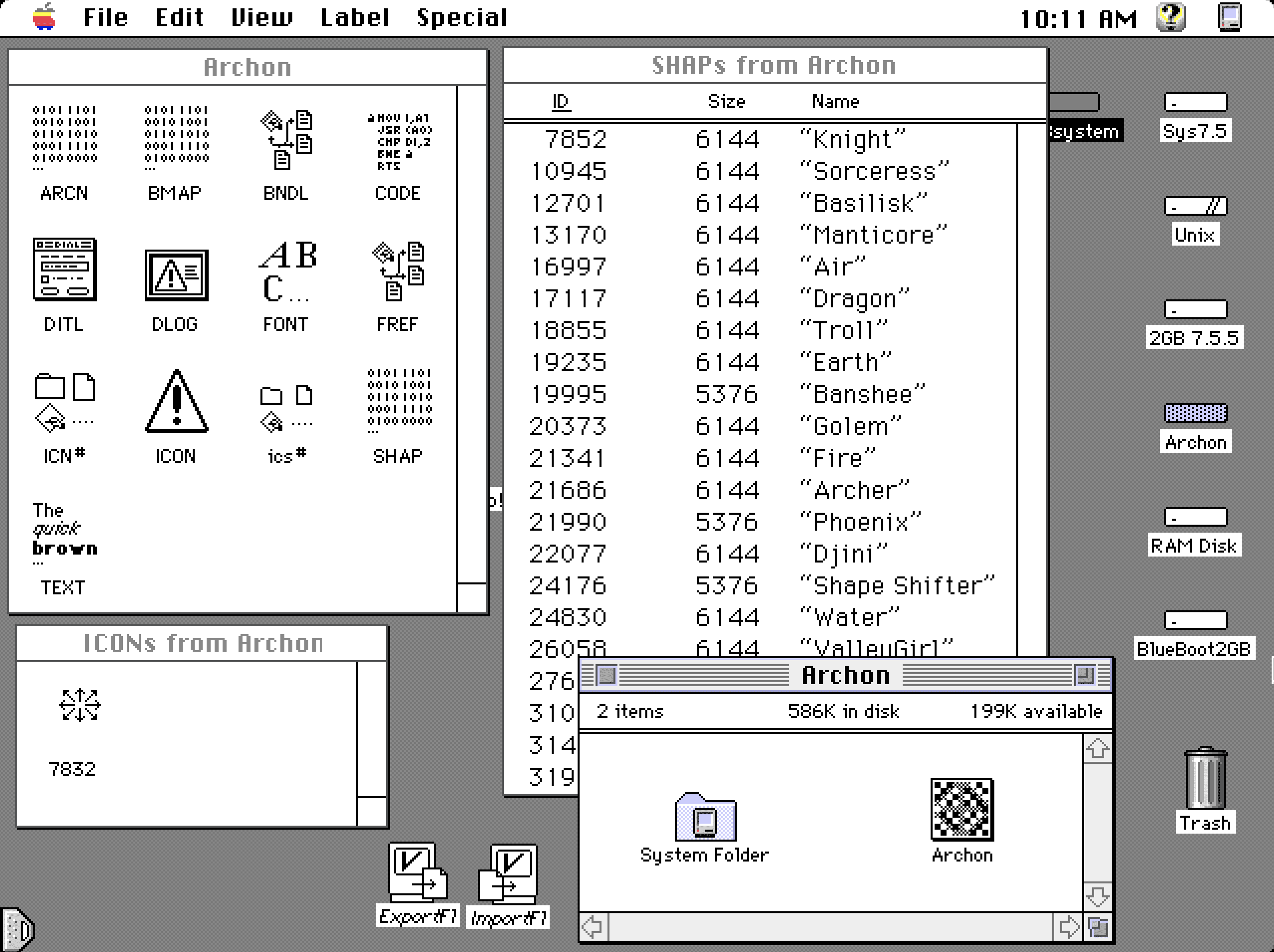

You can use Basilisk II to not only mount the disk image (DL#1 at the Garden), but also examine it via ResEdit, as shown here:
No graphics that I can see. The other resources are dialog boxes and code.

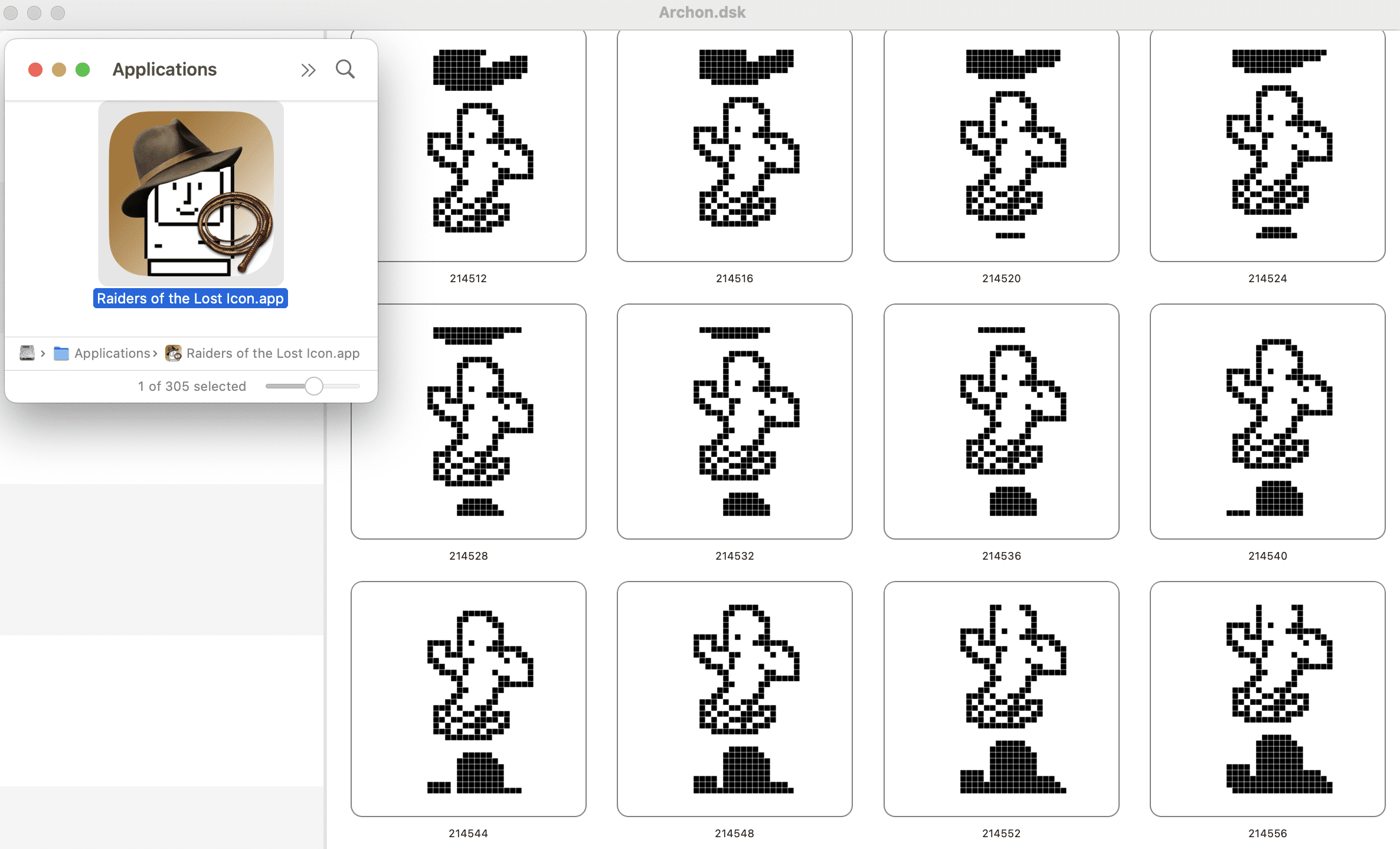

But I then used Raiders of the Lost Icon from @OneGeekArmy , left it in Black-and-White, and took a lot of time to scroll through, and look what it found...
So I suggest you download that app and give it a try. Works on modern Macs just fine.
