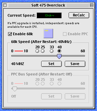

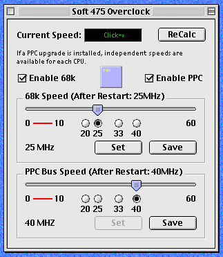

Anyone got some time to do a bit of testing?
You need a... P475, P476, LC475, LC575, P575, P577 or a Q605 :)
Awesome if you have a PowerPC upgrade.
Latest version :
Edit - actually, now like this, because I realised the sliders were sort of pointing the wrong way. Also I used a top secret trick to make the PPC bit enable for the screenshot :
Latest version :
Where can I download this version?

It isn't publicly available yet, I've been struggling to get testers to finalise it.
