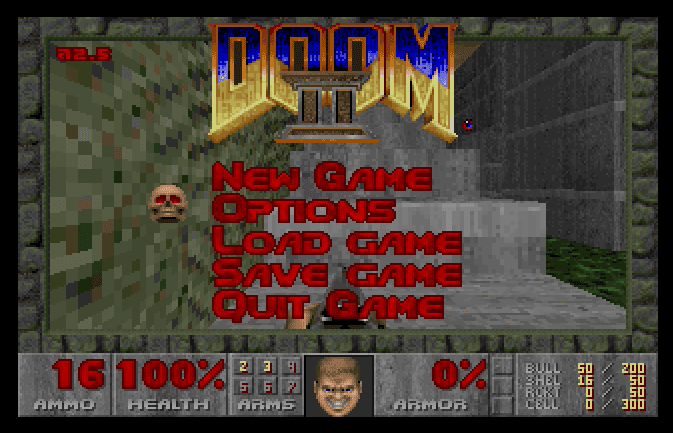

@JDW I'm also curious about getting an FPS display in Doom. Let us know if you figure it out.
All I think I remember is that in whatever version it does work, I believe you have to not have the viewport at full screen otherwise it covers the FPS?
There has to be a counter somewhere because it is in some people's videos isn't it? Or do I have false memories? Am I a Nexus 6?

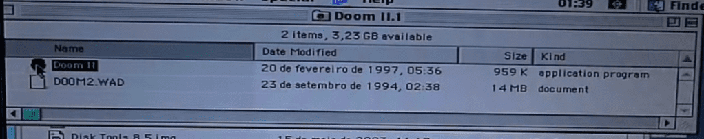

DOOM II showing an FPS on an LC 475 - note how it isn't full screen quite :
Edit - Interesting, this one shows it while at full screen :
So it must just be a specific version of DooM II... this is what they launched, so not much to go on (sizes are dependent on block size and so hard disk size). Date Modified might be the biggest clue.

I've heard other people tell me they can see the FPS like that, but I've never been able to figure out how different their version was from mine, especially since we both downloaded from Macintosh Garden. It's really strange. And yes, I've tried all the various screen sizes too.
phipli
383
259
I think I've found the version :
Ignore the crazy high FPS - I was testing on QEMU (Quadra 800 emulated) on a "modern" laptop.
The file was a bare sit archive, so I've wrapped it in a hqx to make it a bit more internet proof (sit files get corrupted if you send them over FTP sometimes, especially with Fetch, as well as some other things) and renamed it to make it obvious that it is the alpha version with an FPS counter. Please find attached.
And yes, if you're wondering I did download every single version of DOOM II and DOOM on Mac Garden, getting my IP banned in the process, because apparently you're not meant to download every file on two pages that quickly. Thankfully the mirror still works.
To be fair, we could have all saved ourselves some time, myself included, if we'd actually read the Macintosh Garden page - note DL #3 :
Note that it says the alpha is slower than the release game, so as a benchmark this is scoring FPS in the Doom II alpha, not Doom II.
