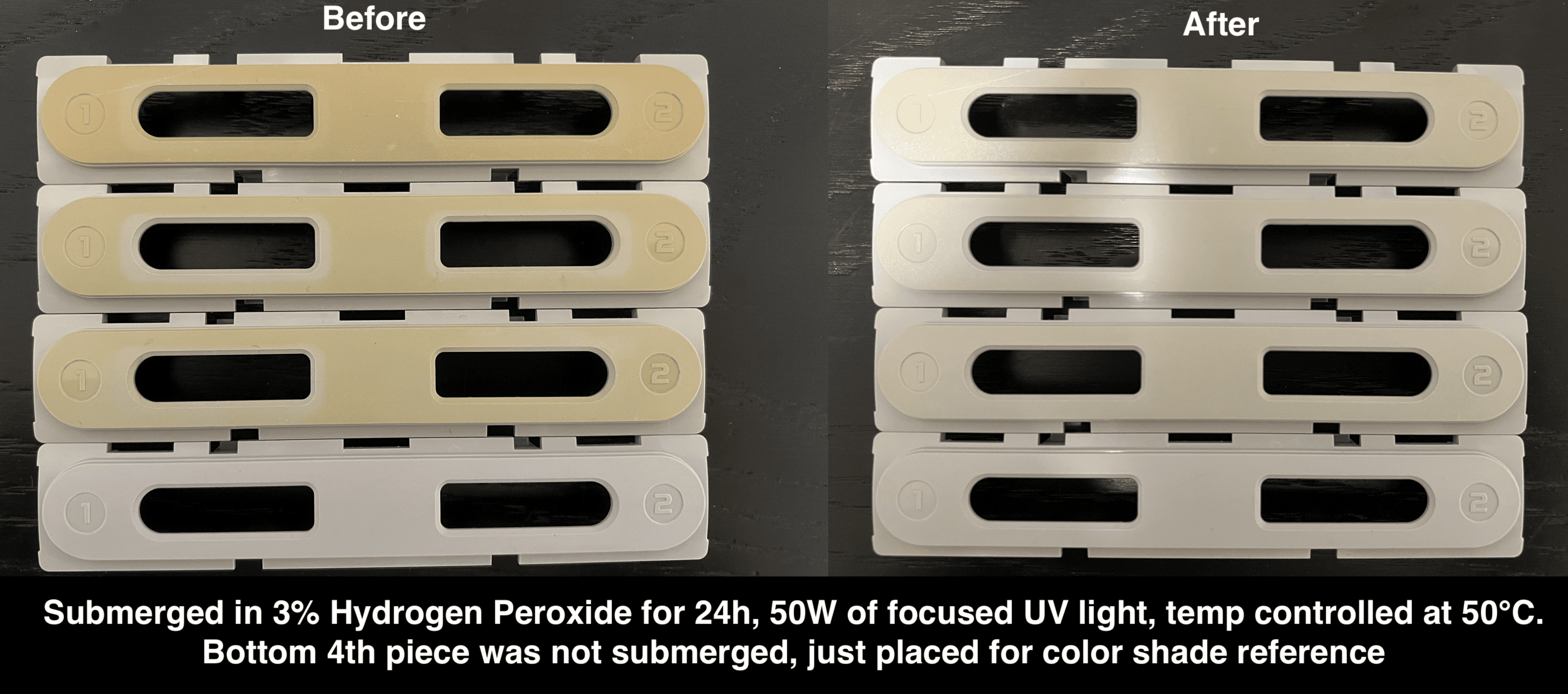

I've did a lot of indoor testing with UV light and heated hydrogen peroxide. I was hoping I could create a setup in the home which would get very reliable results. At the end of the day, I didn't find anything worthwhile. UV just doesn't have the abundant power of the real sun. I would have to wait for 24~48 hours to get some good results. Stickers would get ruined by extended time in heat, any metallic parts get ruined by the hydrogen peroxide.

Here's a sample indoor result. After 24 hour, yellow is still present, and leaving it any longer starts bleaching the whole piece to a different shade. To be honest, this looks comparable to the results I got just from leaving my Mac outside for 5 days.
