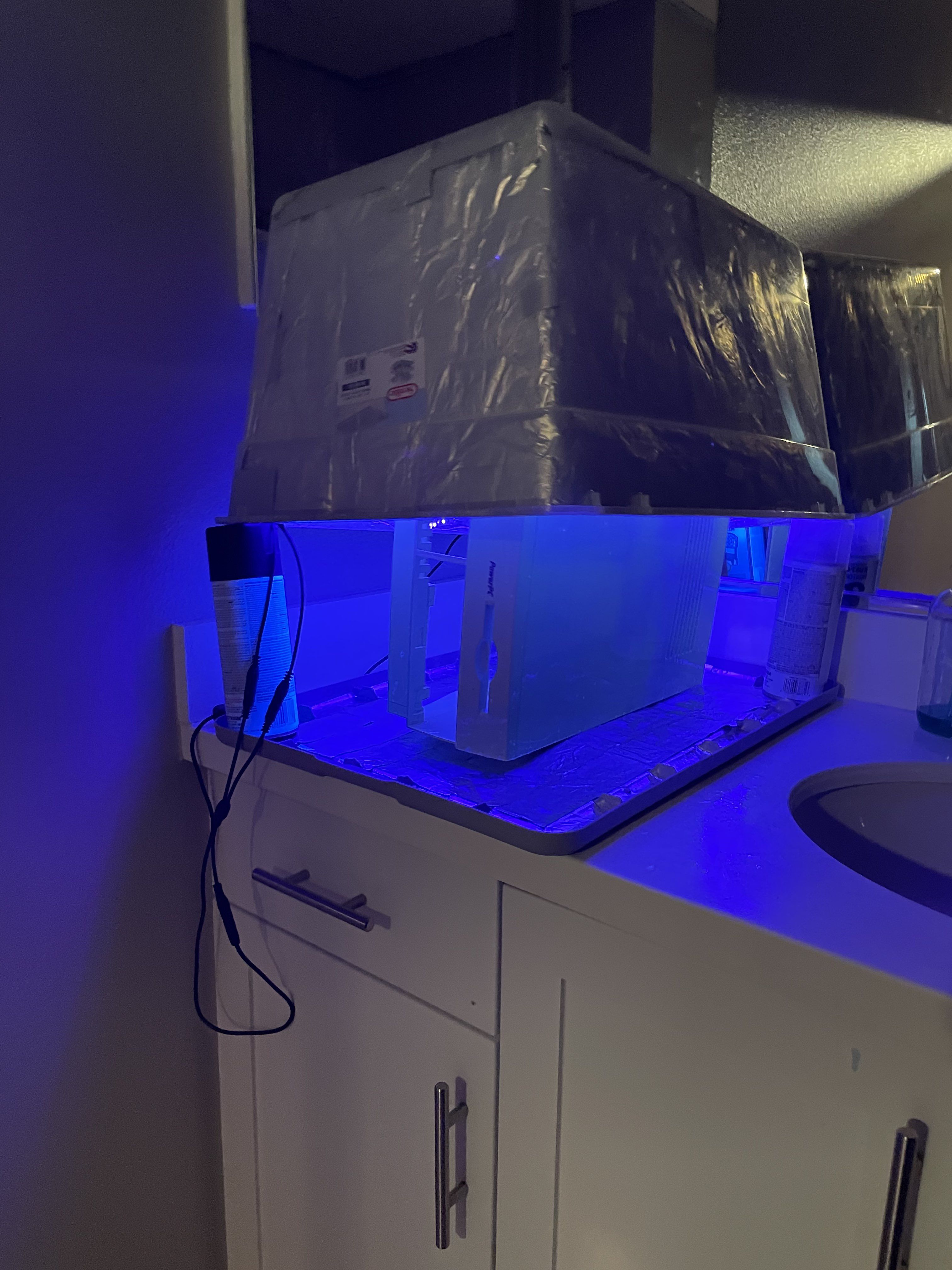

I've had EXCELLENT luck with the peroxide 40vil cream but I do realize that conditions need to be near perfect for that luck.
I constructed a UV box with some thermal insulating tape and foil to place over the plastic pieces during treatment, outdoors isn't ideal for me because I have little space and little access to direct sunlight so that box i constructed just sits in my restroom during the process.
My process for the cream usually goes as something like this:
- Deep clean the plastic before treatment with 99% IPA.
- Then I put the parts on the tray which I place the UV box over.
- For the cream I just put it in a small container and paint it all over the plastic.
- Exactly every hour I return to the box and paint on more cream, I've found that for me every hour works good for re-application because the cream isn't quite dry but still needs re-application.
- Then usually after 6-7 hours I pull out the plastics and rinse them off, after drying I completely lather the pieces in 303 Aerospace UV protection which helps protect it from re-yellowing and generally makes the plastic look cleaner.

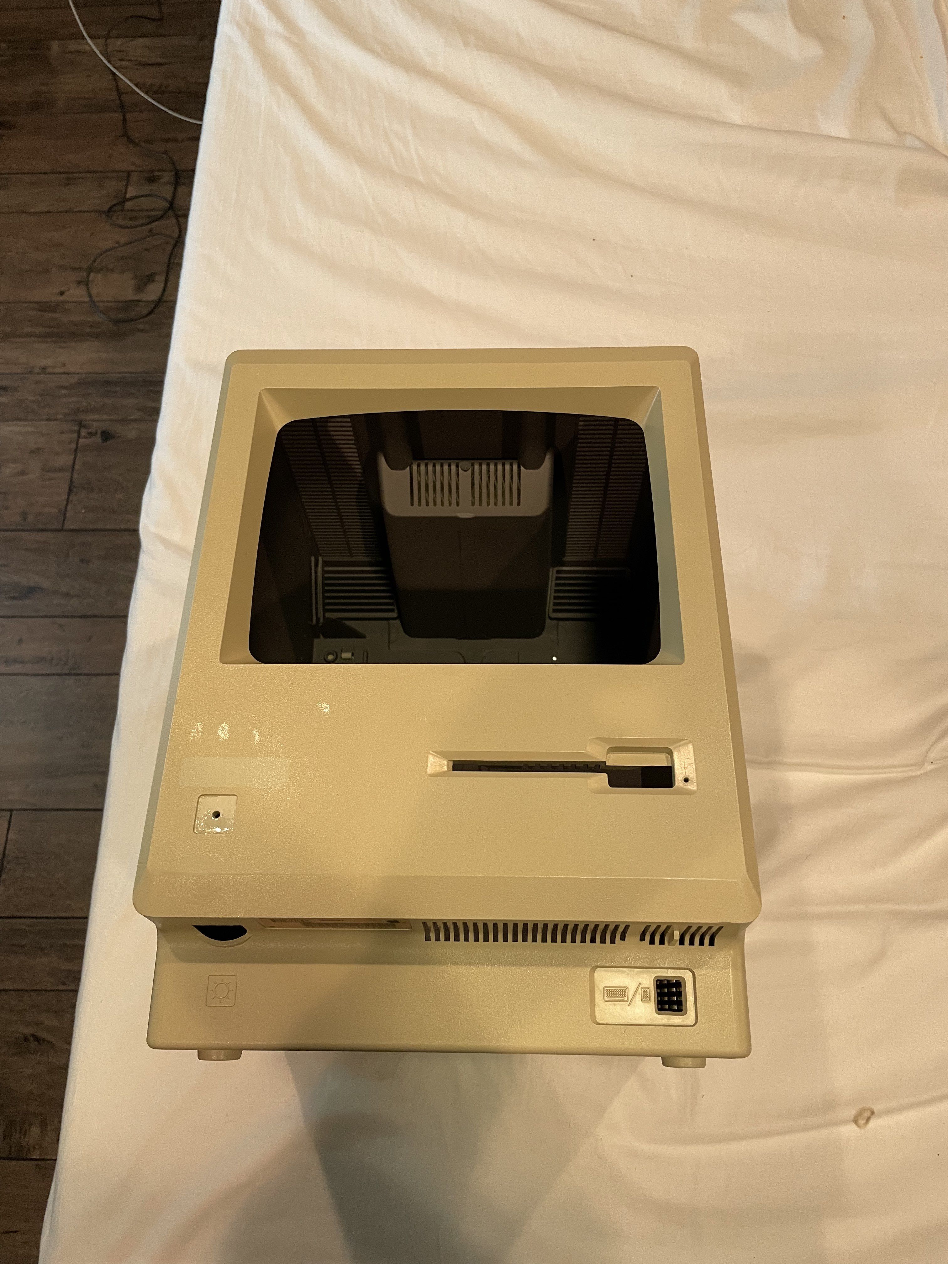

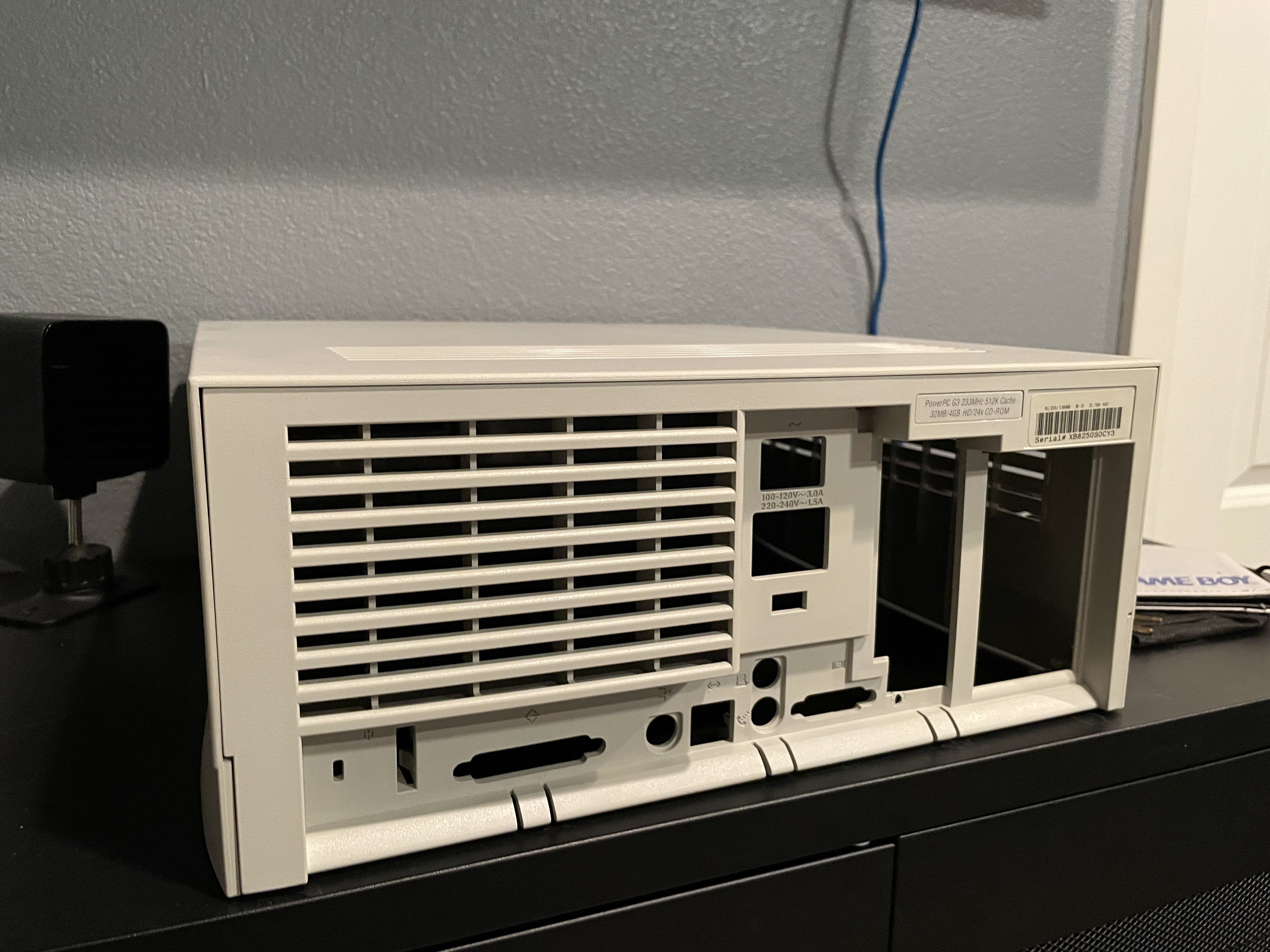

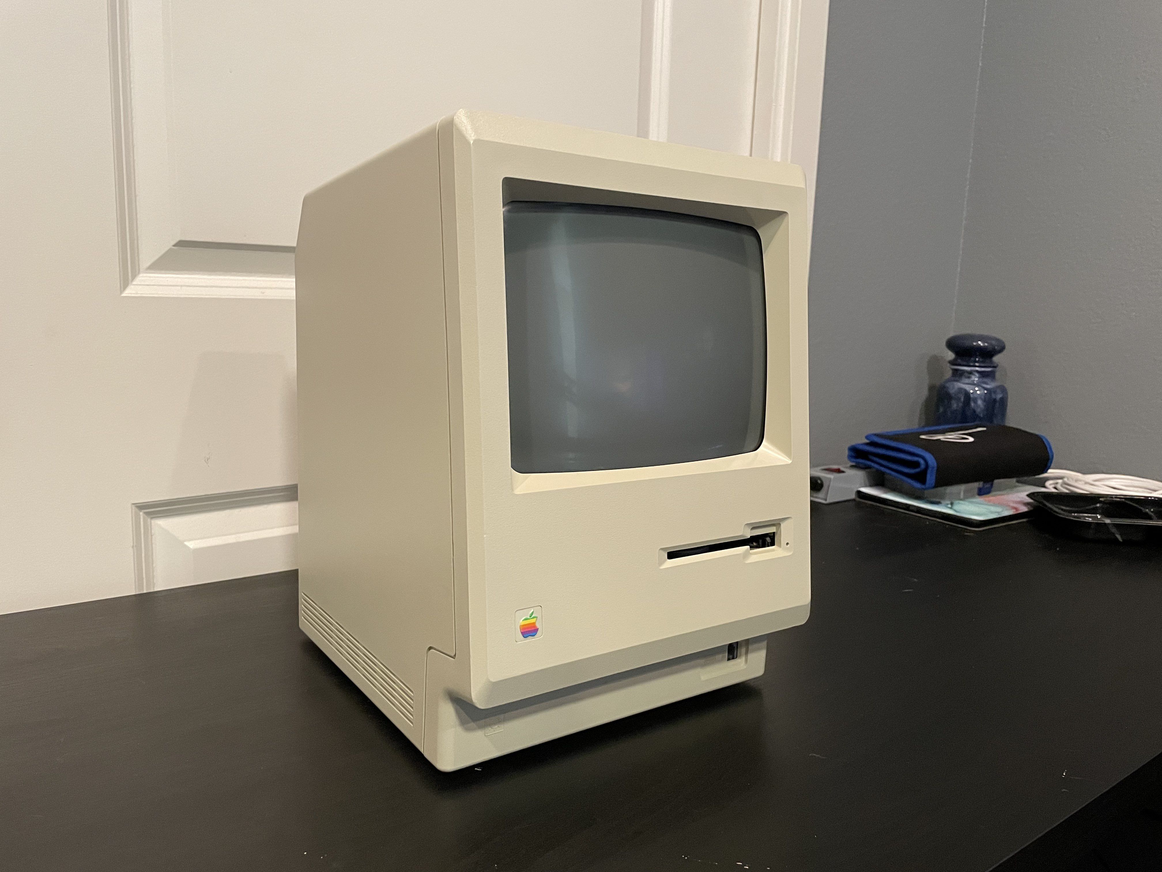

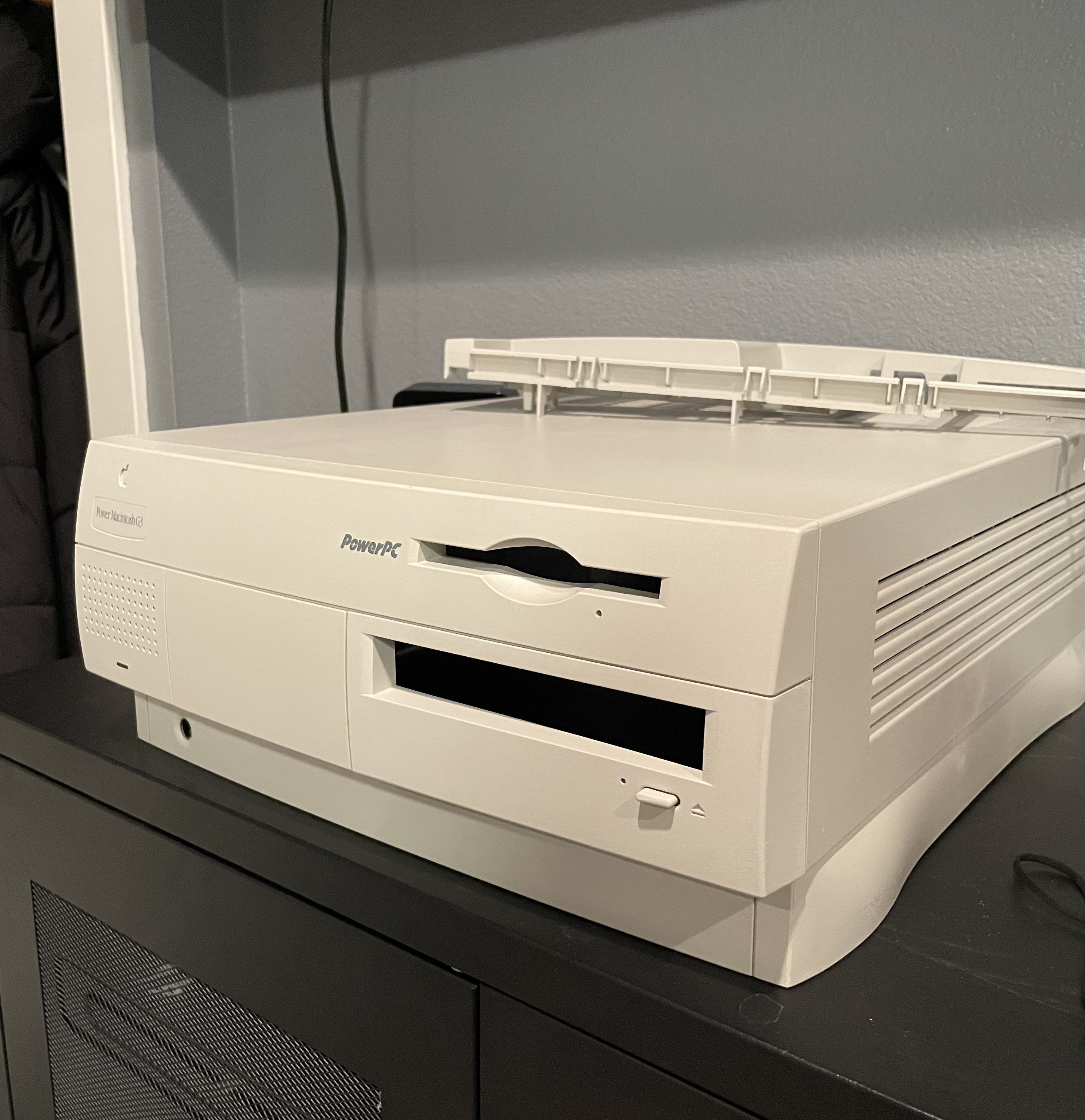

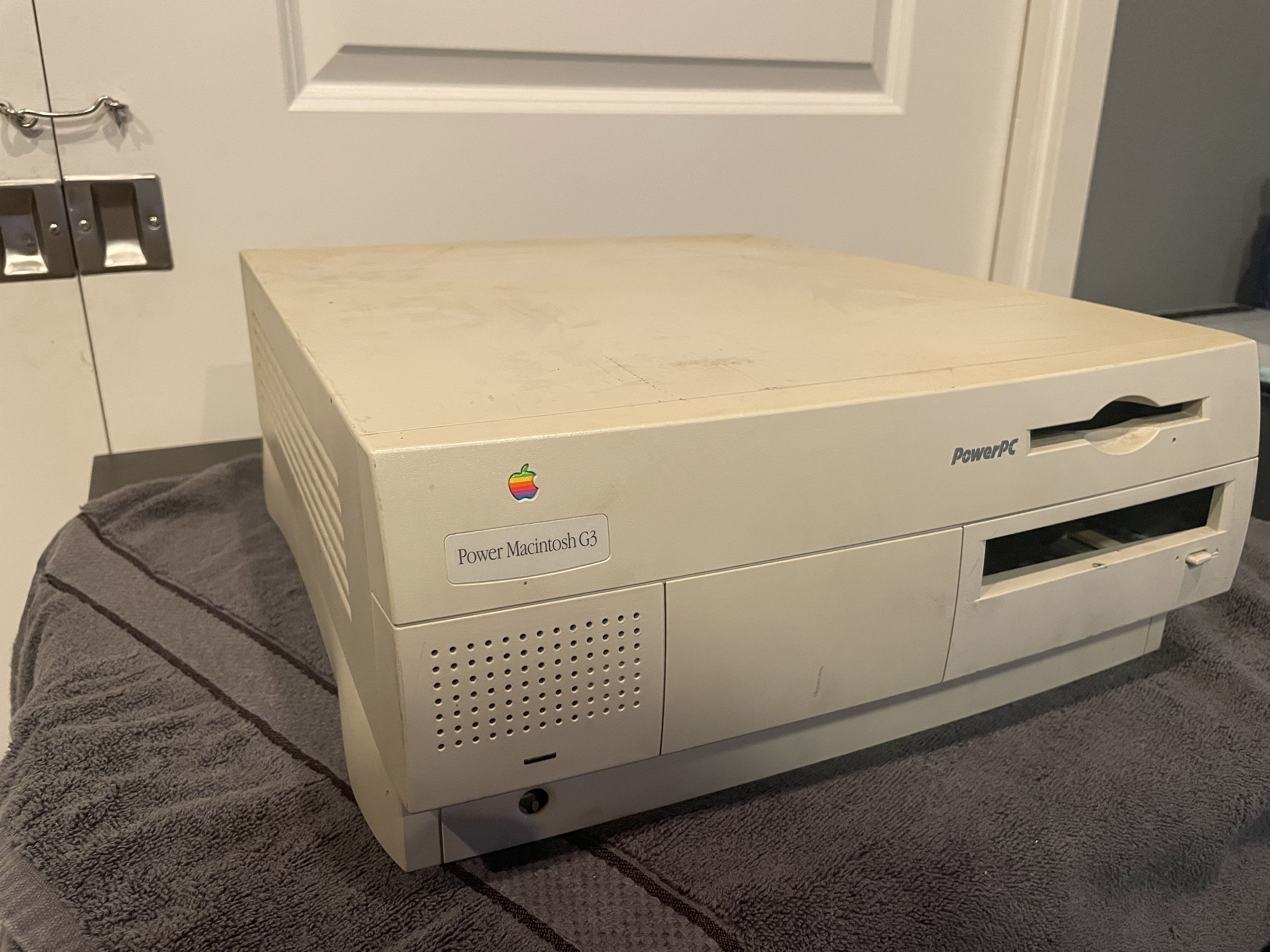

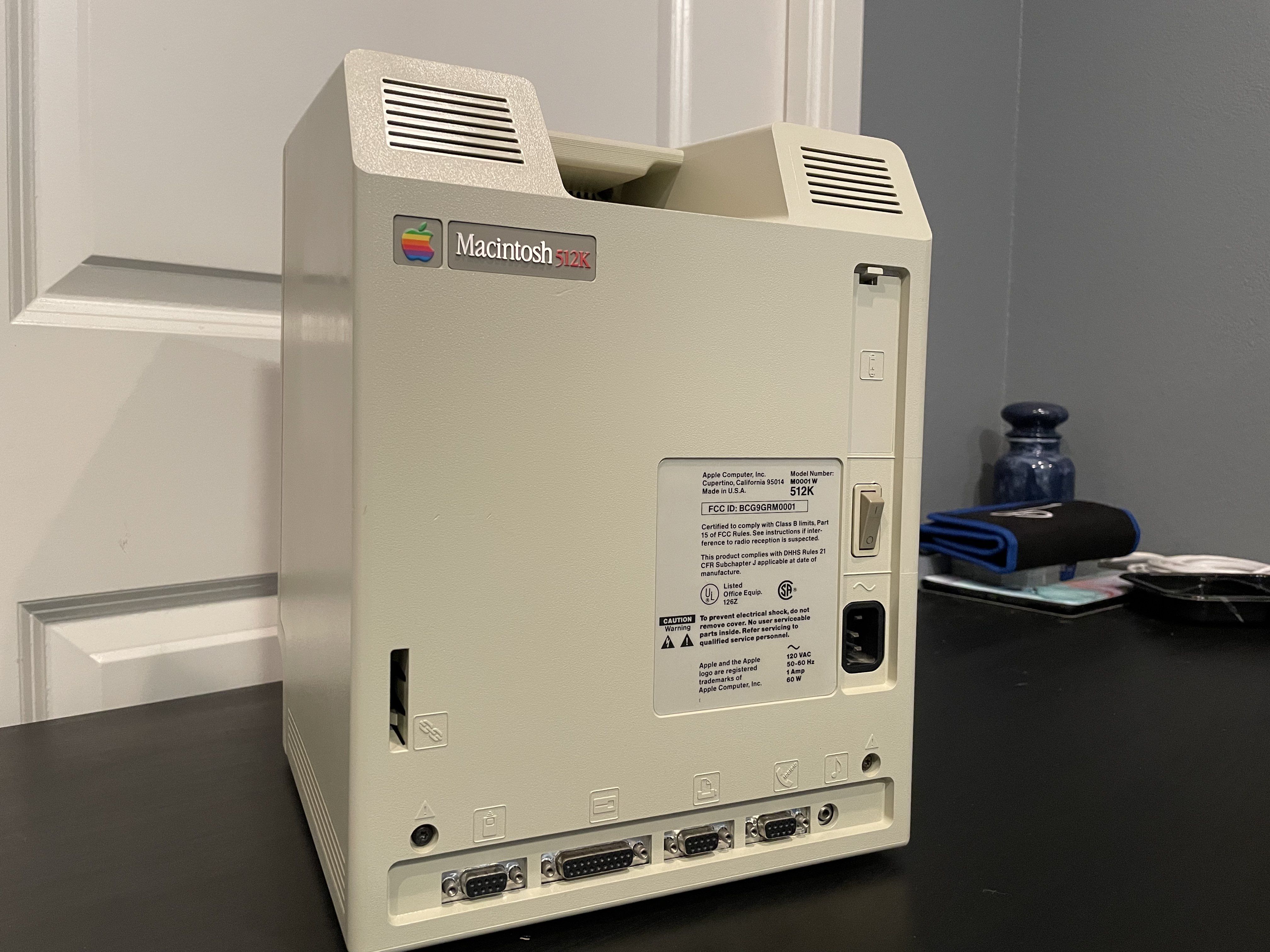

The cream method has always scared me away but since I can only retrobright indoors I went ahead and tried a few different times. From that I found that plastic wrap helps keep the cream from drying, but It adds to the likelihood of streaking greatly, I also found that using the cream isn't really a 'set it and forget it' method either. It takes lots of time and frequent monitorinig so my best advice would be setting aside a weekend for this. During my testing I retrobrighted my //c, Powermacintosh G3, 512k, and Plus all with perfect results I couldn't be more happy with!

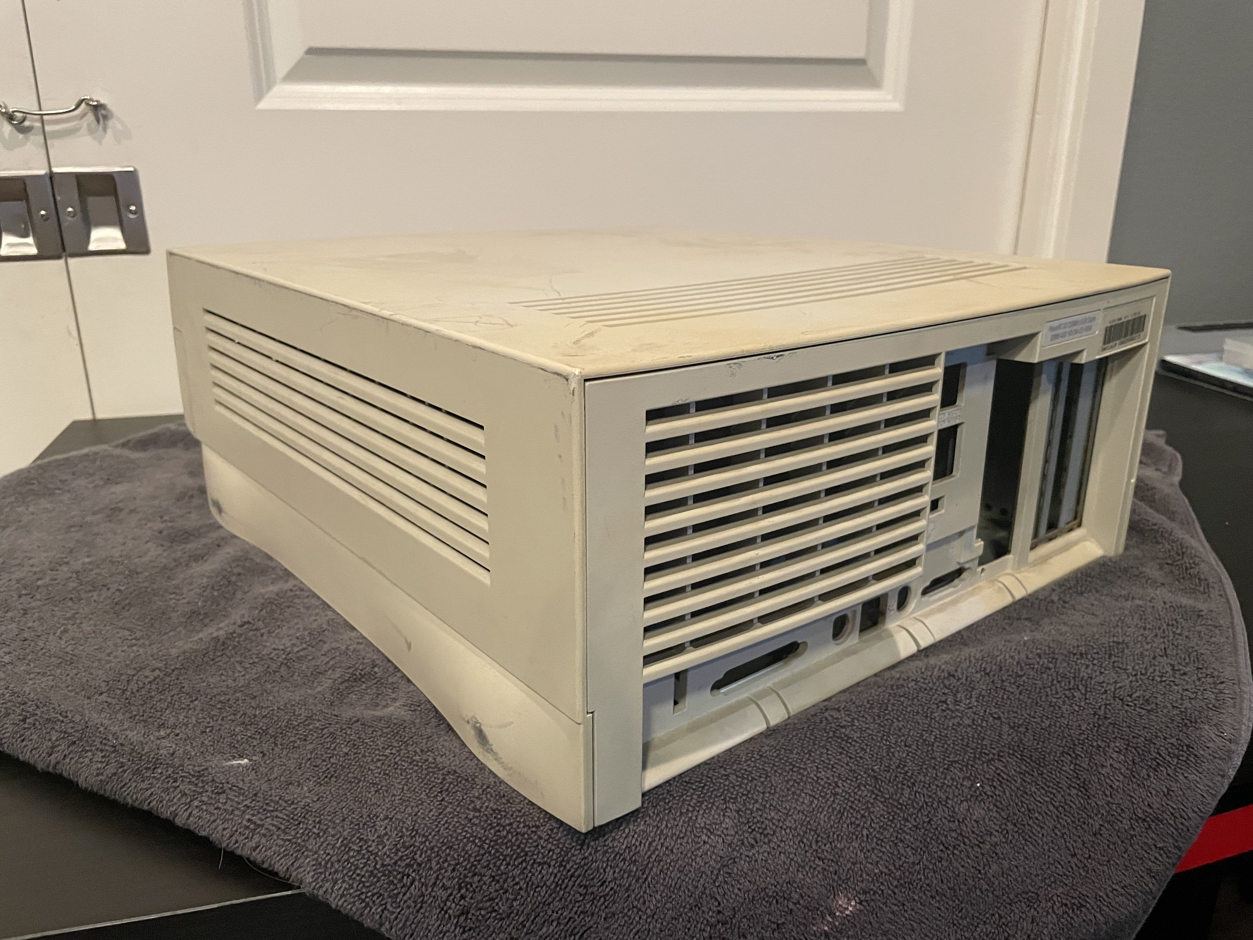

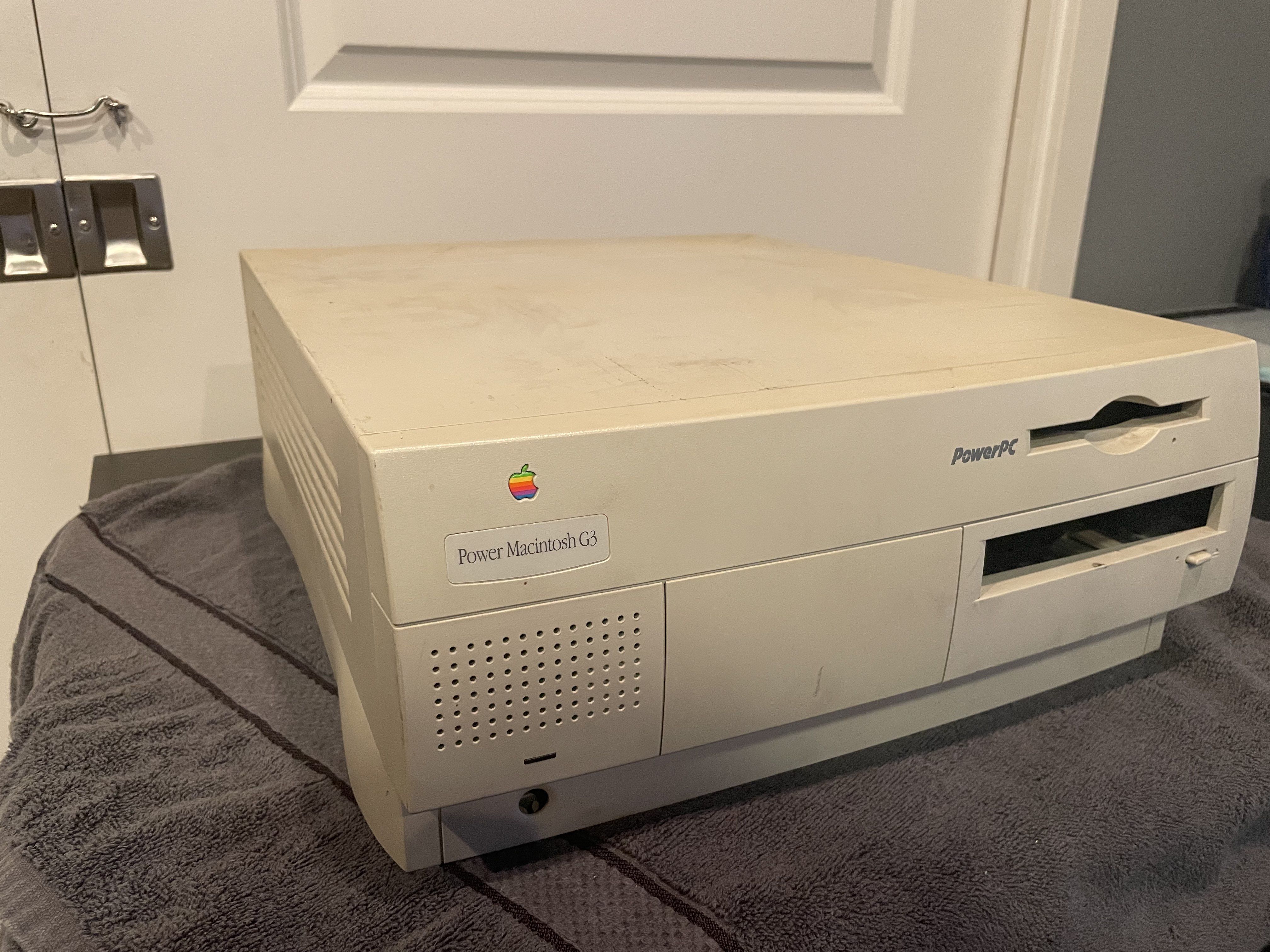

Before/After G3
Original 512k Test
I didn't think of it at the time but my box wasnt big enough for the G3 so I had to prop it up with cans and flip it every few hours for even exposure.
I'm currnetly In the process of filiming a sorta instructional video on this particular formula I seemed to get working on my Machines, I save my SE which has the WORST yellowing too so that should make it interesting. When it's done I'll link it in the thread.

I like your box-construction, could you please explain a bit more how/what did you do to build it?
Is is completely closed during the procedure?
Do you have reflective inside cover (to reflect back the UV light)?
Why it is covered with plastic bag from outside?
It's pretty simple really, I just took a plastic tub from the store and lined it completely with a mix of reflective thermal tape and tinfoil then after that I made a grid pattern with the UV strips. It may just look like it from the lighting but it isn't covered with plastic on the outside.
As far using it during the process I dont keep it airtight sealed, I just loosely rest it over the tray with the plastic pieces. My powermac g3 was actually too big so I had to use cans to stilt up the light box and it worked just fine.
Nothing scientific at all, I just built it with the supplies I had on hand :)
I based it off an older post in this thread, I can link it here.

I will say since switching to the UV light box method, I've found it to be very forgiving and very much a set it and come back after 10-18 hours, depending on how bad the yellowing is. I wrap because I feel like dried peroxide is a greater risk than plastic wrap.
I think when people see streaking from using plastic wrap over peroxide it's due to one of two things:
1. too strong UV light, hitting creases in the plastic wrap and getting focused more on certain areas (e.g. doing it out in the sun)
- or -
2. Leaving bubbles in the plastic wrap, which allows portions of the peroxide to dry, leaving an uneven color.
At this point my approach is to start at 9-10PM at night, paint on peroxide in a thin, even layer, lay plastic wrap over the whole piece, trying to minimize bubbles and ensuring there is a complete airtight seal to keep anything from drying out, then throw it in the UV box and get it out for a rinse in the morning. Haven't had any streaking or over-bleaching with this technique.

I was skeptical, but you can see a difference after only a few hours. After a few days it makes a massive difference per my earlier photos. I'm sold.
