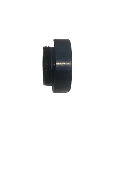

I have removed the cover over the camera, and this is where I'm nervous. I don't know anything about hardware modification. What do I do at this point, and do I need anything else to hold this new lens in place? I don't have access to a 3D Printer.
This thread has very excellent detailed instructions for all the software side of this, maybe it's worth a write-up for the hardware side too!
Thanks!
Jan 13, 2025
419
561
I have not found an easy solution.
My first unit (Build #1) was extra messy, this used the 5mm extension ring. This first design is more zoomed in, as the sensor board is raised only 6.5mm. While there is less cutting of the back plastic, the 5mm ring that you have is wider than the plastic lens holder, which meant a lot of cutting was involved to the to where the sensor build is screwed. This wasn't easy.
In Build #2 I used a 7mm spacer. https://www.m12lenses.com/7mm-Metal-Extension-Ring-for-M12-Mount-p/pt-erm12-700m.htm (they are cheap). There is no cutting to the mounting, just a bit more plastic is removed from the back case/housing. You can use a Dremel or soldering iron to cut the case, to make room for the higher sensor board -- be careful not to damage the sensor-board ribbon cable. I disconnected the sensor board to limit accidents.
In either design, it is best to add a M12 locking ring. https://www.m12lenses.com/searchresults.asp?search=locking+ring
Both designs used 3D-printed offsets. Build #2 was pretty nice (ReelsSTandOffv6.zip is a STL file) as this print has some adjustability.
Try using https://printathing.com/order/ to order the 3D part.
I printed in ABS plastic. Seems it will cost about $11 ($0.79 for the part, the reset is handling.) I have not used this service, as I print at home.
