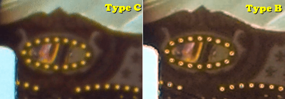

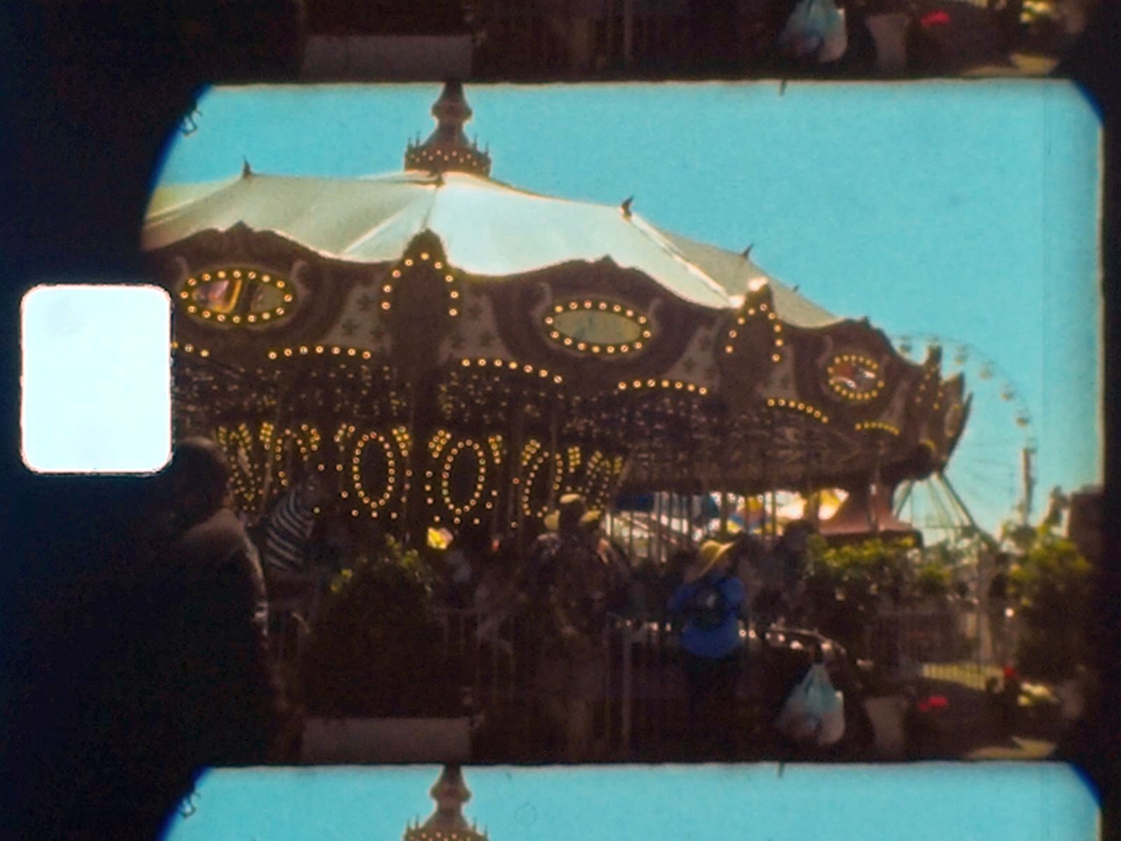

I still have an issue with my Type B with 12mm lens zoom out to the max.
My original Type C lens hack with a the lens slightly closer:
Both unit are set to sharpness of -1.0. Yet the Type B still lacks resolution, and as weird sharpening halos (resulting in black dots in the lights.)
Clearly something in the firmware's resolution hack is not working on B.

Brionco
Feb 27, 2025
6
My original Type C lens hack with a the lens slightly cloh unit are set to sharpness of -1.0. Yet the Type B still lacks resolution, and as weird sharpening halos (resulting in black dots in the lights.)
It looks like the stock FW when sharpness is set all the way up. I was seeing these dots in highlights as well.

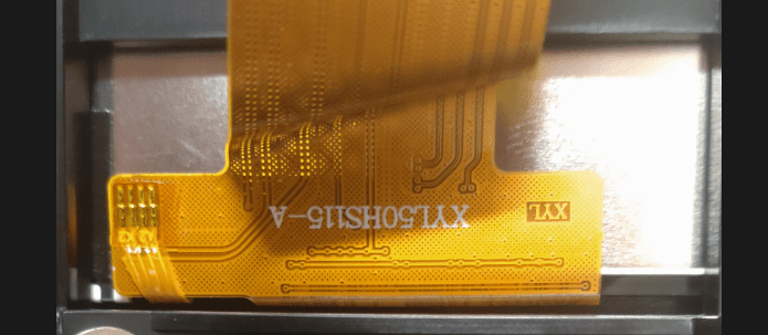

rick c
Jun 23, 2025
Hi, unfortunately not. I had put the project on hold. I wrote to two Asian dealers, but they couldn't help me with the data on the display either.
As the device isn't really cheap and I had digitized everything with the original firmware (not really perfect, but better than nothing ;) ), I wasn't prepared to invest that much again. But maybe that will happen.

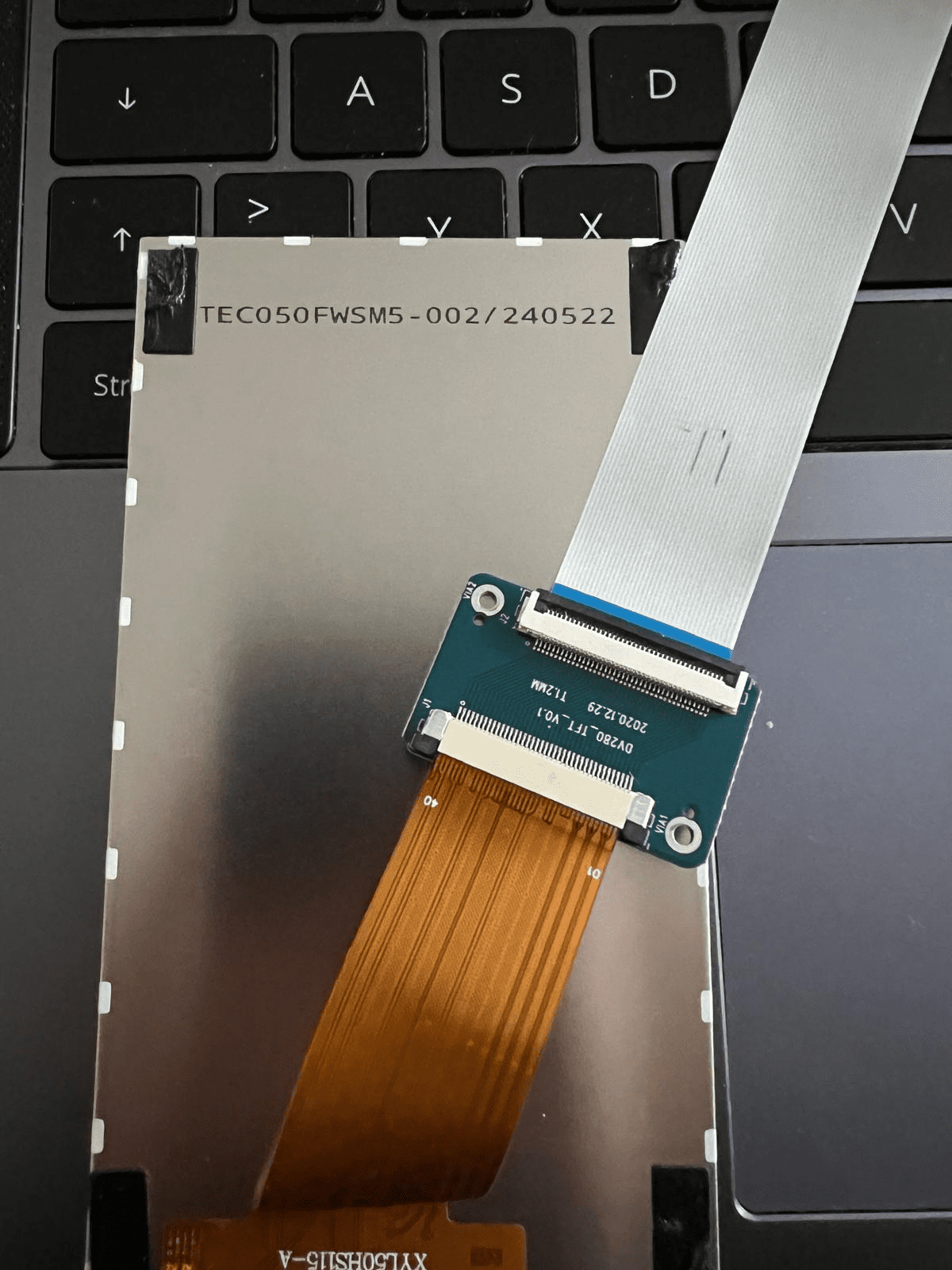

I "blew" my screen on B machine by getting the 40 pin ribbon twisted where it connects too the mother board. After a careful but invasive post-mortem with a microscope, I found 5 conductive traces fried on the screen just beyond the connection where the ribbon transitions to the screen itself. I was able to determine that they were directly opposite the heavier duty power traces the supply the illumination LEDs. The affected traces are used to address the screen matrix that generates what the screen is displaying. Like your scenario, after untwisting and reconnecting the flat cable correctly, the machine booted correctly and seemed to operate, but the screen was either black or unintelligible.
Since then, I've tried to identify the exact 5" TFT 40 pin flat cable screen based on resolution and the exact dimensions of the screen with the assumption that it is an off the shelf item. I found one that fit perfectly, but uses a 30 pin cable. That's the best I've been able to come up with.
Somewhere is a screen with the spec we need or can use with some work-arounds. Kodak does not replace the screen if it comes in for a warranty fix. They just replace the whole machine.
We could use some help out there if someone is savvy enough to find a solution.

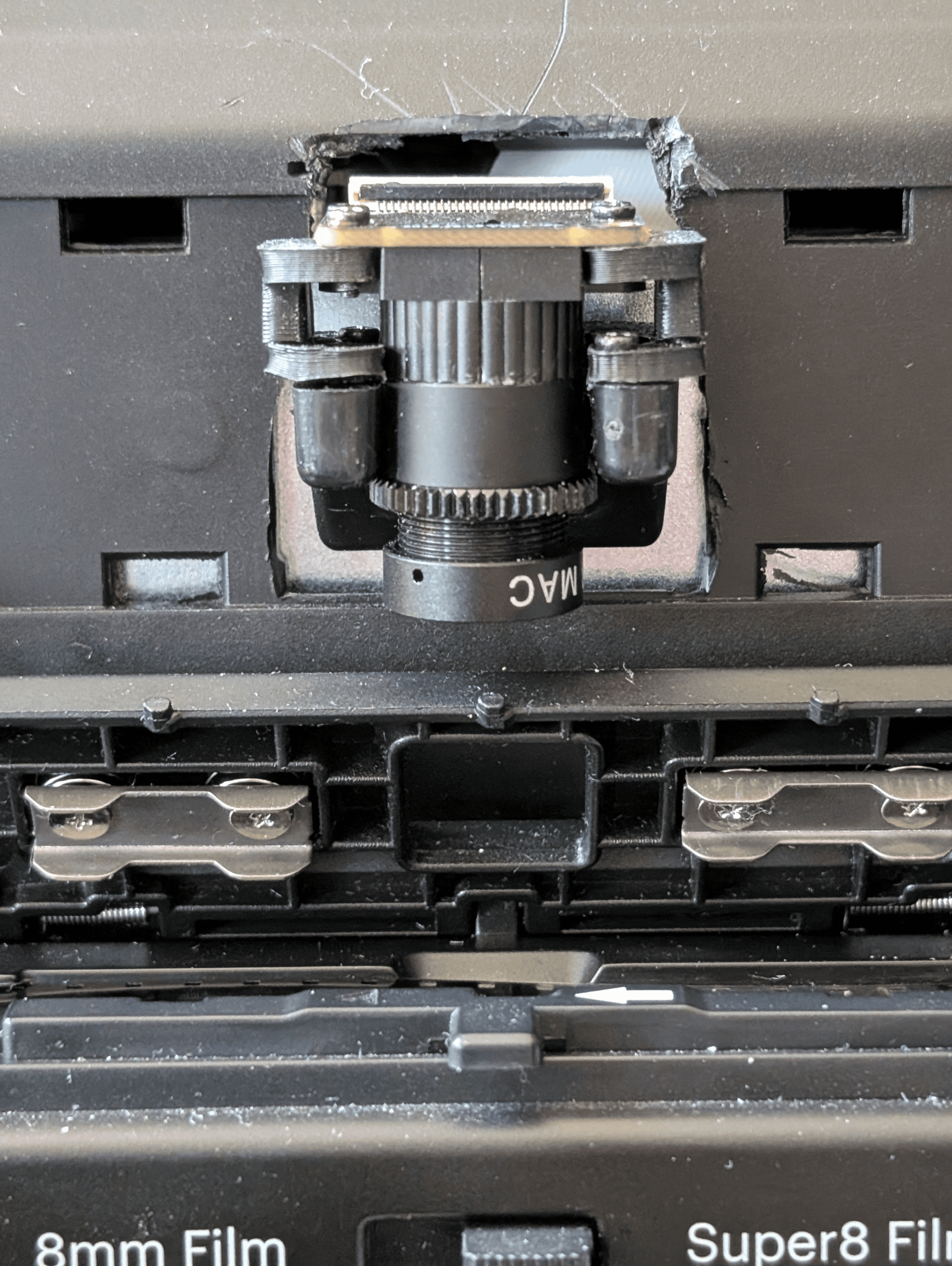

I wasn't every able to focus the original lens when moved too much closer. Also as you move the lens down, it hits the film loading tray. With the 12mm lens it is really not any lower as the the sensor board is higher.
Why did you disassemble the unit to replace the lens? The Lens can be replace without opening the unit, just remove the lens cover from the front. The reason to open up Reels is for adding the serial port mostly for development purposes.
well - after opening it I also saw how to remove the cover without opening the part... :)
But as always - opening things up gives a clearer view :cool: - at least if you plug the cables in correctly afterwards... 😭 - a new part is here - don't tell my wife...)
... I was looking for a solution to lower the sensor - in other words, to be able to replace the original sensor mount using a 3d print...

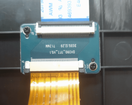

thjakob
Jun 20, 2025
16
6
If I look at the 40-pin ribbon cable, which is routed from the motherboard to an ‘intermediate board’, the PINS are routed 1 to 1 to a mating connector on the ‘intermediate board’. The LCD/TFT ribbon cable is connected to this mating connector - but the LCD/TFT ribbon cable probably only has 11 wires (which may indicate control with SPI) - in some cases several wires are pulled together/connected and routed on a single wire within the ribbon cable.
You mention that you have found a custom-fit display (except for the 30 PINs...) - do you have more details?
(presumably the whole thing won't fit anyway because of timings/voltage levels... - but who knows...)

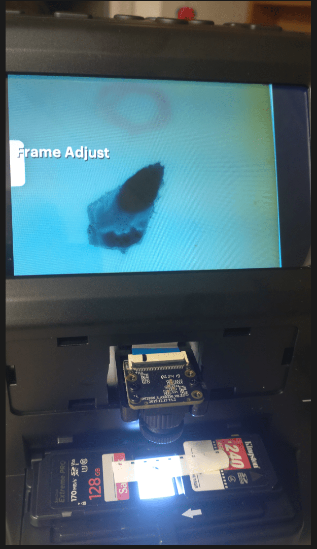

thjakob
Jun 20, 2025
16
6

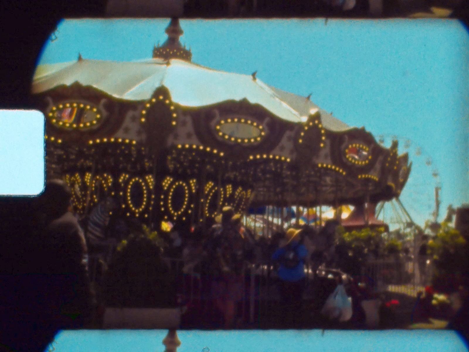

... now I'm a bit confused - would it be possible to get a sharp image with the stock lens using the full sensor size, contrary to the previous tests ? ...
I have this cool firmware from odan0 in version 6.1 on it.
I have removed the scropping completely (`fully zoomed out`) in the settings - I have now gradually `underlaid` the film strip so high that only the actual image is now taken from it again - while I `turned out` the lense out until the image is sharp again. So - as I see it, the full sensor resolution would now be used to capture a Super8 image...
... yes, that's just a blob of felt-tip pen... but amazingly sharp - in my opinion...
Sure, so if I lower the sensor and thus the lens, this film fixer flap gets in the way when I load the film...
... maybe build a fold-away sensor holder with a 3d print...
But back again - am I pushing the lens to its limits with this ‘lowering’ so that effects occur somewhere that I have not (yet) recognized?

Mac84
Sep 4, 2021
311
449
New Jersey, USA
www.mac84.net
Yes, but keep in mind the live preview of the image before you record is different from the results of the recording. With the live preview there isn’t as much compression or images to video processing going on, so it tends to look sharper.
There is a “webcam” mode of the device that you can enable via a serial connection, although then the issue would be how to reduce the flicker and frame pull from the video stream etc. Plus I think that stream is only at 1080p.
This is great test. How many millimeters from the lens front to the film?
thjakob
Jun 20, 2025
16
6
the subject of ‘video compression’ is currently far beyond my understanding - with this test I was merely trying to find out whether a technical (sharp) focus can be achieved with the stock lens if you bring it closer to the film (ok, in my test I just brought the film closer to the lens)...
The fact that my sharp image is then `compressed` is of course a pity - couldn't the sensor/board be taught to simply create thousands of uncompressed jpegs - even each film image several times with different `shutter speeds` -> HDR
In the end, the film is then only created afterwards in a video editing program with my own compression, which I can then select there...
... that would be a completely new software for the scanner...
Translated with DeepL.com (free version)

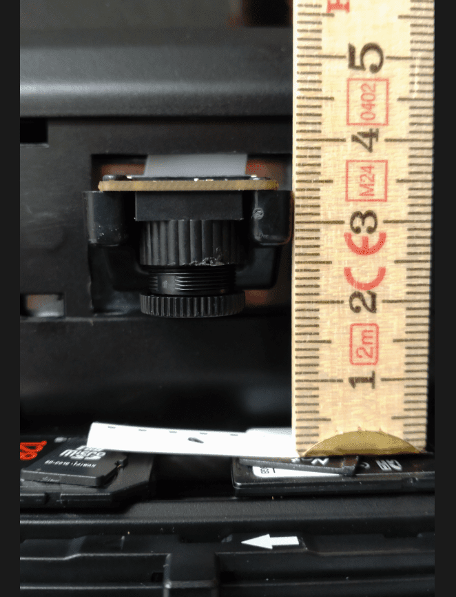

thjakob
Jun 20, 2025
16
6
it is approx. 18mm from the ‘lens housing’ to the film (the lens itself is approx. 1mm in the housing)
The original distance is about 33mm - right? If you consider that the sensor holder is approx. 15mm thick - you might be tempted to install it rotated by 180°...
admittedly - it still needs some help with the Dremmel (retaining cam and ribbon connector + cable gland) - perhaps easier with the 3d printer... 🤷‍♀️
It won't work the way it's shown here, because the lens already wobbles a little bit in the thread - and therefore probably won't produce a nice film due to vibrations - do you add image stabilization to the firmware? :ROFLMAO:
... I'm a bit conflicted about this test - because I've already ordered a new lens from Scorpio... 🥳
