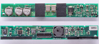

High Resolution Top & Bottom photos of all the DC boards.
Barrel Plug Board​
Primary DC Board with Daughtercard Attached​
Daughtercard​

Here are high resolution photos of the component side and black side of the PMU circuit board. And while the utter lack of burned components doesn't guarantee something is bad on that PCB, it's a bit challenging to troubleshoot.
