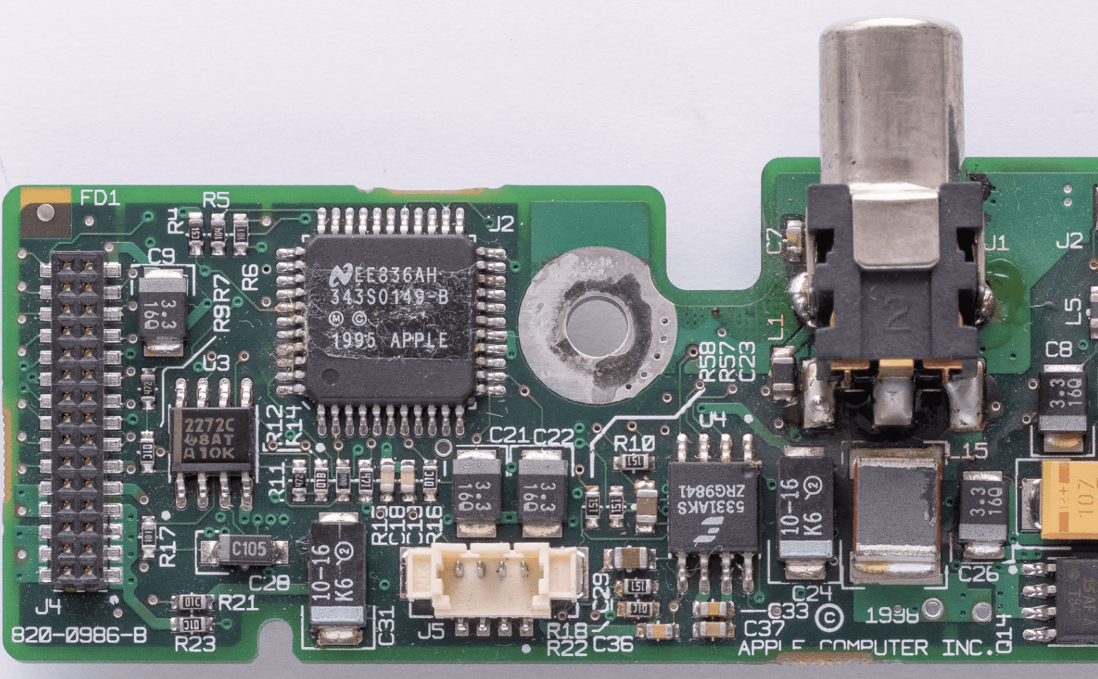

If not done already, I would evaluate for barrel plug PCB failure by exchanging the barrel plug PCB's between the two PDQ's:
- If the booting behavior follows the exchange (i.e. the non-booting PDQ now boots and the booting PDQ now doesn't boot), then the problem is the barrel plug PCB of the non-booting PDQ.
- Unlikely, but if the booting behavior AND the sudden shutdown issue follow the exchange, then there is a problem with both barrel plug PCB's.
What brought this to mind was a non-booting Lombard I obtained last month that turned out simply to have a bad barrel plug PCB.

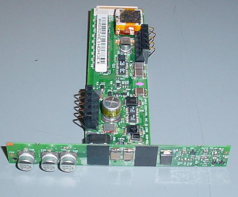

Schematics would help, but a problem that fixes itself as you described sounds like a bad cap. Is this the board in question:
I think that board generates the different voltages used by the machine from the main battery and/or the power brick. If you carefully probe the caps on this board with the power brick attached, you should find constant 24v from the brick as well as 5v trickle/standby that goes to the cuda/PMU. If moving this board from the now-working machine fixes the still-dead one, that could help narrow the search.
Is there a 10v 100uF electrolytic next to the cuda/PMU chip? Is this near where the clock battery plugs in?
One other thing to try could be temperature. Without going to extremes, you could try different temperatures, like a warm sunny spot vs 15min in the fridge. If 15min in the fridge breaks the now-working one, that would also point to electrolytic caps.

By if by "PSU" you mean "the small PCB on which you find the DC power input jack," all I can say is that there are no electrolytic capacitors on that board, and I have re-soldered the joints on that DC power jack so I can confirm absolutely that is not the problem.

I did more voltage measurements today.
When the "semi-good" PDQ refuses to power-ON, I can still press the keyboard keys & PWR key to do a PMU reset, and as long as I hold down those keys, the fan runs at full blast. The fan is so loud it's impossible to hear the hard drive, but I confirmed today that the hard drive powers up while the fan is spinning full blast. Under that condition, I measured the following voltages (all rock solid stable while the fan is running full blast with keys pressed):
  • C31 (to the left of connector J5) on main DC board at back with the power plug: 4.99V
  • C3 on Modem: 5.05V
  • Various capacitors on the CPU card: 2.0V or 3.3V, depending on which capacitor
  • Capacitors on the RAM module attached to top of CPU card: 3.3V
But as soon as I release those keyboard keys, all power gets cut and the above voltages all drop to zero, and the HDD and fan spin down. Pressing the power button soon after that does nothing, and voltages do not rise even for an instant. Usually, if I wait 24 hours and then press the power key (with the AC Adapter connected to the wall and PDQ), then it will power ON, but for whatever reason, it refused to power on today after that waiting period.
