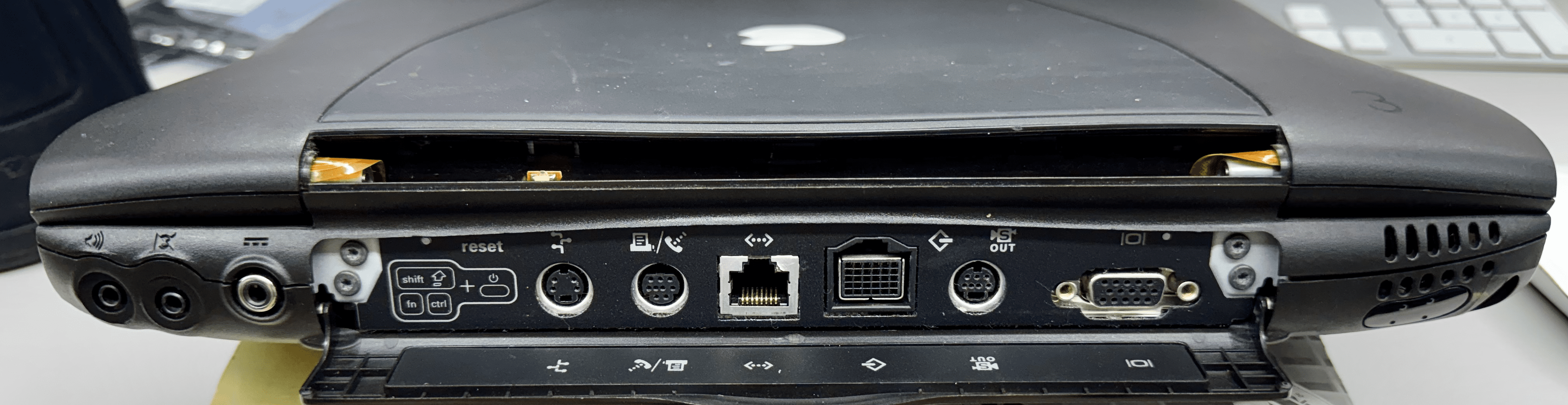

I've not tested the headphone jack or the VGA output connector because I've not had need too. Today's reveal shows why. Today, for that one time only, I got a boot chime (which means the internal speaker works, and there's no need to check for sound via the headphone jack) and I also got the display backlight and LCD to activate and function normally (for a short period of time lasting a couple minutes).
Here is a photo showing all the ports, just FYI:

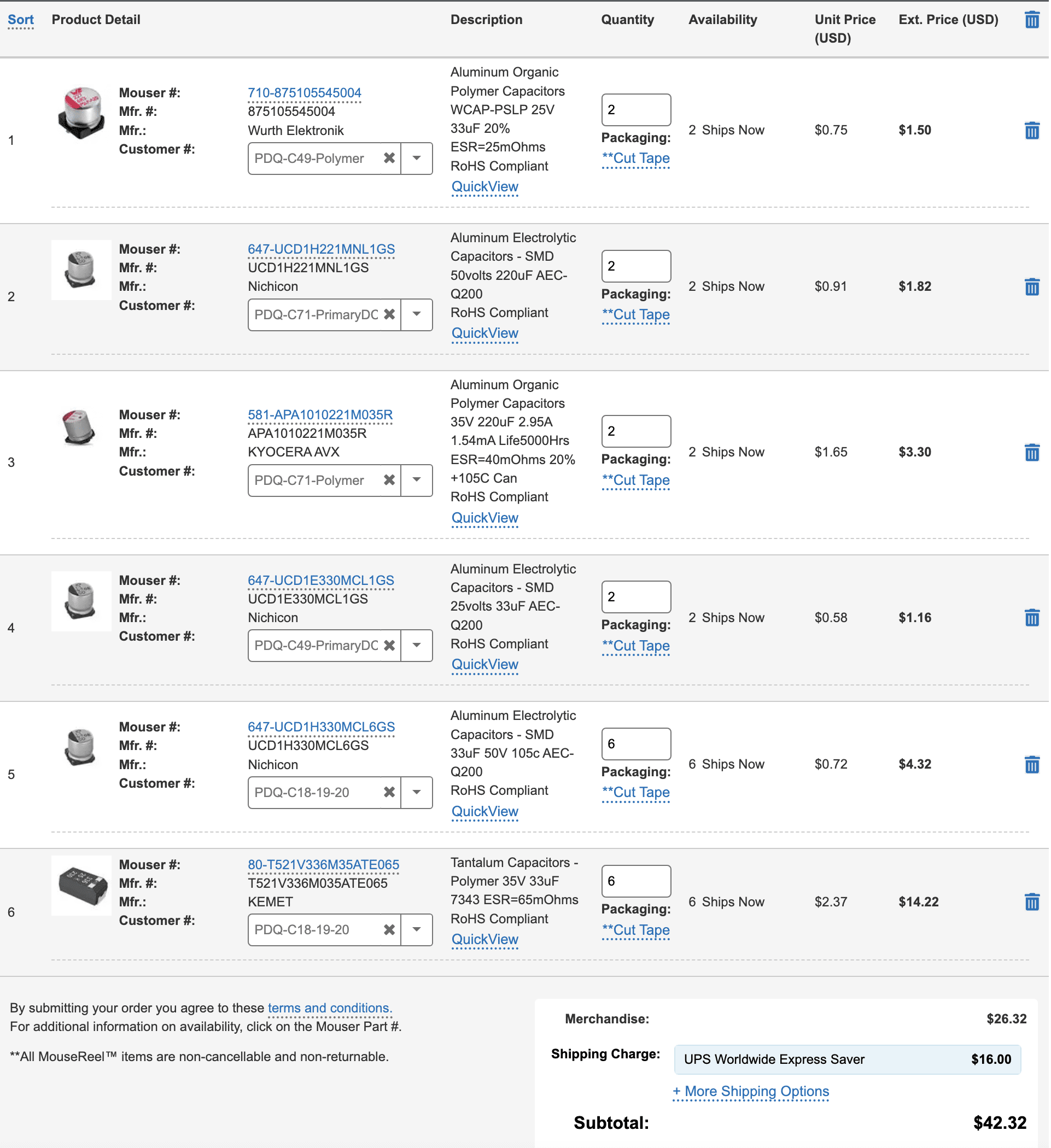

I will order the 5 capacitors (both aluminum electrolytic types with low ESR and polymer types, just in case the ESR of the polymer caps is too low for the DC circuit). That will put to reset the suggestions that recapping may be the culprit. But again, the caps are far from the CPU and HDD, so I think they are there mainly for dealing with the two drive bays. Even so, we shall see.

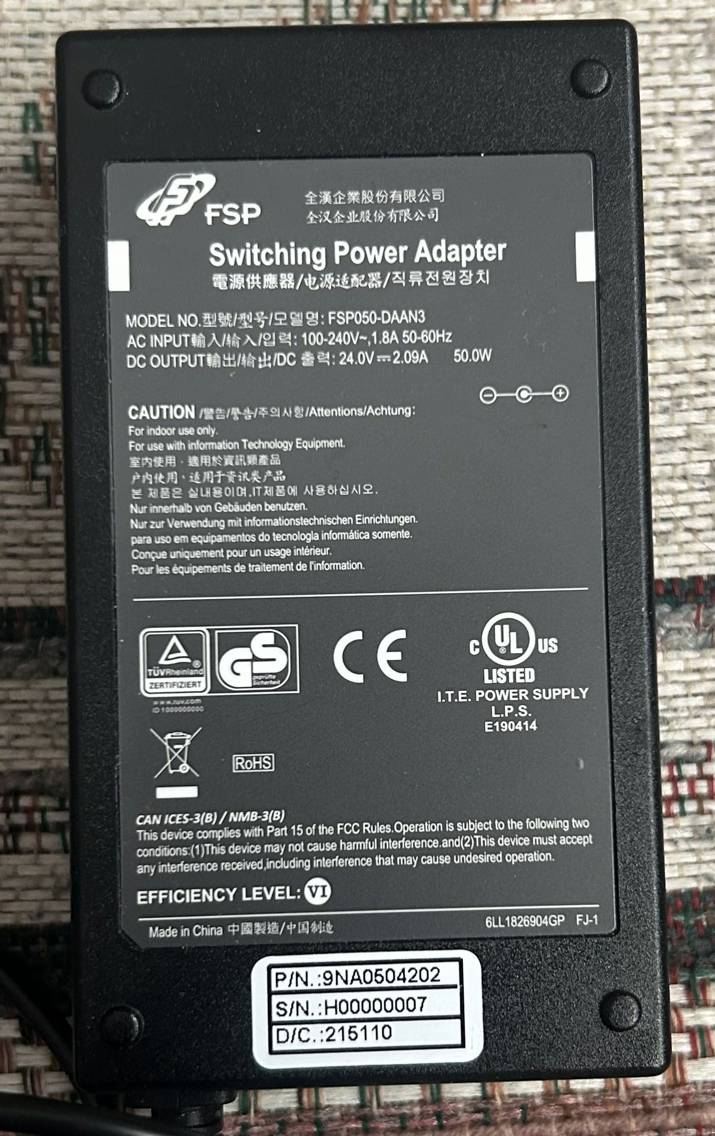

So I guess the question at this point is, have any of my fellow Wall Street owners found a suitable modern replacement for the stock Apple AC adapter? The output is 24 V at 1.875A.
For my PDQs and Lombards, I use an FSP AC adapter from Digikey (Digikey part number 2967-FSP050-DAAN3-ND, FSP part number FSP050-DAAN3) with a connector adapter from Bix Power. It appears that Bix Power does ship to Japan.

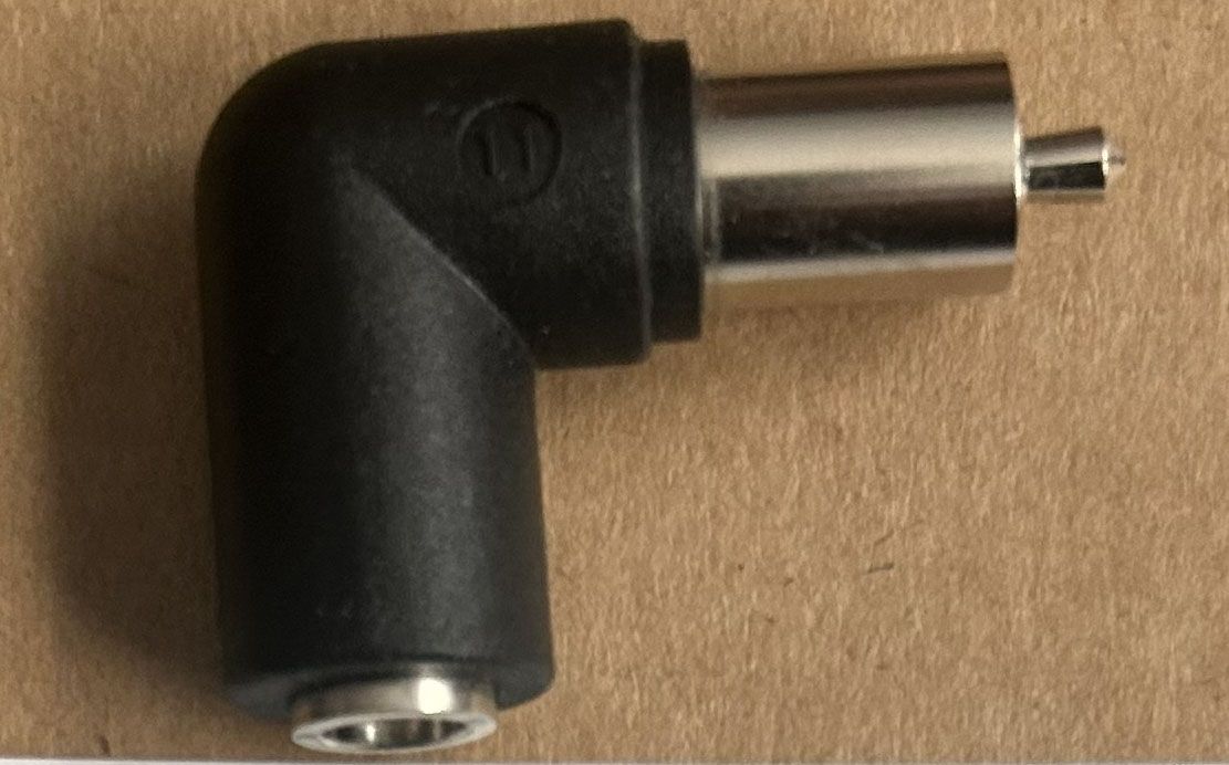

I actually started investigating that right angle adapter from Bix a couple days ago, but they want $45 for shipping alone which is an absolute ridiculous amount considering the size and weight of that thing. It’s totally utterly unacceptable.
It’s quite sad too because in theory it should allow use of any 24V, 2A or higher modern AC adapter.
With that said, I am thinking about purchasing something from a US based seller and discussing with that person if I could have the adapter shipped to them so they could ship it to me. We shall see.

In my specific case, yes, I have two, specifically made for the PDQ machines. Model M4402. I uploaded photos here.
But the reason we are discussing the right angle adapter is for the sake of using an alternative, modern AC adapter. If one uses a mere "compatible Apple" adapter, it too would be vintage, possibly have leaking capacitors, and be suspect. A modern adapter would not be suspect. We simply need that right angle adapter. And to prevent that one company from having a death grip on it (they alone sell it now, and gauge people outside the US for outrageous shipping fees), I think I will talk to Mark J. at MacEffects about the possibility of them selling something similar in the future, opening the door to a realistic price for buyers worldwide.

I decided to hold off on my Mouser order for those 5 capacitors because my gut is telling me VERY STRONGLY those 5 caps have nothing to do with the problem. They are just too far from the motherboard and HDD to make any sense at all. They seem to be there to support the two drive bays. And so, I want to test a modern replacement AC Adapter first. If that fails, buying those 5 caps is my fall back. And if that too fails, then all I have are tears. :cry:

RECAPPING​
I still think the electrolytic capacitors that are on the PCB which sits between the two drive bays are too far away from the primary DC board that has the DC input jack on it (at the back of the machine). I therefore am highly skeptical if that would be "the magic fix" for this sudden power loss problem. Nevertheless, to avoid a situation where folks continue to point to finger at those caps, I will need to now buy the caps and see what happens.
YOUR THOUGHTS​
Now that you've read my report, I'd certainly appreciate your thoughts and suggestions.
If I recap and still have the same power loss issue, then it's clear something else is the cause.
