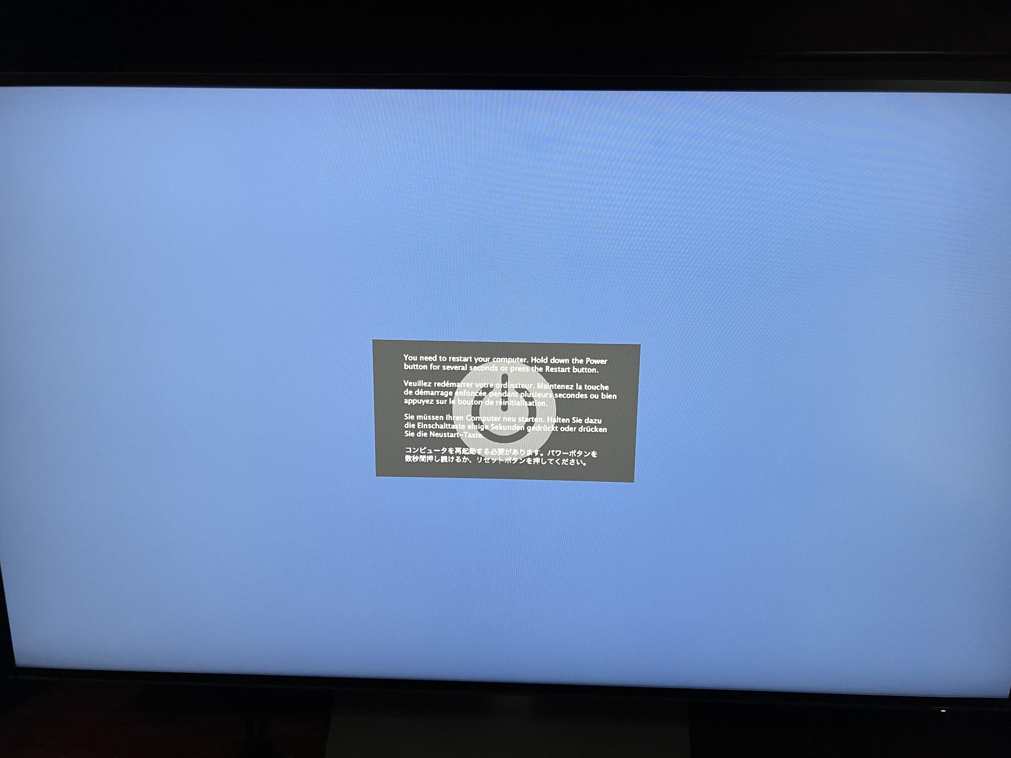

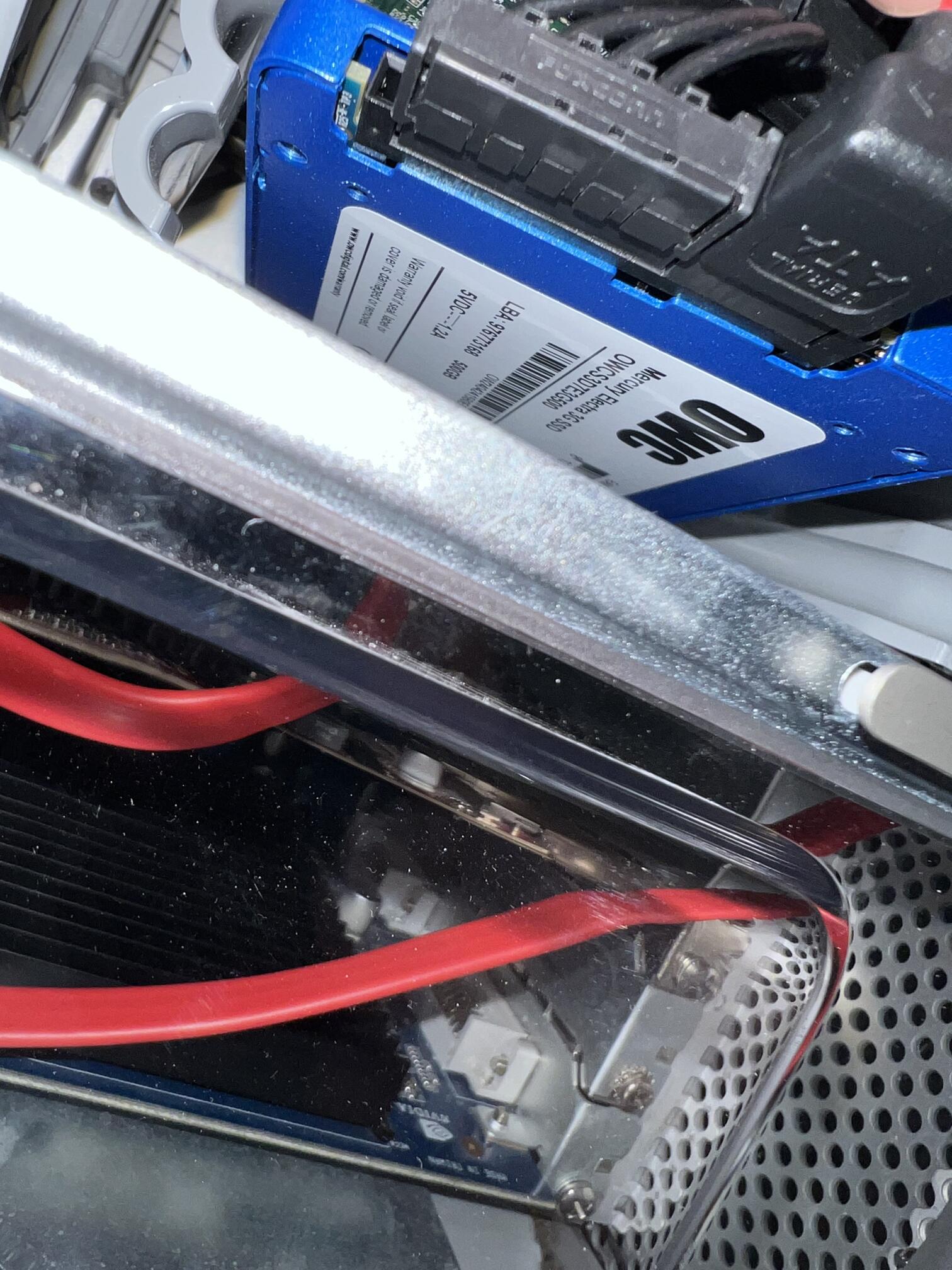

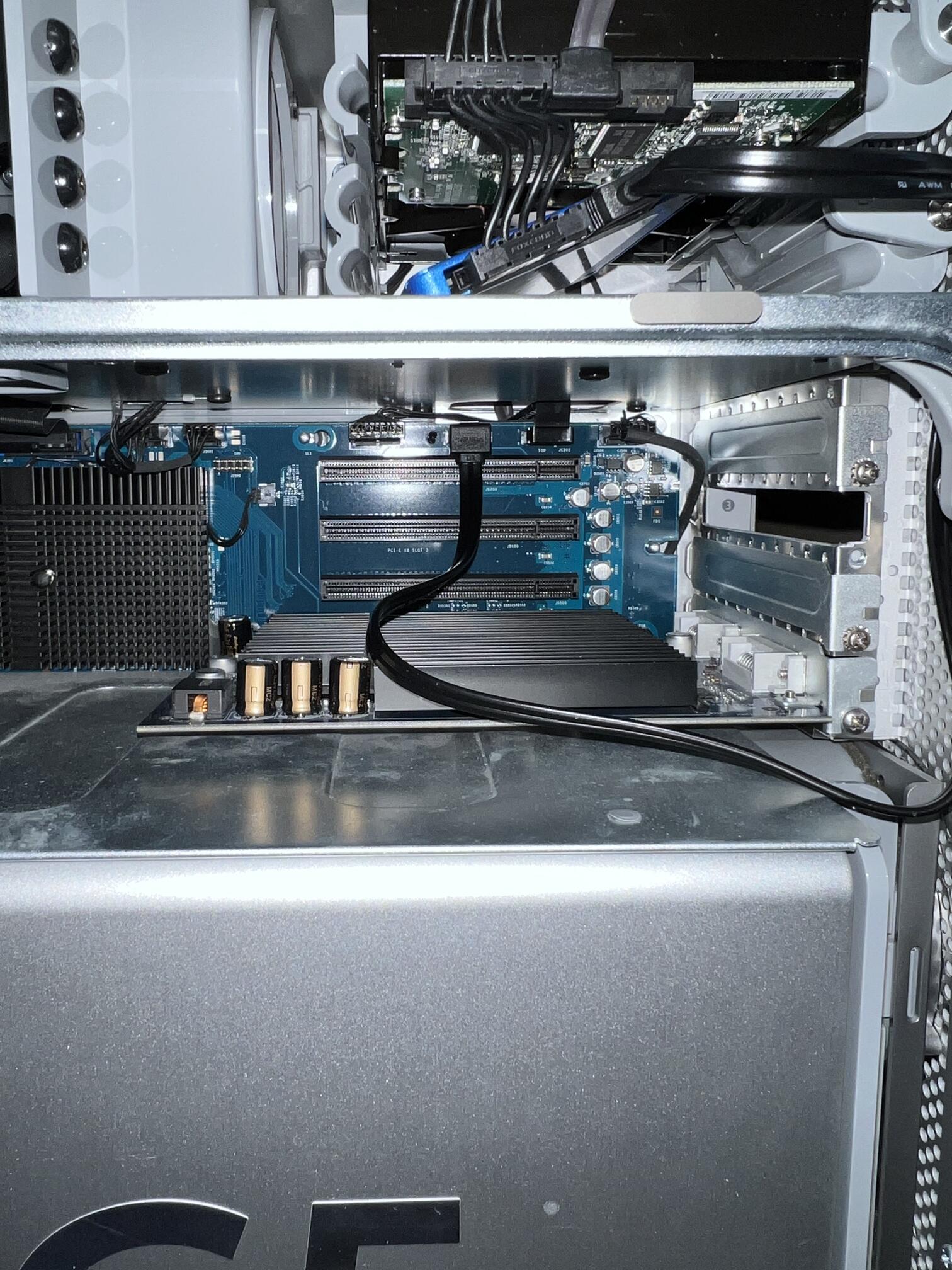

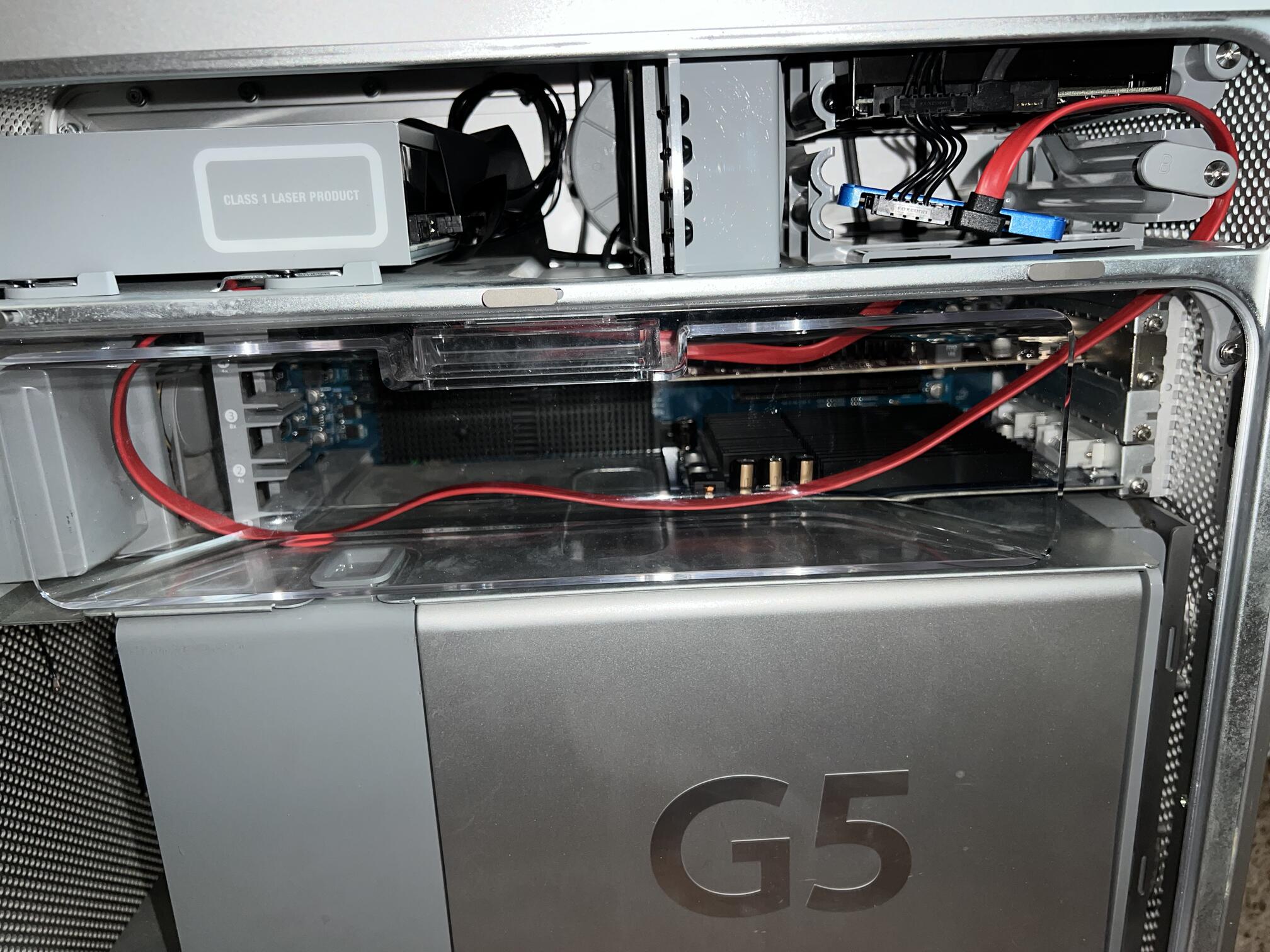

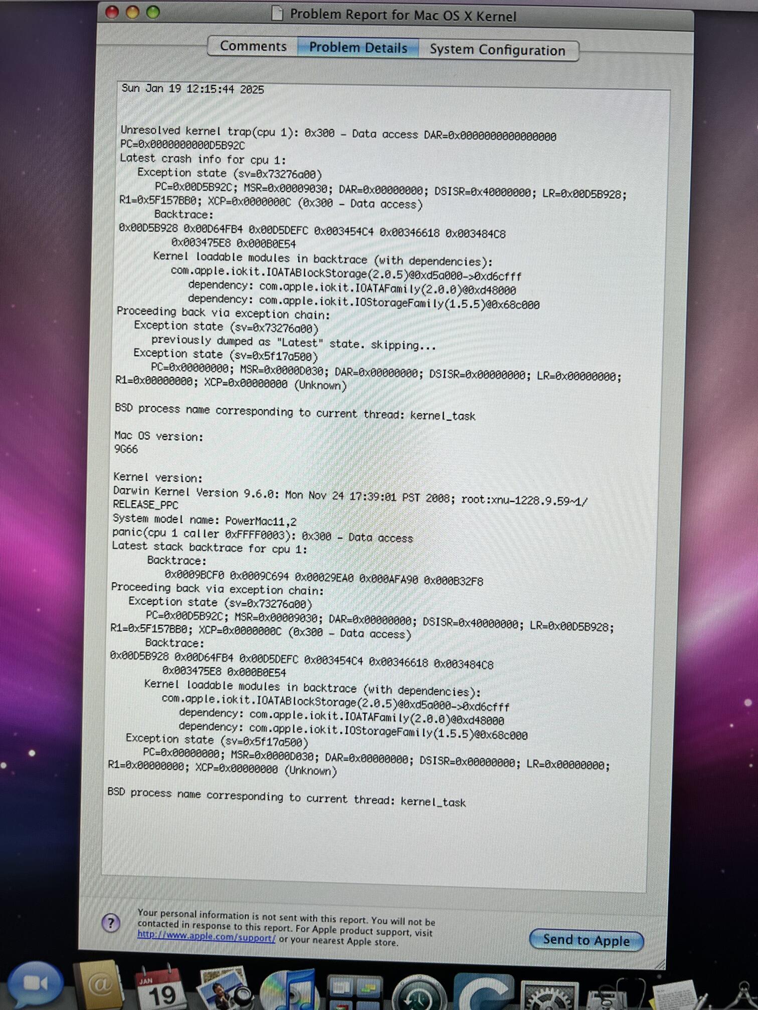

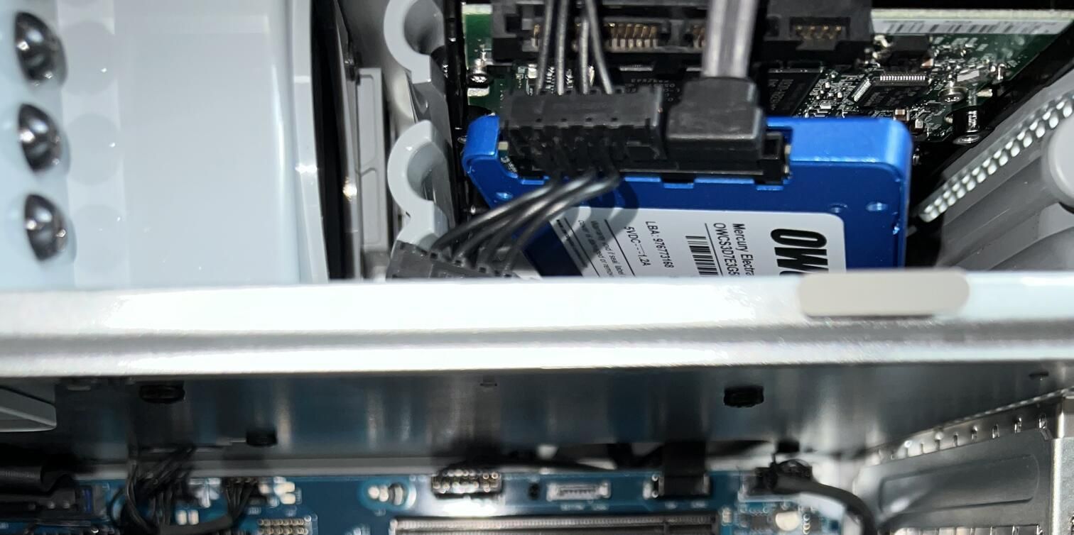

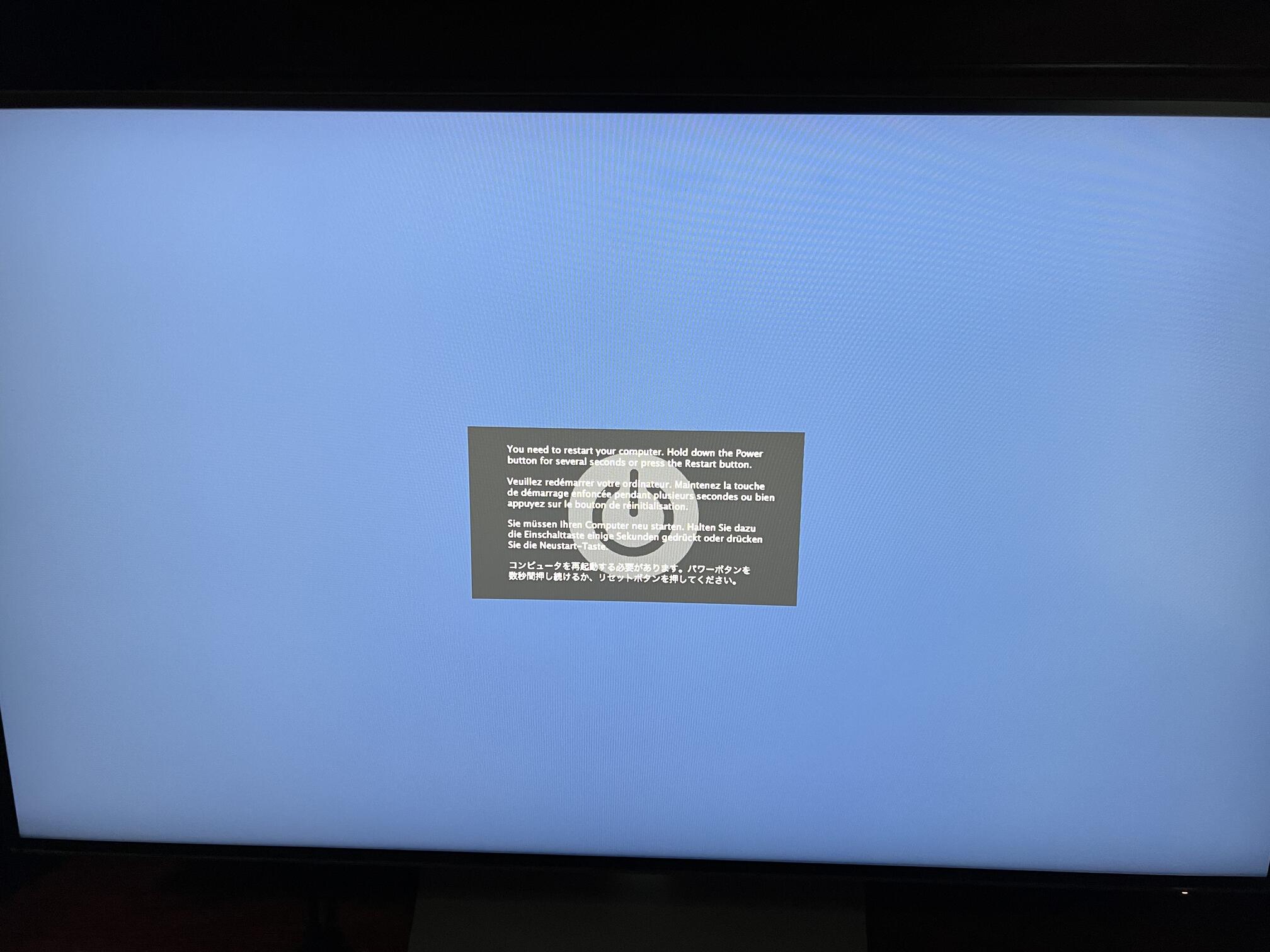

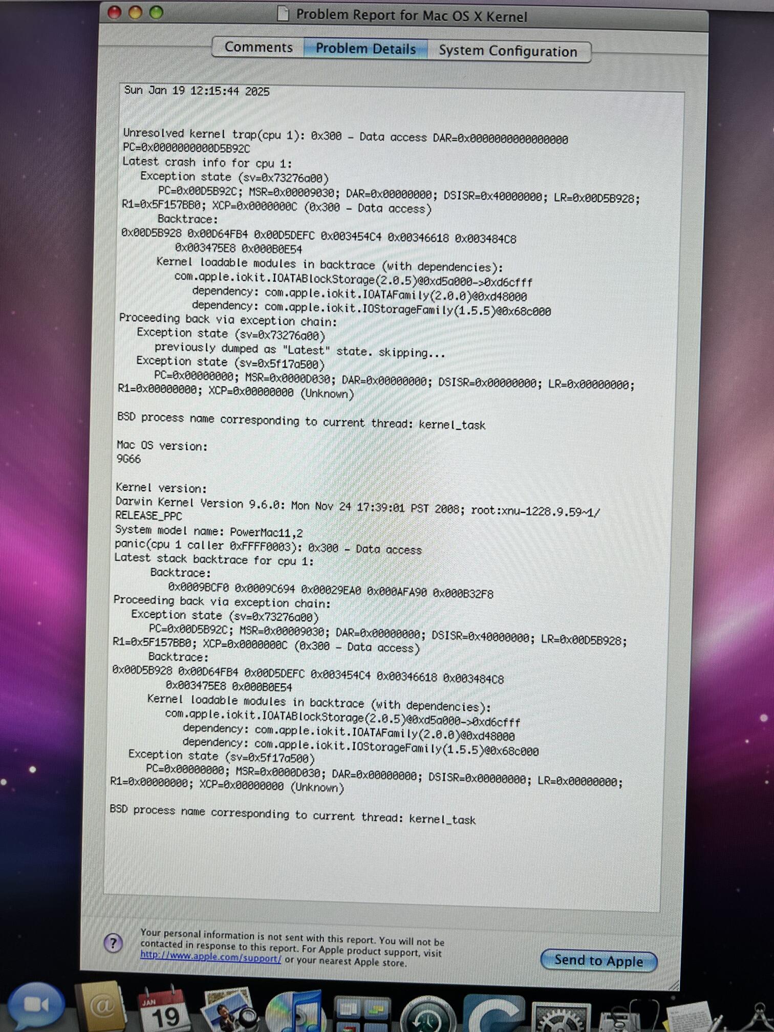

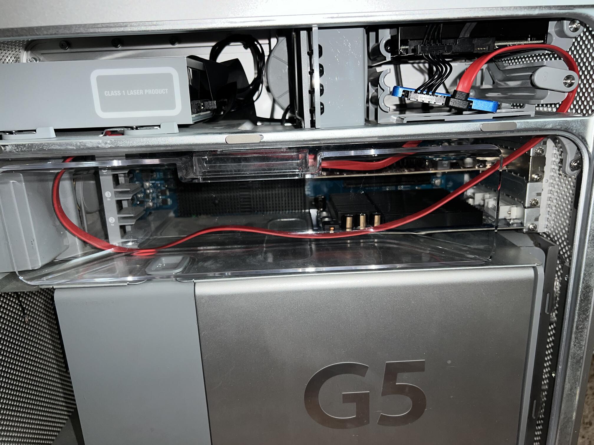

FELLAS, I NEED YOUR HELP​
Alright, so one of the two SATA data cables I ordered has arrived. I know it's quite long and it looks humorous at this length, but I think this was the shortest they had available.
aaaaand.... I get a kernel panic
Here is what the kernel panic log shows in case anyone want sot make any sense of it:

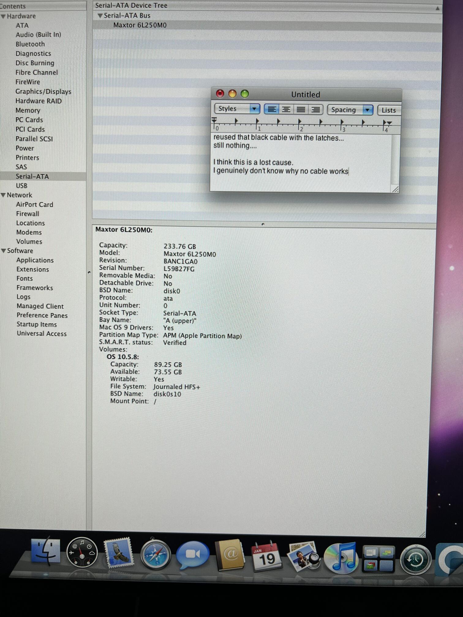

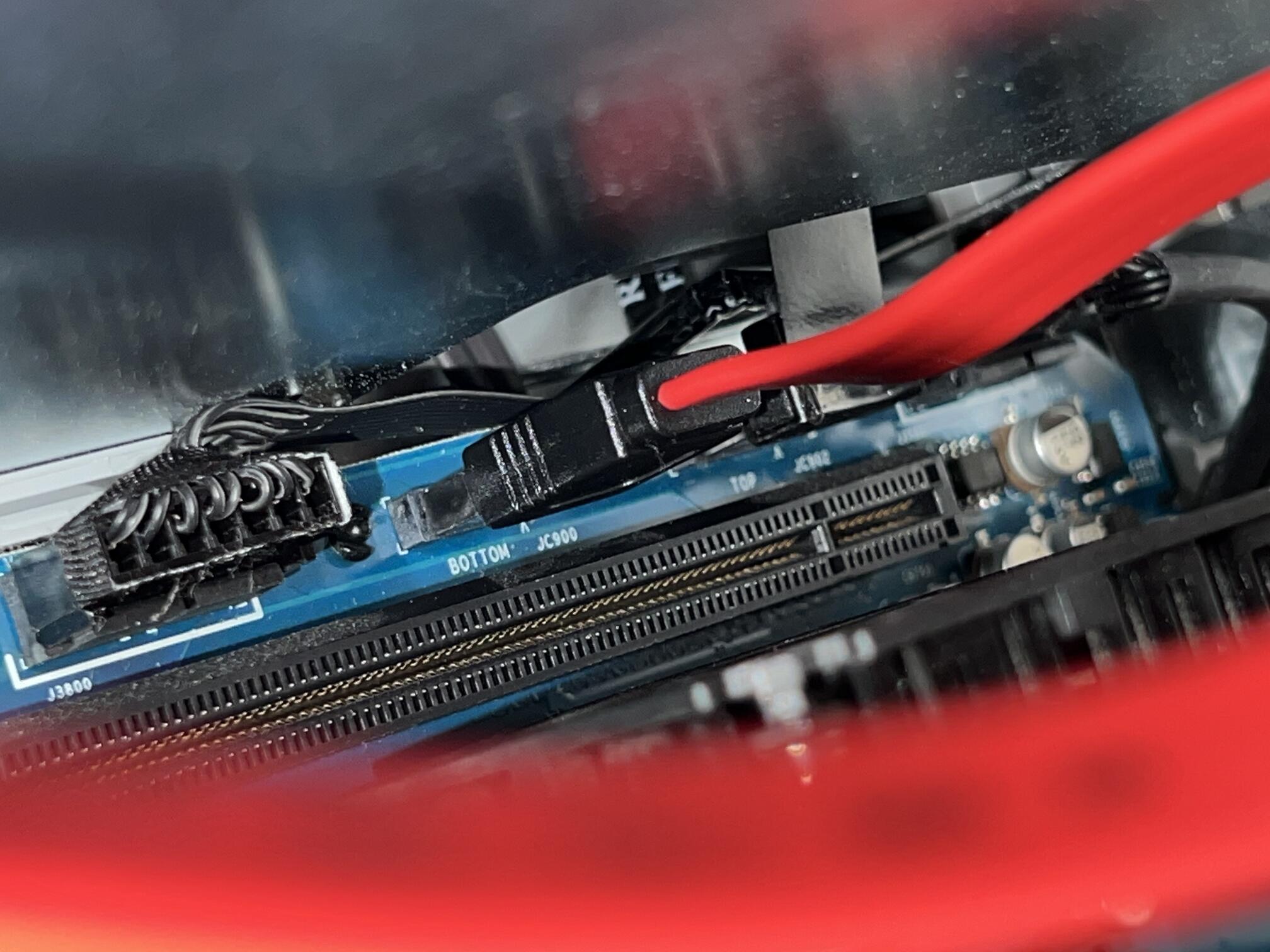

Unplugged everything. Took it apart. Checked to see if the cable is plugged in all the way even though I really shouldn't need to be doing this. Is it plugged in to the drive? Yep. Plugged in to the motherboard? Yep.
Turn it on. The SSD still doesn't exist.
I went and got the black cable with the latches from my earlier post.
I take out the cable and just plug in the SSD using the upper drive bay's power and data cables to force the PowerMac to boot into Sorbet Leopard which is cloned to the SSD using Carbon Copy Cloner as you saw in Part 3.
And that just leaves the computer on a blank screen with no Apple logo ... indefinitely... with the fans on full blast.
I'm throwing in the towel and tapping all of you into the ring. Just in case it wasn't clear what I am trying to do, here is a quick summary of my predicament and a run down of my goals:
1. The SATA data cable for the bottom drive bay is out of commission
2. I have used two cables in its place with no success
3. I want to use my Mercury Electra 3G 500GB SSD as a bootable drive with 10.5.9 "Sorbet Leopard" installed
4. The drive is recognized by the system and seen by Disk Utility only when plugged in via an external USB enclosure thus far
5. Plugging the drive into the system using the top bay's cables results in nothing booting even after cloning 10.5.9 "Sorbet Leopard" to it
I chose this SSD because of the testimonies of multiple people across various Mac forums claiming that it's basically a guarantee to work with any PowerPC Mac with a SATA connection, but I'm having the exact opposite experience with all of my troubleshooting.

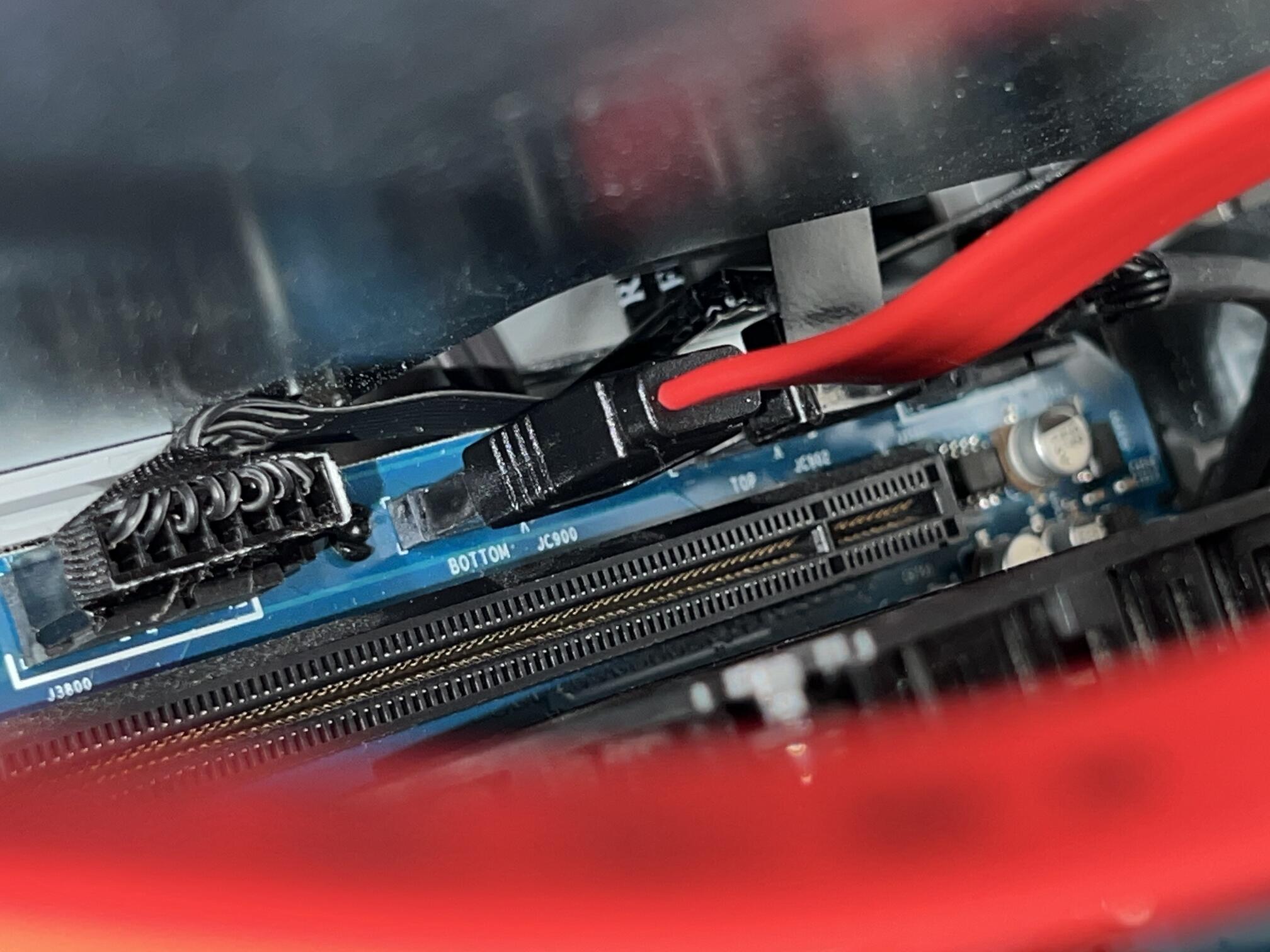

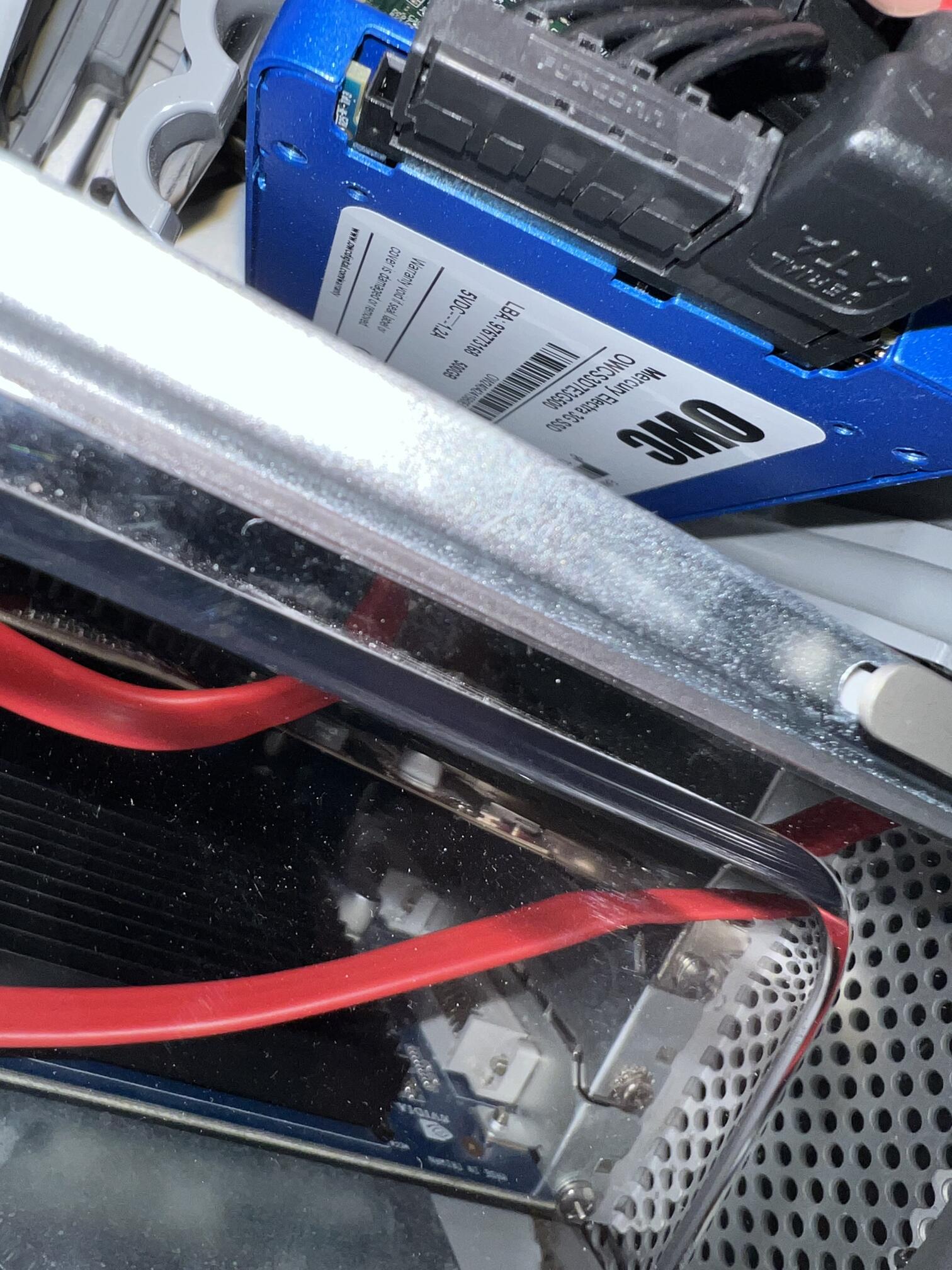

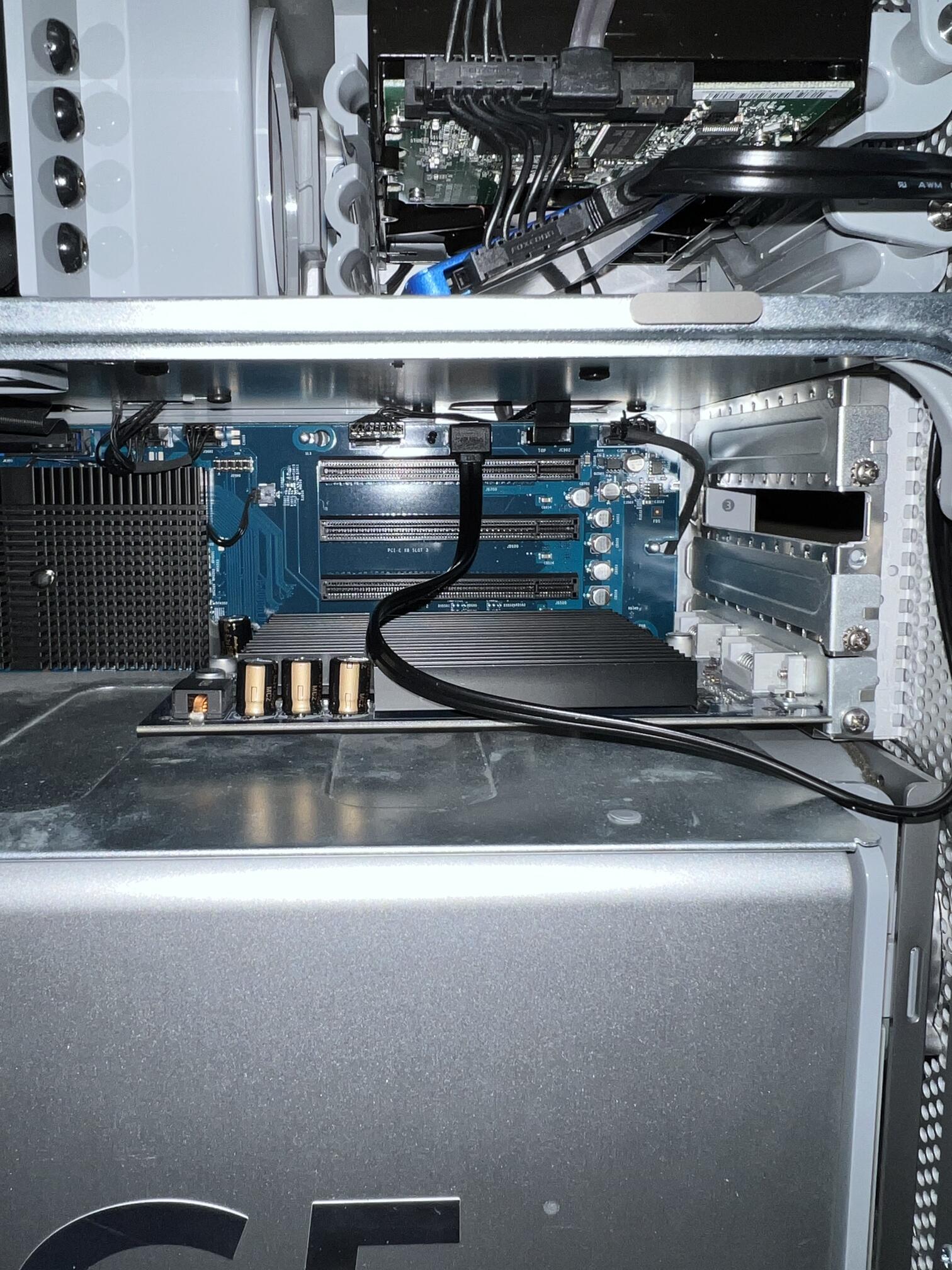

View attachment 19642View attachment 19641

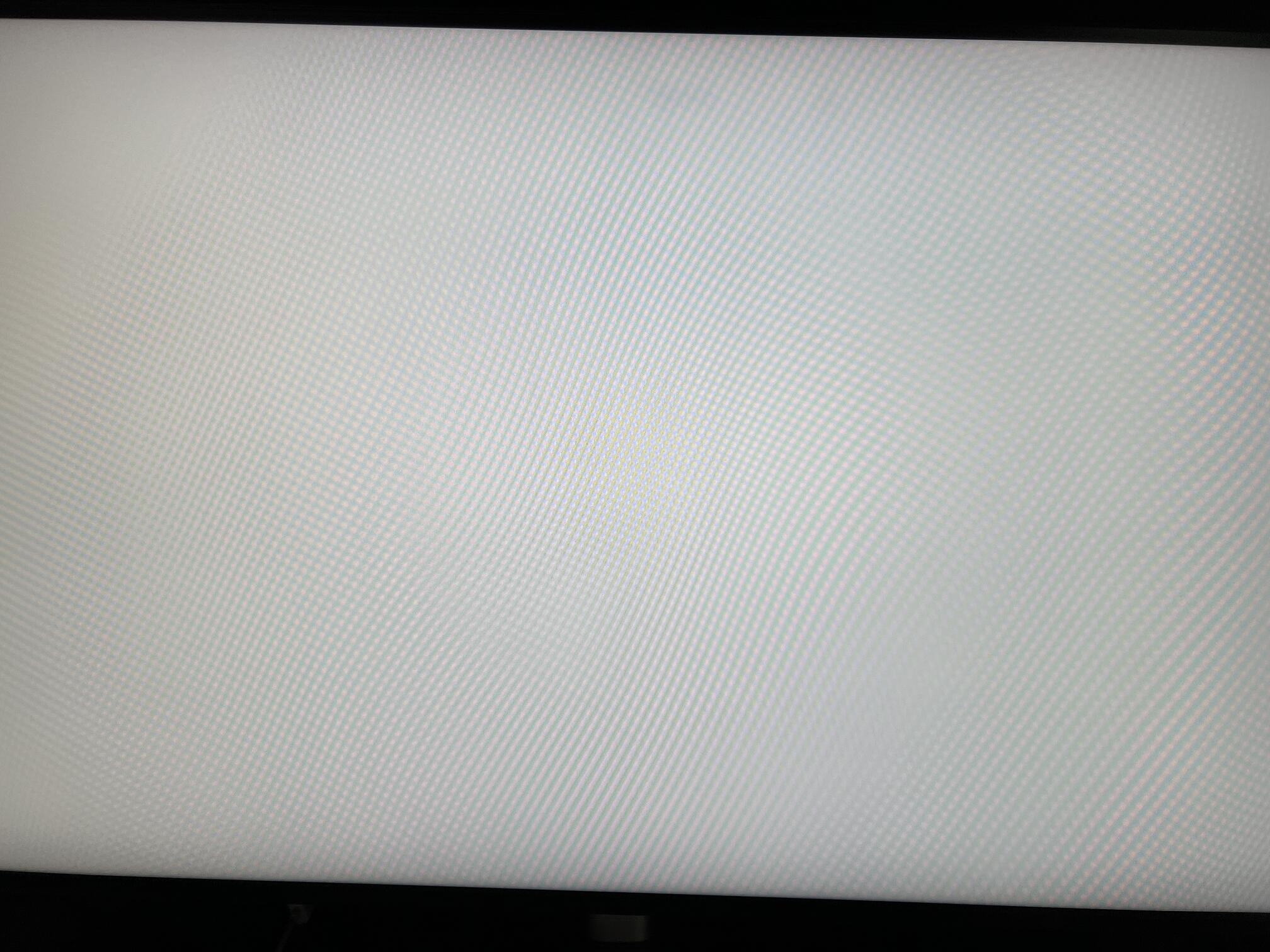

I noticed that my predicament is practically exactly the same as this individual I discovered on the 68kMLA forums here: https://68kmla.org/bb/index.php?threads/powermac-g5-wont-recognize-sata-drive.31488/. I suggest reading the short thread. The individual just ended up using a hard drive instead, which is not what I want after all this time, especially considering there originally WAS a hard drive in the second drive bay that got both it and the data cable demolished once unplugged, suggesting that it was forcefully connected or something I cannot explain. I'd like to be rewarded with a usable SSD after all this hassle. Any working solutions are appreciated.

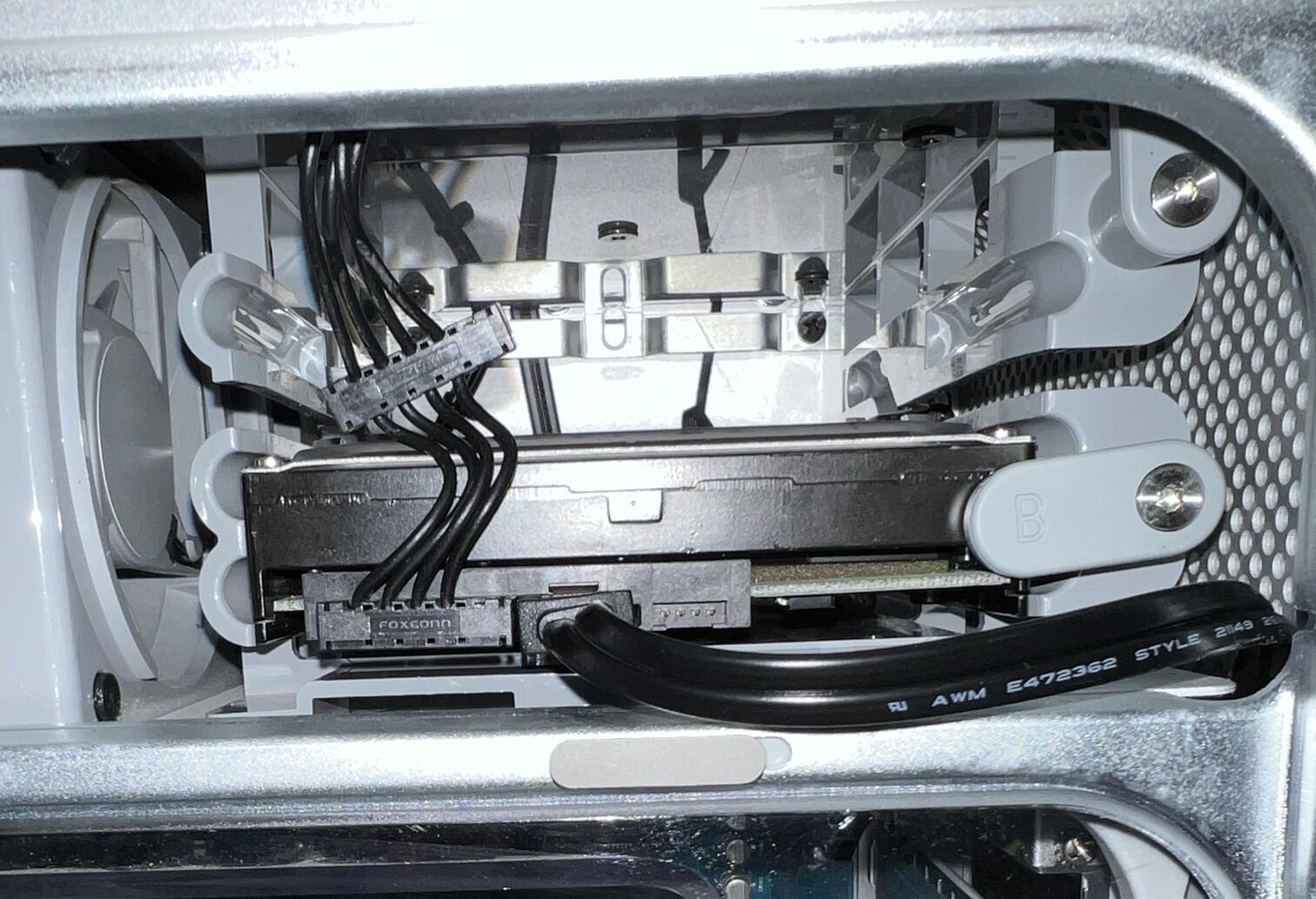

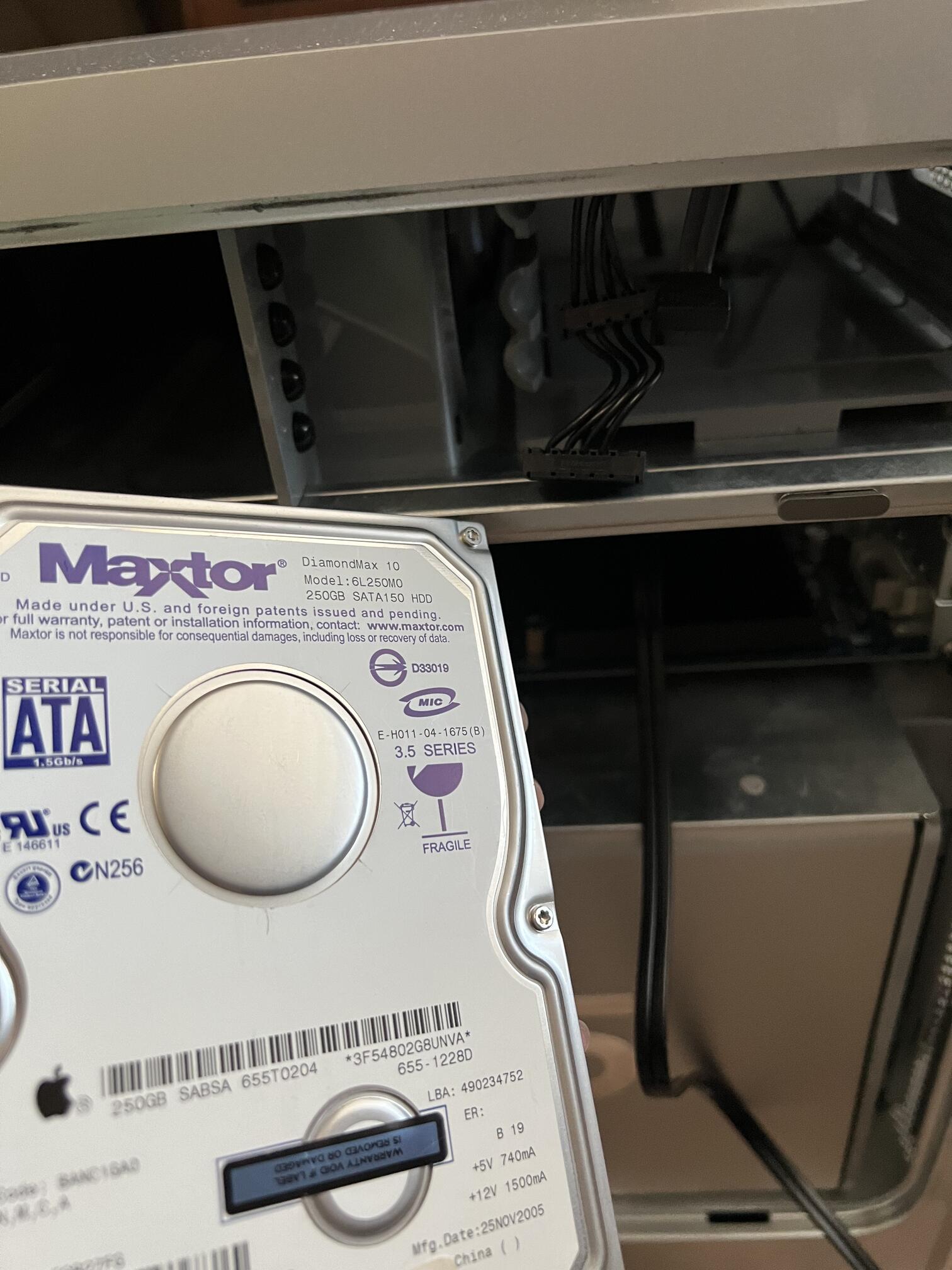

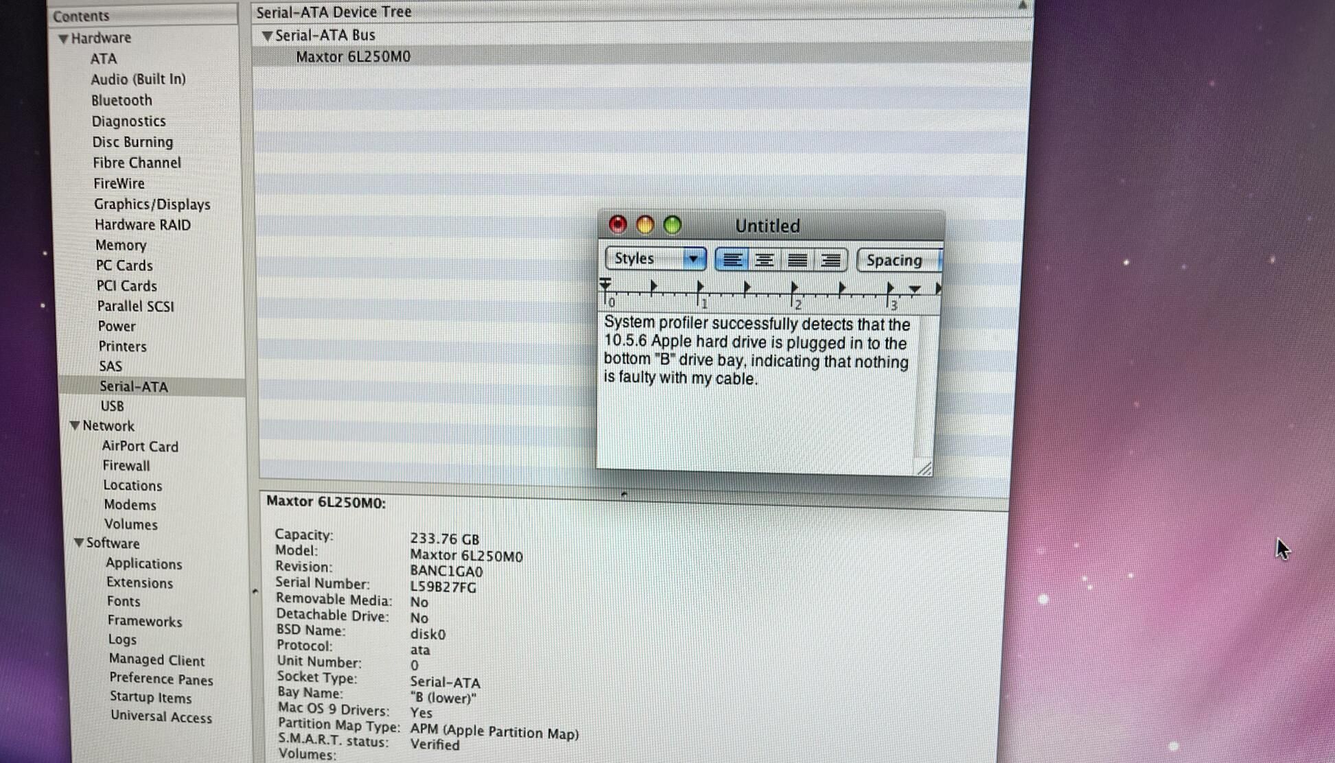

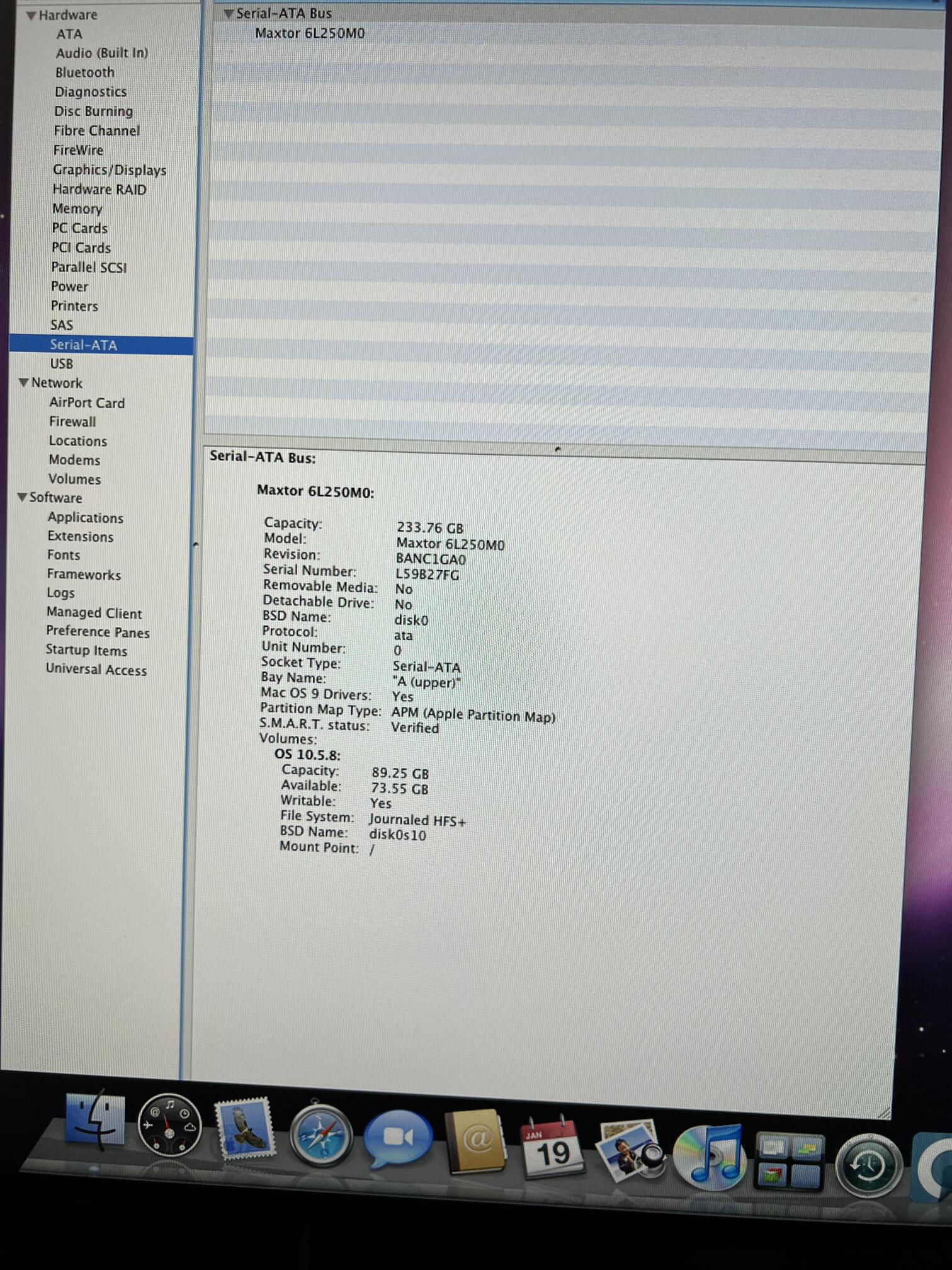

Alright... Can you still boot off the original Hard Drive in either bay (top or bottom) with any of your cables (short black or long red)? Lets just make sure there are not some other system issues other than the SSD drive at this point.
iBookSpeedster88
Jan 1, 2024

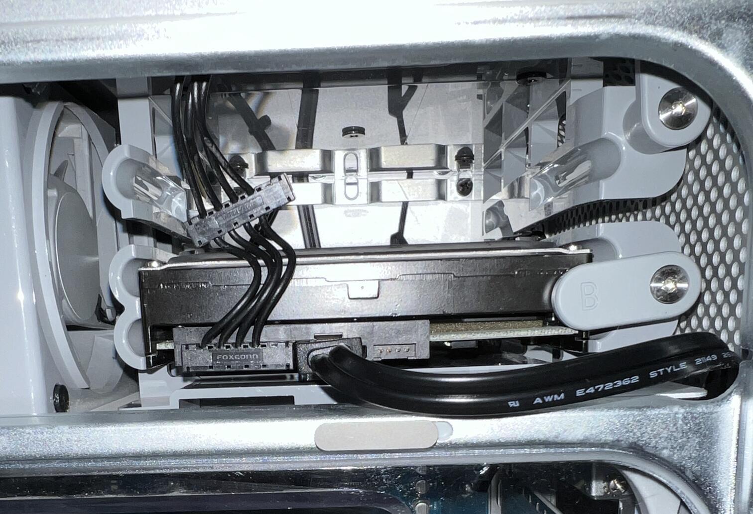

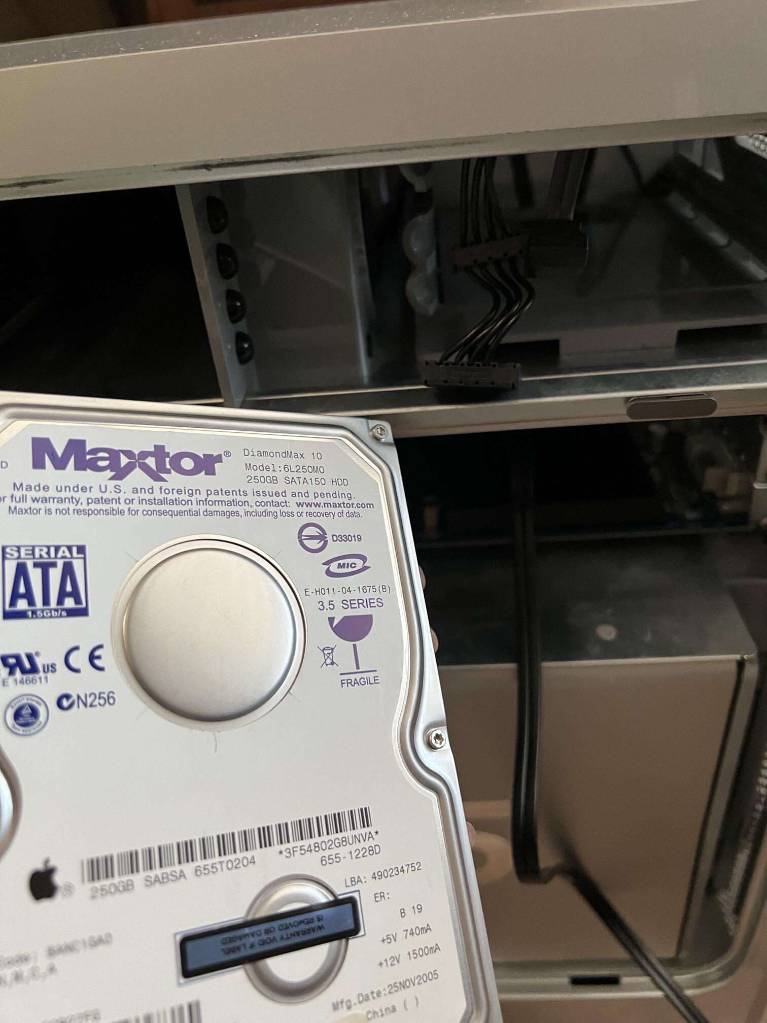

Let's try it.
Hard drive out:
Hard drive in:

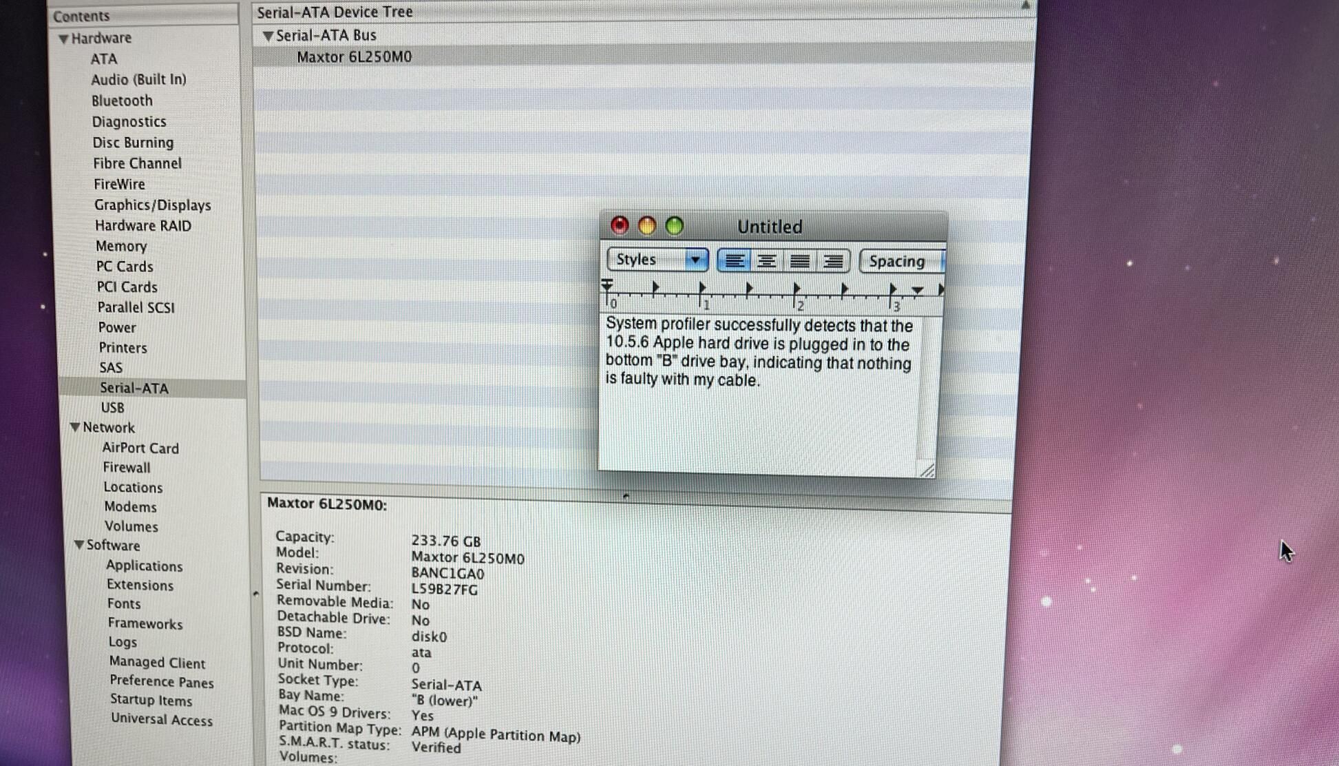

PowerMac G5 recognizes the drive and safely boots into 10.5.6 Leopard. System Profiler shows the hard drive is plugged in to the bottom drive "B" with no issues:
same SSD I'm using in my 1.6 iMac G5... really not sure why it wouldn't work?
That's why I continued under the assumption that my cables were at fault and not the SSD since I purchased it with its reputation as being guaranteed compatible with PowerPC G5 Macs. Yet, the drive mustn't be at fault either considering it was properly recognized and formatted when plugged in to the PowerMac externally inside of a USB enclosure!
994
696
I'm curious if you spun up a burned Leopard or Tiger cd/dvd and tried to install a fresh copy of either OS on the SSD via sata, if DU would see it and install to it sans usb. Anyhow, I'd verify disk health in DU to understand the health of the ssd or something like Crystal Disk if you have Windows machine. In my mind it's pointing to the disk. You know its not the data cable or the power cable and you know its not the port on the logic board as the spinner was recognized and booted right up to a functional desktop.
I have had new SSDs of the same make and model where one that is an older revision works w/o issue and another that is a slightly newer revision not show up or work in any capacity in my Powermac G5s (sata3) with updated bits inside. I could see that since it is a new SSD (and not new old stock necessarily) that a similar situation is in play here - folks over the years using an older revision of this branded drive with great results and here you are with a current newer revision of the same branded drive having issues - some new componentry has been introduced into the SSD limiting that purported reverse compatibility with old sata1 macs.
Have you reached out to the SSD manufacturer? Have they recommended anything?

Let's try it.
Hard drive out:
Hard drive in:
The external USB case has a converter/controller in it that converts the SATA to USB. Put the SSD back in the USB external and see if its recognized. If it is not recognized, I call bad SSD. If it is recognized, I have no reason to explain why it does not work.
The only obscure thing that might be a faint possibility is the 3.3v rail. The PowerMac G5 has the 12V, GND, 5V rails on the power cable, but no 3.3V rail. It may be possible that this specific SSD requires the 3.3v rail. Does your external USB case have that 5th wire for 3.3V on the power plug? Some drives may generate their own internal 3.3V if needed, not sure on this SSD.
SATA power plug pinout and Old Tom's Hardware discussion

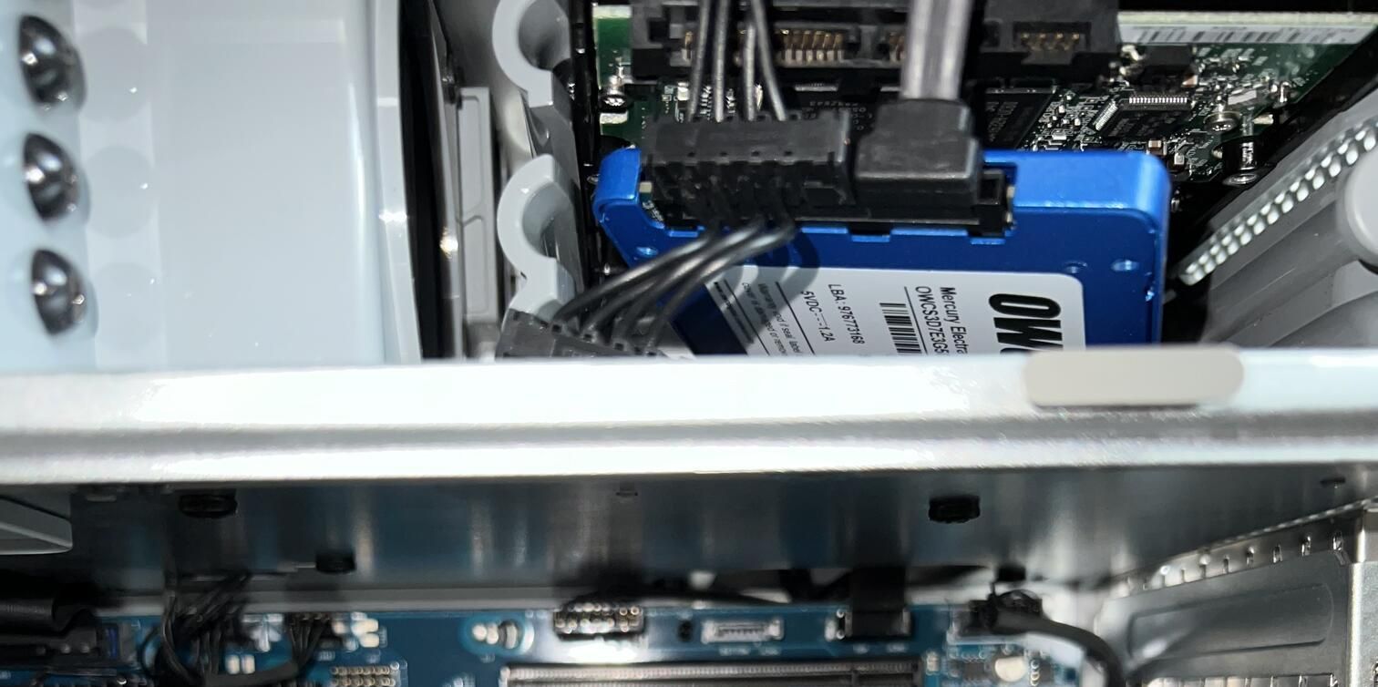

I performed another test by plugging in the SSD to the top drive bay, leaving the Apple hard drive in the bottom bay now knowing that my cable is not an issue. No modifications taken to the current setup. Turned on the PowerMac G5 and I am returned to the blank white screen with no Apple logo. That's interesting. If there was no bootable OS installed to the SSD, shouldn't I be taken to 10.5.6 Leopard which is installed on the Apple hard drive? So, the upper drive bay takes precedence in the boot order, it seems.
Here are the results with this in mind:
1. SSD plugged in to bottom bay "B", hard drive plugged in to upper bay "A"
RESULT: 10.5.6 Leopard boots and the SSD is not mounted nor recognized
2. SSD plugged in to upper bay "A", hard drive plugged in to bottom bay "B"
RESULT: nothing boots and the blank white screen sans Apple logo appears indefinitely
3. SSD is the ONLY drive plugged in regardless of which bay it is plugged in to
