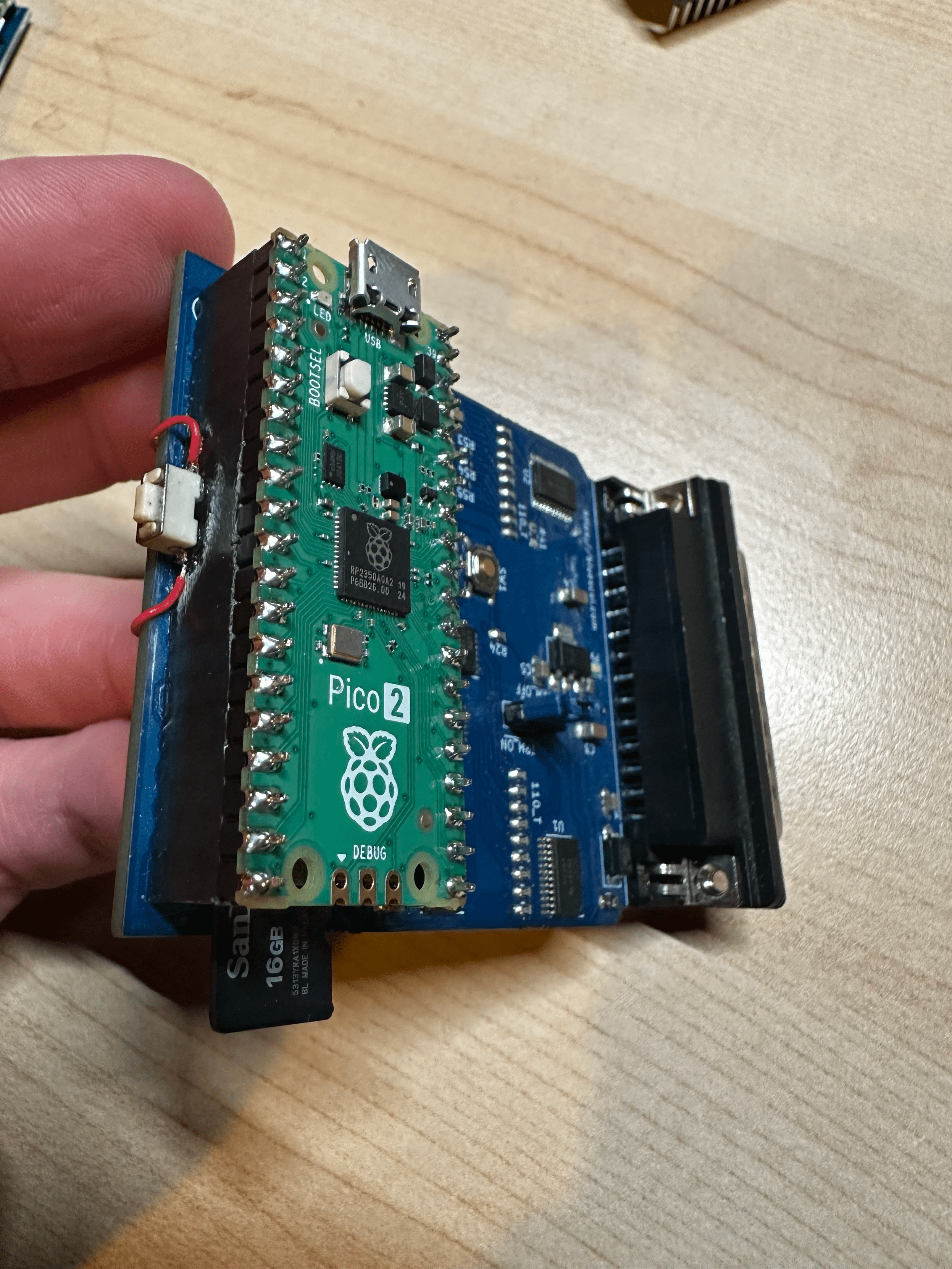

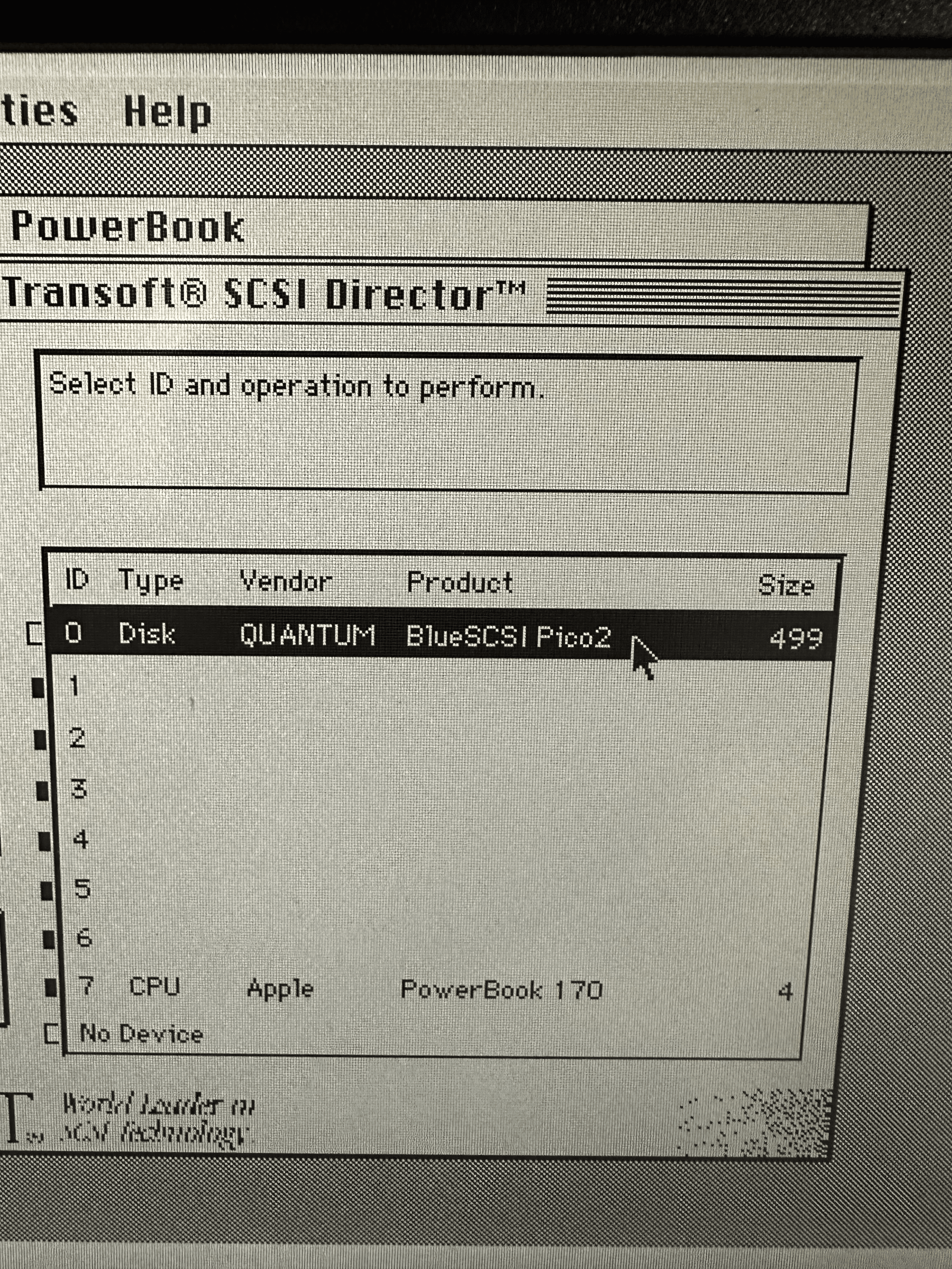

This afternoon I got BlueSCSI v2 working on the new Pico2 dev board - still work to do yet and using pretty rough around the edges stuff in the framework, but hey, it boots!
(Red wires/switch is so I can flash the pico without having to unplugging it each time)

This afternoon I got BlueSCSI v2 working on the new Pico2 dev board...
I see from the Pico2 product page, it offers "a higher core clock speed, double the memory, more powerful Arm cores, optional RISC‑V cores, new security features, and upgraded interfacing capabilities," plus it is backward compatible.
I assume that to the end user, a BSv2 using a Pico2 would operate no differently (performance, WIFI, general features, etc.) than our existing Pico-1 products, correct?

Pico 2 uses a new chip, the RP2350A. It has twice the working RAM as its predecessor, and also twice the program storage (this is on an external chip, but 2x is 2x). Overall it will allow for more features, some of which will have to be Pico2-only due to RAM and storage restrictions on the original Pico.
View attachment 17589View attachment 17590
Doing testing with patches to address the timing issues applied - no real surprise here as no other code has changed - slight bump in write. Code will be on github tonight or tomorrow under the existing pico2 branch.
