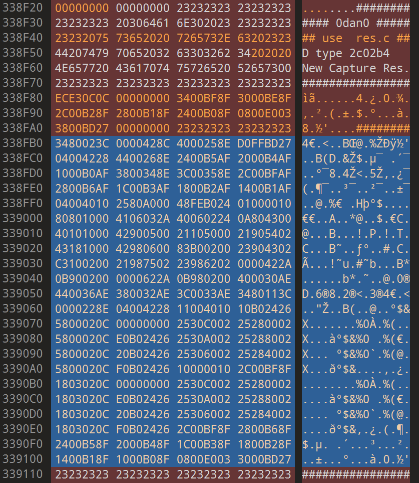

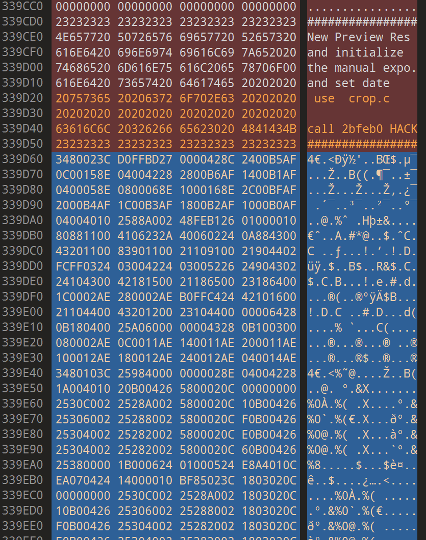

in the rbn, search on res.c and crop.c
This is where the res.c binary goes (bytes in blue.)
This where crop.c binary goes:

the crash is within the memory space of where I'm inserting the res.c binary. I've done the typical removal of ELF headers, etc that I've done with your other C++ mods.

The last version you showed was working, what did you change. Can I see the .rbn?

@0dan0 , this is my latest version with just consoleD calls. No crash in this version, but still freezes. Which memory address did you use as a hook to call this code?
