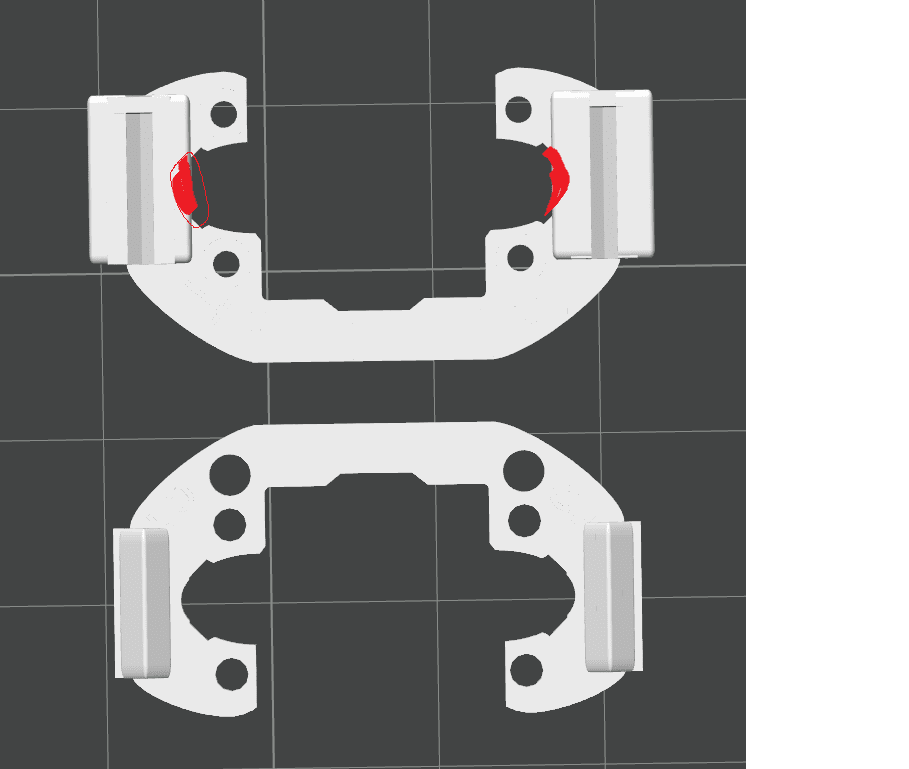

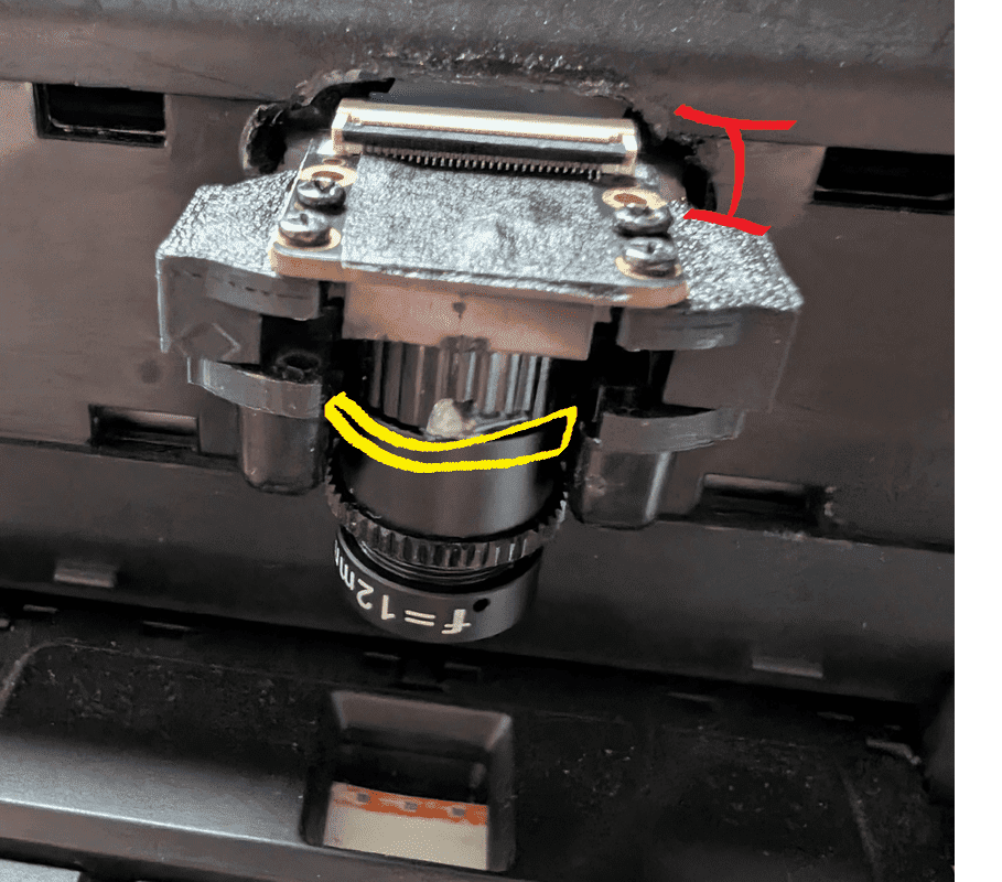

Do you have any tips on focusing the lens? On my 1st unit the metal 7mm adapter took dozens of tries to thread in, and then it still only threaded about halfway in. With the spacer/model set provided, I cannot get it to focus with the 12mm nor the 16mm lens (from the USA source). I have to lift the piece way up to get any sense of focus. E.g. the yellow part is the spacing gap I have from screwing in and the red bars are the approximate height I have to lift the camera board to get focusing. (I also need to upgrade firmware from five or so months ago's version.)
Has anyone tried swapping the camera mount for one of these? Might be easier than having the extra lens ring extension?
Lastly, a suggestion on the camera mounts, on my unit the camera bracket rubs the standoff bracket piece it mounts to. Mainly from the box-and-ears shape for clearance is overhung by the dovetail joint receptacle on that piece. If you make another revision, it would be good to make that cut through all parts, not just the thin plate part.
That doesn't appear to be the correct lens, it must be:
Azure Photonics AZURE-1228MAC 2/3" 12mm F2.8​
A generic 12mm M12 will not work, not any 16mm lenses that I have found. That lens has a different font, and hole not present on any of my AZURE-1228MAC lenses.

And these were purchased from RMA? The correct lens will focus if that 7mm extension can sit flush against the lens mount. The 3D print now has three standoff heights, and I have found the lowest standoff height is the easiest. Yet you have to mount your sensor board significantly higher, which makes it feel as if this not the same lens.

Yes they were. I will try the lowest shim to focus with and also those reduced iris lens caps. I can't get the 7mm extension to sit flush but I'll have to try some more. Getting that extension to screw in is the hardest/longest part of this mod, and that includes opening the case to cut the hole!

Don't use iris lens caps, as that introduces vignetting.
The issue is the plastic camera mount, the thread is too easily messed up, I had trouble with it too. Maybe on my next unit, I will print my own extension tube in TPU, soft enough to thread the lens onto, fill customizable length.

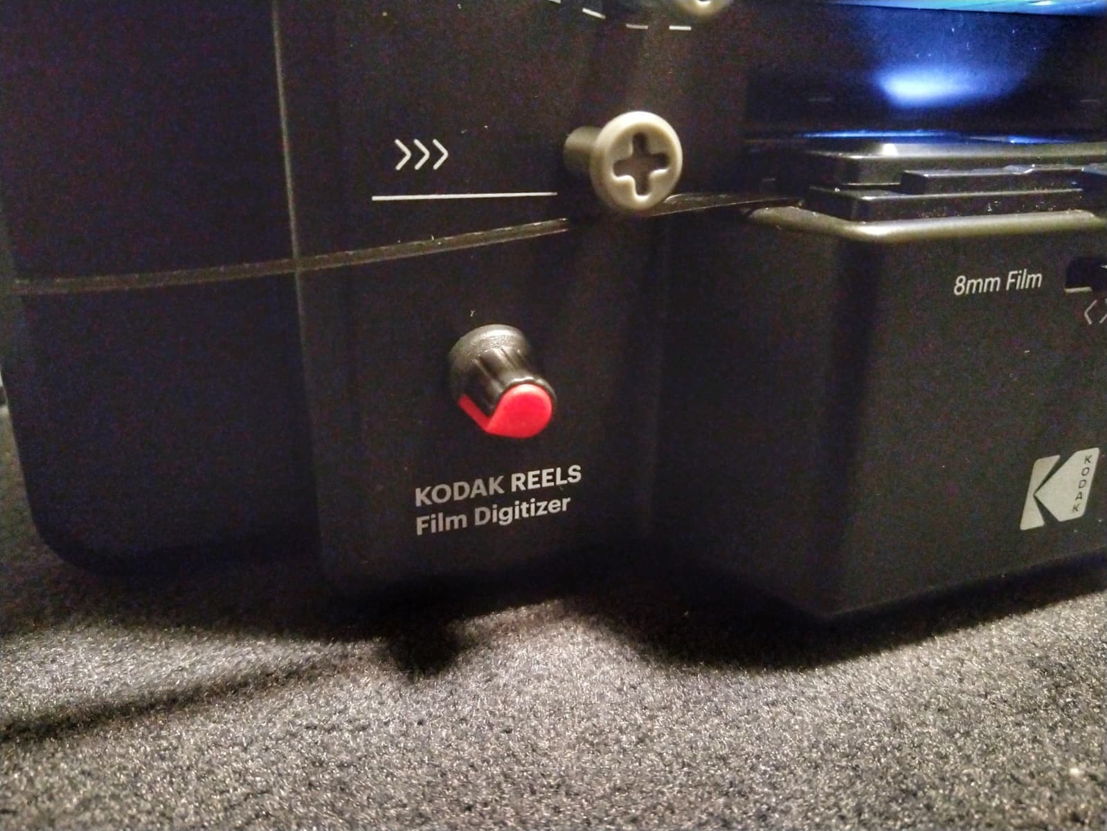

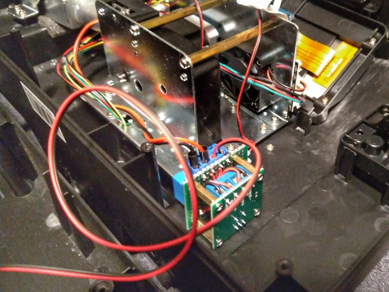

hi everyone,
after flashing the overwhelmingly awesome modded firmware,
I came up with a hardware-modification on my european Reels (B),
I felt might be worth sharing with you.
It helped me get rid of the jittery captures I had on some movies.
The pickup-reel moved too fast in my opinion, so I added a speed-control.
This enables me now to slow down the the pickup and therewith the
force with which it was pulling the movie through the scanner.
maybe there's also the benefit of the plastic-pegs not scratching
the filmstrip anymore, as it isn't pulled over them as hard as before.
if you are interested, I would be happy to share more details about this.
greetings from southern germany,
Chris :)

hi everyone,
Chris :)
It is possible that some of the jitter can come for the film being pulled too hard, however not all, as it can happen with no pulling reel attached. There is a firmware issue in the original, as it happens in stock unit too. I have some potential leads on next steps in firmware.
