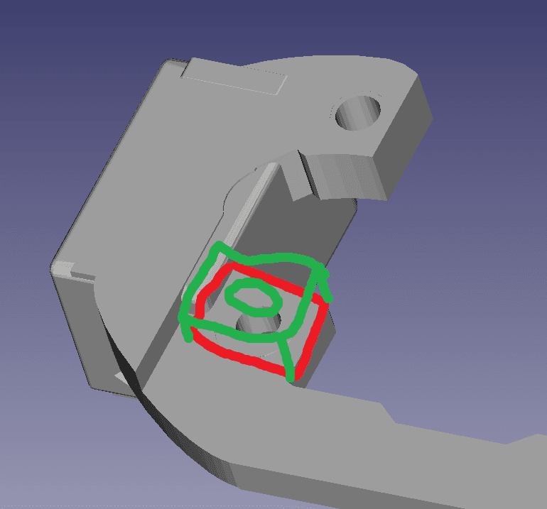

It took me a minute to realize what was going on, that's the front and back view of the knob that is some sort of speed control. I was looking at it and thinking why's there a spare reel holder on your unit.
Dumb mistake on my part. I made the channel between the two walls of this design too narrow for the film to pass through. It's been resolved and updated as a v2 part in my original post.
Probably not easy or useful, but the other one, the one that drops in from the top, it would be useful to have keying on it since it's so almost just a square it's easy to install the wrong way.

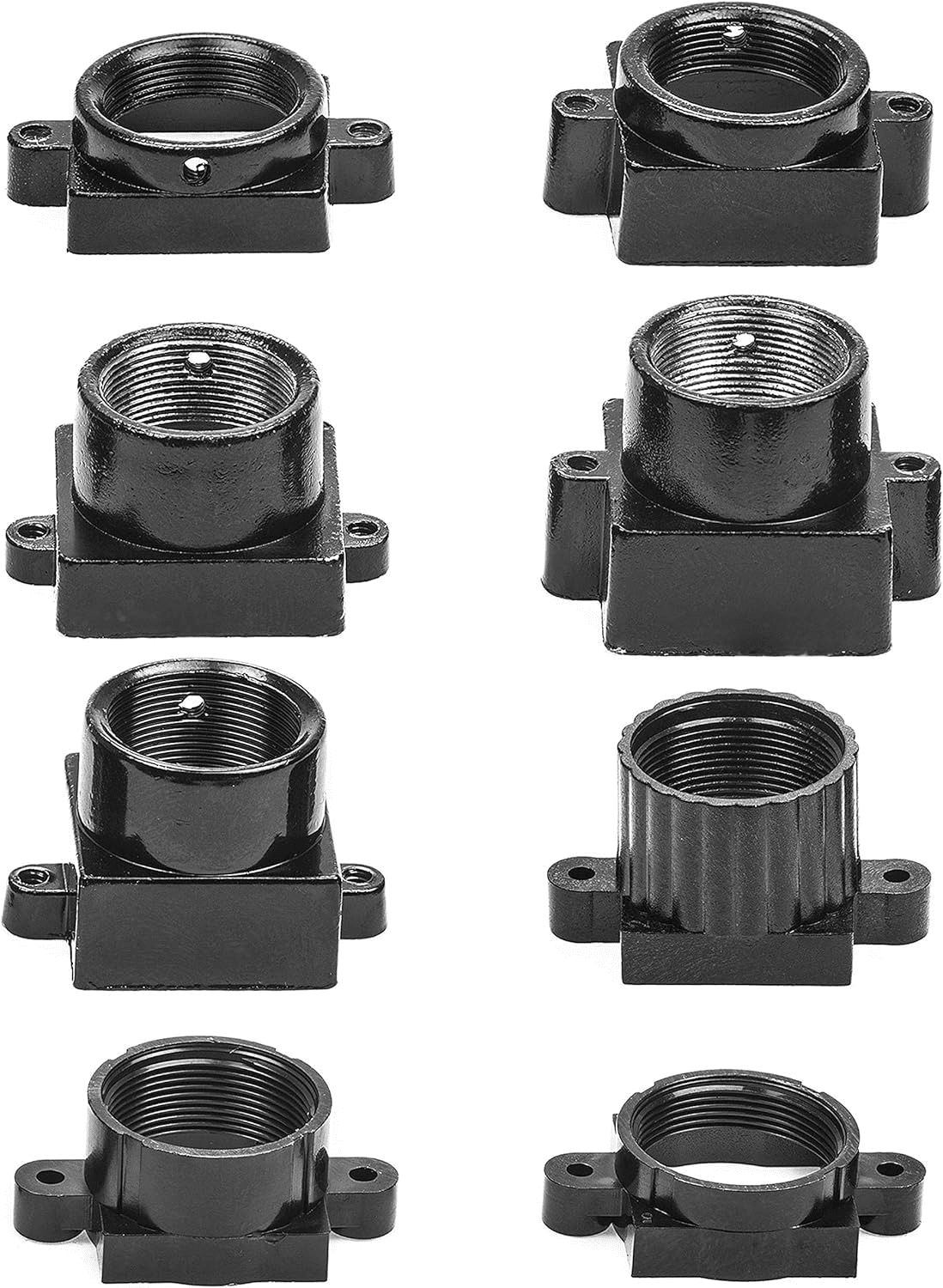

Don't use iris lens caps, as that introduces vignetting.
The issue is the plastic camera mount, the thread is too easily messed up, I had trouble with it too. Maybe on my next unit, I will print my own extension tube in TPU, soft enough to thread the lens onto, fill customizable length.
OK didn't realize they weren't good to use, seems like some people had success with them.
I did order that pack of lens mounts from Amazon and might try switching mine out. You're right about the threads, it's like they were never intended to be used once the original lens was removed. It feels like the plastic "shrinks" some from the molding and makes it harder to go in like a taper. But could just be bad threads. Looks like I got some dust on the sensor too in the process :( minor cloudy/dark spots on my preview images. Also ordered some micro screw kits so I can put all four screws in the lower and upper mounts going forward. After playing with the focus I see how even just a touch is enough pressure to shift the camera so making the board mount as secure as possible seems like a good idea. Ten pounds of junk drawer screws and nothing that small!

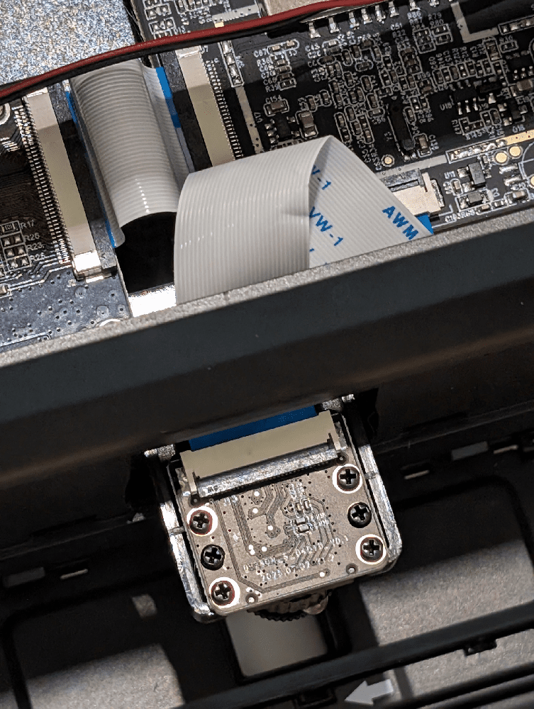

Are there any other obvious hardware changes aside from the camera board? I see the camera ribbon cable is still as awkward as ever.
I expect they had trouble sourcing AR0330 sensors (12 years old), only the sensor board is changed.

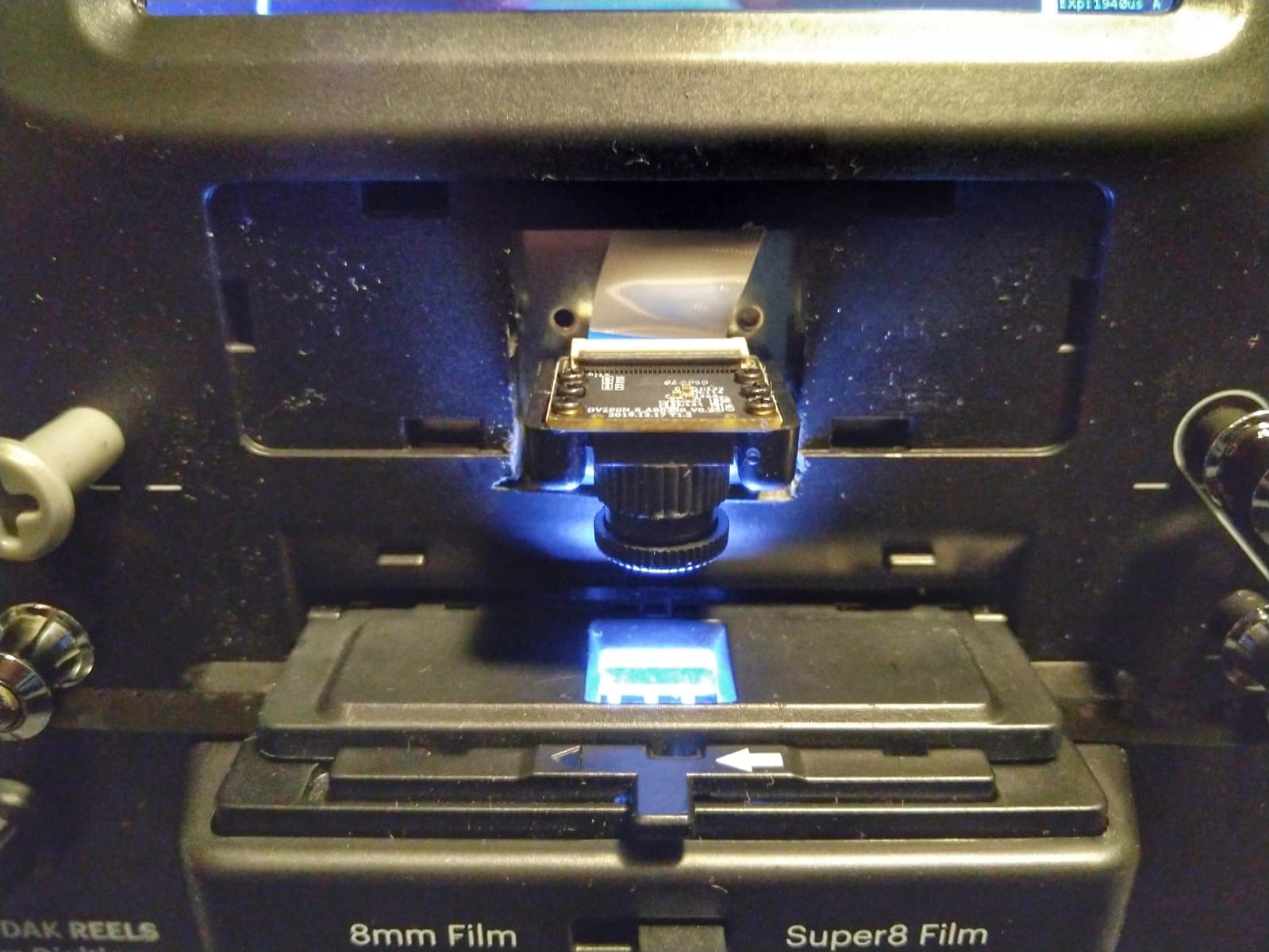

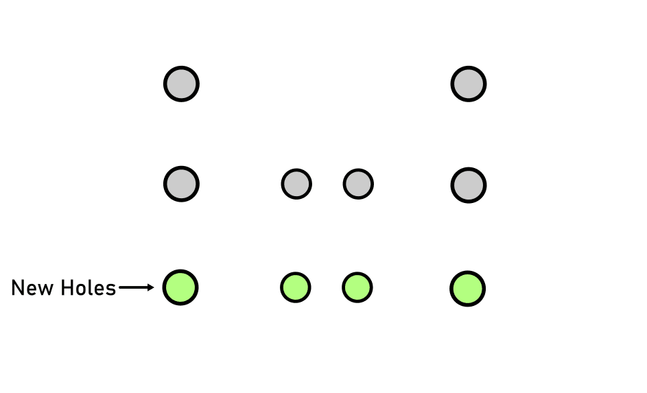

I am currently into the hardware side of things and I tried an el cheapo solution for enhancing the resolution my Kodak is getting with its stock lens.
Simply Because I didn't want to spend another 100 € for a new lens, I thought about just bringing the camera closer to the film strip.
After testing a possible distance, where I still was able to focus, I settled on 12 mm.
Which is about the distance between the screw holes of the camera mount. That way I only had to drill four new holes into the metal plate of the scanning assembly.
After remounting the camera and connecting it again (don't worry, the ribbon cable should be long enough), I could measure how much of the plastic case below it I had to cut away. (about 5 - 6 mm)
Finally I had to modify the camera cover to fit over the lower hanging lens.
The result now looks like this (cover removed for illustration purposes :) )
With everything in place I refocused the stock lens to match the new height.
Compared to the effort I had put in, I am pretty satisfied with the final result, considering both resolution and overall look of the modification.

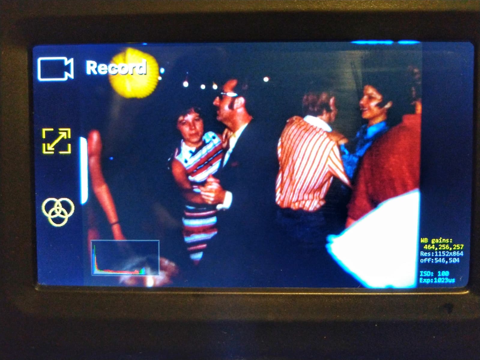

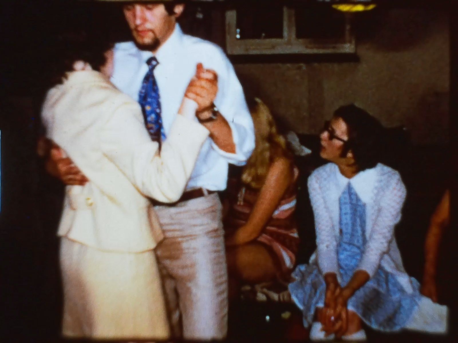

Here is a comparison of before and after - both in 1600x1200 (max zoomed out)
The effective resolution is now at 1152x864, with a small margin around the actual frame.
Here is another screenshot of the capture. Given that the actual movie isn't the highest quality, I am still happy with how it turned out

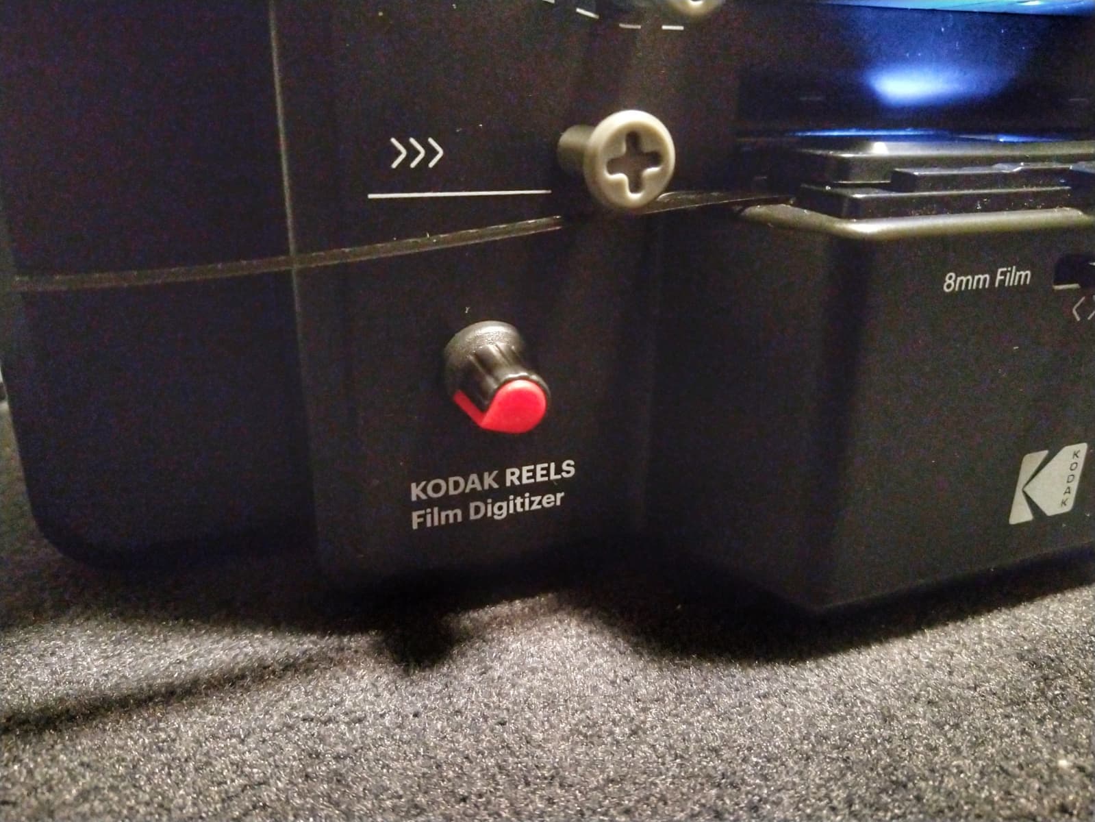

Those are sweet metal rollers for sure! They almost look like they were salvaged from an 8mm projector.
I made a post earlier this week about updating the posts to rollers. I measured the stock posts with digital calipers and got nylon washers and spacers at the local Ace Hardware, where I could test fit what they had with the stock post. I got three washers per post, two inner and one outer to fill the empty space by the nylon spacer.

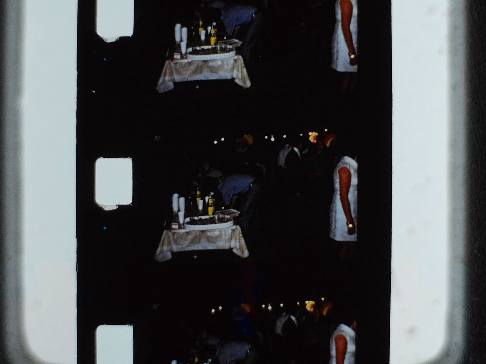

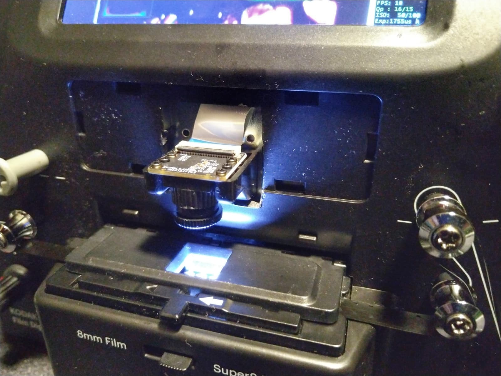

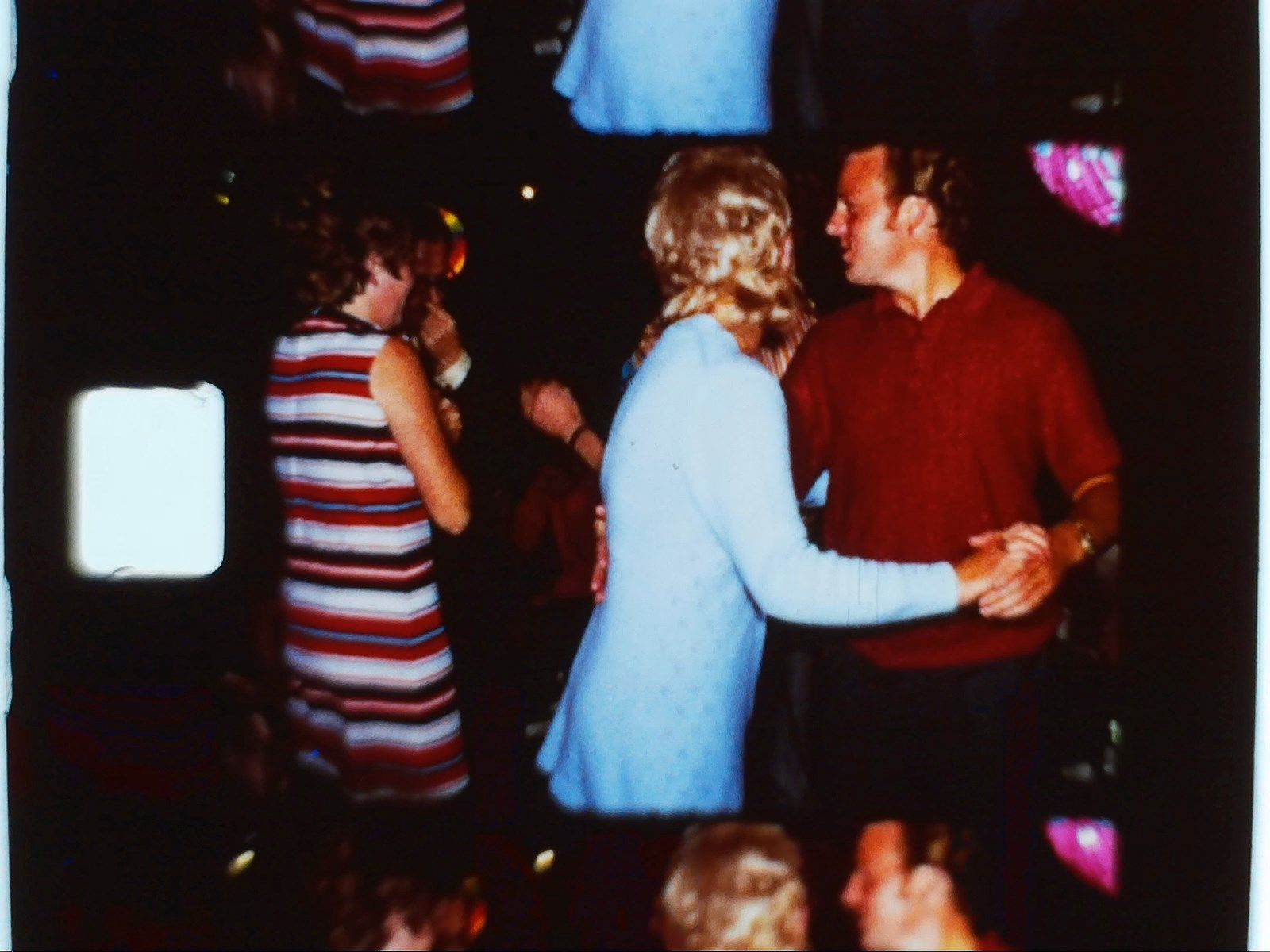

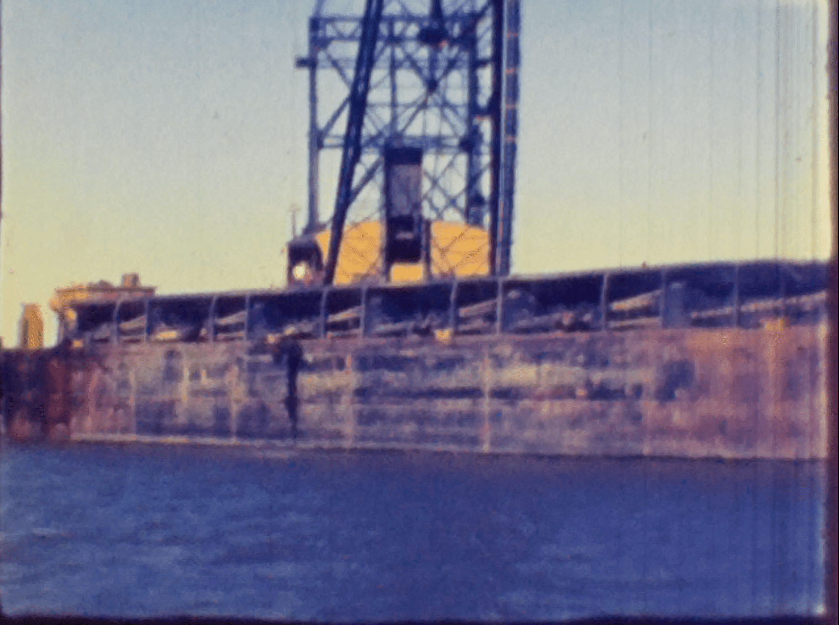

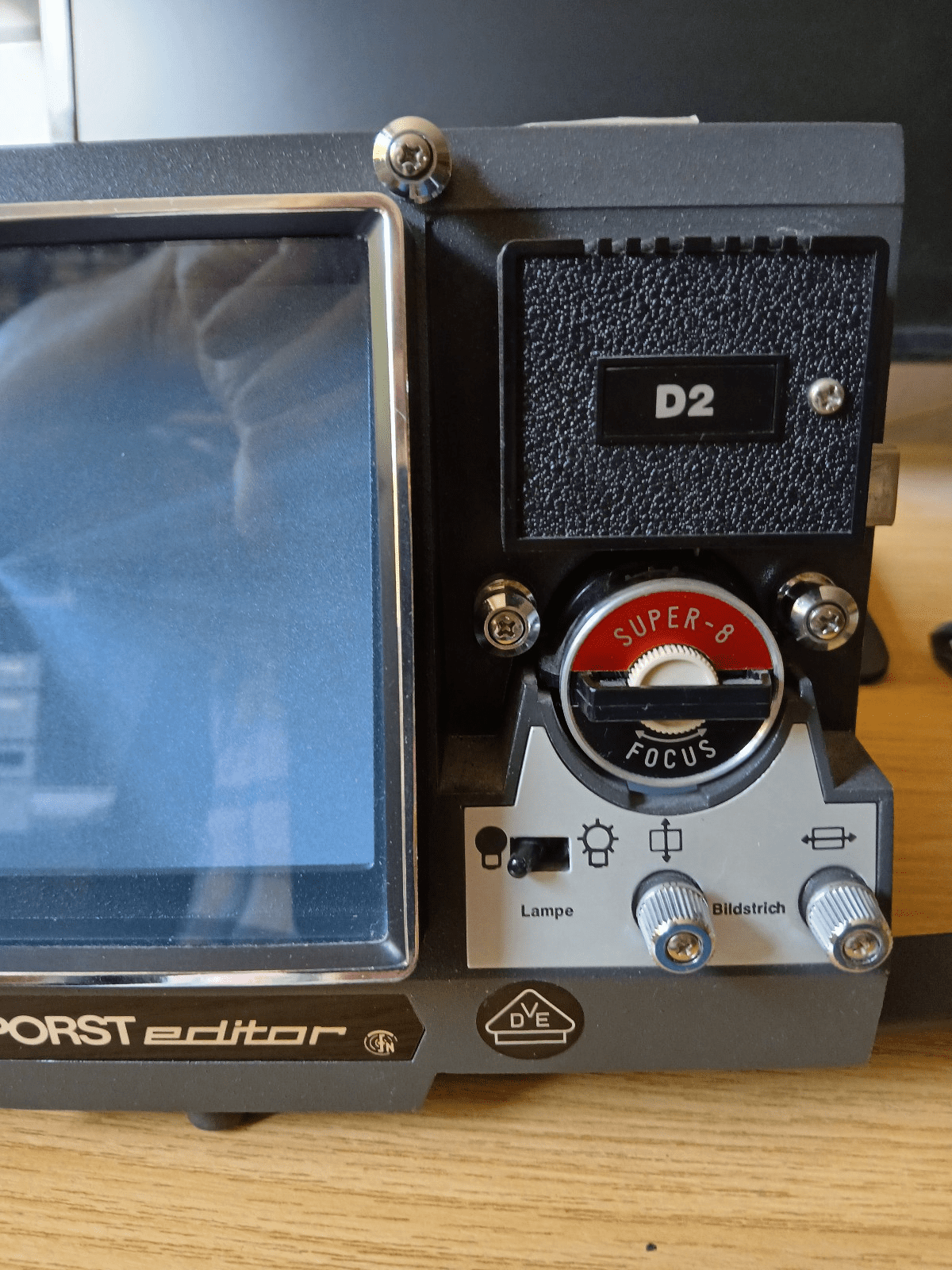

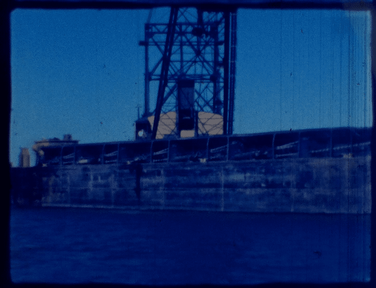

After a long long time...I finally have my C-unit modded!
I installed a new 18mm spacing M12 lens mount, plastic, and the extension screwed in all the way, as it should. Unfortunately the metal ones from this kit were 20mm spacing and the 18mm ones (that this board takes) were plastic. It did work fine though. https://www.amazon.com/dp/B07QMRDZYS? I used the mount the most similar in height to the original. That said, it'd be easier to source just the one you need in the future.
Used some extra M1.7 x 5 screws to secure both the PCB and the bracket with all four holes. Shorter screws might work, but that's the smallest the kit had. I did come across one other issue(?) as I tried to secure the board and bracket with a full eight screws, the two back screws on the top bracket cause it to deform and also for the camera to tip forward. I need to take it apart and investigate further if there's a clearance issue, if the bosses should be brought up to the surface height instead of undercut, or what is going on. As it was, I used the two back screws to go in and out until I had the lens centered on the frame so to speak.
I just took a quick scan and didn't adjust color or exposure settings, but from an older Mac84/0Dan0 firmware with the old lens to the new lens the sharpness is evident.
