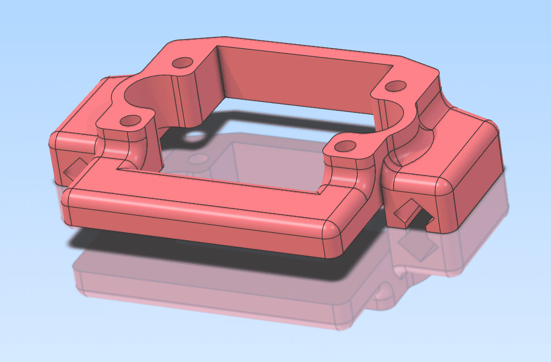

I found single-piece orderable lens mounts that are the same size as our original. If you're replacing the lens it might be just as well to buy one of these and swap it at the same time to save frustration.
This one might be slightly taller than stock, I believe stock is 8.5mm, this one is 12mm.
PT-LH008P Plastic M12 Lens Holder 18mm Hole spacing​
Or this one is about 17mm tall, it might eliminate the need for the spacer piece in the assembly.
Also, my Rev. C unit's camera board didn't fit well on 0dan0's bracket - the ears of the stock and modified lens mounts rubbed the rails and the components were slightly taller than the provided cutout. I re-modeled a new version of the upper spacer half bracket, it can be printed with less concern for removing the supports cleanly and it allows for a slightly larger camera mount with some minimal spacing.

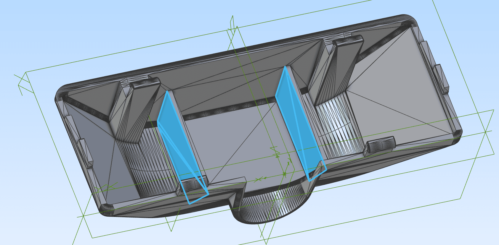

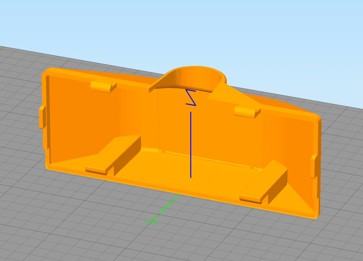

@Deano I was trying to install your printed cover with 0dan0's lens spacers and the extra piece I built to fit my camera board. It seems the ribs in your cover are pretty close and interfere with installing the cover in some instances. Could you modify it to push them out wider, maybe to the point the clips are? E.g. pushing the blue parts shown below further apart.
I believe @0dan0 posted a revision of @Deano 's dover to fit his lens mods better. @Deano has a different lens spacer in place if I remember correctly.
I fixed that in my mods.
