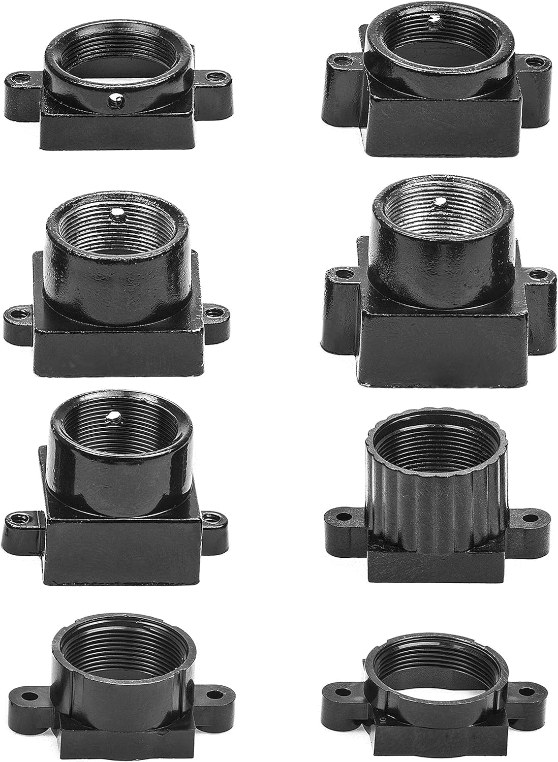

After a long long time...I finally have my C-unit modded!
I installed a new 18mm spacing M12 lens mount, plastic, and the extension screwed in all the way, as it should. Unfortunately the metal ones from this kit were 20mm spacing and the 18mm ones (that this board takes) were plastic. It did work fine though. https://www.amazon.com/dp/B07QMRDZYS? I used the mount the most similar in height to the original. That said, it'd be easier to source just the one you need in the future.
Used some extra M1.7 x 5 screws to secure both the PCB and the bracket with all four holes. Shorter screws might work, but that's the smallest the kit had. I did come across one other issue(?) as I tried to secure the board and bracket with a full eight screws, the two back screws on the top bracket cause it to deform and also for the camera to tip forward. I need to take it apart and investigate further if there's a clearance issue, if the bosses should be brought up to the surface height instead of undercut, or what is going on. As it was, I used the two back screws to go in and out until I had the lens centered on the frame so to speak.

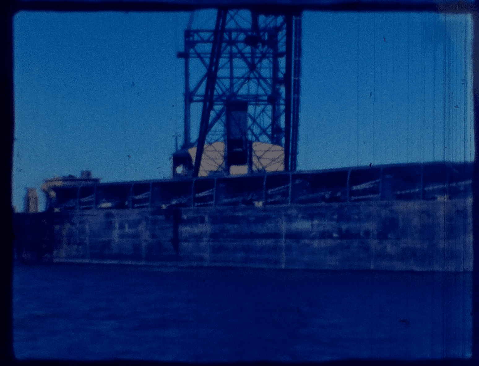

I just took a quick scan and didn't adjust color or exposure settings, but from an older Mac84/0Dan0 firmware with the old lens to the new lens the sharpness is evident.

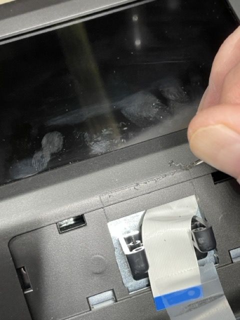

The plastic posts are held by screws that are easily removed once you have separated the case.
So the two ribbons you see in that picture---the narrow one goes to the button control panel on top of the unit. Before you pull apart the halves further, move that top panel to the other half so that you only need to disconnect the wider ribbon to the back half. I use masking or painter's tape to hold that button panel in place so that it does slide out.
That wider ribbon uses a “pull out” black tab—don’t try to pull the tab out more than you need to—light pressure on both sides of the tab should release the ribbon.

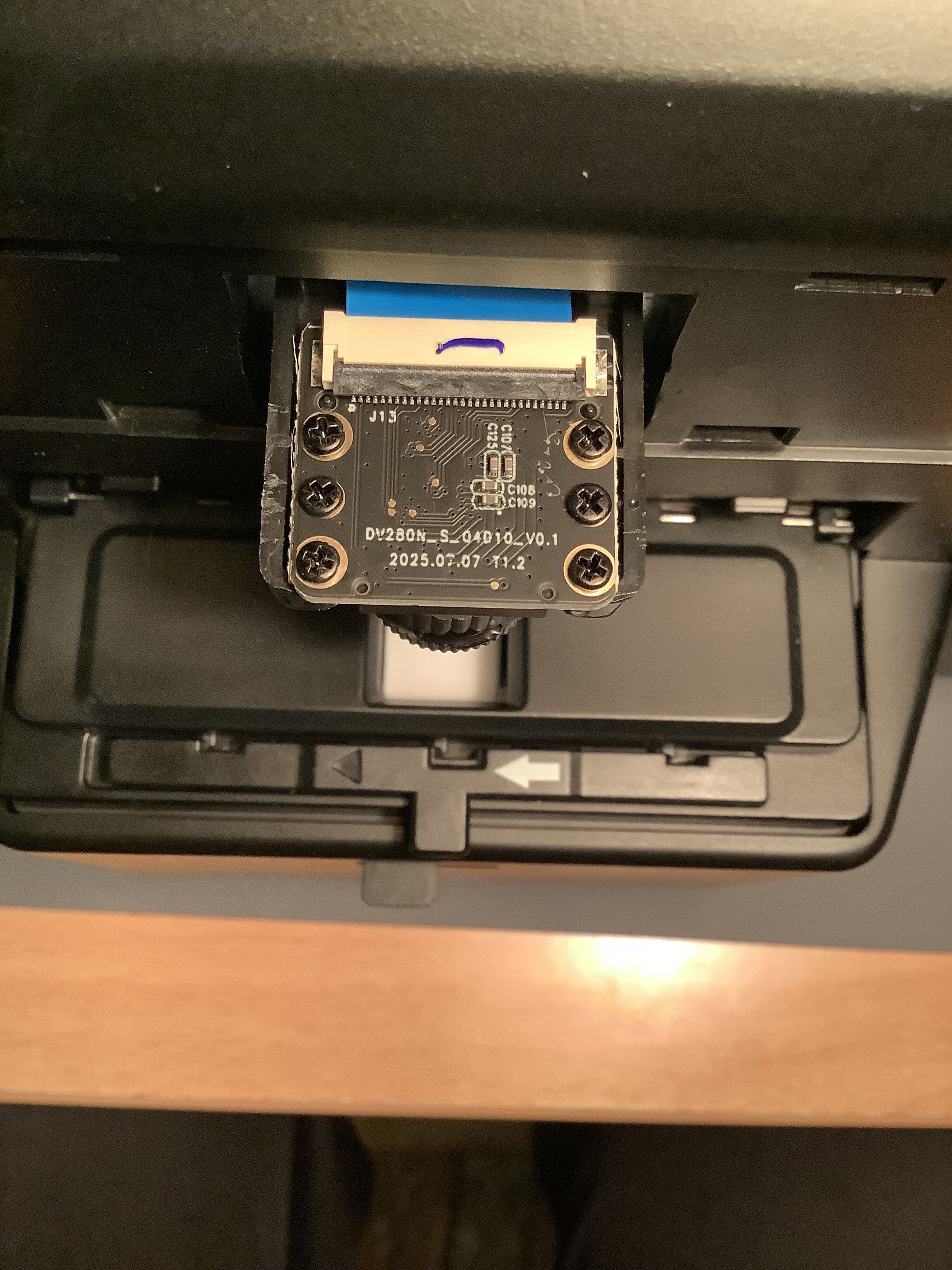

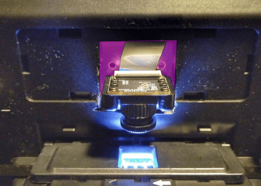

Thnx for advise, it worked great. I have also removed the cover to the sensor and lens. I was thinking about if I should lower the lens by 12 mm as mentioned earlier on this forum. But there is a plastic wall in the backgroud. Does this background cover the screws, that holds the sensor?
and I took a photo of the sensor. Can I recognize if my Reel is the modelD by the brand of sensor?
My S/N starts with H28251488K******. I have not tried to flash a new firmware yet, but I am more than willing to contribute with tests if it can help the mission👍😌

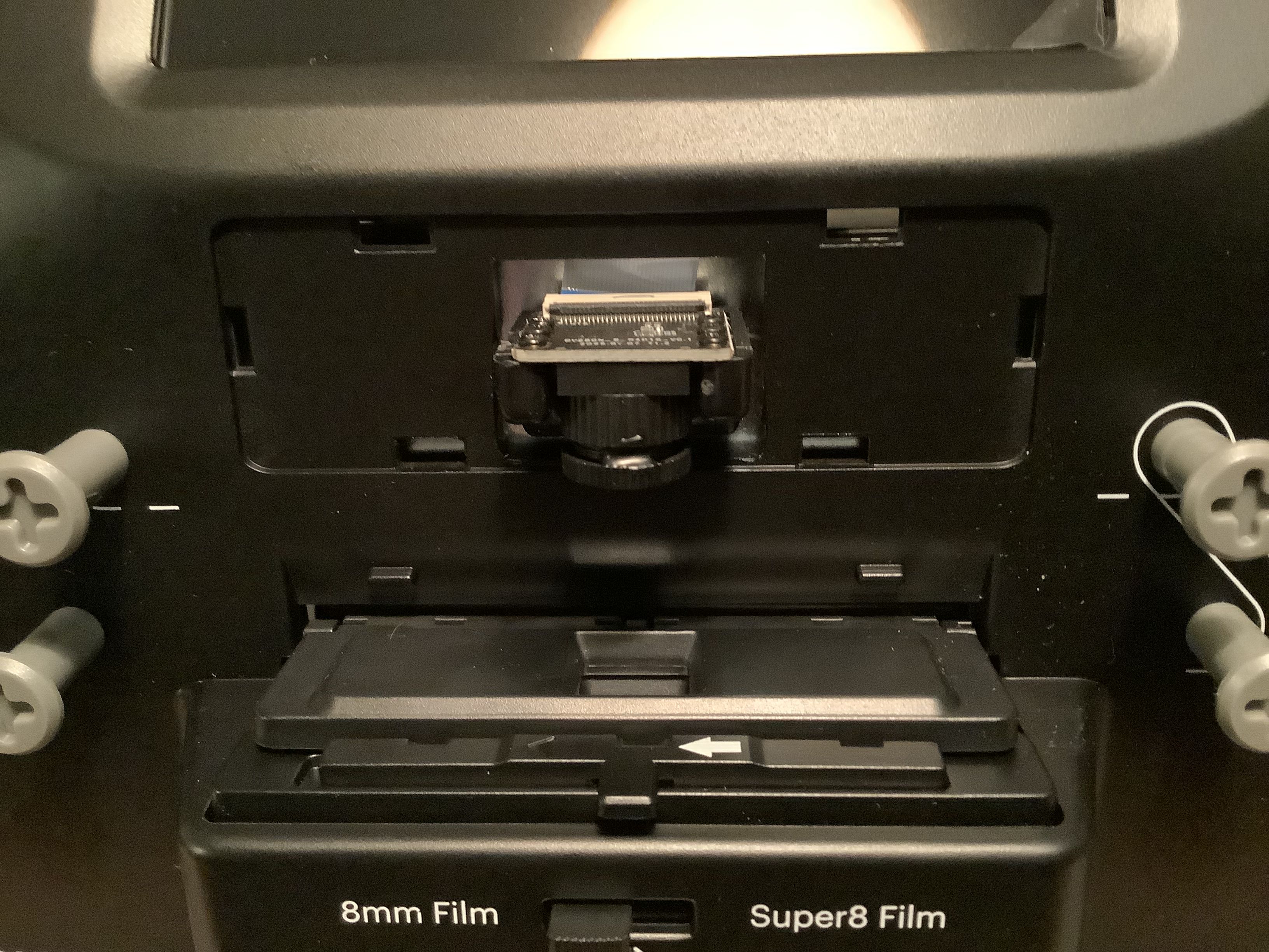

I am currently into the hardware side of things and I tried an el cheapo solution for enhancing the resolution my Kodak is getting with its stock lens.
Simply Because I didn't want to spend another 100 € for a new lens, I thought about just bringing the camera closer to the film strip.
After testing a possible distance, where I still was able to focus, I settled on 12 mm.
Which is about the distance between the screw holes of the camera mount. That way I only had to drill four new holes into the metal plate of the scanning assembly.
After remounting the camera and connecting it again (don't worry, the ribbon cable should be long enough), I could measure how much of the plastic case below it I had to cut away. (about 5 - 6 mm)
Finally I had to modify the camera cover to fit over the lower hanging lens.
The result now looks like this (cover removed for illustration purposes :) )
With everything in place I refocused the stock lens to match the new height.
Compared to the effort I had put in, I am pretty satisfied with the final result, considering both resolution and overall look of the modification.
Here is a comparison of before and after - both in 1600x1200 (max zoomed out)
The effective resolution is now at 1152x864, with a small margin around the actual frame.

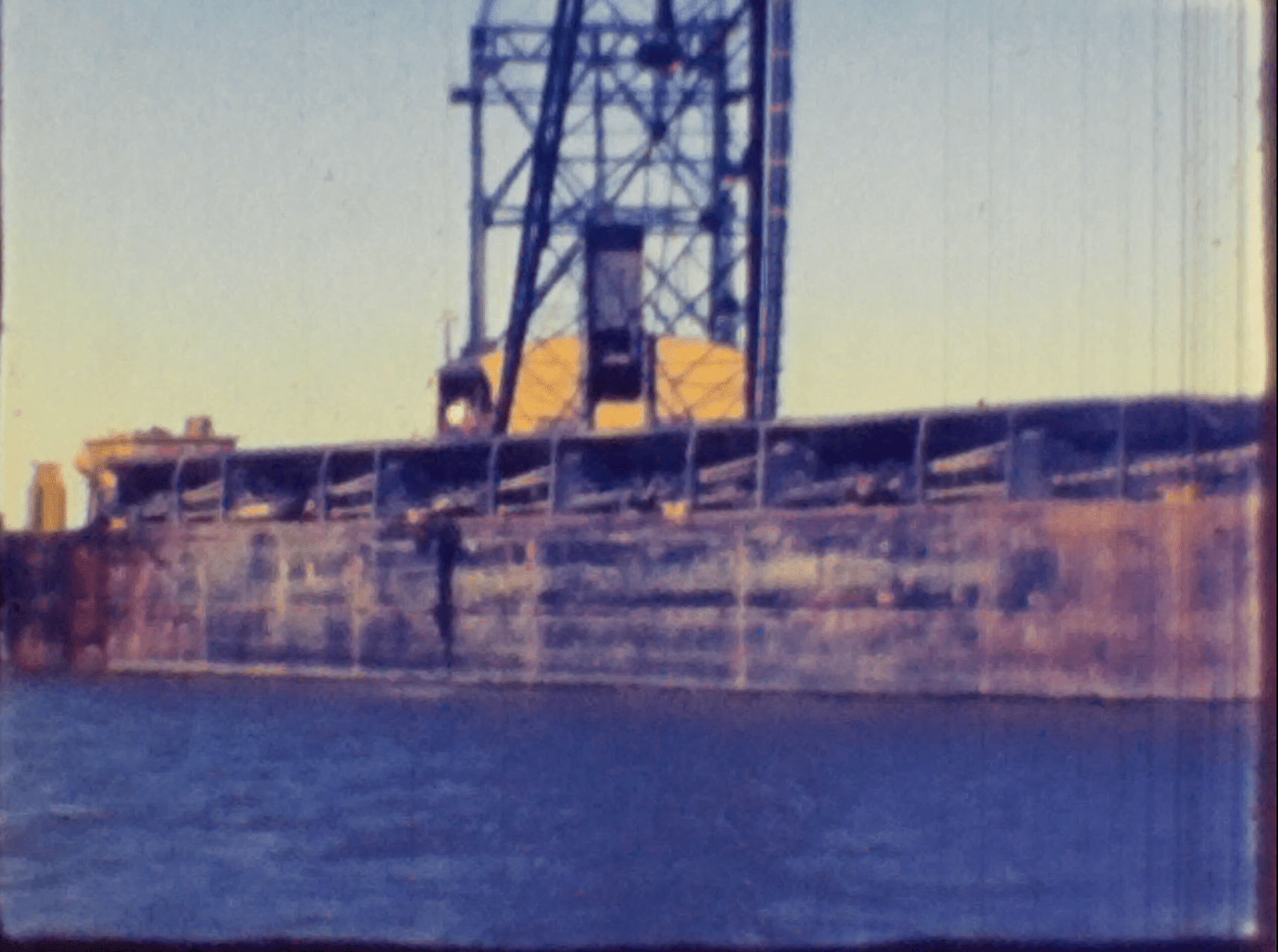

Here is another screenshot of the capture. Given that the actual movie isn't the highest quality, I am still happy with how it turned out

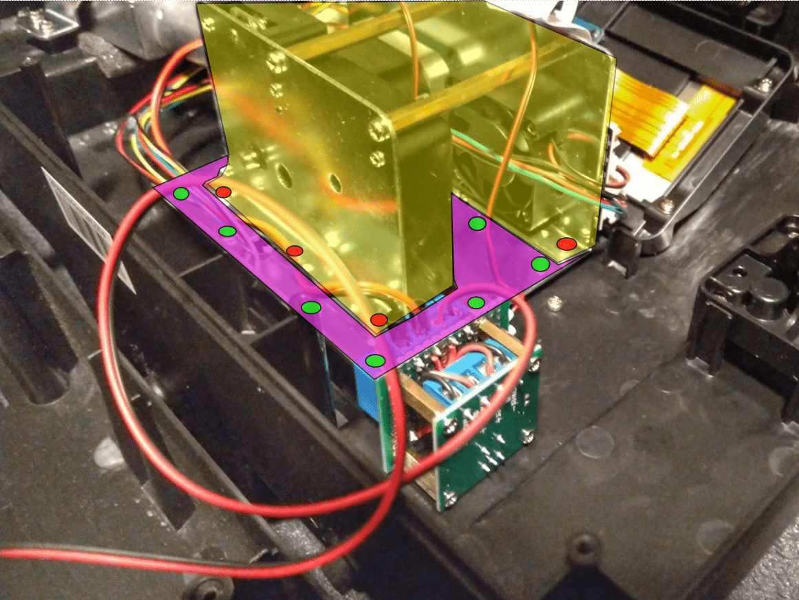

i'm sorry i didn't take pictures of the whole process, i hope i can make it a bit clearer:
you have to completely unscrew the scanning unit from the case.
there are like 8 screws that are screwed into the plastic.
first, carefully disconnect the ribbon cables. you have to unlock the connectors.
then remove the screws marked green, so that the pink metal plate comes off.
this holds the scanning assembly together. after that, remove the red marked
screws, to separate the metal plate and the yellow motor cage, together with
the transport mechanism.
you should now be left with only the pink plate, to which the camera module is attached.
remove the four screws that holds it in place and you only have the plate, ready to be drilled.

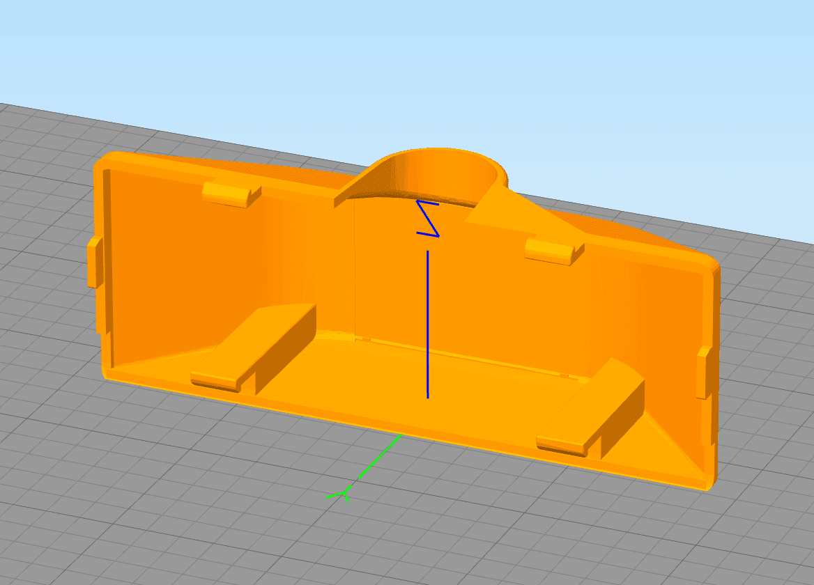

Installing riser- I decided to design a one-piece riser for elevating the lens/image board. I made 4mm, 5mm, 6mm, 7mm, 8mm, and 9mm versions. The only one that didn't give me fits trying to focus was the 7mm design. It's printed on my MSLA printer to retain the small alignment pin details.
I purchased M1.7 x 12mm screws for installation. They're tough to find, but I found a supplier on eBay. Unfortunately their thread does not match the original screws, but they bit into the existing unit's plastic threads fine.
Reduced aperture cap- I printed a 3mm aperture hole cover for the lens per recommendations made by 0dan0. Printed in ABS which gives it just enough stiction to hold onto the lens well. I didn't really appreciate how useful this would be until I tried getting a good focus with the new lens. It's helps immensely!
Backlight mask- Taking inspiration from 0dan0's mask, I built this piece to help mask any light bleed from outside the film edges. It fits snuggly in the film strip opening and appears to provide a bit of contrast improvement. I'm looking to do another version where it fits behind the film instead of above it.
Backlight Mask-Below Film Alternate- This is an alternate idea for masking the backlight edges. It fits below the film inside the backlight opening. The two walls of the mask should run parallel to the film. The walls are meant to aid in pressing the mask into place (it's a mild press fit), and aid in removing it from the unit with your fingers or tweezers. I haven't compared its effectiveness with the door attached mask, but I would expect it to be very similar. I'm actually using both masks which again I have no proof makes any difference. Your choice!
Cover-Lastly, inspired by Federico's mods, I decided to design a cover for the lens and image board. I rather like looking at the exposed lens and its components, but there's a benefit to keeping it all covered and protected. It's a resin MSLA part finished and painted black.

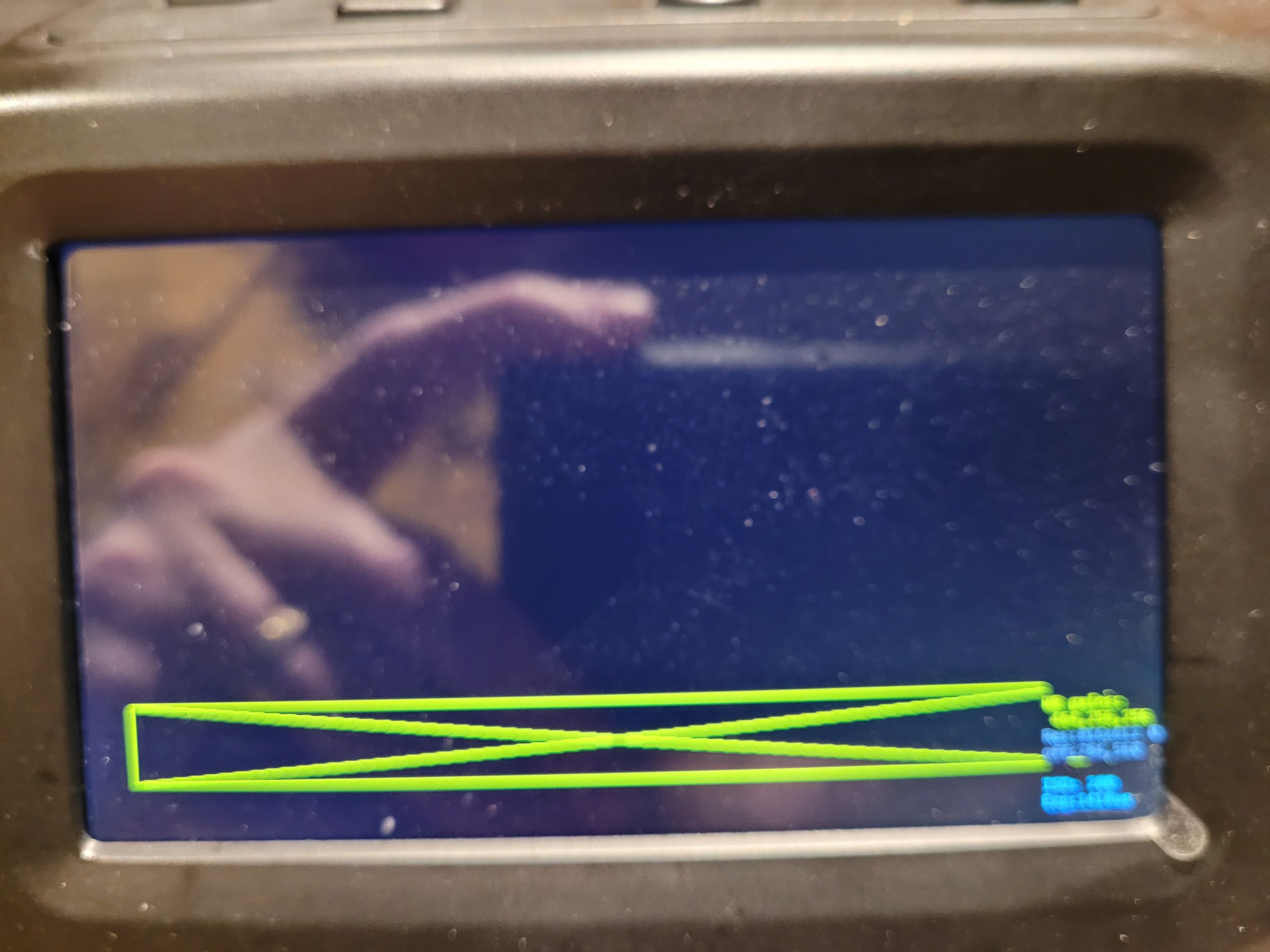

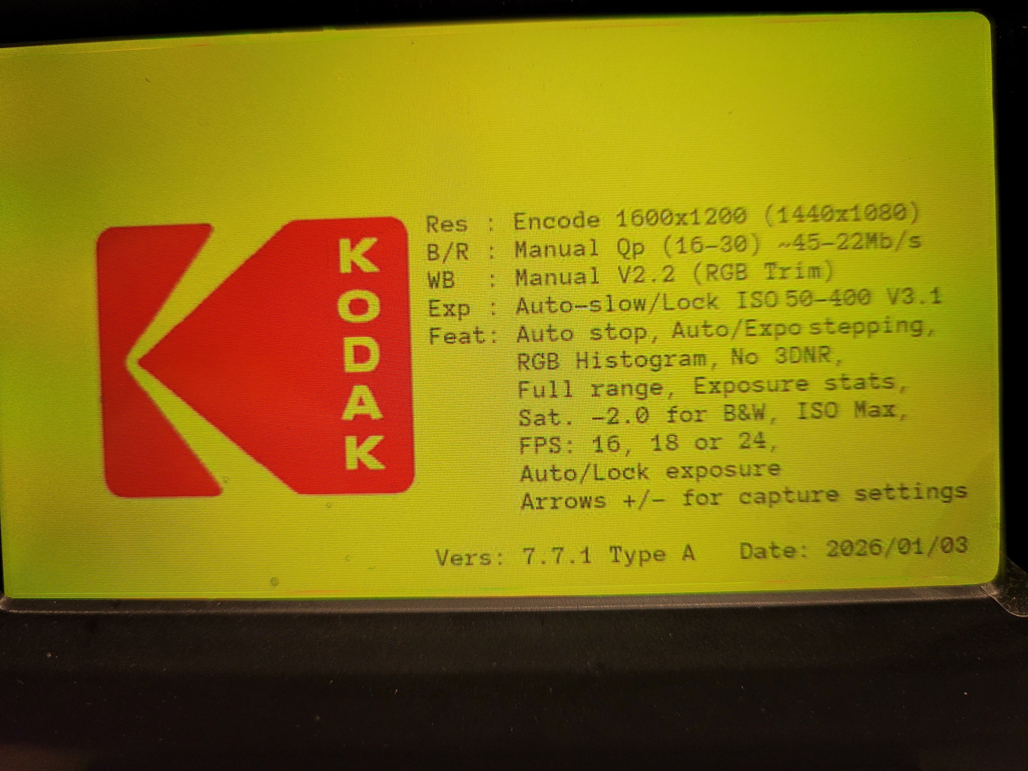

Hello. Thanks in advance for your help. I'm attempting to use 0dan0's 7.7.1 version A variant on my Kodak Reels. I've attached the serial number and the startup screen on the scanner. When I start a scan, it goes through all of the motions of scanning, but once it is done (4.5 hours later), there are no scanned video files on my memory card, which is a 128GB card. I have been able to use mac84's 1440p version, which does produce video files. I've also tried other versions (7.4 and 7.3) and they give the same result, no video files.
So my questions are:
1. Based upon my serial number, is the A variant the correct one?
2. Am I doing something wrong?
3. What else should I try to do to get this working?

Use a 32GB cards or smaller, or try formatting the card as FAT32. I think the large card support was broken.
