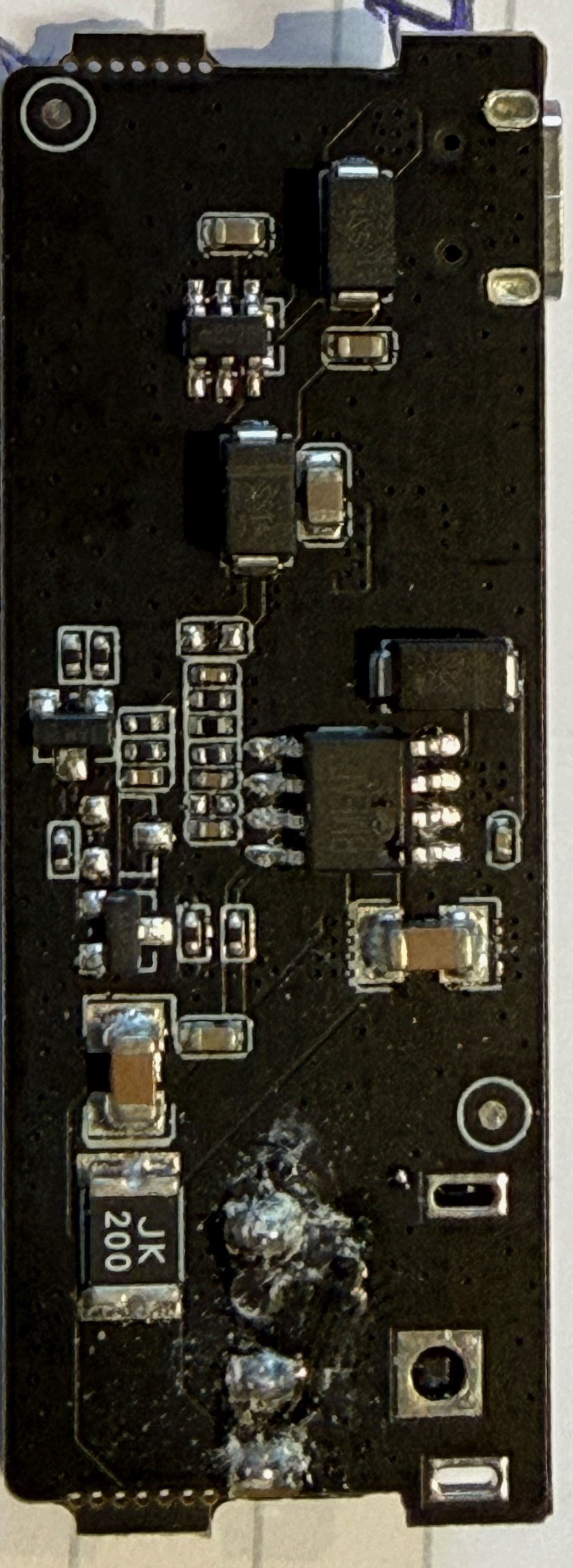

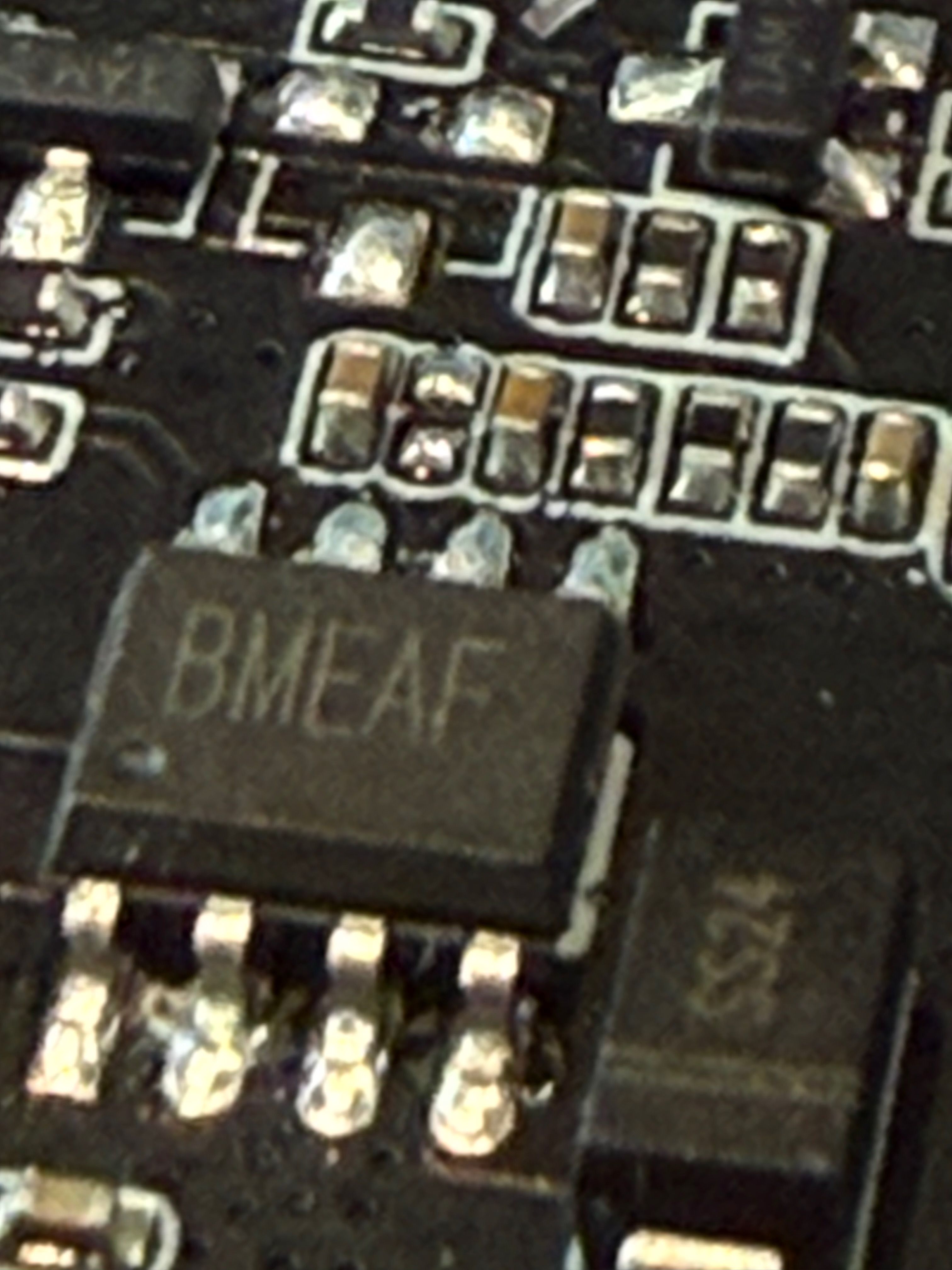

hi all,
new member here, looking to use updated firmware on a Reels unit I picked up off Ebay.
there was a posting last year on the subject of the power supply - with a burned out component (8 pin, surface mount), looking for any intel on the identity of the component.
the Spares or Repair unit I have was dead - not even a hint of powering up - and although the power board didn't have any signs of damage, when probing with a multimeter between pins 1 and 2 with 12 v in the barrel (and nothing else connected), I slipped and released magic smoke. I suspect it was already mostly dead, but I certainly finished it off.
does anyone have any insight as to what this component is? it's marked BMEAF, like the other post - another option (a reply) showed a BOG0B marking.
I'd really like to get this device working - I've got a bunch of old super 8 to transfer, and would quite like to shoot some new movies !
thanks in advance
Nick

"Matead" indicated in his post 485 in the original thread that "The chip is in fact a LSP5523-R8A."
Digikey in the US has them for 77 cents.
Reactions: ChrisTheChiller

thanks for the pointer - RS in the UK had the IC for a similar price.
i have just replaced the IC and now have signs of life - the power light comes on and i have some motor activity during startup - if i press ok after the startup process seems to finish (motor tests), the lamp comes on too.
The screen, although the backlight comes on does not display anything and pressing ok again in record mode (lamp on) does nothing. Any suggestions? I haven't yet wired in a serial port on the board, but i figure that a next step.
I've tried A, B and C origial firmware from Mac84, with no difference in the display. the barcode on the bottom is E3124148BK00636 - had to scan that as it's a bit scuffed - likely a B unit.
any suggestions on next steps would be great!

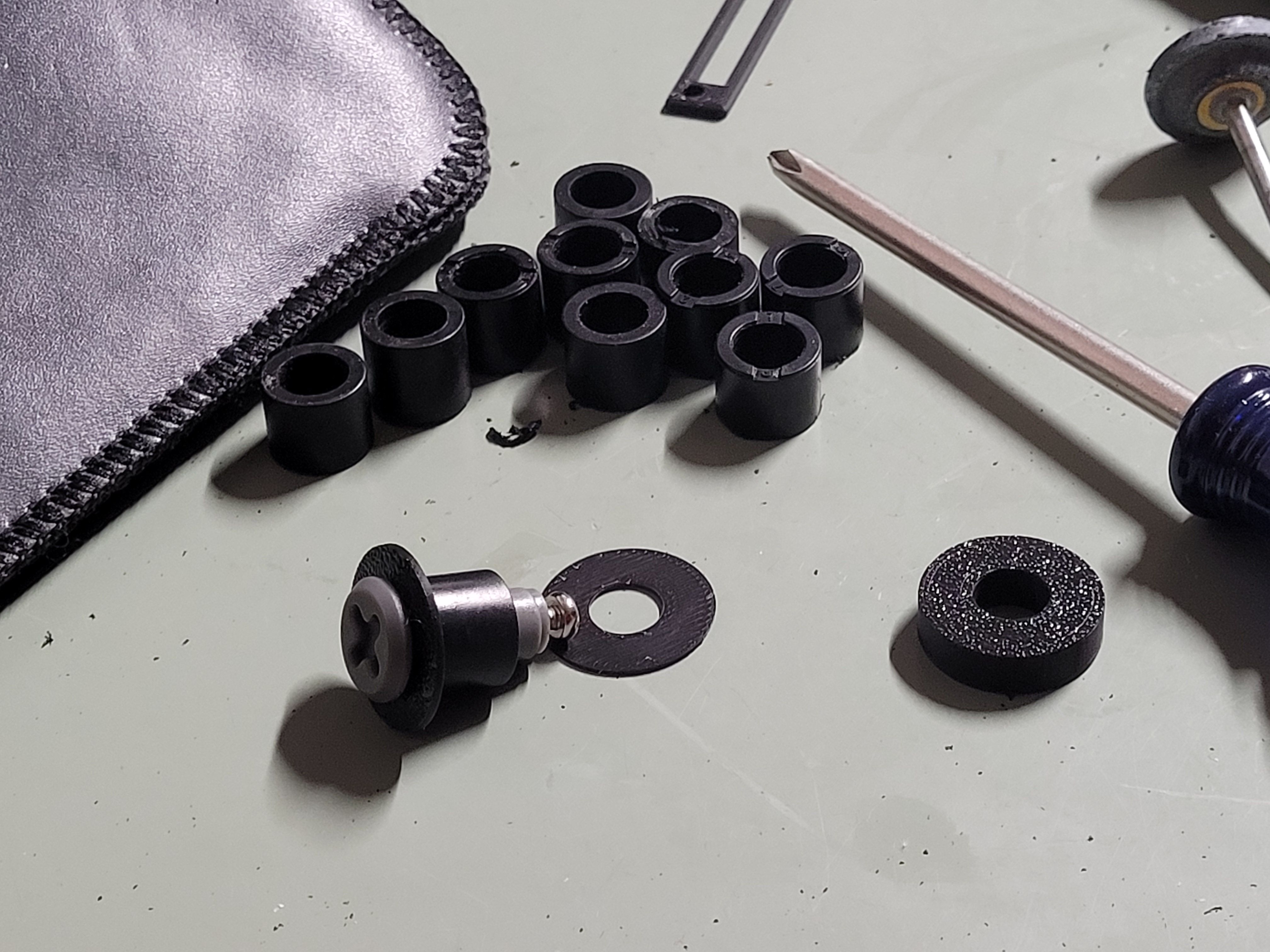

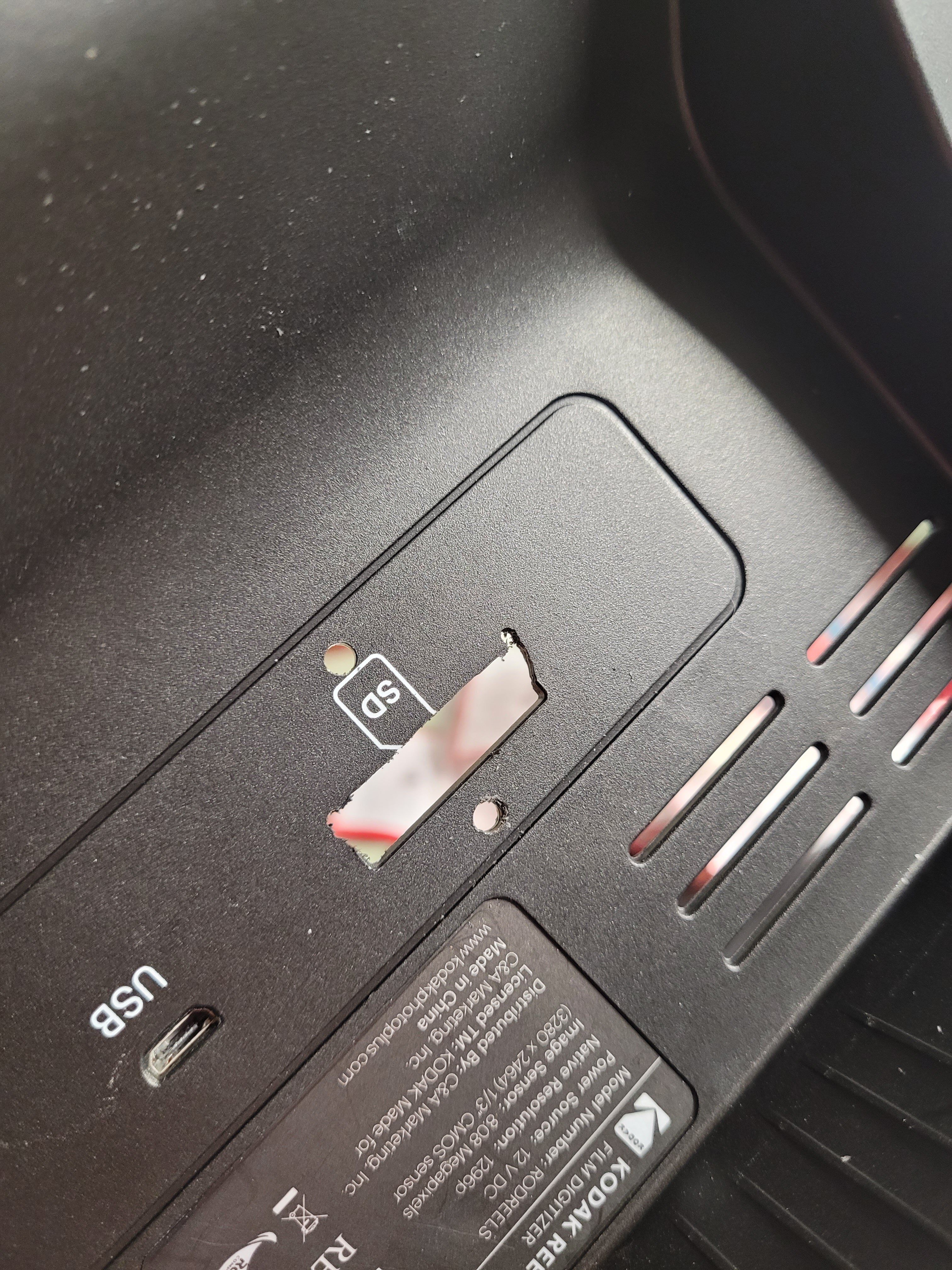

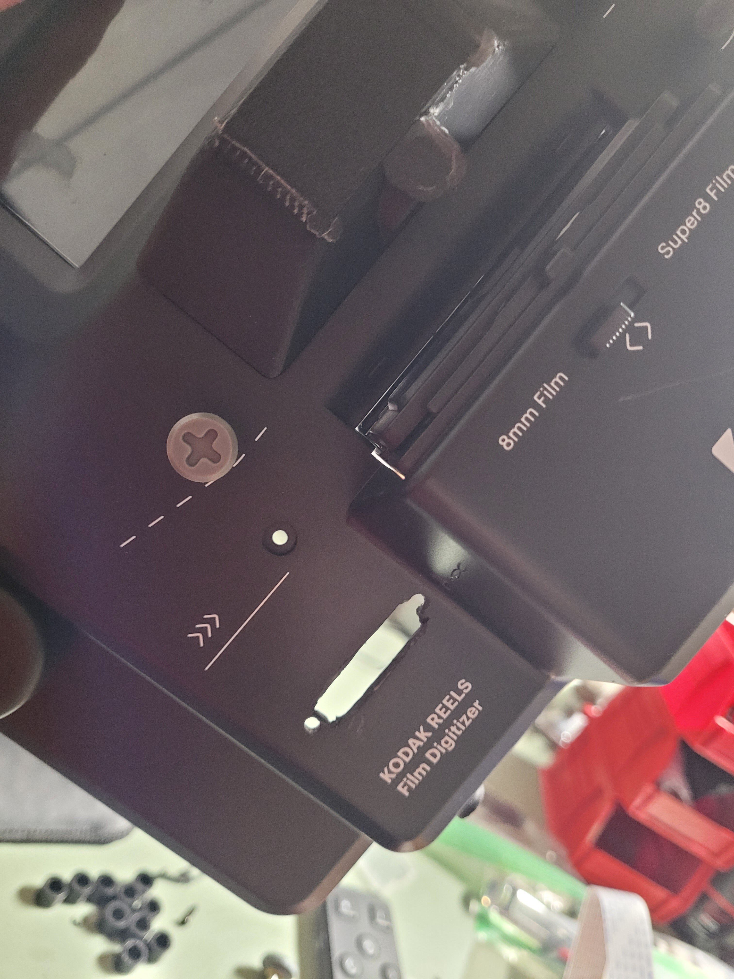

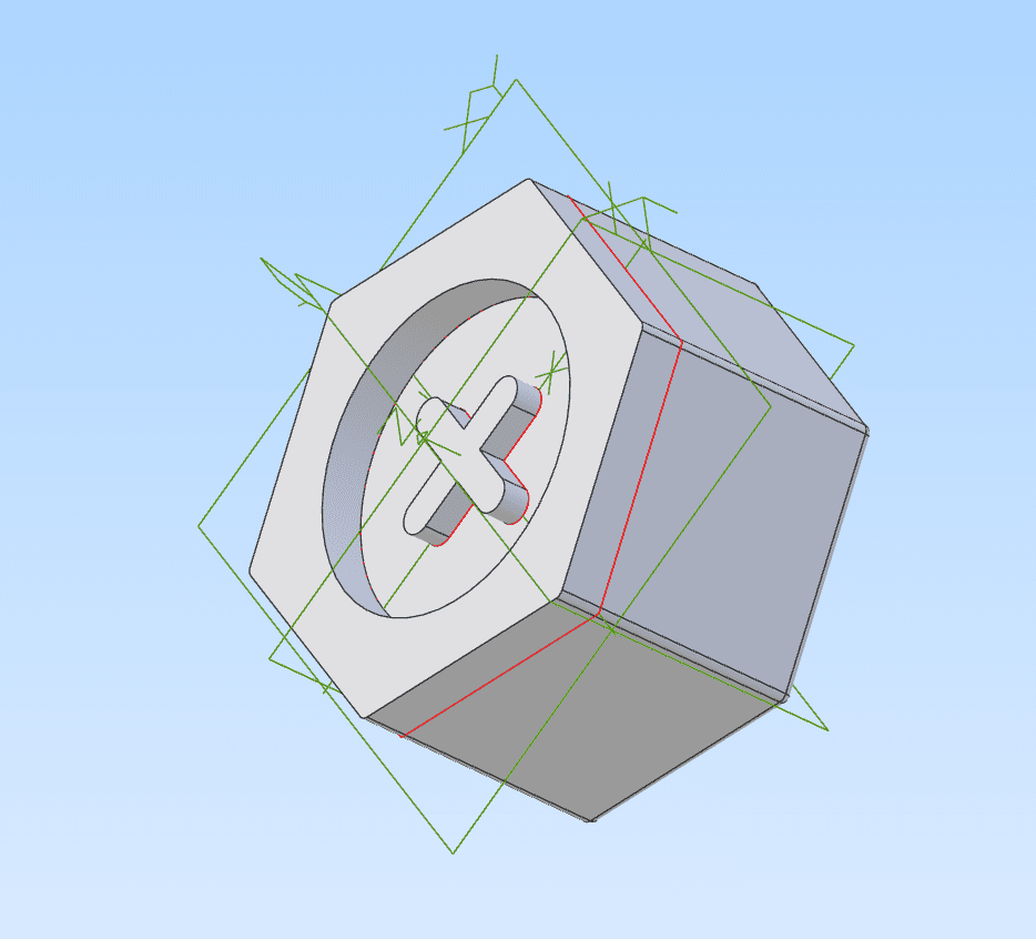

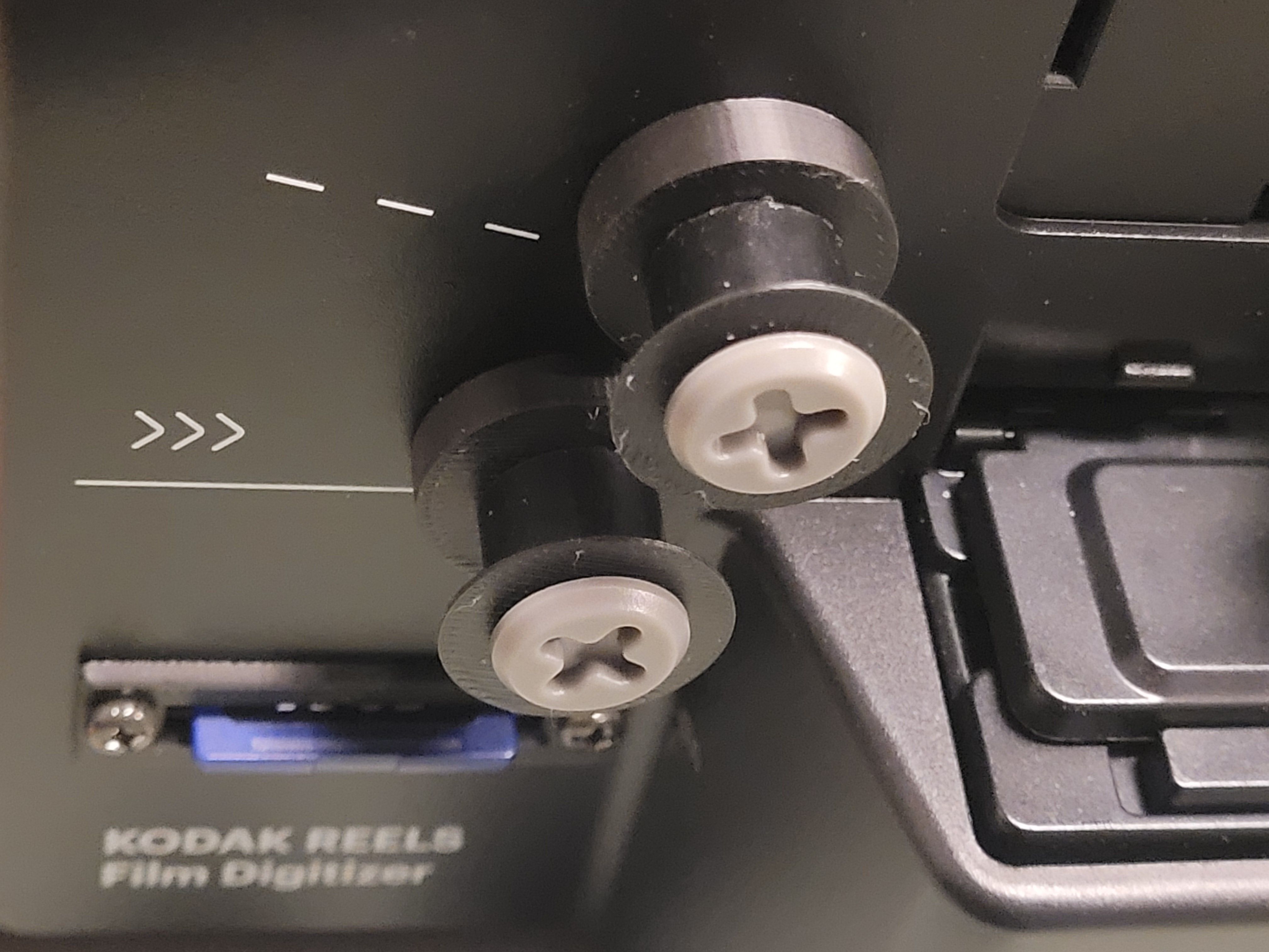

Finally have the full suite of mods installed on my machine.
Smooth Rolling Film Pulleys
I did the pulley mod, I already had some random slippery maybe nylon spacers in ~24mm length so I just cut them in half to about 10mm spacers when I was done.
The washers were 3D printed in 0.5mm increments up to 5mm. [Attached to this post.] I used a 0.5mm washer on the outside, then the spacer, and finally whatever sized washer on the inside to mostly fill the shaft to the shoulder, but not quite, to ensure free rolling.
The hardest part is holding this all to put the screw back in on the backside. So, I also made a custom 1/4" drive or 1/2" hex socket handheld tool to hold the posts steady for me. [Attached to this post.]

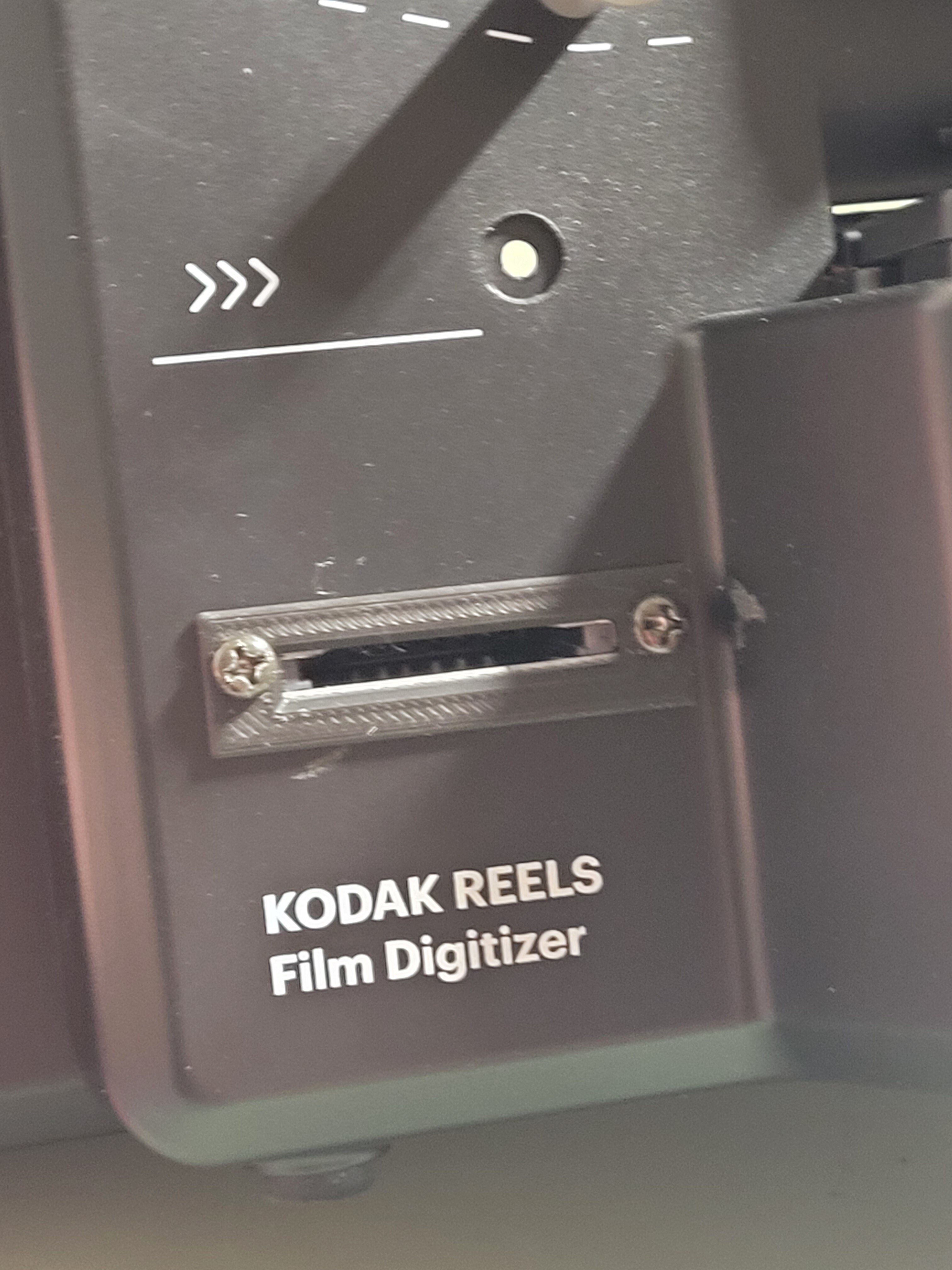

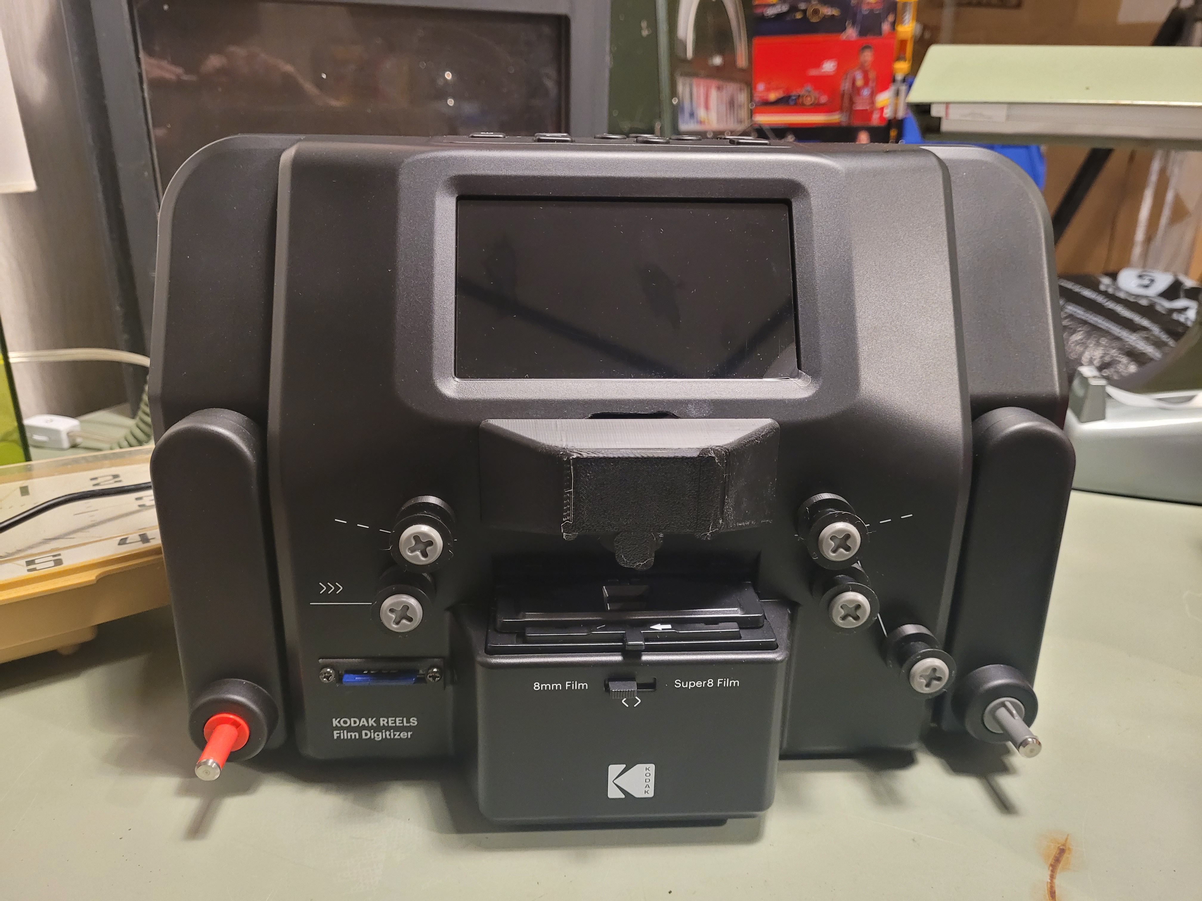

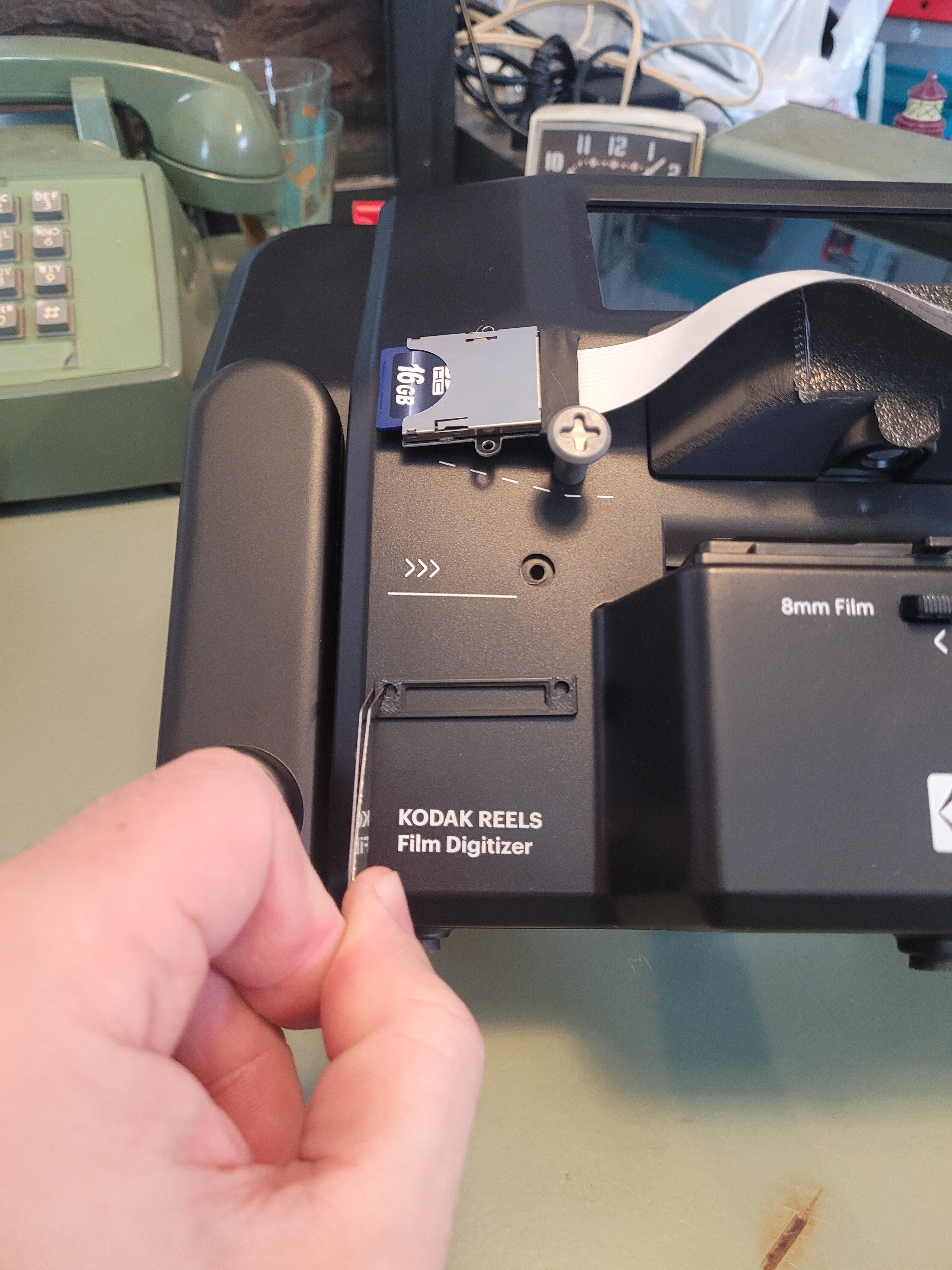

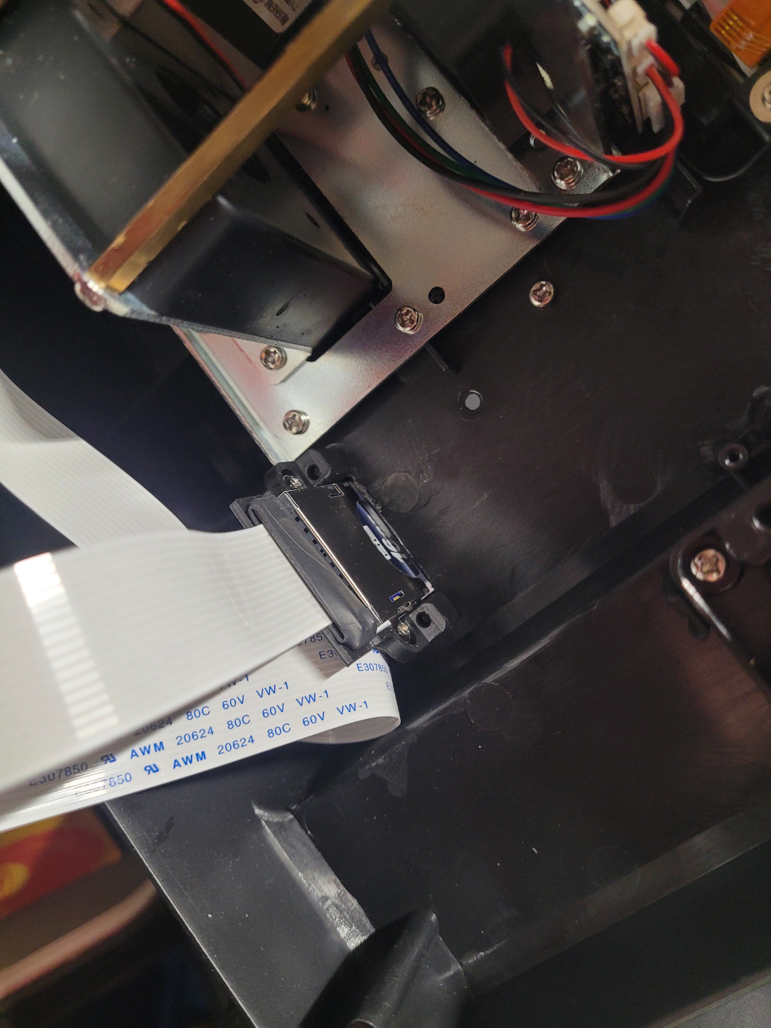

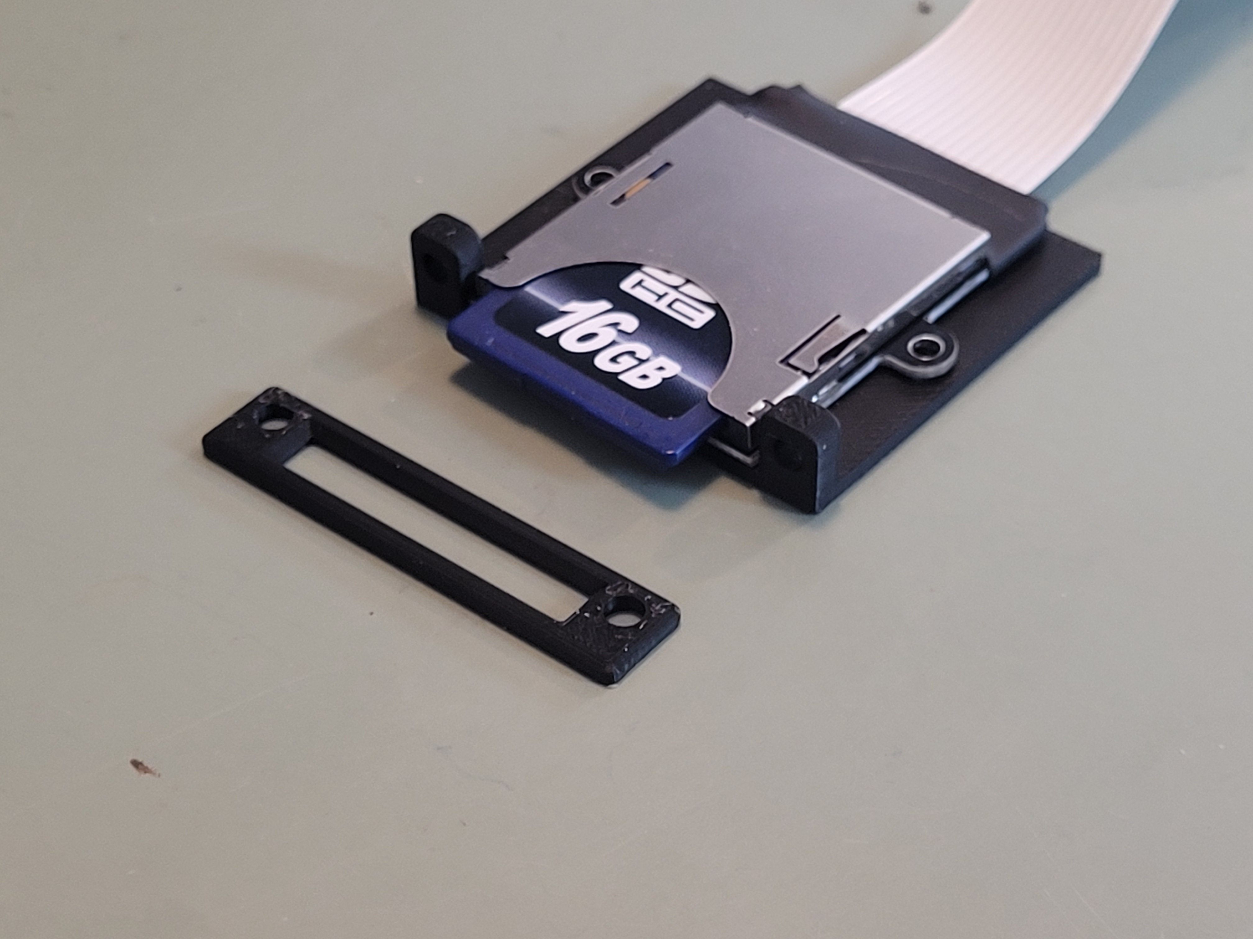

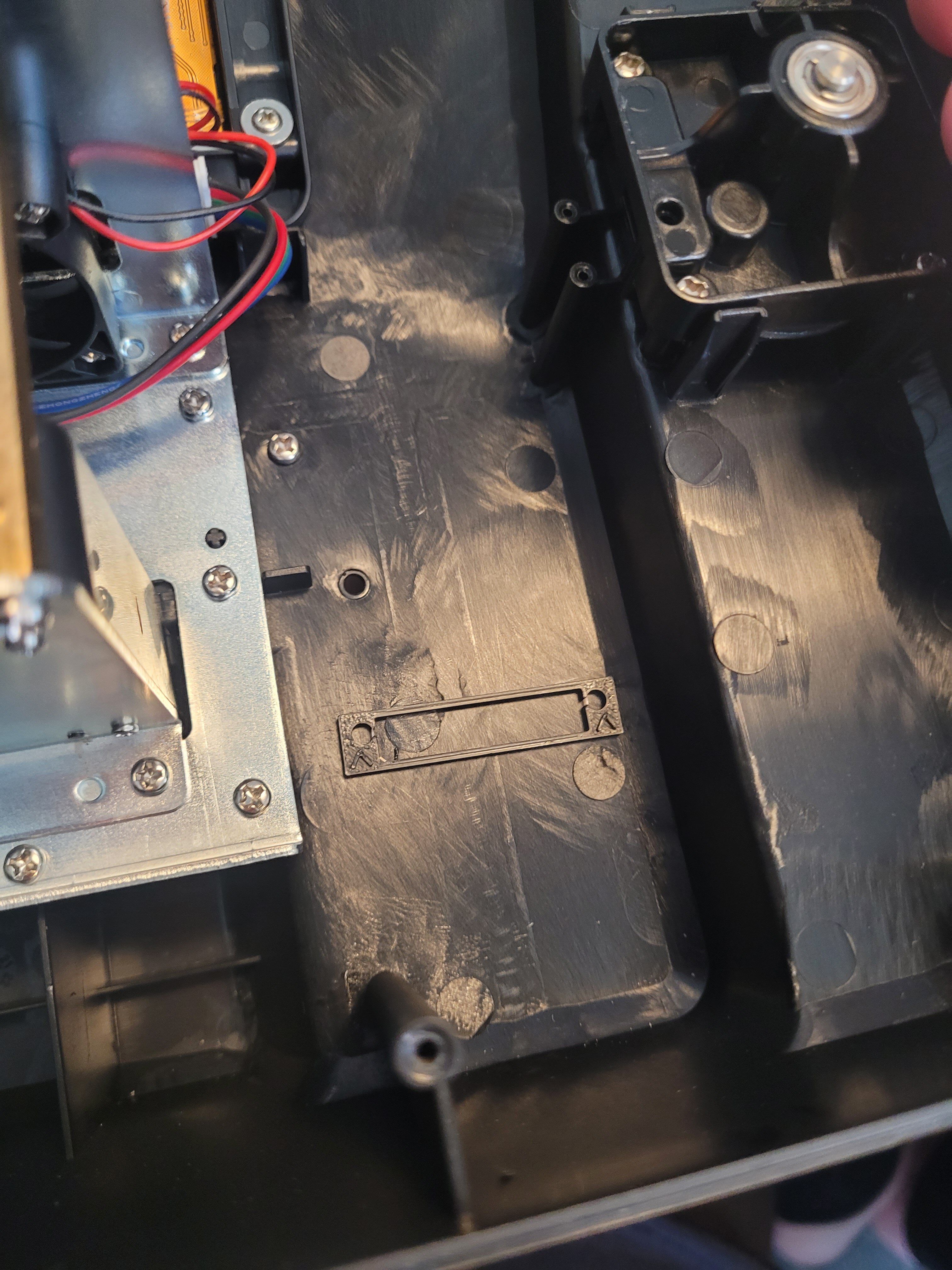

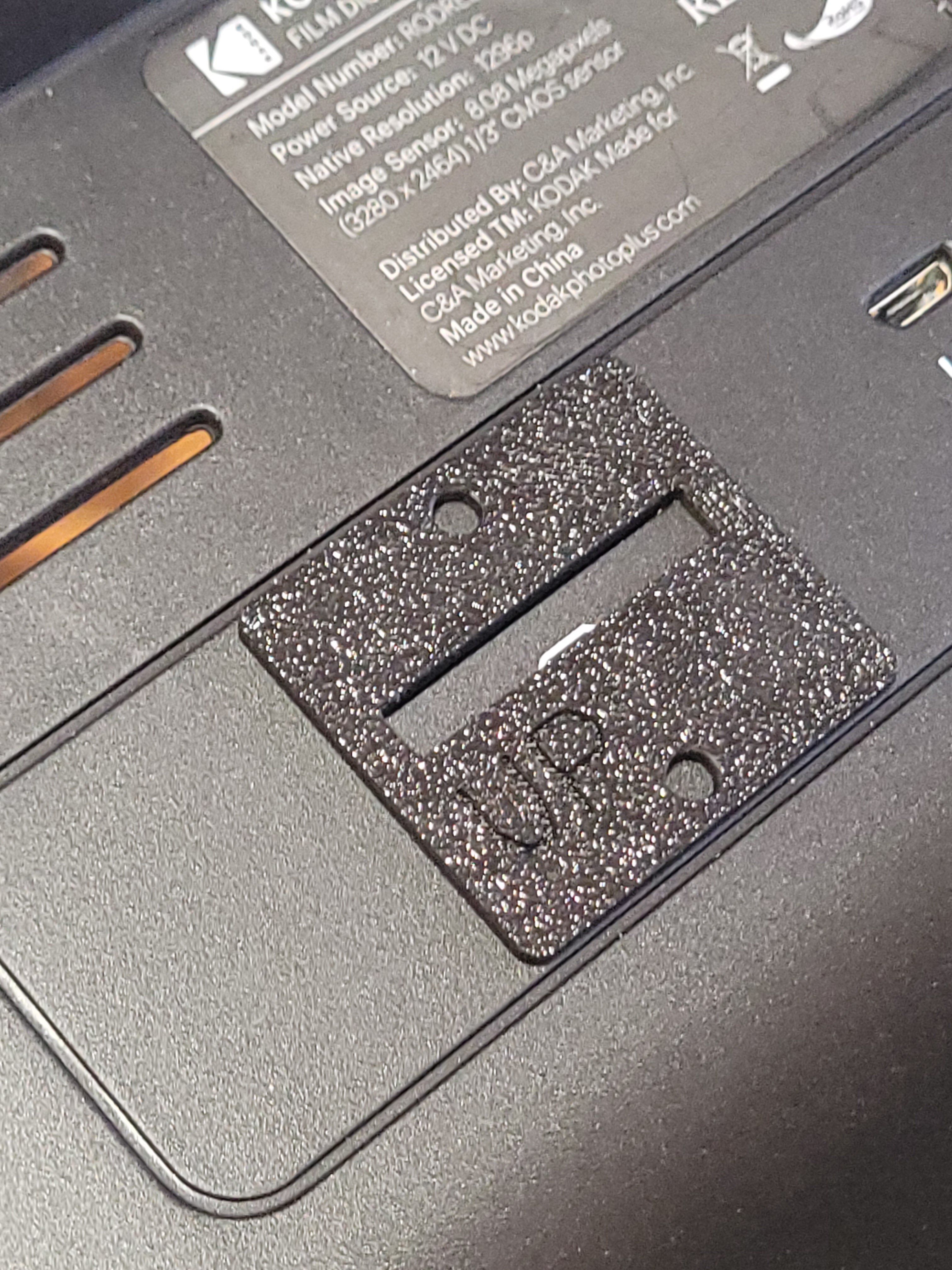

SD Card Relocation
As I had briefly alluded to last month I was working on a relocation kit for the SD card. That is now complete.
On the back half of the unit I placed the existing SD card slot enlargement template.
Drill the holes, trace and cut the slot.
Two #4 x 1/2" sheet metal pan head screws secures the new cover.
Locate a good spot on the front for the new SD slot:
Drill and cut.
Mount the SD slot to the mounting board with M1.7 screws.
Using #4 or similar screws, run them through the faceplate and body pulling in the SD card holder. Note in this final design the metal SD card slot will sit more flush with the face of the existing Reels housing instead of being more inset.
And we're done.
Note that this SD card relocation uses updated files. I have added those to my original post for the SD relocation.
