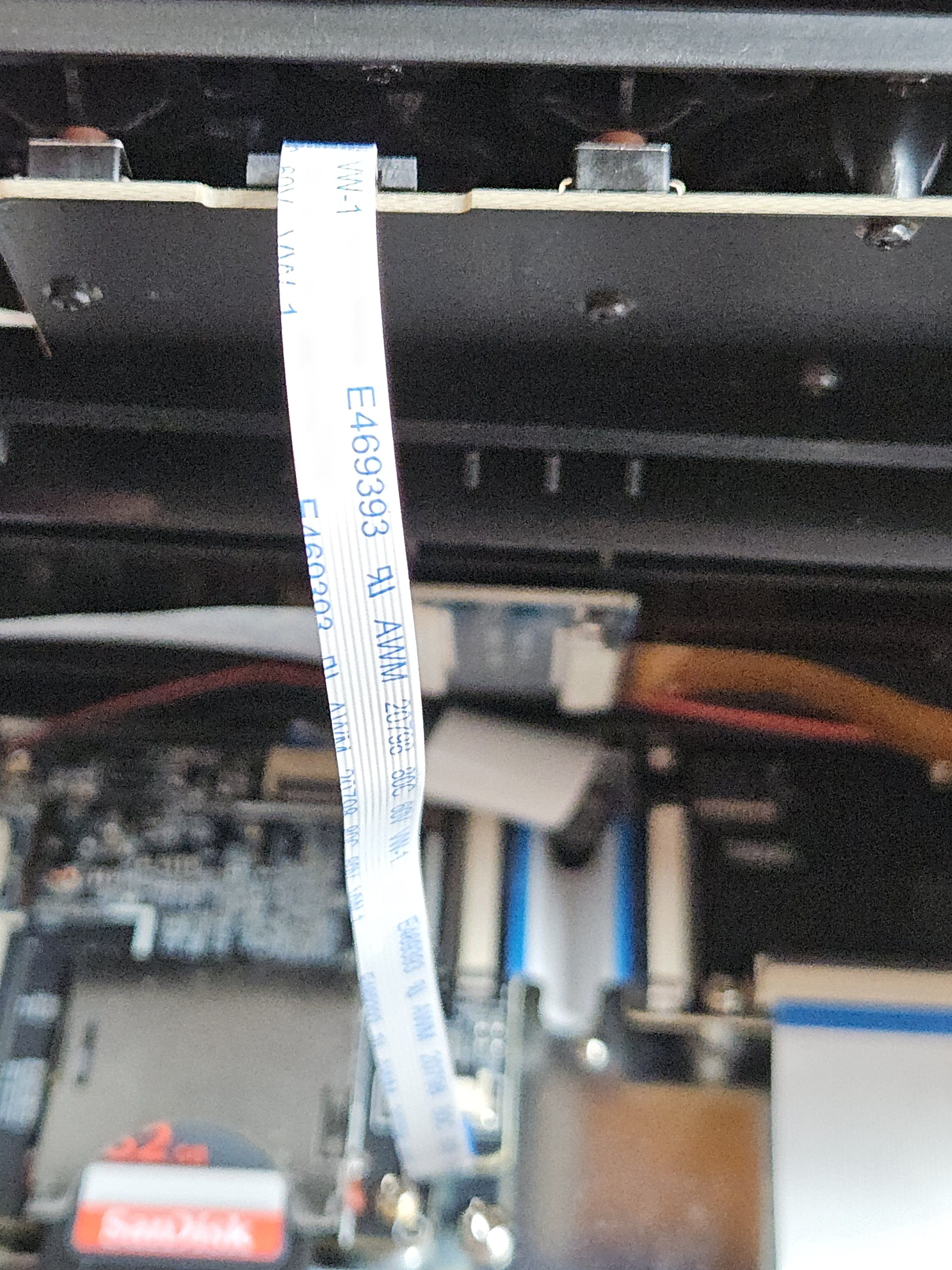

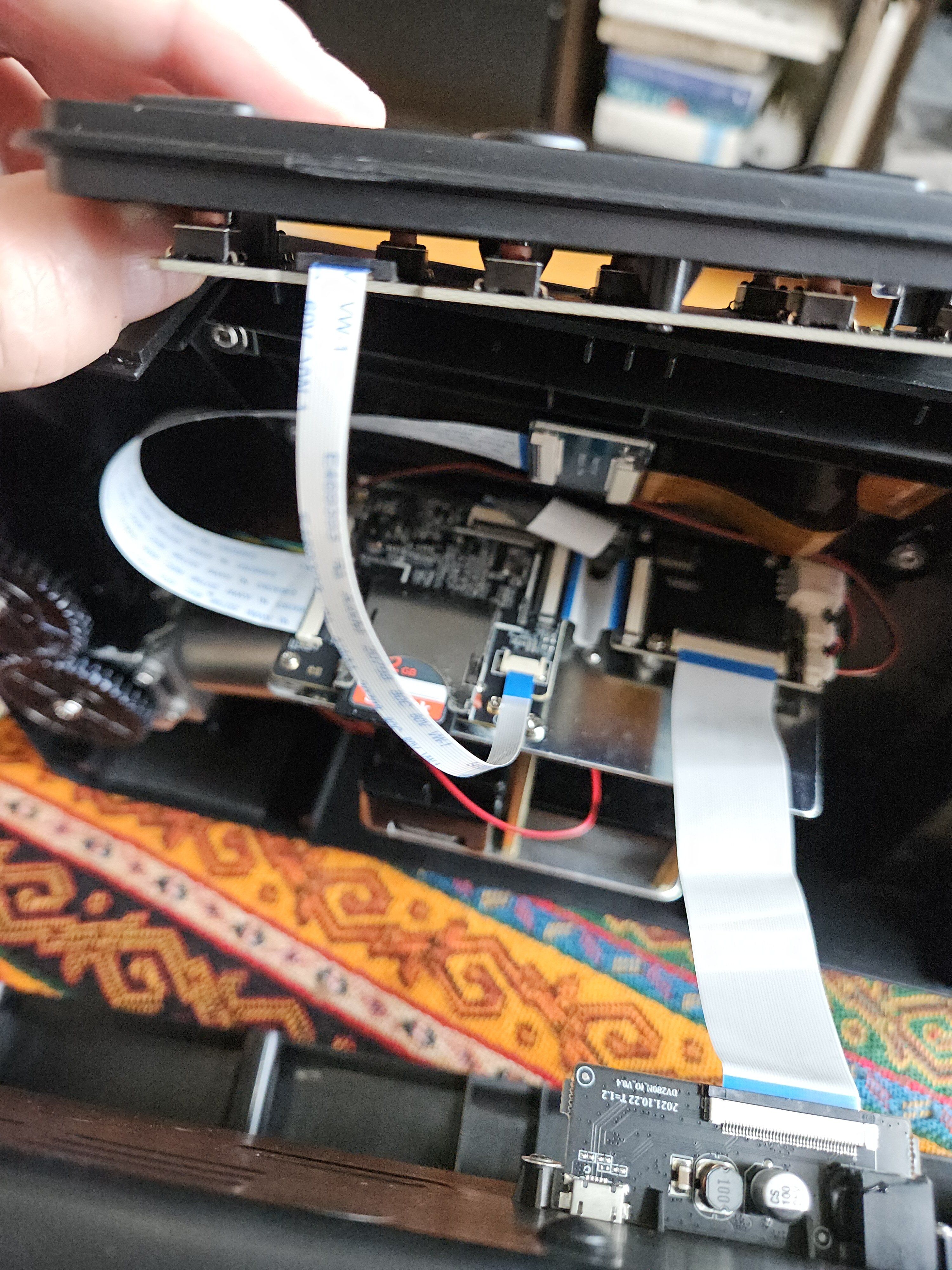

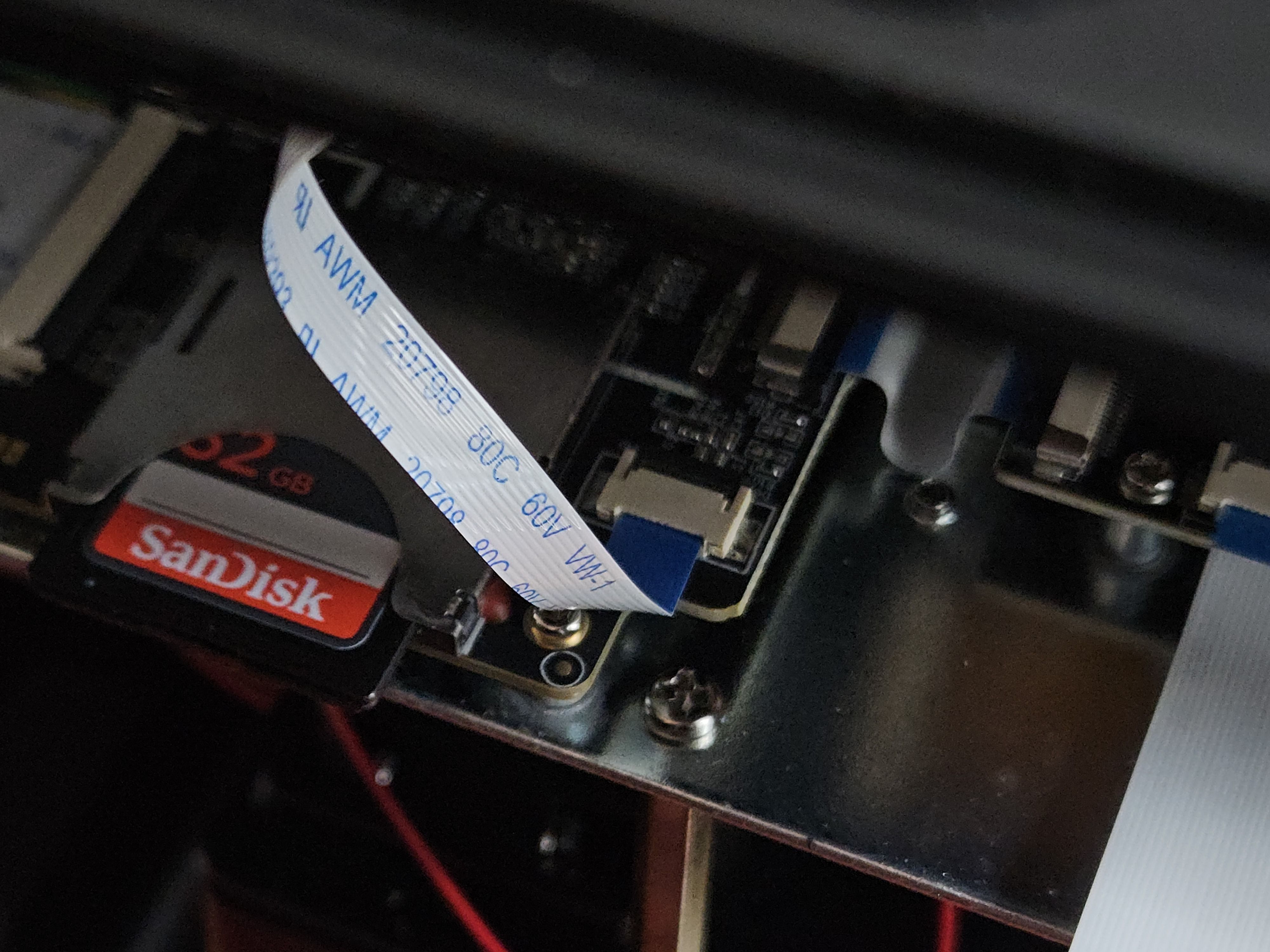

I damaged the terminals of the 10 pin cable, joining the control board to the processor. I tried to reconfigure the contacts but did`n t suceed. Now I have ordered new cables. Can somebody tell me wether the straight connection (contacts on the same side, Type A) or the inverse one (Type B) is required? I missed to take a picture of the original.
For the 40 pin cable it is clear, that it is type A. Thank you for your help!
Hi @hasi here the pictures: I had to open my model B again because in the excitement of rebuilding, I've inserted the command board upside-down and I've noticed only when I' was ready to scan a reel...
The cable is not twisted, but it may be twisted on the board, or simply the board could be mounted reversed compared to the command board. In any cases check the picture: one side of the cable is printed so you can buy a type-a and mount it in the same way. Let me know if the pics are showing enough for you to understand how to mount it
Besides: why didn't you try to cut short the damaged cable, strip gently with some sandpaper the new end, to expose the connectors and give it a try?
Good luck, Federico

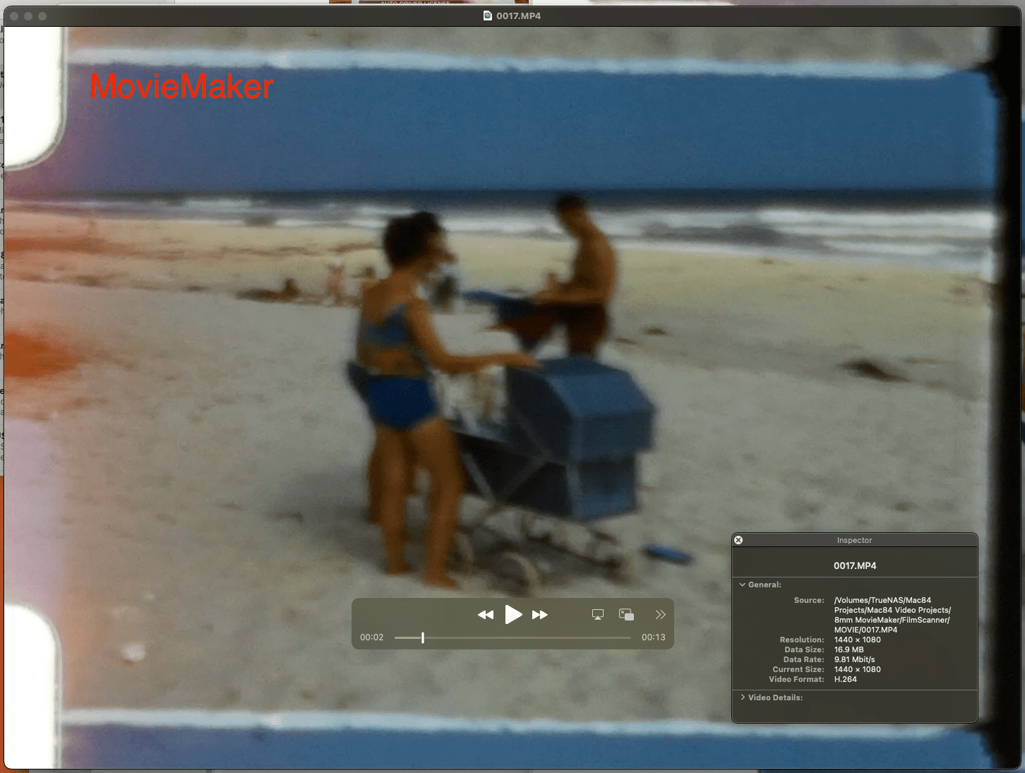

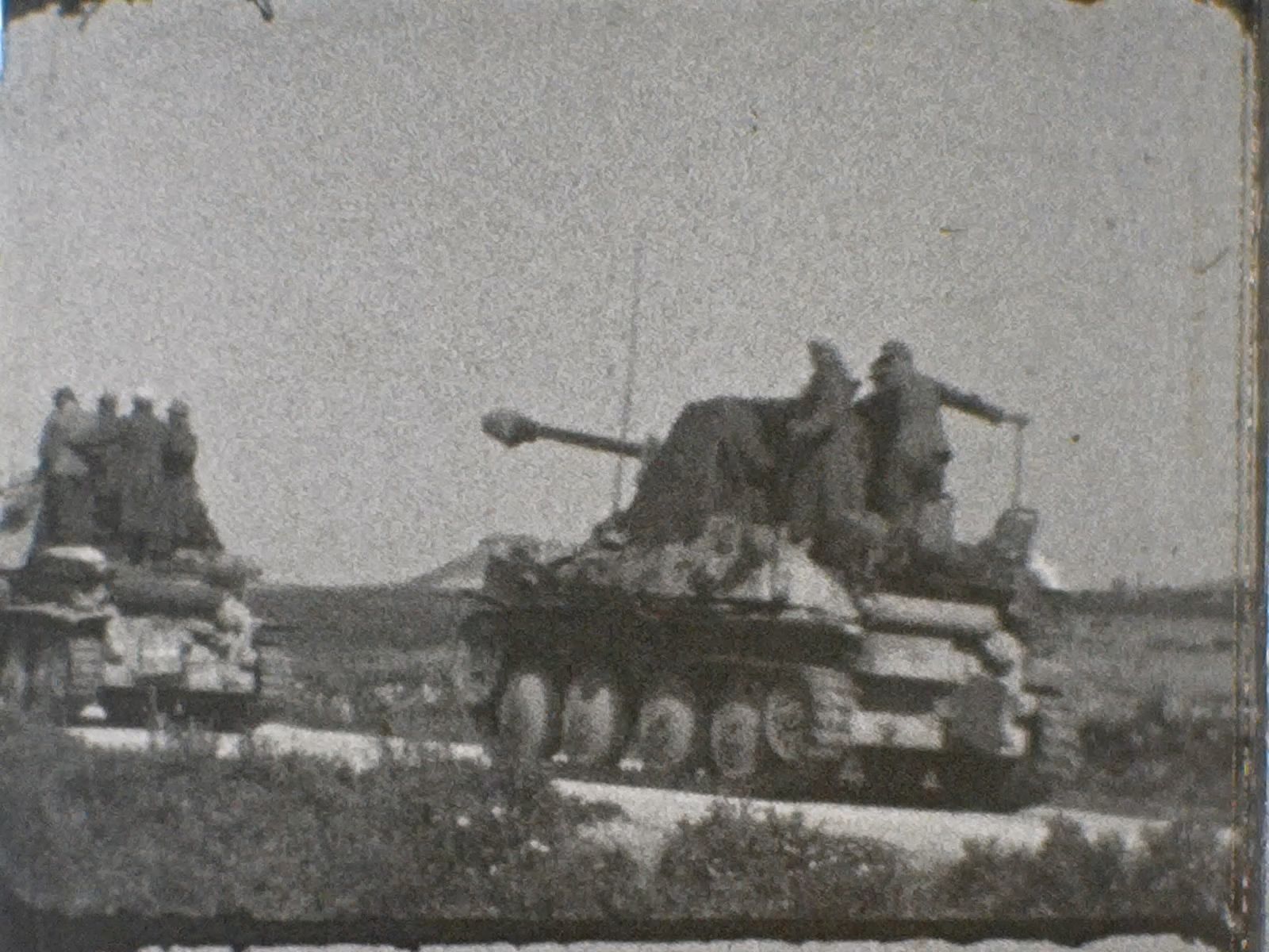

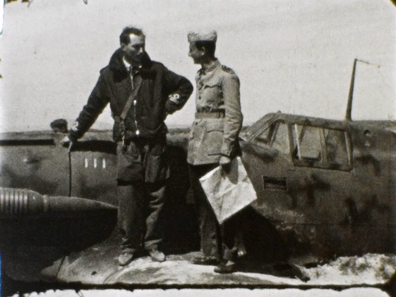

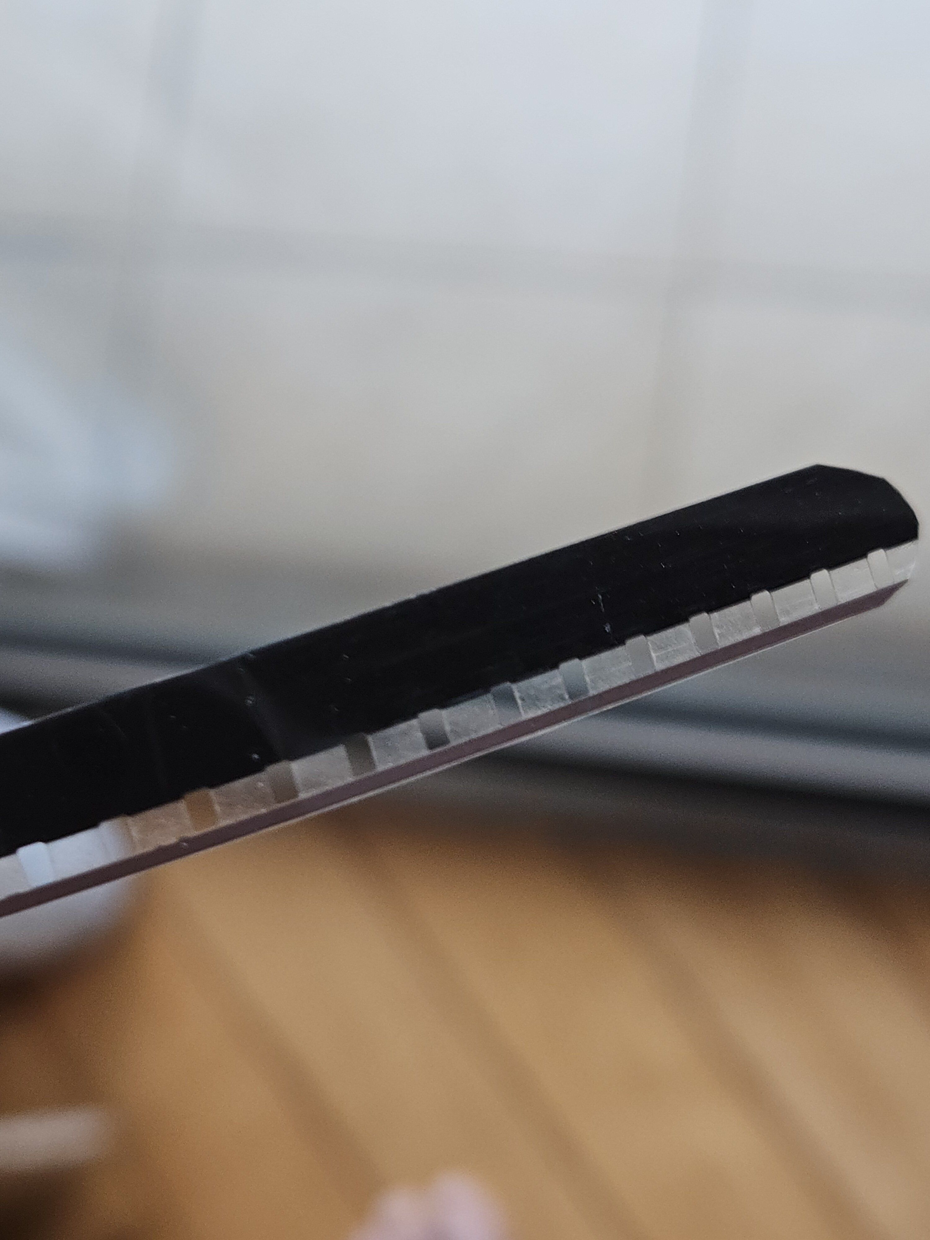

Hi everyone, I'm scanning with 7.7.0 a 8mm 1943 reel from my grandfather. Some war footage in b/w from Tunisia (with Panzer IVs, Macchi planes and burning airstrips: some examples attached) and I've noticed that the film has a bronze/brown strip outside of the driving holes and I reckon it might have an audio channel embedded.
Have a look to the two attached pictures: what do you think?
If so, is there any way to record it, maybe with an old cassette player? I am not aware that my grandfather duplicated the original footage over a new film, adding a post-production sound, so if it is an audio track indeed, it may be original.
Thank you, ciao, F.
Good luck, Federico
Thank you for the pictures! To me it shows, that the cable is B- Type with the pins inverted. The blue stripe is in both connectors pointing to the top, but since the connector of the control board is upside- down, relative to the cable the contacts are opposite. Please tell me if I see it wrong. For me it was also important to see, that the cable is not twisted 180 deg. -Not respecting that could cause short citcuit and my unit would be gone. I tried with sanding the ends but didn`t succed. I hope that with the ordered cales it returns to life again.
have a nice day!

I don't think you'd physically be able to run the 8mm film through a cassette deck. BUT if you removed the playback head from the deck, extended the wires, and held/positioned the head so that the audio track was in contact with the head, while the film is running at normal speed, maybe you could hear the audio (if present). Lots of variables there.... but sounds like a great project.

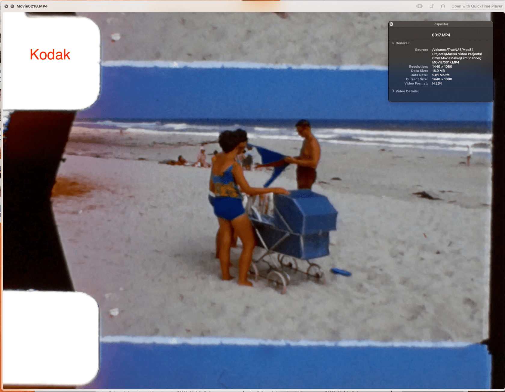

I haven't caught up on this thread but it's exciting to see all the new posts!
I just thought I'd share something briefly. A company reached out to send me a Movie Maker Pro for review. I just took it out of the box and was curious how the capture quality compares with the Kodak.
I'm unsure if I got a lemon or what, but the Movie Maker seems to be wildly out of focus!
I hope to do an in-depth review and tear down of this product in a future video, but I thought you'd all appreciate a quick look. The top screen grab is from the Movie Maker, the later from the Kodak.
