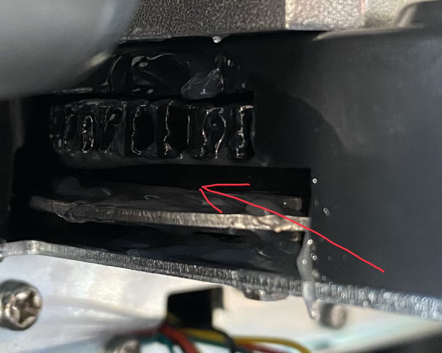

I have one notation about the disturbing scratching sound that can appeare when scanning film. I think that I have located where the silicongrease shall be placed. Look at the pictures and see where the arrow is pointing. Use a syringe to dispense the grease between the plastic gear and the metalplate. If you look under the lower plate (it does not show on my pictures), there is a hole in the center. I have seen grease coming out there, so I will try to put a cöutch of silicongrease in there and then seal the opening with some tape, after cleaning the metalplates suface

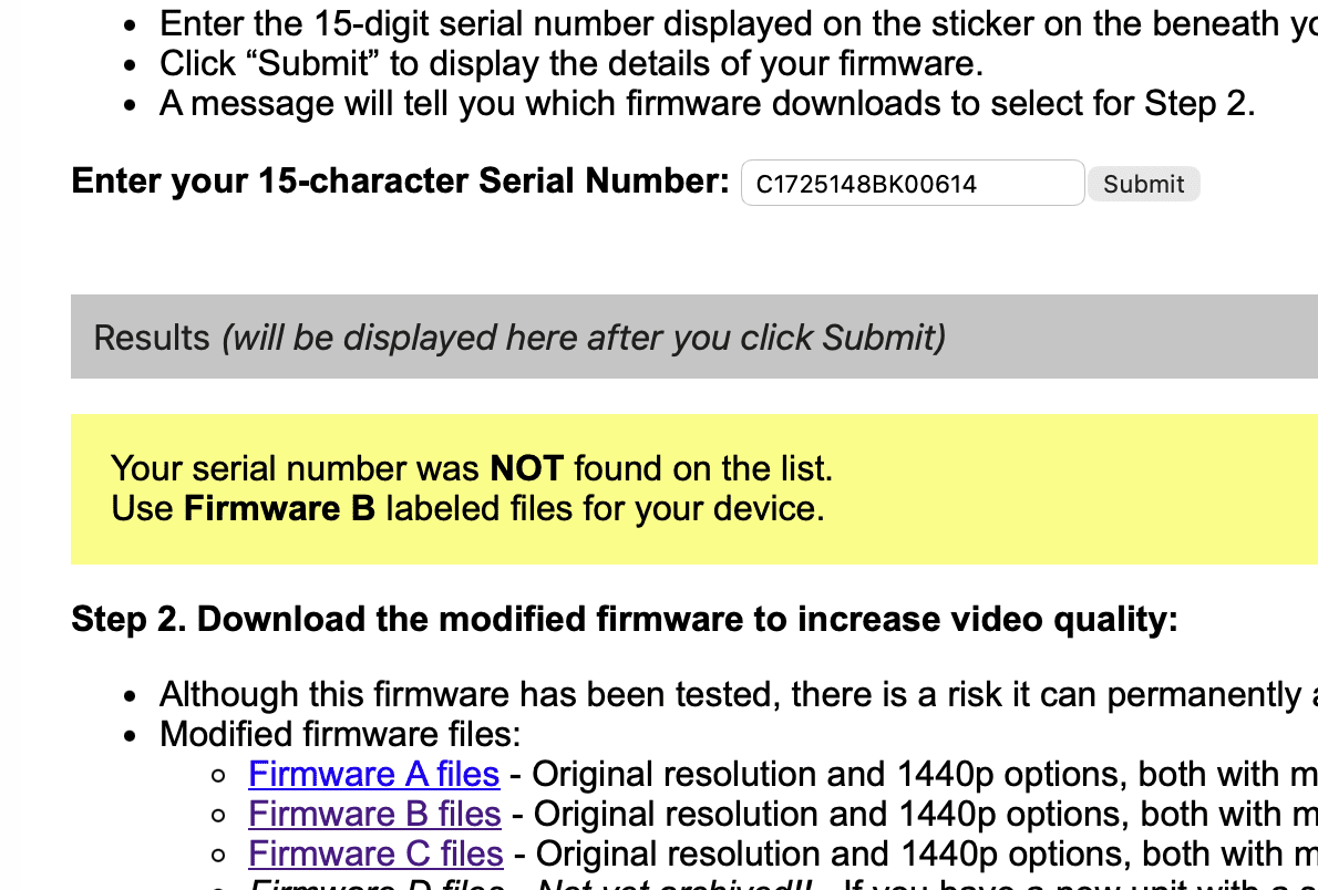

Please confirm if Type C firmware works.
Before I go ahead with installing it, you think that "C" is the right one.. the "look-up" page is pointing me to "B" (see screenshot)..sorry just want to be as sure as I can before I take the risk!

Jan 13, 2025
442
615
The look up page hasn't be updated with the newer serial numbers. That is Type C. Fortunately it doesn't matter, you can install the wrong version, then install the correct firmware, and it will fine.

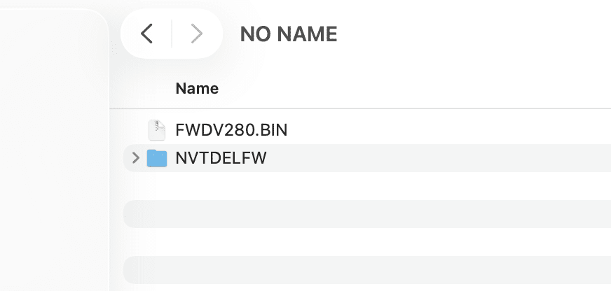

Just to be absolutely certain before I go ahead..the .BIN file doesn't actually go inside the NVTDELFW folder, the 2 sit side by side in the root directory, is that correct? Thanks, MD
That's how I did it. Successful install of v7.7.0 C

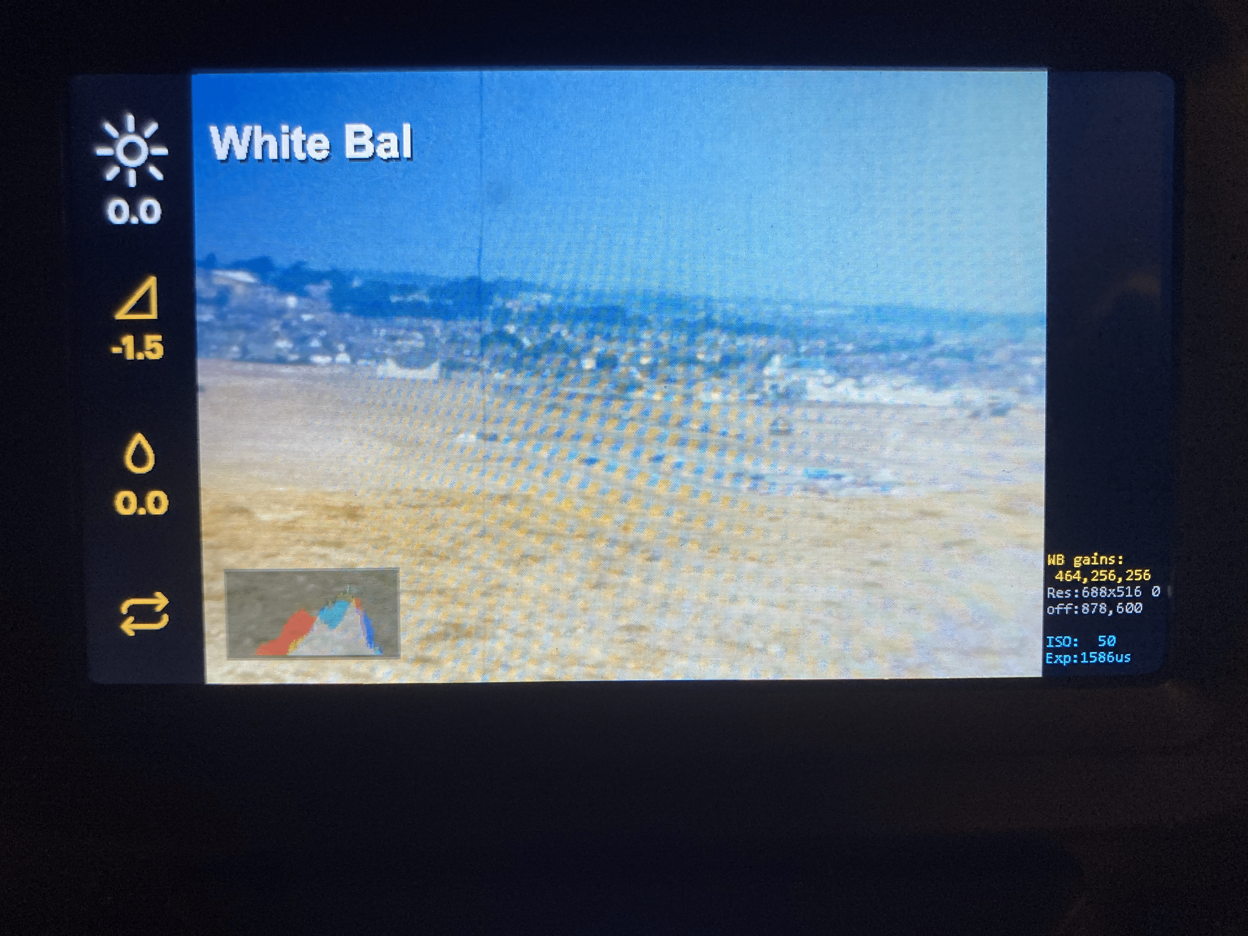

I have just installed the v7.7.1 firmware and can report the following: I am not able to progress beyond the "White Balance" setting, nothing after that is showing (maybe I'm being incredibly stupid but regardless of which buttons I press can't access any of the other "new" parameters). I tried a few seconds of recording but on stopping record the screen froze on the "playback or close" screen and the only way to restore activity was to hold the power button down and restart the machine. So.. not much luck unfortunately. I was using the "C" file. (my serial number C1725148BK00614). Should I try again with the "B" firmware, and if so, should I firstly install the factory firmware, or just go straight to the "B", and should I try the "restore factory settings" button? Would be interested to hear from anyone with a C17251 model to see what they've been able to achieve. Thanks in advance, any advice greatly appreciated.
Start with the documentation: https://tinkerdifferent.com/resourc...irmware-for-the-reels-8mm-film-digitizer.165/
Most of the new controls are only available during capture.
You have a C unit, no point installing B or stock firmware.

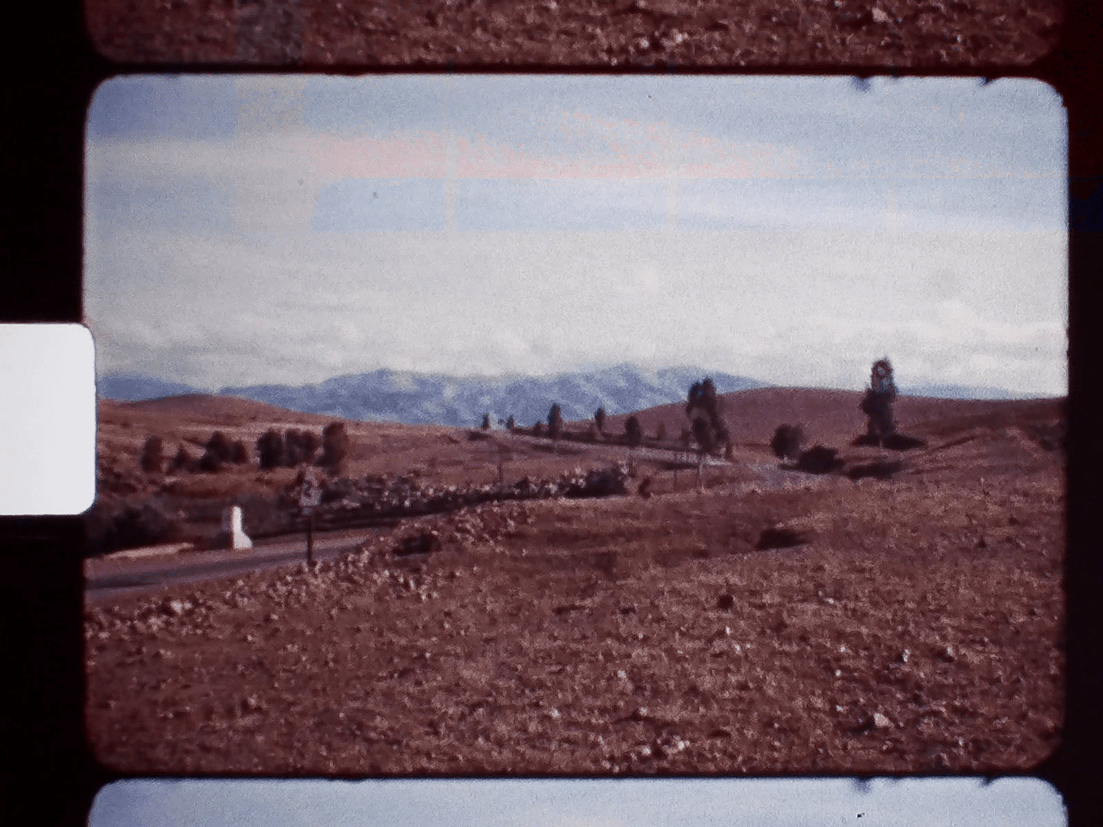

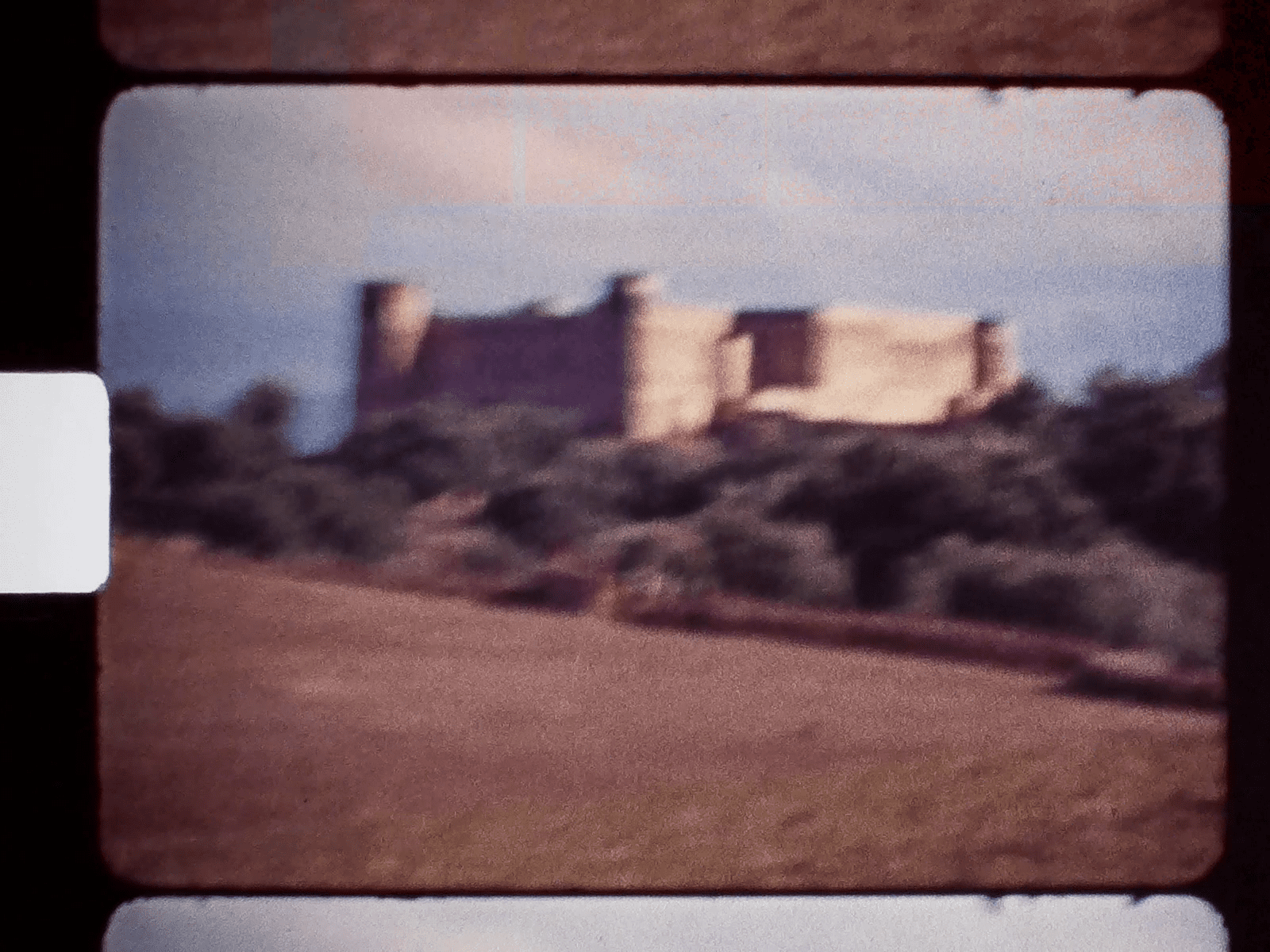

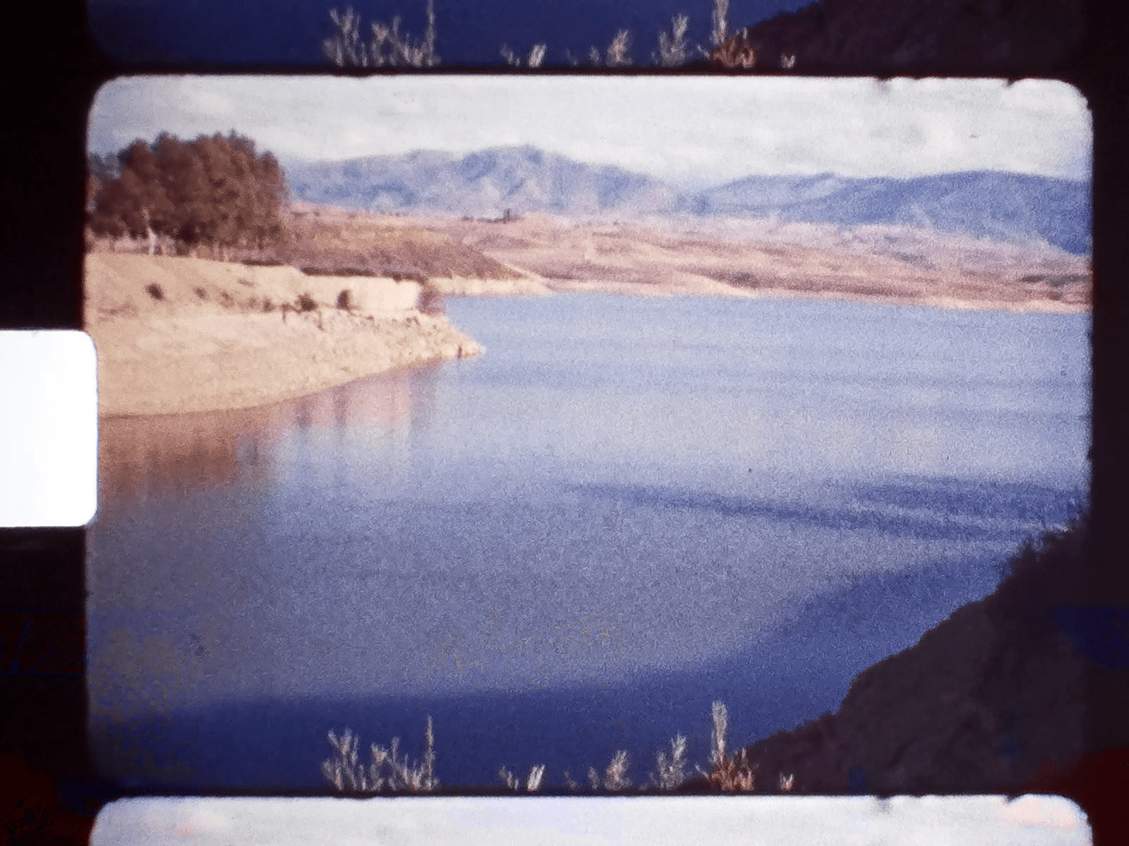

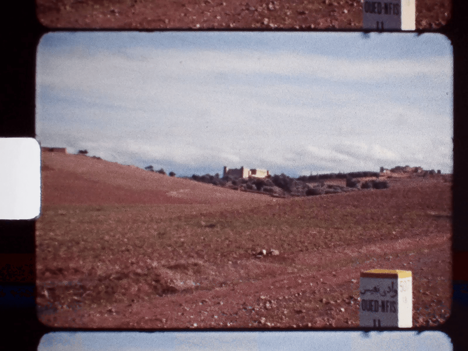

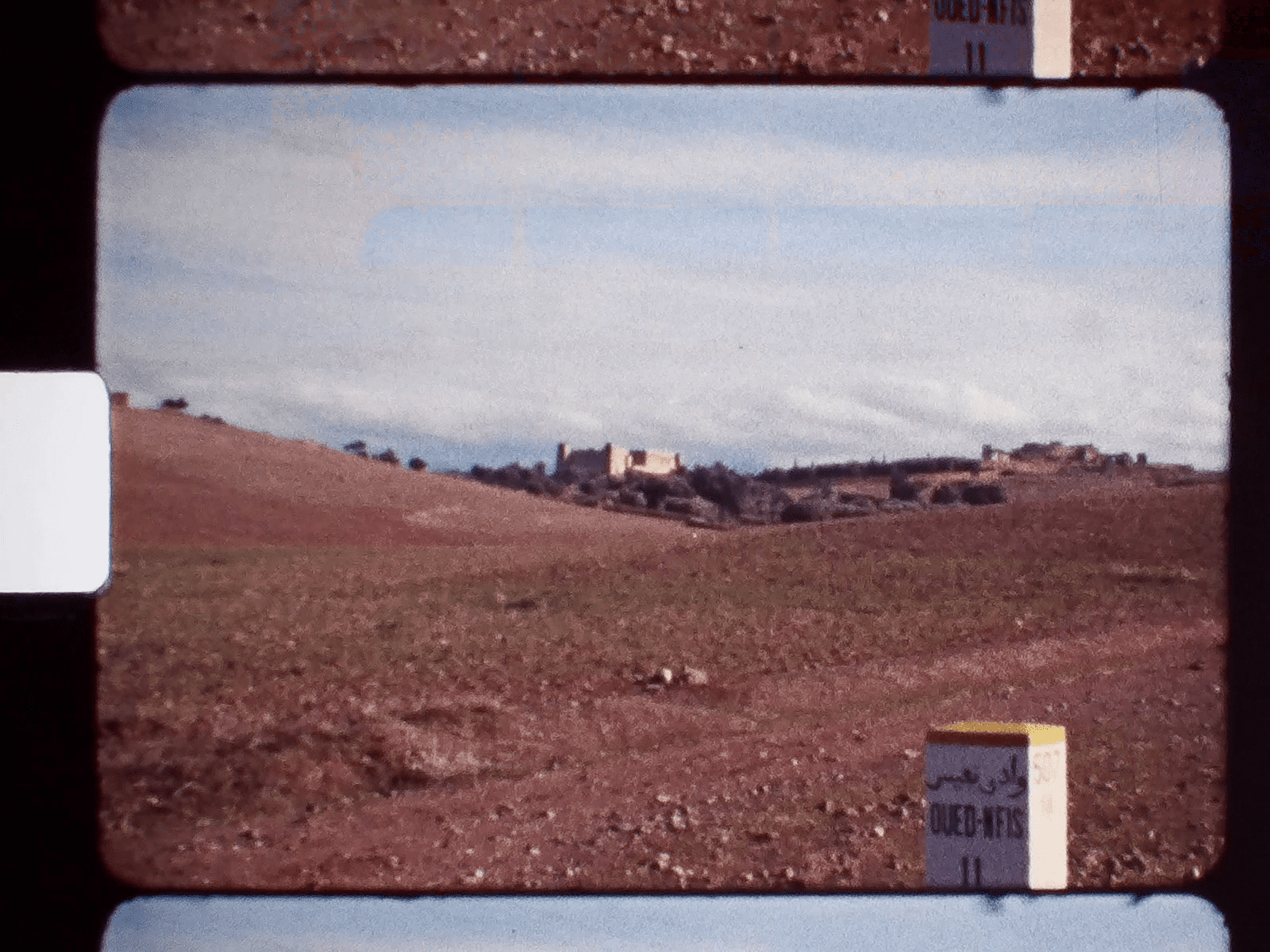

Hi, longtime lurker first time poster here. I bought a C unit last year and have only gotten limited time to test and modify the machine. I finally got around to installing the new lens from scorpion and had to buy new lens mounts from aliexpress to get the focus right. Now i'm encountering an issue with pretty blatant artifacts appearing at the bottom and top of the captured footage. It is a repeatable pattern every 96 frames and especially prominent in light areas such at the sky. I've confirmed that this pattern can also be seen on older footage captured before lens mod. I was wondering if anyone else encountered these or would know what caused these.
It alternates 2-3 times at the top with 2-3 times at the bottom. You can see the bottom example on the snapshot of the lake. Every Snapshot is paired with another frame where the artifact switches from either top to bottom or bottom to top.
This is a hardware design flaw.
Read about it here, and some mitigation steps: https://tinkerdifferent.com/threads...m-digitizer-new-thread.4885/page-2#post-42791
Reactions: Siocnarf
