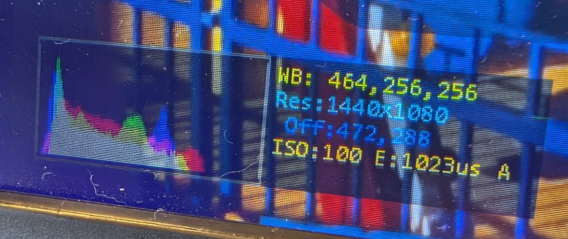

Hello @0dan0,
FYI I encountered this interesting glitch after I was zooming in and out of the frame, and it is persistent after power cycling. Notice how the top section has a hard line. It's like it's repeating a section or cutting out a section.
I haven't updated the FW in a while, so maybe this is just a side effect of the additional zoom/frame adjust options. However, just sharing in case it's helpful. In addition, when zooming in and out, the screen can glitch out for a fraction of a second, displaying horizontal bars for a moment.
FW model: 7.6.1
HW model: A
Thanks again for all your hard work!

I expect your new lens might be pointing to far to one side. When you are reframing to centering, might be using some out-of-range values. During preview share these numbers:
