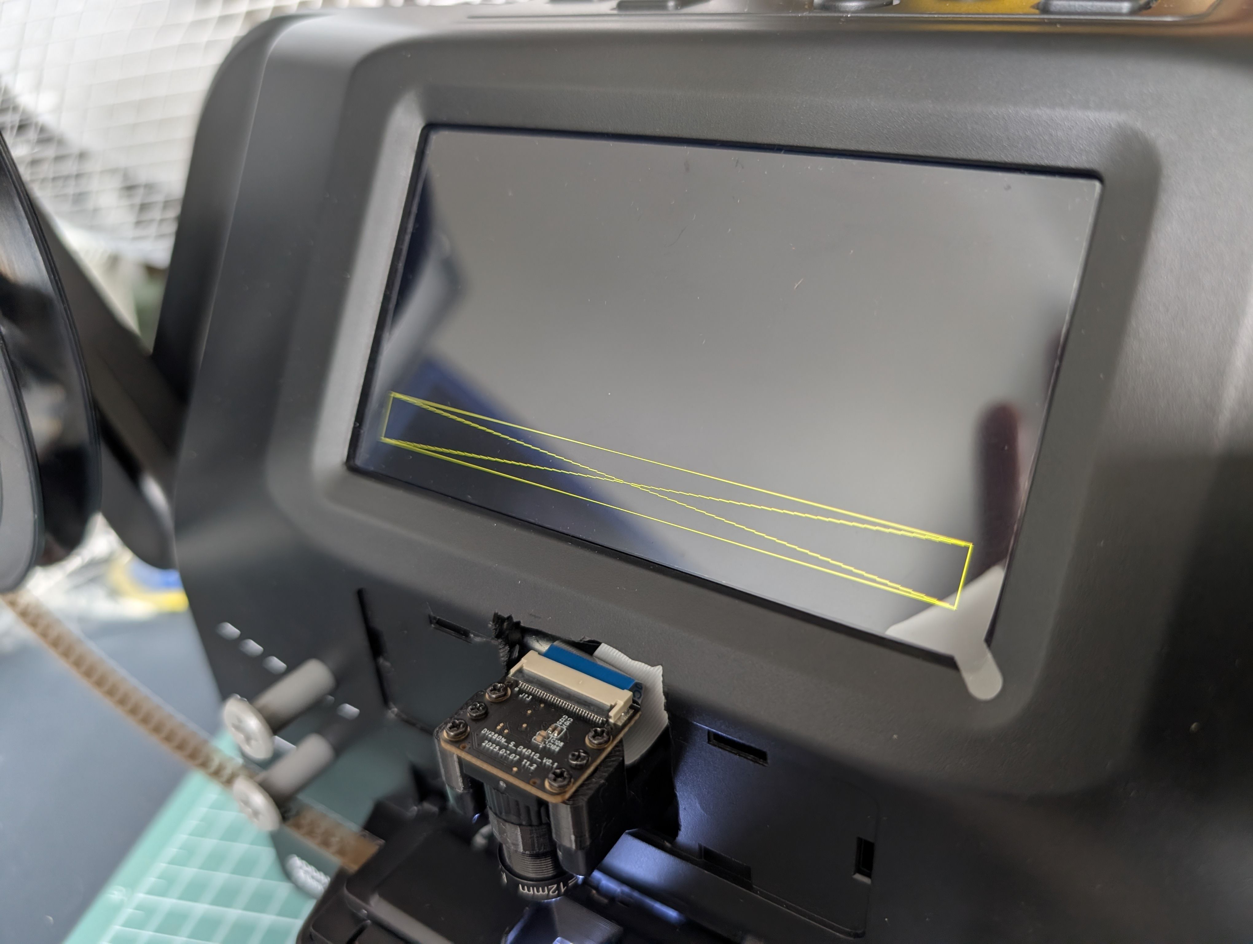

Looks like my EU supposedly-typeD scanner doesn't work with any of the type D firmware posted here, including stock. It shows this for like 5 seconds after hitting "Record" and then goes back to preview.

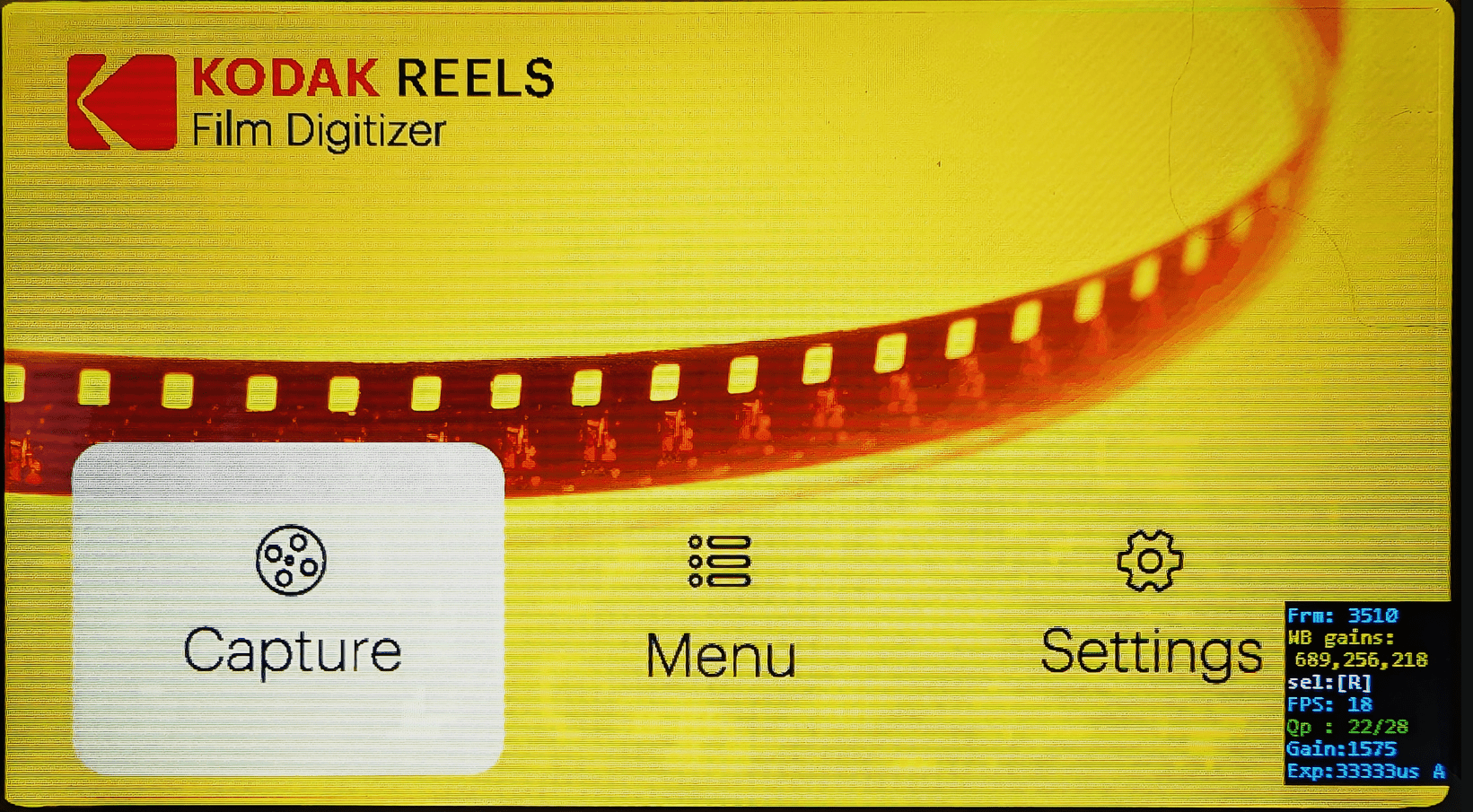

Progress update! Another Type D test build.
  • Reel-end auto-stop — the device detects when the film runs out (or a snapped/broken splice mid-reel) and automatically stops recording, finalises and saves the file, and halts the motor.
  • The auto-stop uses the exact same finalise path as pressing OK/Back, so the MP4 file is closed correctly.
  • Card-stall recovery — if a slow card can't keep up and stalls, it now does the same clean stop.
  • Menu-adjustable Qp floor (range 16–26, default raised to 22) — tune the encoder's minimum Qp to your footage.
  • Minor: on-screen Qp: current/lowest, "REEL ENDED — FILE SAVED" note after an auto-stop.
How the reel-end / blank-frame detection works
When there's no film in the gate — the end of a reel, or a broken splice — the sensor just sees the bare backlight, which is bright/white. The auto-exposure reacts by dropping to its minimum exposure (~118 µs on my unit). Real footage has much higher exposure values — mostly around 300 µs and up. So the firmware just watches the live exposure value every frame:
  1. It first "arms" once it has seen real footage (exposure above a footage threshold).
  2. After it's armed, if exposure stays in the "no film" range for ~20 consecutive frames, it fires a clean stop.
The "no film" threshold is currently tuned to my unit's exposure values. The white level should be fairly universal (it's the sensor's minimum exposure), but if your footage or lighting is unusual it may need tweaking — treat the auto-stop as beta for now and let me know how it behaves on your reels. There is a debug "Blk" row on the OSD that shows when the blank detection has armed and when it has detected 20 frames of blank footage.
How the clean stop (motor + file) works
Getting a proper programmatic stop was the fiddly part. Just cutting the motor leaves the recording unfinalised. Pressing OK/Back to stop actually kicks off a chain of internal UI events. Tracing that chain led to the top-level stop routine that does the whole teardown in order: encoder finalise → file save → motor stop → return to the preview state. The auto-stop simply calls that same routine, so it behaves identically to a manual stop — the MP4 is properly closed, the motor stops, and you land back in the preview mode.
For anyone poking at the firmware, here's the details (for Type D device):
  • Record vs. preview state: the movie-mode state byte at 0x80e0a624 reads 10 while actively recording and 8 in preview. Handy for any mod that needs to know the current mode.
  • The clean stop is a single call: 0x801203a0 (no arguments needed) is the top-level record-stop routine. It dispatches the stop UI event 0x04000326 — the same event OK/Back generate — which finalises the encoder and closes the MP4, calls the motor-stop function 0x80114a88 (which drives the motor register 0x80ddc670), writes 8 back to the state byte 0x80e0a624 (return to preview), and runs the UI teardown. Calling that one function is exactly equivalent to a manual stop.
Menu Qp floor
There's now a menu item (QpF) to set the encoder's minimum Qp, range 16–26, default 22. Higher keeps the encoder further out of the low-Qp zone that can choke on grainy content (small quality cost); lower gives a bit more detail. Tune it to your footage — it persists across power cycles.
Known issue: Occasional hard freeze
The hard-freeze (screen stuck on a frame, film keeps advancing, buttons dead, no file saved, hold power to reboot) is unresolved. I suspect it's an encoder-level issue that isn't specific to the build. Best current guess is a rare buffer overrun on complex/grainy content at higher bitrates: it's rare on short reels and more likely on long ones. I've seen the freeze also few times during testing and long captures.
What helps in the meantime:
  • A fast FAT32 formatted card.
  • The new Qp-floor menu — raising it reduces the low-Qp bursts that possibly correlates with the freeze.
  • Splitting long reels in multiple parts.
If you hit a freeze, a photo of the frozen screen (especially that Qp readout and the frame count) would be really useful data.
Feedback and bug reports very welcome!
