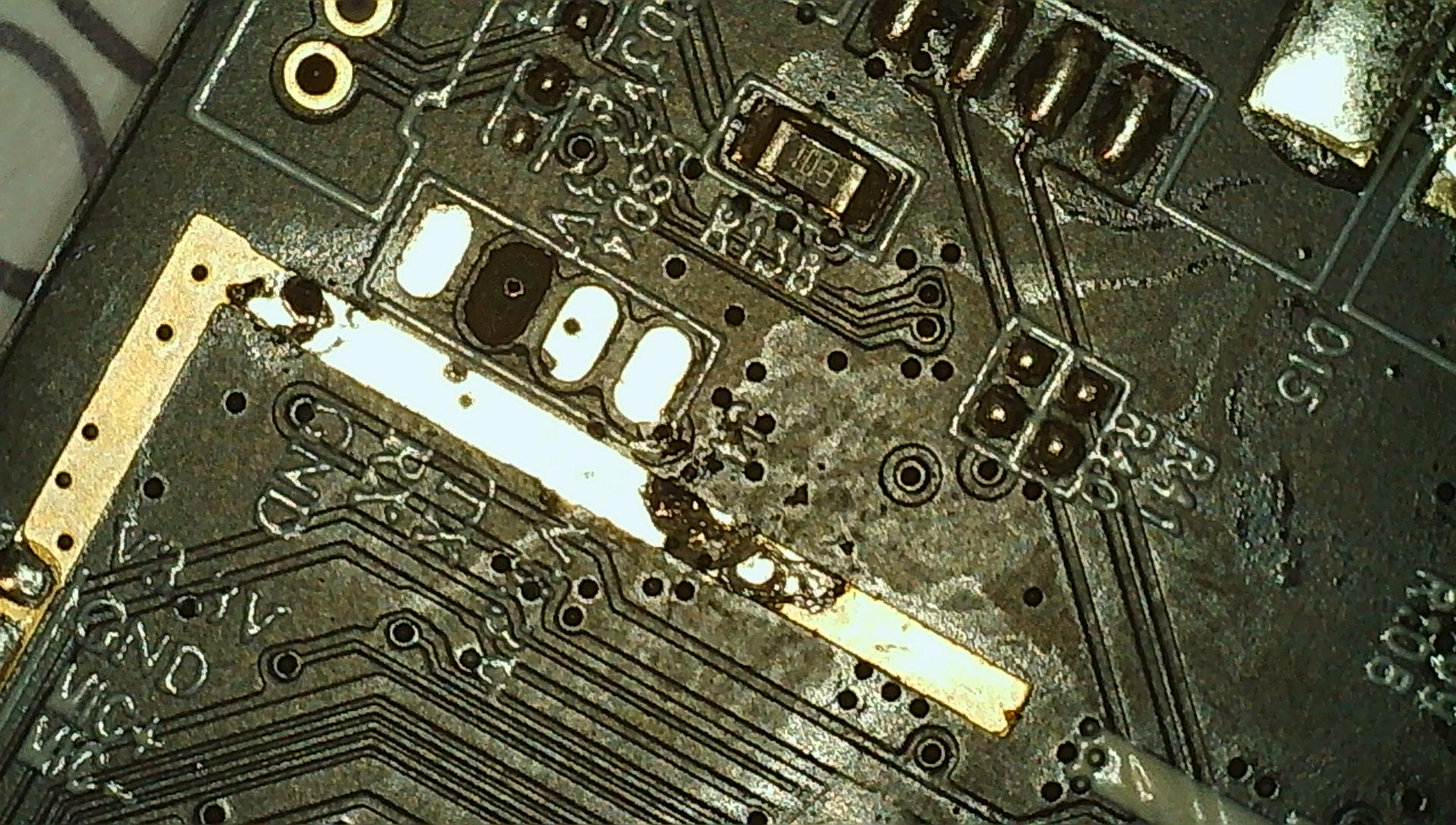

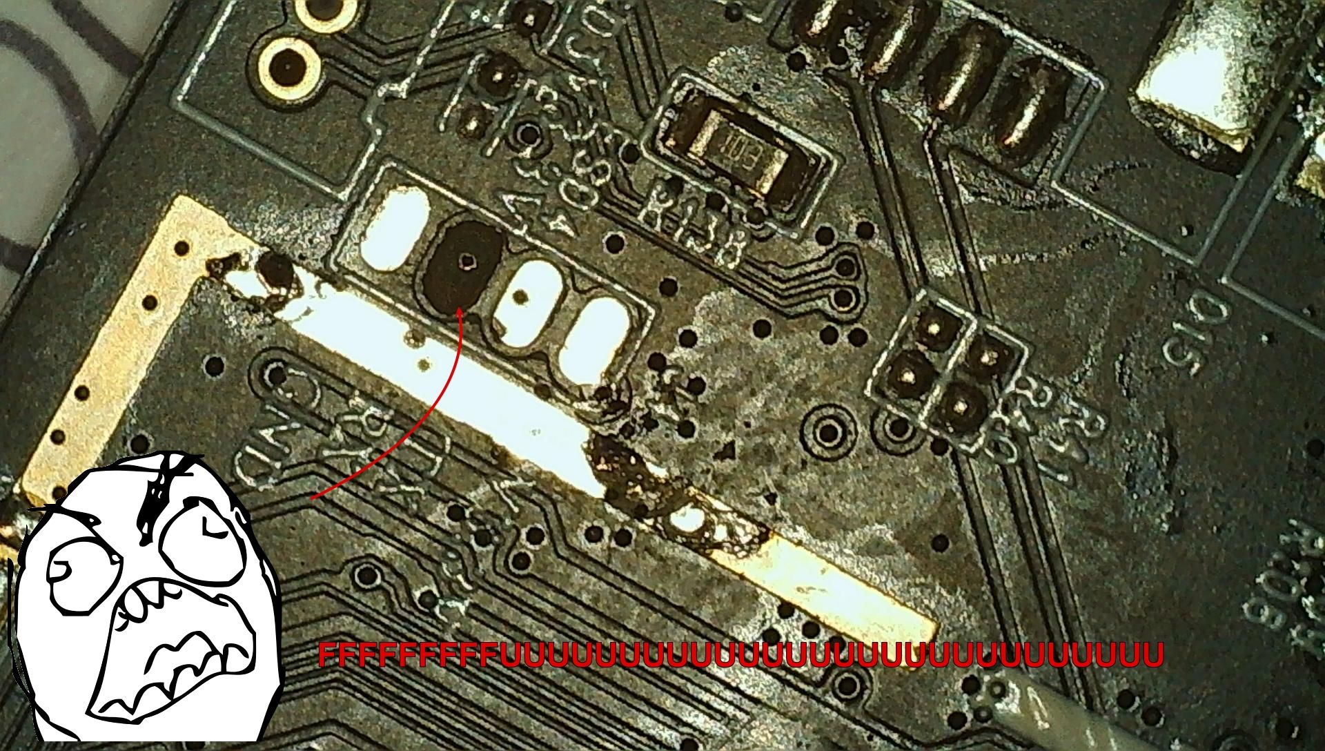

Ok. So I got it all apart with no issues.
However I've F'd it up. I managed to lift the RX pad and now I can't attach the lead. Let this be a lesson to me not to use my nice solid core wire, even if it's wonderful to handle.
So now I'm SOL with regards to dumping this firmware. If I can't manage to microsolder a couple of wires without ballsing it up, then I have no chance desoldering the firmware chip for reading.
Mac84. I can disassemble this and send you the board for firmware extraction - that's about my only hope of getting a read from this, now.
Edit: I have reassembled it, and so far it does appear to be working normally.

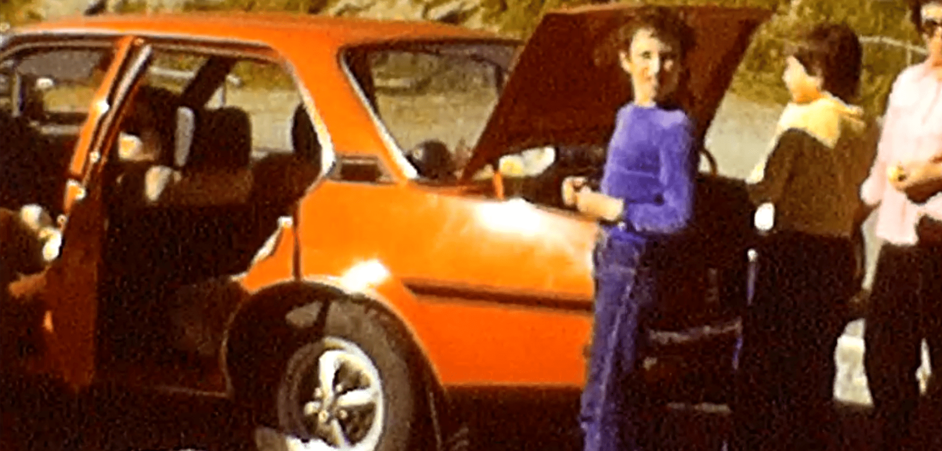

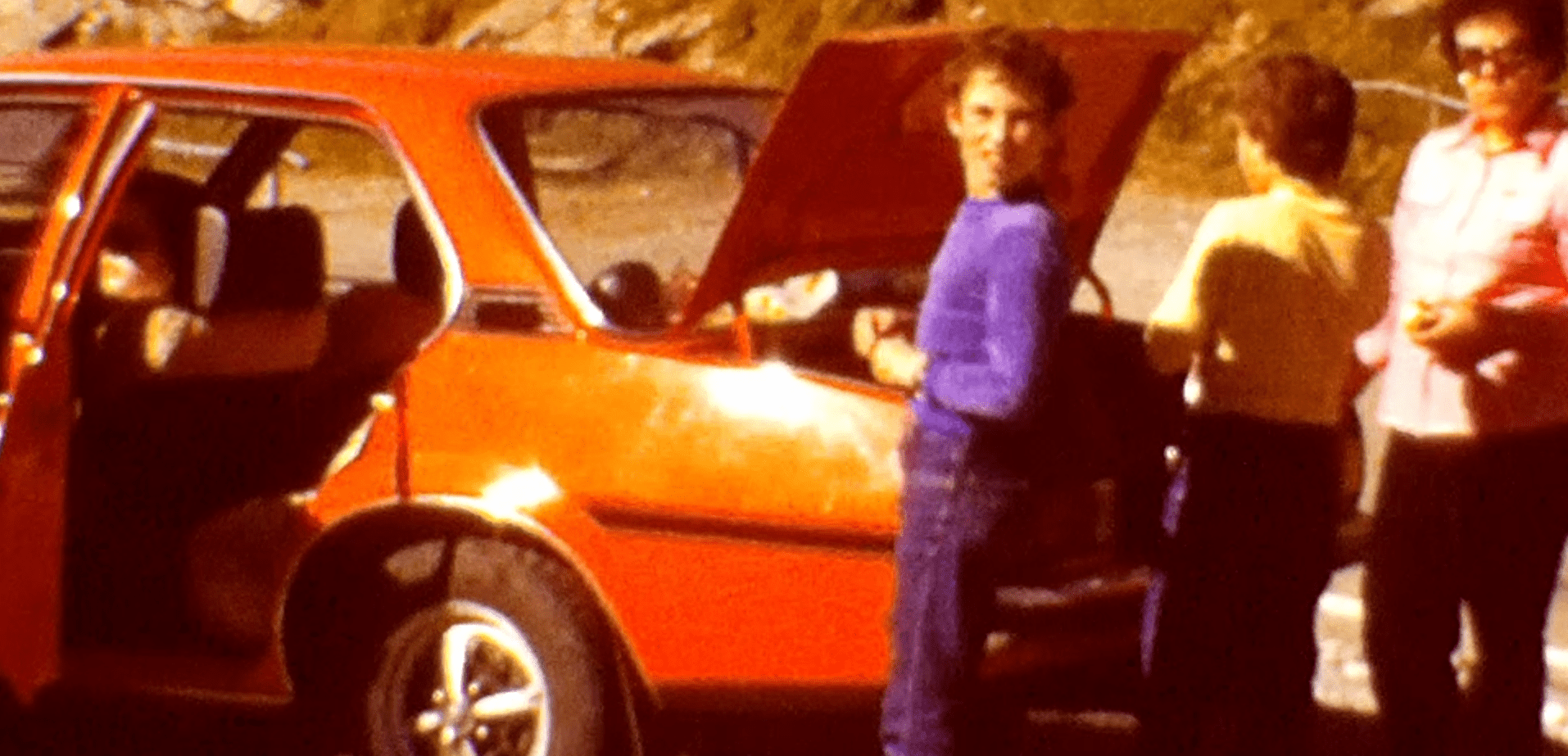

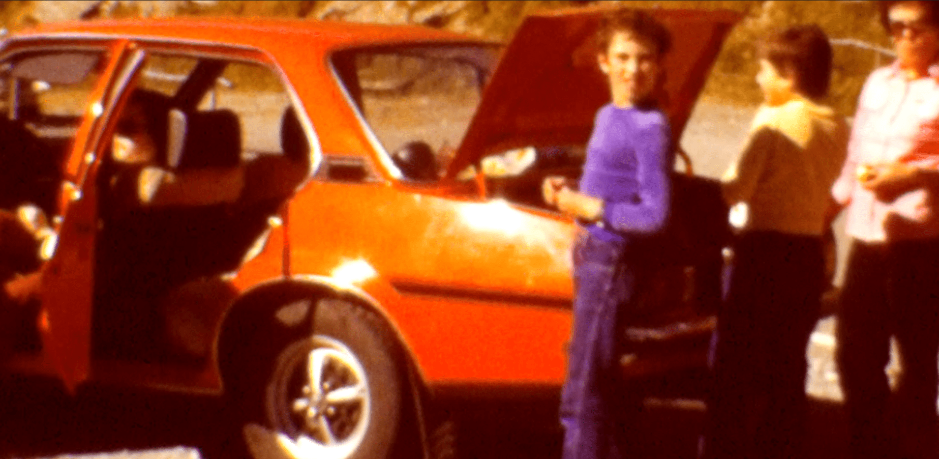

Please find before and after images. Before has sharpening 0 and after has sharpening -2 as I intend to sharpen in DaVinci Resolve or some place different and not bake it in.
Edit: I changed the image for a zoom, as there the change in quality is especially notable
- after mod: no sharpening (-2)
- stock, using sharpening dialed to 0 (a bit of sharpening)
- after mod: with tasteful DaVinci Resolve Sharpening
@melw , the automatic stop after the scan worked like a charm, thank you very much!
