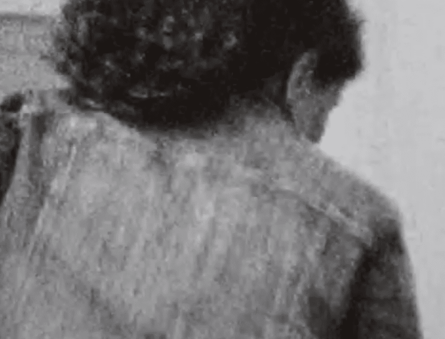

A still from a dark Kodak Tri-X B&W scan:
BEFORE (I believe this was set to -1.0 exposure, -2.0 sharpness, not sure of the tint, it seems to be reduced. If you've adjusted your image settings, I recommend before updating your firmware making a note of what they were):
AFTER (-0.5 exposure, -2.0 sharpness, 0 tint):

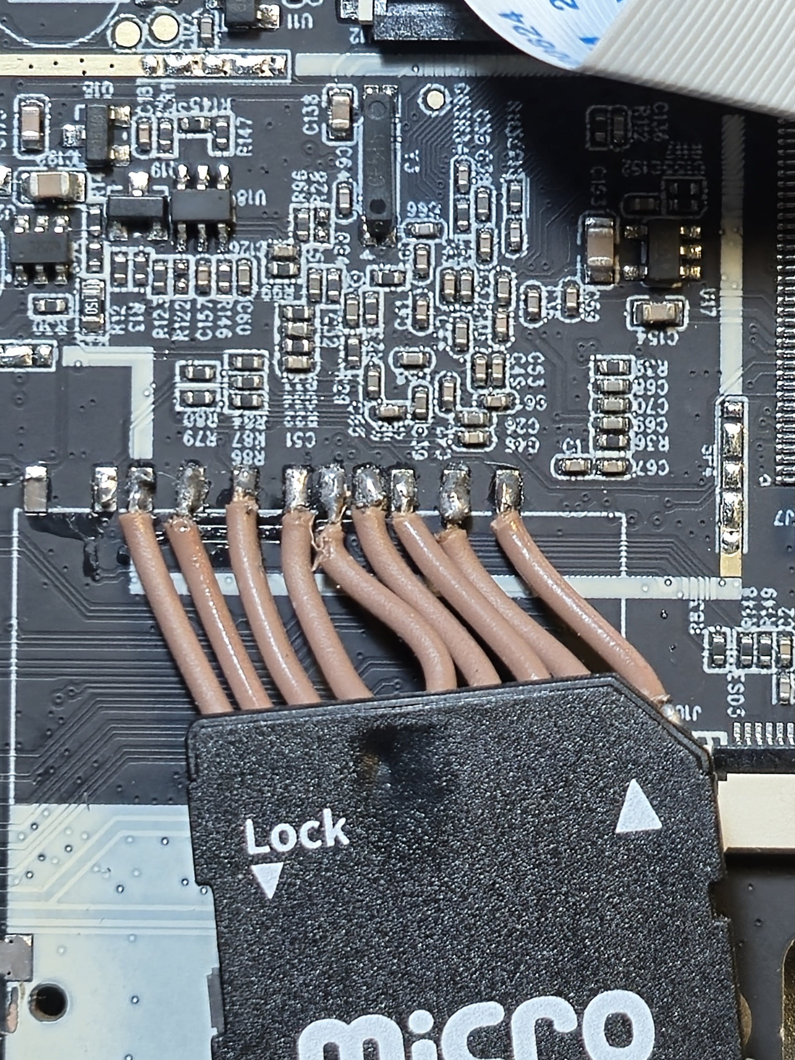

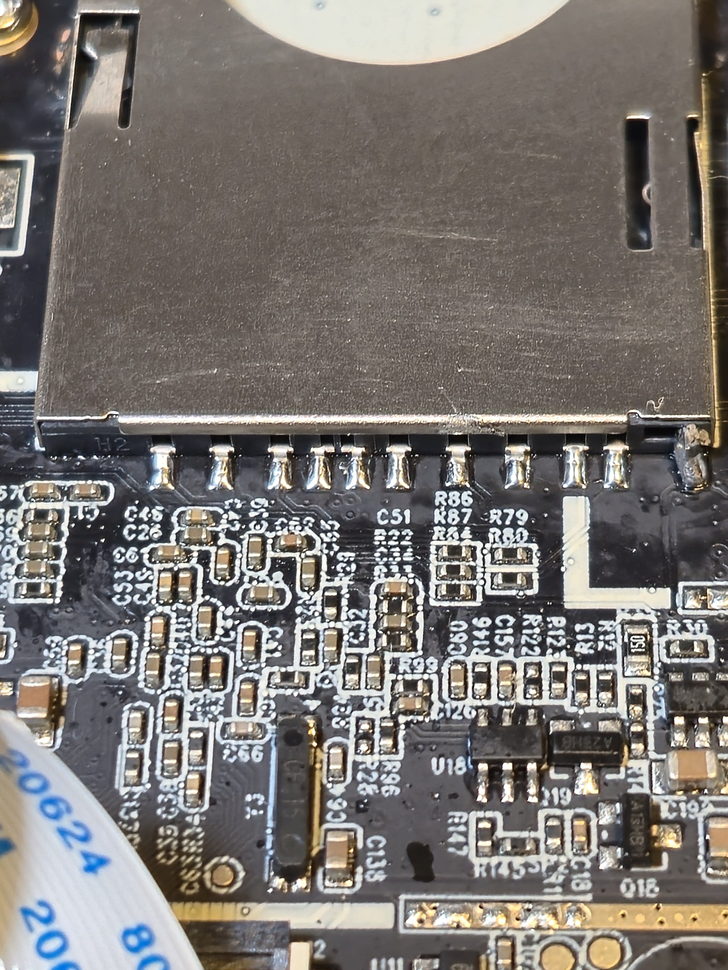

Well, I think I reached the end of the road.. :(
I removed the hacked-in micro reader thingy and installed a new SD socket onto the main board, then installed a new SD card. The unit powered up, and this time it went to the scan screen when I pushed the OK button and it didn't ask for the card like last time.. But, then it again asked for the card. With it running (I know), I fiddled with the SD card and found that the new socket is, I believe, defective. The card won't lock into the socket - the spring inside pushes the card back out. There is no flux inside the socket as I'm very experienced with that type of repair.
But while I fiddled with the SD card and tried to get it to lock, the Kodak shut off. I pushed the power button and no white power LED. I unplugged it for half an hour and still nothing. I disassembled and reseated all the ribbons (they are in good shape as are the ribbon sockets), but still nothing. I get 12V on the input board and 3.3VDC on the main board. I get 3.3 on the keyboard, but I don't see any SDA info on the keyboard. Under a microscope, I don't see any fuses. The board stays "cold" when power is applied.
There are four pins on the SC socket reading at ground potential, which seems like two or three too many. I'll check the pinout if I can find one on line and see if that's correct, and if not, see if removing the socket will clear the shorts to ground.
EDIT: the pic of the card socket with the red pins show which pins are reading short to ground. I haven't removed the socket yet, but will. But if this is the end, then thanks everyone for the advice!!
John
SECOND EDIT: I found out that pin 4 is Vdd (power source), so it should not be grounded. When I get a chance, I'll remove the socket and see if the short goes away. If it does, I'll order a socket that doesn't use a spring loaded mechanism because internet searching suggests the new socket could have failed mechanically inside shorting pins. Hopefully it didn't trash the board.

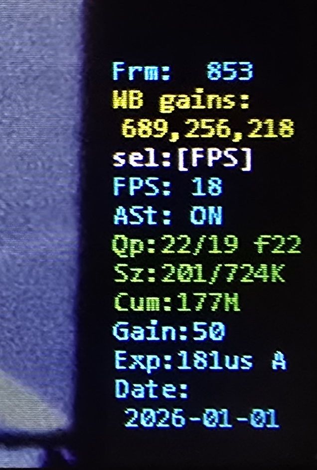

How to adjust custom settings? I just got a brand new Reels scanner this week and the work-in-progress D firmware from 2026-Aug-24 seems to be working fine for my first test reel. However, I'm confused about how to adjust the custom settings, can someone explain how a user can change the settings?
The User Guide and Reference gives the impression that some settings are changeable before capture, and others during capture, but I don't really see any way to change them before capture at all. During capture, at least on this firmware, it seems like the arrow buttons don't do much. The on-screen display shows various things but the setting with [ ] brackets is "sel: [FPS]" and if I use the up/down arrows it stays on "sel" but simply lets me pick other values (instead of just "FPS"). The left/right arrows do nothing during capture, as far as I can tell.
Is there a guide that goes into more explanation about how the settings are meant to be tweaked?
In good news, the default settings seem pretty good, already a huge improvement over a couple things that were dealbreakers for me in the stock firmware (auto white balance turned off, improved resolution, 18 fps metadata on the final MP4, etc)
Thanks to everyone who has advanced the project this far already!
Maybe you've already seen this but post #653 has instructions for changing settings:
For me, they are not intuitive and I don't think I'm using them correctly so if you figure out the best way to tweak them, please share!
I agree that the defaults are good and I agree with your deal breakers.

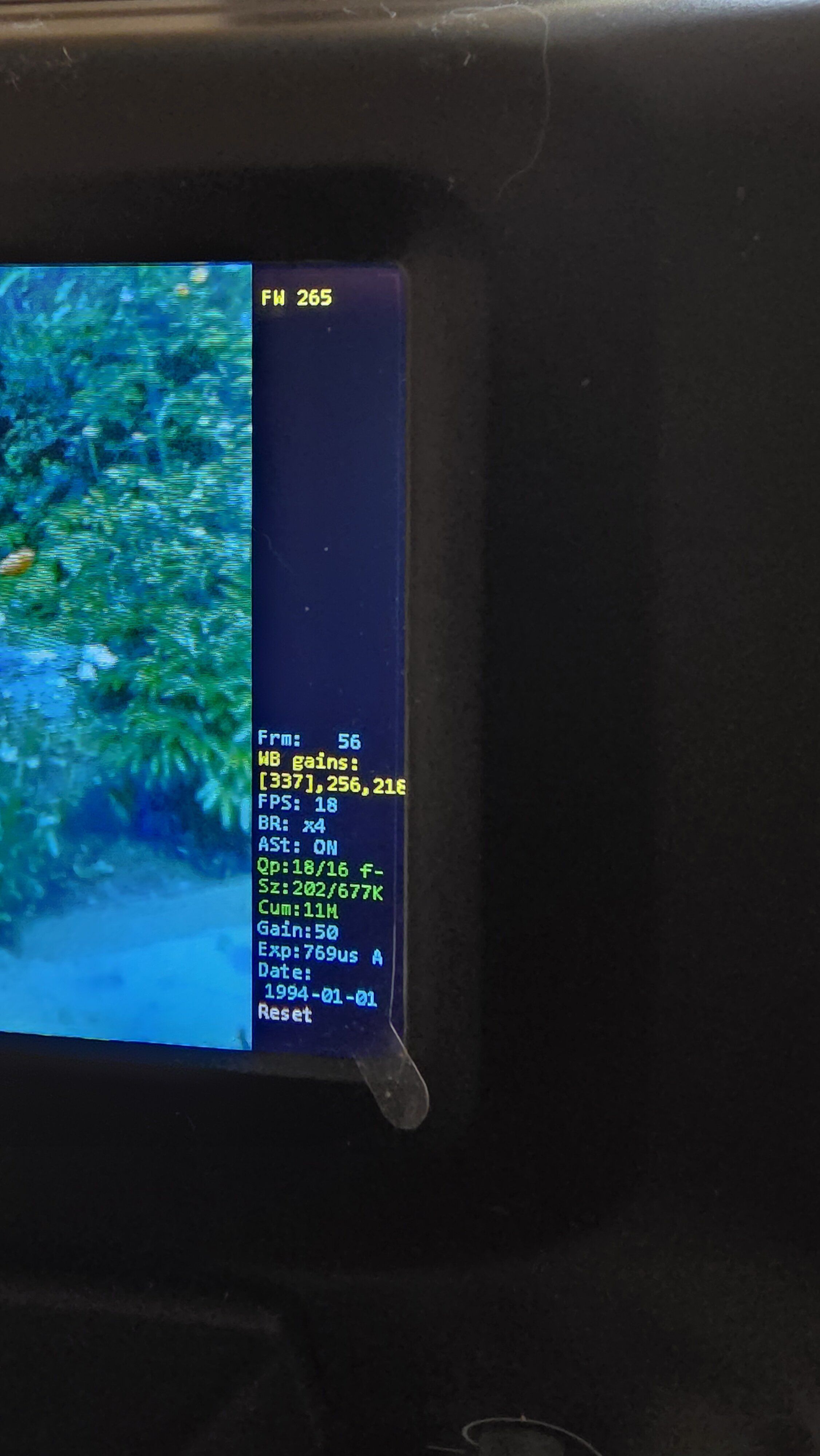

  • Build number on screen — FW 265 in the top right. Please include it in any report — makes it easier to distinguish which build version was used
The settings menu has been reworked
Now the [ ] marks the value you are editing, directly:
Code:
WB gains:
[689],256,204     <- editing red
FPS: [18]
BR: [x4]
ASt: [ON]
Qp:22/16 f[-]
Date:
[1984]-09-01
[Reset]
  • Up / Down — move between settings; the brackets walk down the list and wrap around
  • Left / Right — change the value by a big step (white balance moves in 16s, the year in 10s)
  • Minus / Plus — fine adjustment, one step at a time
Few things worth knowing:
  • Settings can only be changed during a recording. In preview the stock firmware owns the buttons, so there is nothing to find there — you are not missing a menu
  • Settings are saved and survive a power cycle. So the easy way is to start a short throwaway recording, set everything up, stop, and then do your real captures. [Reset] puts everything back to defaults
  • FPS and BR settings only apply for the next recording cycle, not the currently ongoing one

  • If you do hit a freeze, photograph the frozen screen. It now shows the build number, bitrate, Qp range, frame sizes and total bytes in one shot
  • If anything else behaves oddly, just let me know!

Hi @jmccabe - please try the build I just shared (forum post #731). Among all the fixes, reworked also how the menu & settings functions. Hopefully it's bit more usable now!

  • Fixed the OSD flicker. The stock UI was clearing the UI layer in two different places. The OSD now redraws immediately when that happens.
  • Stall auto-stop timing corrected from build 265. 270 is back to ~8 s to warn, ~12 s to stop. The x4 auto-stops some of you saw were caused by the Qp floor, which has been off by default since 265.

Thanks for the super-fast update! It's perfect timing for me because just today I had my first experience of the capture process aborting (on my 8th reel, only 112+ to go). The digitizer was continuing to move the reel along just fine, but about 15 minutes into the scan the software was no longer capturing and had stopped responding to button presses. I had to unplug it from power in order to reboot it.
The new firmware seems to be working fine so far! The only weird surprise for me is that when I booted up with the new firmware on an SD card, it didn't apply the update, and continued to boot up in the existing firmware (from last month). It initially seemed like SOMETHING was happening because the boot-up screen was present for like 15-20 seconds, instead of the usual 4 or 5 seconds. But when I started another capture, I didn't see the new firmware indicator in the upper right. To investigate, I turned it off, unplugged the power supply, checked the SD card on my computer to make sure it was the new firmware (it was), then powered up again. On this second power-up the screen stayed black and it successfully applied the firmware update just fine.
Thank you so much for adding the FW build number on the capture screen now! It made it trivial to verify that I had the correct version installed.
