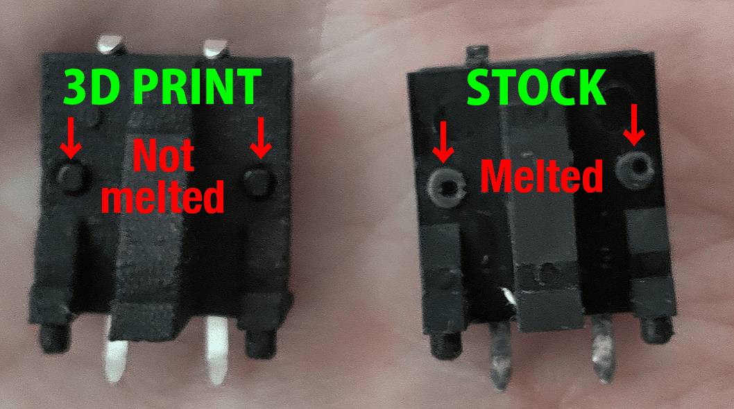

I'll make a proper post and github repot for the interrupt/reset switch back but until then here's the latest models. I updated the height slightly.
License for the models are CC-BY-SA
Thank you for that!
By the way, I see in your photo that you didn't yet melt the two posts, as is the case on the stock switch mount...
That would need to be done, once the switch is installed into the mount, to ensure the switch remains firmly affixed.

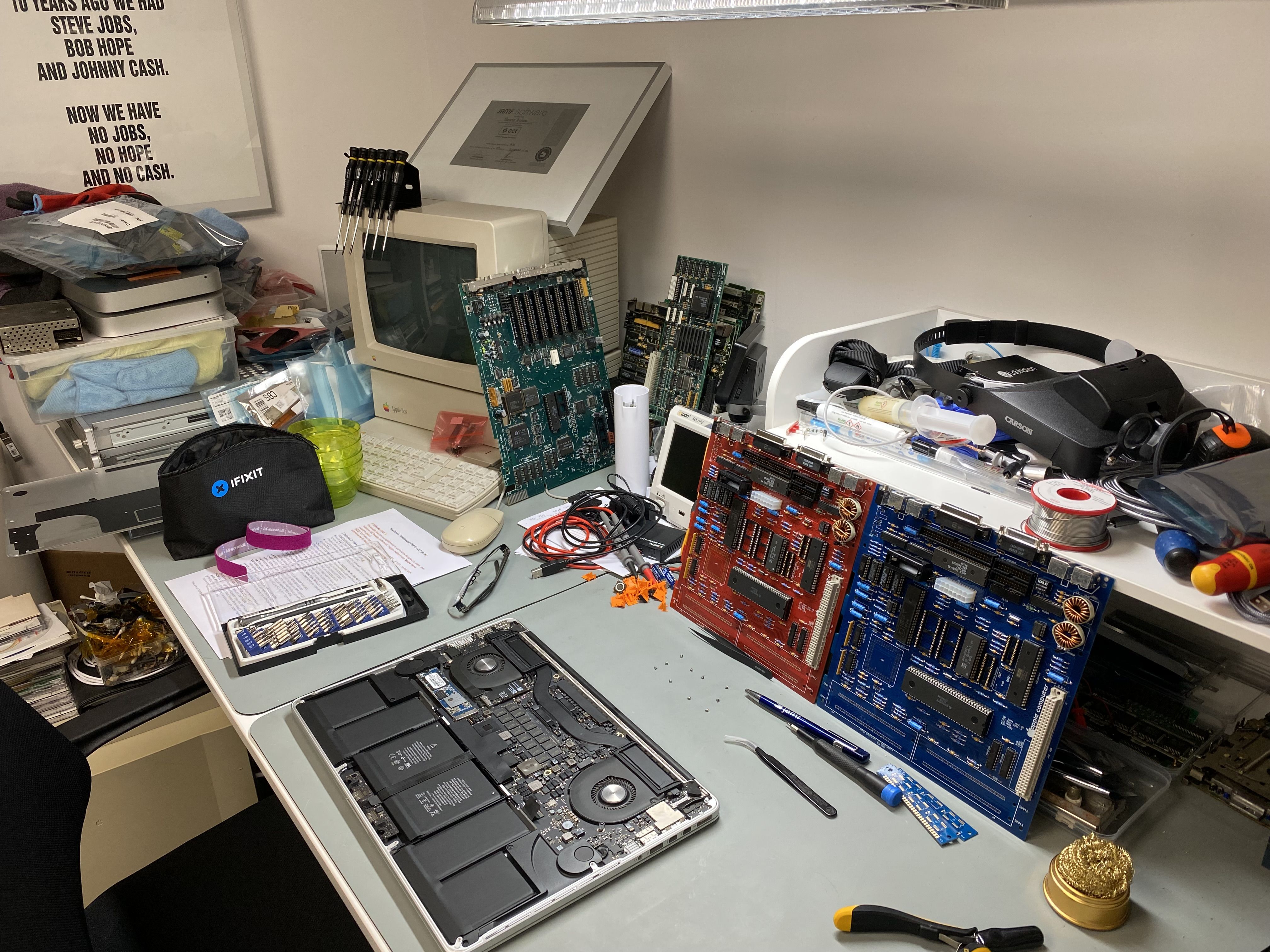

so.... now I have matching red SIMMs :)
OK, slightly different red, but they will look nice. If any is building a red version, I have some spare, as I did not feel like ordering only 4 from JLCPCB :)
So, @JDW it will be a matter of matching blue or glowing red pill !
BTW, I don't see many people talking about SE reloaded boards, do we have an idea on how many did or are playing with it ?
Oh @alxlab the battery replacement PCBs are just a great idea ! I also made a lot for all the Macs I need to repair (even though I could fin 1/2 AA without much issue). Just keep green, this is much cheaper.
Fixing a IIsi (motherboard below) first so I have more room... The PSU was the Italian version, not Teac or Sony and honestly, one of the worst PCB I had seen, looking like cardboard. anyway, the capacitors that smoked are all replaced now, I hope I survive powering it back up ! lol
