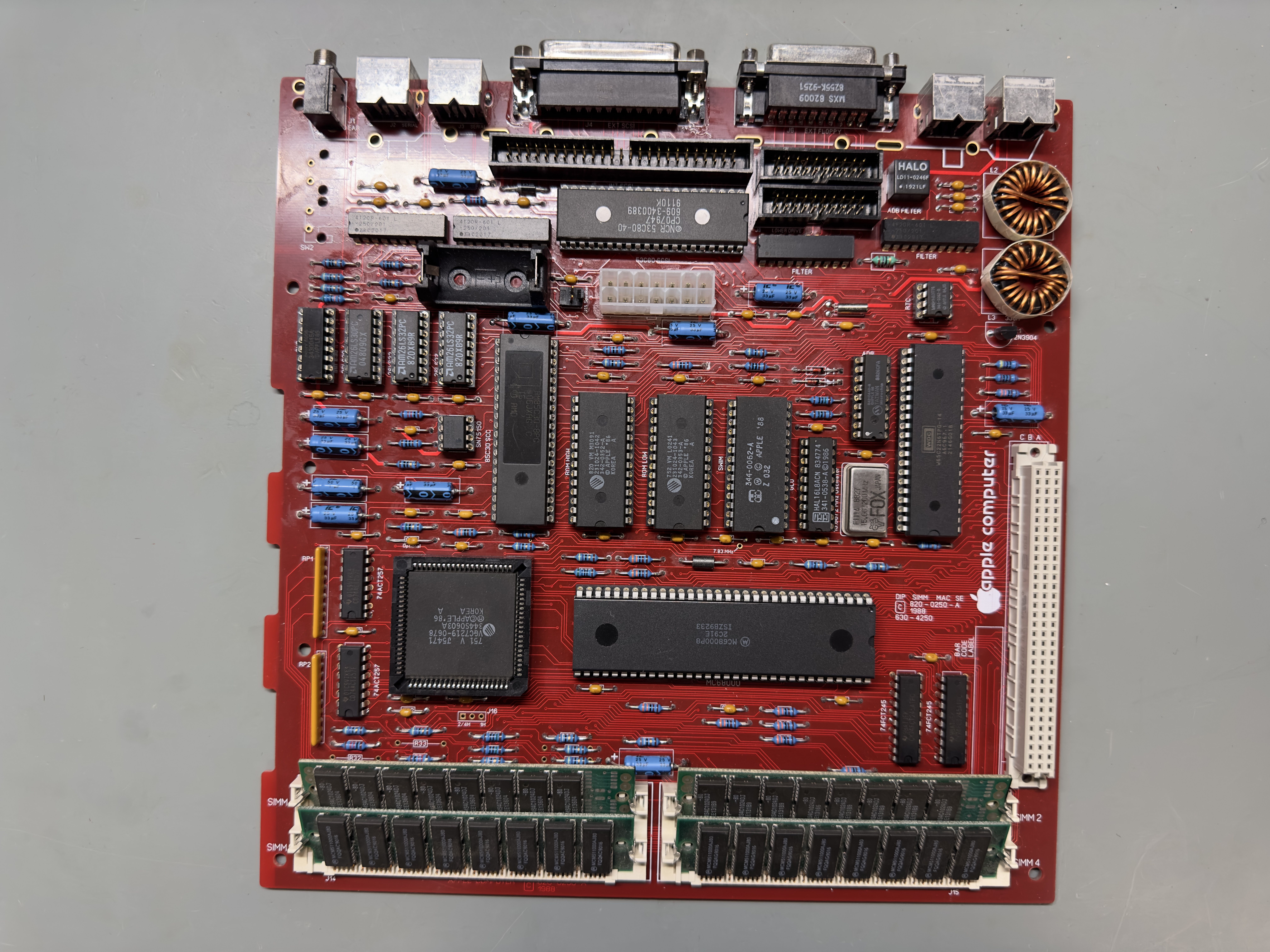

Hey all !
I now have 2 donor boards to complete my SE reloaded ones. Both are fully functional.
As you can see from the picture below, they do hold two different Part Numbers : 630-4125 and 630-4250.
Do you know what the differences are ?
Apart from the silk screen colour, a jumper for RAM size selection on the right, and a few ICs of different brand, I can not really spot a difference.
No leakage or damage to the boards, I will remove the battery anyway. (I never had a Varta leak though).
Also you can spot some unusual SIMMs on the left hand side.
Now... I think I will flip a coin to know which one will be the first donor.... unless anyone gives me a specific reason to start with any of them ? @JDW ? @Kay K.M.Mods @Kai Robinson ? :)

And... first attempt, no boot.
Some hissing in the speaker, display turns on, but image is garbage.
The tube is scanned, definitely, but it's like half the lines are missing.
I need to make a J12 extension cable, otherwise troubleshooting will be difficult !
And back to schematics, now the fun part starts.

So, as mentioned just above, first power-on did not go very far.
No bong and a weird hissing sound in the speaker.
The CRT comes up with a very bright image and very visible scan lines.
So at least we have some scanning, so some clocks are working.
I'm checking again all soldiers, continuity to ground, and other voltages, continuity between J12 and components.
Could be so many things....
The SE case I'm using was not recapped, but worked fine with the two other boards, so I'm currently assuming the analog part is ok.
I may try later in on of the known good SE/30 case with recapped Sony PSUs.
I'm also looking at powering the board with my bench power supply and see if I can get some timings on the scope. But I guess that will be hard, because of the links with the analog board...
Really need that J12 extension. :)

Hello all ! The red SE/reloaded board is alive !!!!
It was a stupid mistake. I had the 85C30 SCC upside down (plus potentially a few BBU pins slightly bent, but I'm not sure). :( I can't recall how many times I did check orientation of components, especially this one, and could not see it.
So the Mac is now booting, I get chime, picture, mouse cursor and... sad Mac (see below). Picture is slightly offset but pretty good quality.
Now I had not time yet to go further, but I'm open to advices. I need to get back to sad Mac codes (could be memory, this was indeed a very quick test)
Many many thanks to @Kai Robinson and @JDW !! Couldn't have make it with our your help.
