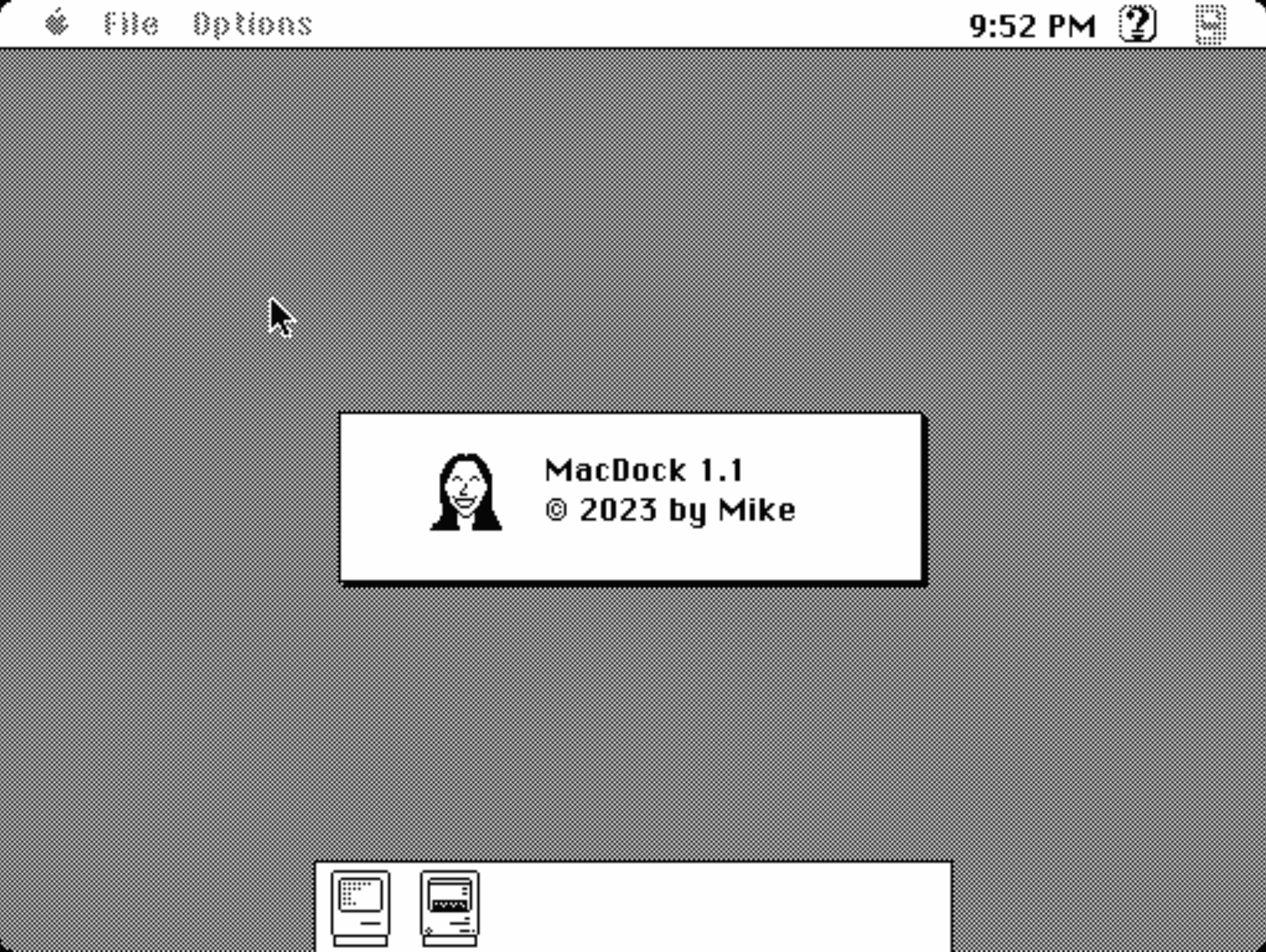

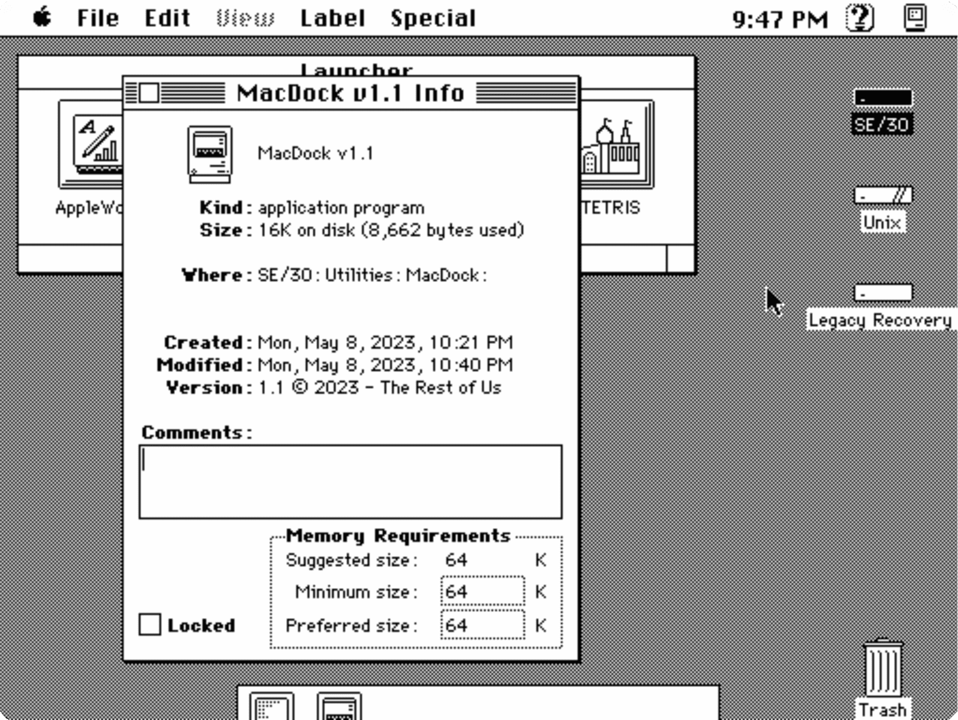

  • v1.1 -- 5/8/2023
    • No longer keeps After Dark screensavers from triggering when idle
    • Reduced CPU utilization by being selective about when to redraw the Dock and its icons
    • Added "About MacDock..." dialog
    • Reduced RAM requirements to 64k
