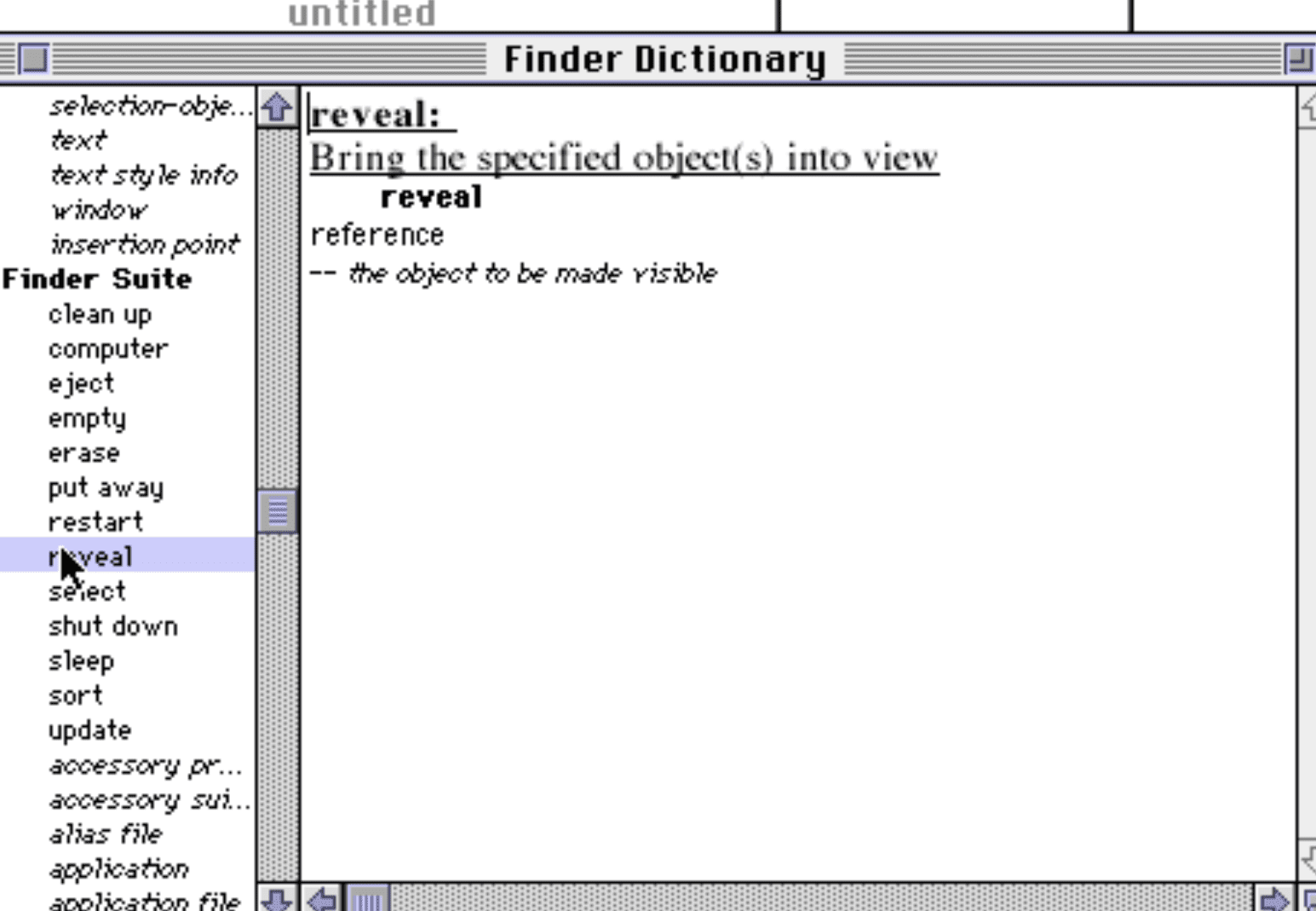

Quick update -
With the great help of folks over at 68kmla, based upon the suggestion from Crutch on here, the AppleEvents thing was figured out.
Link to thread here but for continuity here's the deal:
Only a portion of scriptable calls are in the Finder (at least in as late as 7.5.5). Additional ones (3 "Suites" worth actually beyond what's in the resource fork of Finder) are in the Finder Scripting Extension extension that is in the Extensions folder (but only appeared in like 7.5.2 I believe(?)).
There I found some better-suited events for what I was doing. Namely the Reveal event.
It takes in an FSSpec descriptor as a parameter (rather than a list of aliases as I was trying to make before for the Open apple event with eventID "sope").
Anywho after some awesome support and even example code thrown my way by member "cheestraws" at 68kmla I was able to make it work on my side.
So without further ado -- here it is. When you have the Command key pressed down and click on an item in MacDock it will pull up the location of that application in the Finder. Again - this is just like in modern macOS btw!
With this feature (in the update coming soon to MacDock) both the Cmd+click and Option+Click will work as they do in modern macOS. Note that the option+click came 'for free' based on how the Apple's provided / built-in "LaunchApplication(..)" function behaves which was neat.
