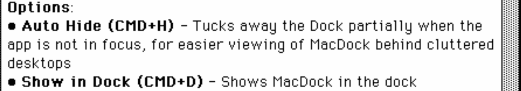

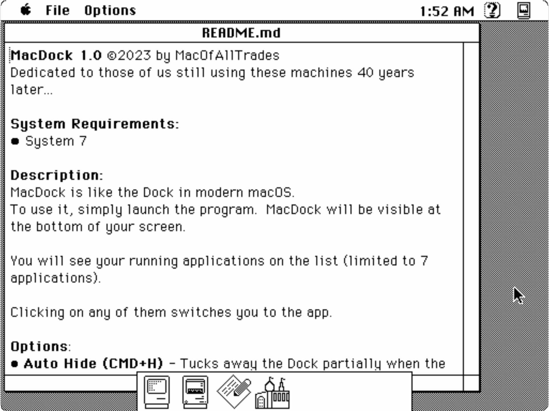

However, the dock only hides half way.
Yes, that is by design. If you read the README.md file in the MacDock folder, @MacOfAllTrades explains:
Here is an example. Notice it's easier to see? Then, when clicking on the dock itself, it brings the MacDock to the front.
I would like it to hide all the way, though. Maybe in a future version? :)

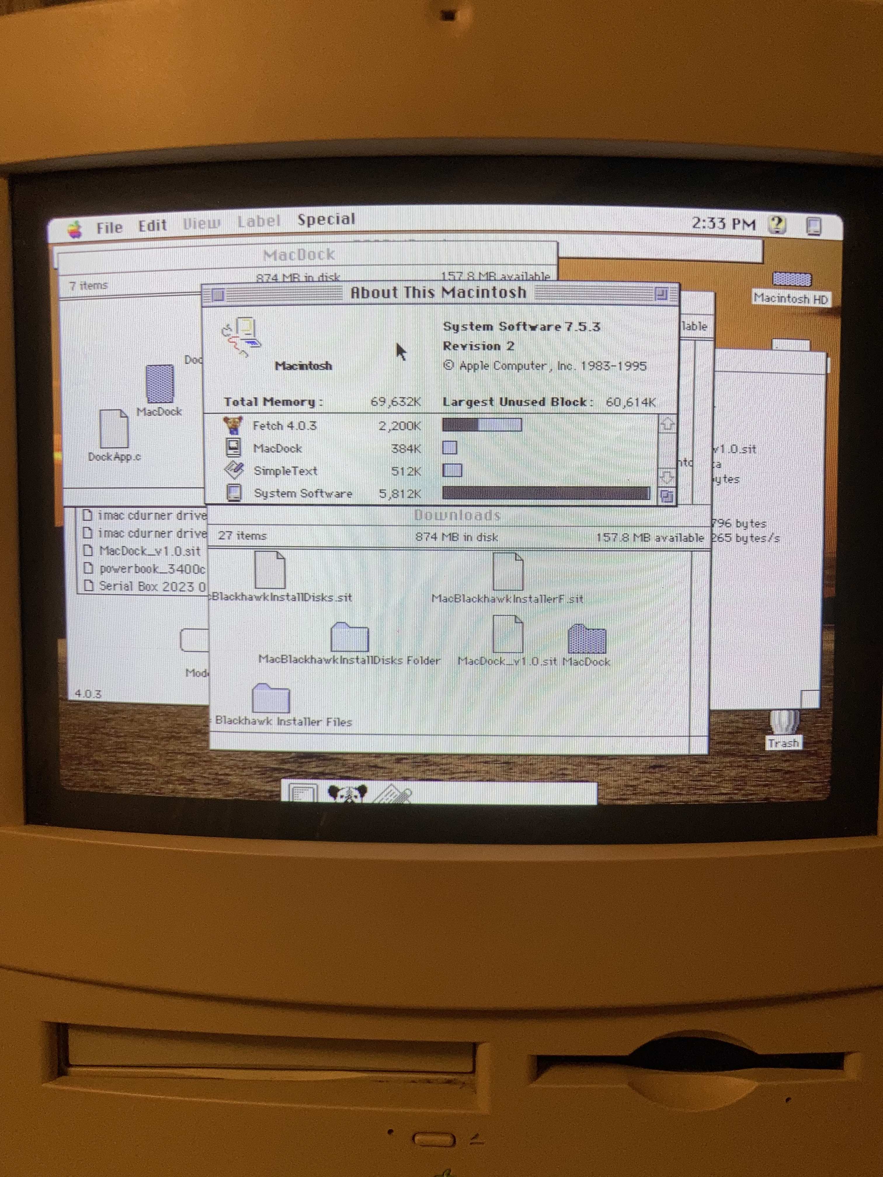

What I neat app! Excellent work. Works good under 7.5.3 on my P575. However, the dock only hides half way.View attachment 12083
Yes by design. Just a partial hide so its still useful even in a cluttered desktop.
i may add a full hide option (but id still leave a little nub or tab there that you could click on. Otherwise the only way back to it would be to use the traditional app switch menubar menu which if already there then youre probably able to switch to your destination app directly :p
