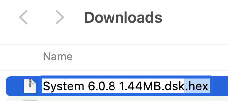

I reduced my system down to a floppy disk and verified that it sleeps when booted from a FloppyEMU.
The .dsk is attached. It is not actually a .hex. I added that to allow it upload to the forum page. Download and just rename it without the .hex at the end.

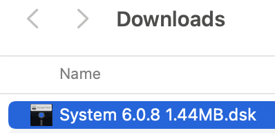

I will just delete the last 4 characters of the filename as shown below...
2,865
2,227
BTW, I checked and found that this forum already allows moof and dc42, so it makes no sense to disallow support of dsk, so I added it. Now everyone can upload *.dsk images without name changes. You can see that in the attachment to my message. Just reload this web page in your browser to see the change.

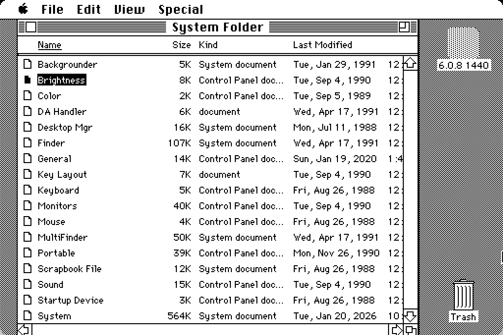

I noticed that you have Brightness in your System Folder (the attached disk image)...
I didn't have that in my S6.0.8 System Folder, if that matters.

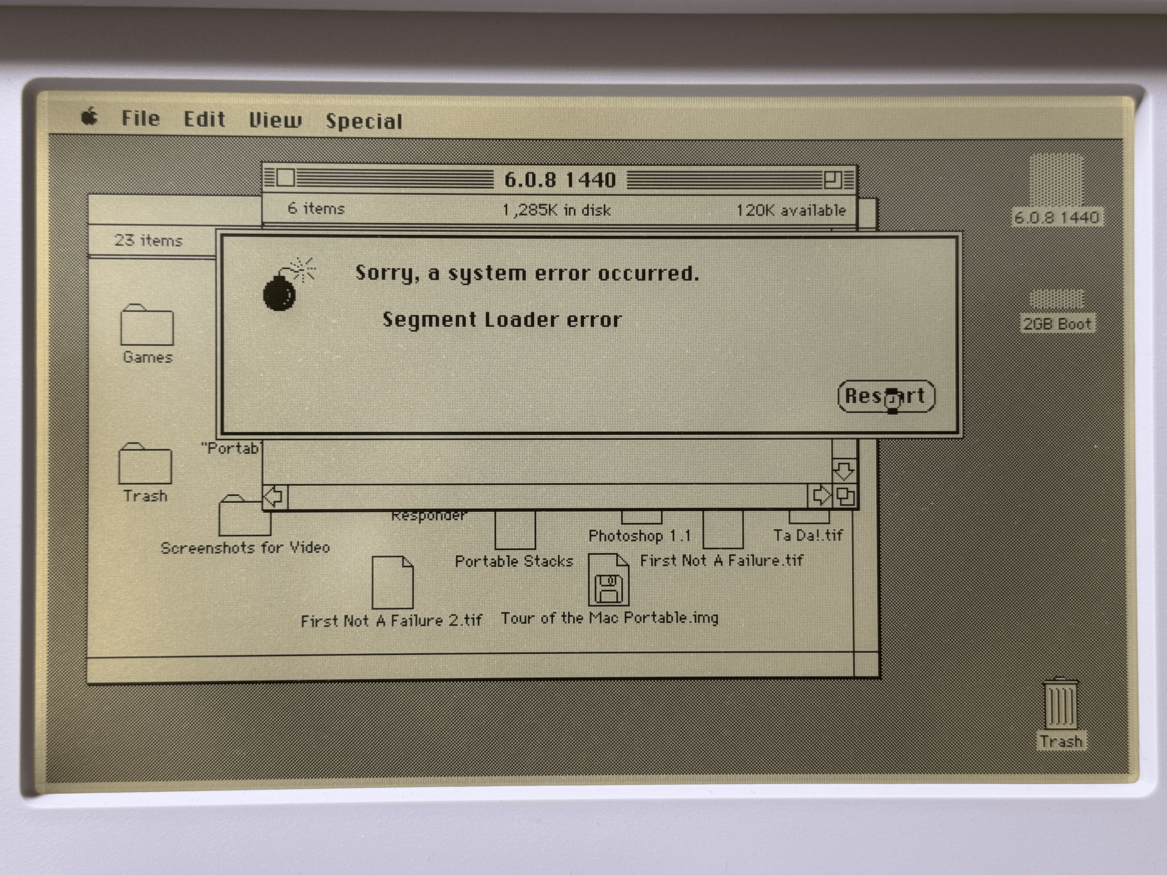

After that, I tied dragging the System Folder from the mounted floppy (via FloppyEMU) to my mounted BlueSCSI, but I got this strange error...
I Restarted from the BlueSCSI, booting into System 7.1, and the copy of that System Folder now works fine.
