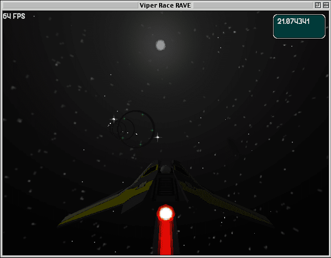

My MARCHintosh project for this year is the same as the previous year - I am working on my 3D spaceship racing game, tentatively called Viper Race RAVE, inspired by Ambrosia Software's EV: Nova's gambling cutscenes. You can read a bit about it here:
Viper Race RAVE
It builds on the same engine I wrote for Blokz RAVE a couple of years ago, which was also a MARCHintosh project. Recent progress includes:
- Working Rigidbody Physics simulation (Like Half Life 2) Video of that (please ignore the regression in the thruster graphics)
- New improved graphics
- Better framerate than last year
- Lots of under-the-hood framework fixes that accelerates my development, like automatic UI layout and checkboxes (this helps a lot haha)
Planned features this March:
- Level layout following a spline path
- Some sort of rudimentary AI ship controller for the opponents
- Further optimization, the physics engine is quite taxing at the moment, and the graphics can be optimized a lot
It's a quite ambitious project and I will probably not be done with it at the end of this MARCHintosh, but I'm sharing my progress either way!
The game will require a PowerPC Macintosh with a graphics card with at least 4 MB of VRAM, and Mac OS 9.
Tools used:
PowerBook Pismo 400MHz
CodeWarrior Pro 8.3
Photoshop 4
Blender 4 on a modern PC because I can't be arsed to learn how to use Lightwave at this age

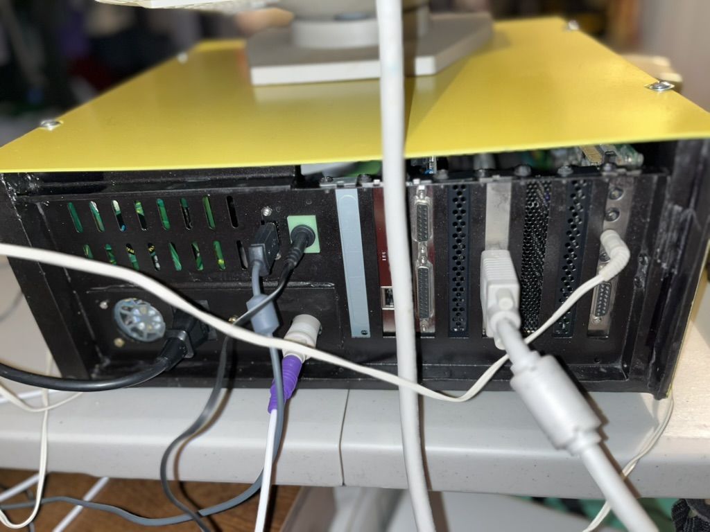

First update:
Got the new backplane cut down to fit. Had to move slots to left about 3.8mm to clear side of case/logic board.
Made first ugly slot cut with wet tile saw to start cutout for connectors and slot removal.
9500 board is stand-in for PEx ProtoBoard.
Lots of nasty work with grinder/cutoff wheel coming up. This friggin' tanks' rear armor plate is 14 Gauge/1.5mm thick!
edit: had to trim the base off on the left to fit and ripped the flanges on right side and back to match the height of the sunken backplane.

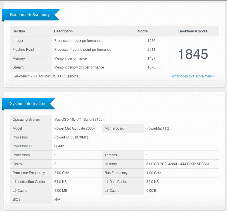

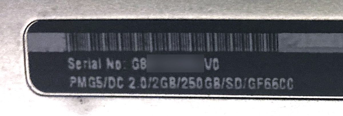

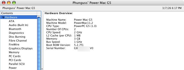

I stopped by Free Geek yesterday and found another G5 project. $5, no graphics card, missing the acrylic air deflector, no hdd, no ram.
Single processor, dual core, 2.0GHz.

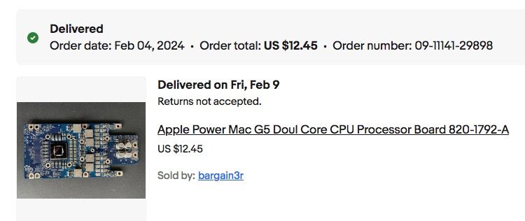

I added all the spare parts needed, and it fired right up. And then I remembered I had a spare dual core processor that I purchased when trying to fix my quad core G5. Turns out this one was 2.3GHz and that is why it didn't work in my 2.5GHz quad core as a 2nd cpu.
And it did not work in this 2.0GHz motherboard either, so it is likely dead. The motherboard should support any dual-core speed G5, per @HrutkayMods videos.

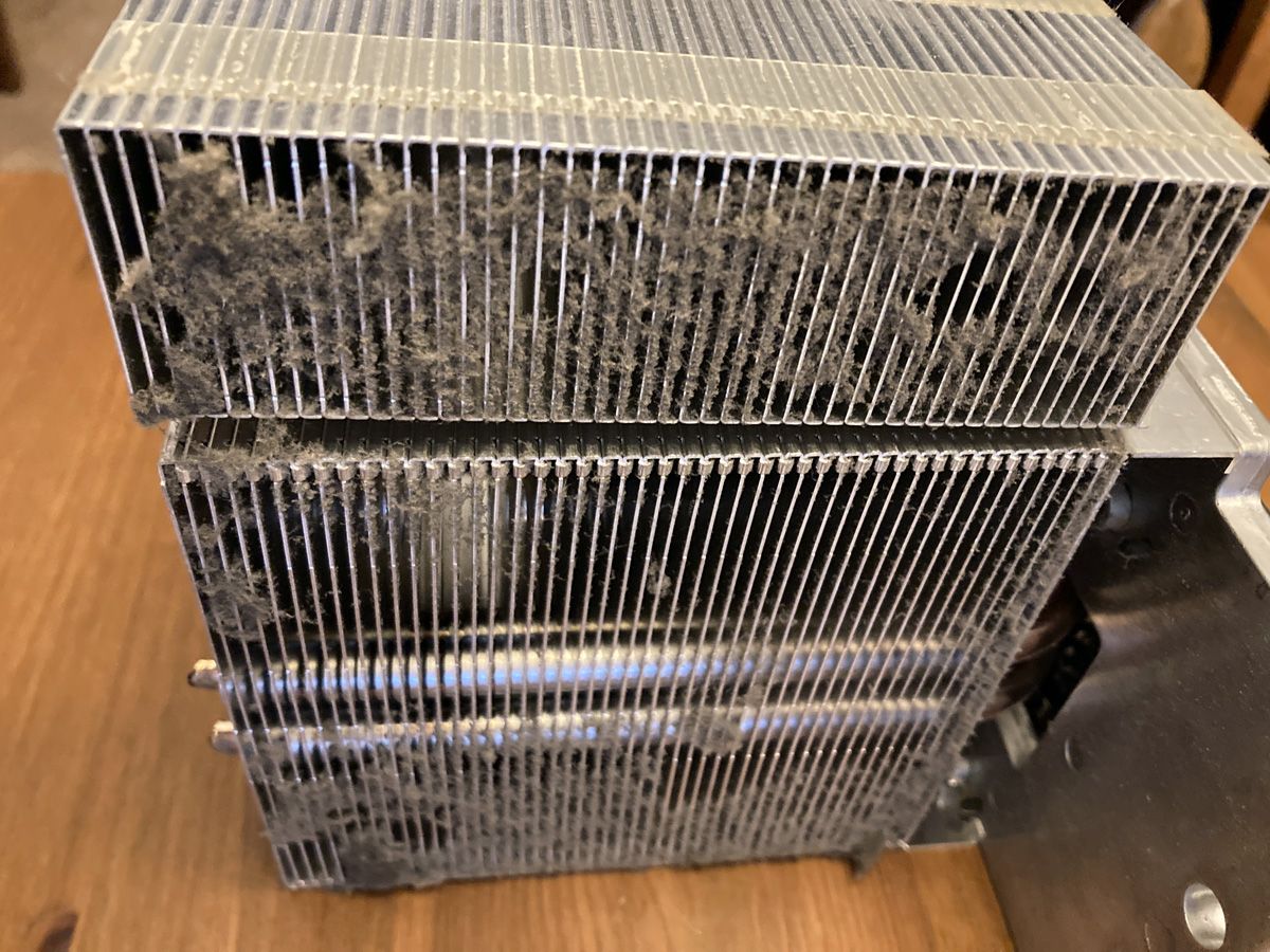

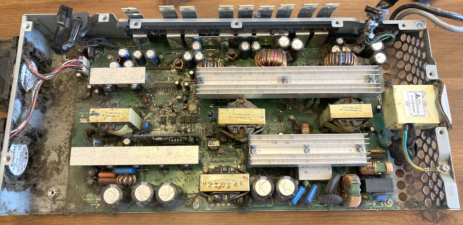

So while I was swapping out the CPU, I noticed a lot of dust.
So I figured I better blow out the power supply as well. I guess it had a productive life. You don't get this dusty sitting on a collector's display shelf.
Now she is clean and ready to work!

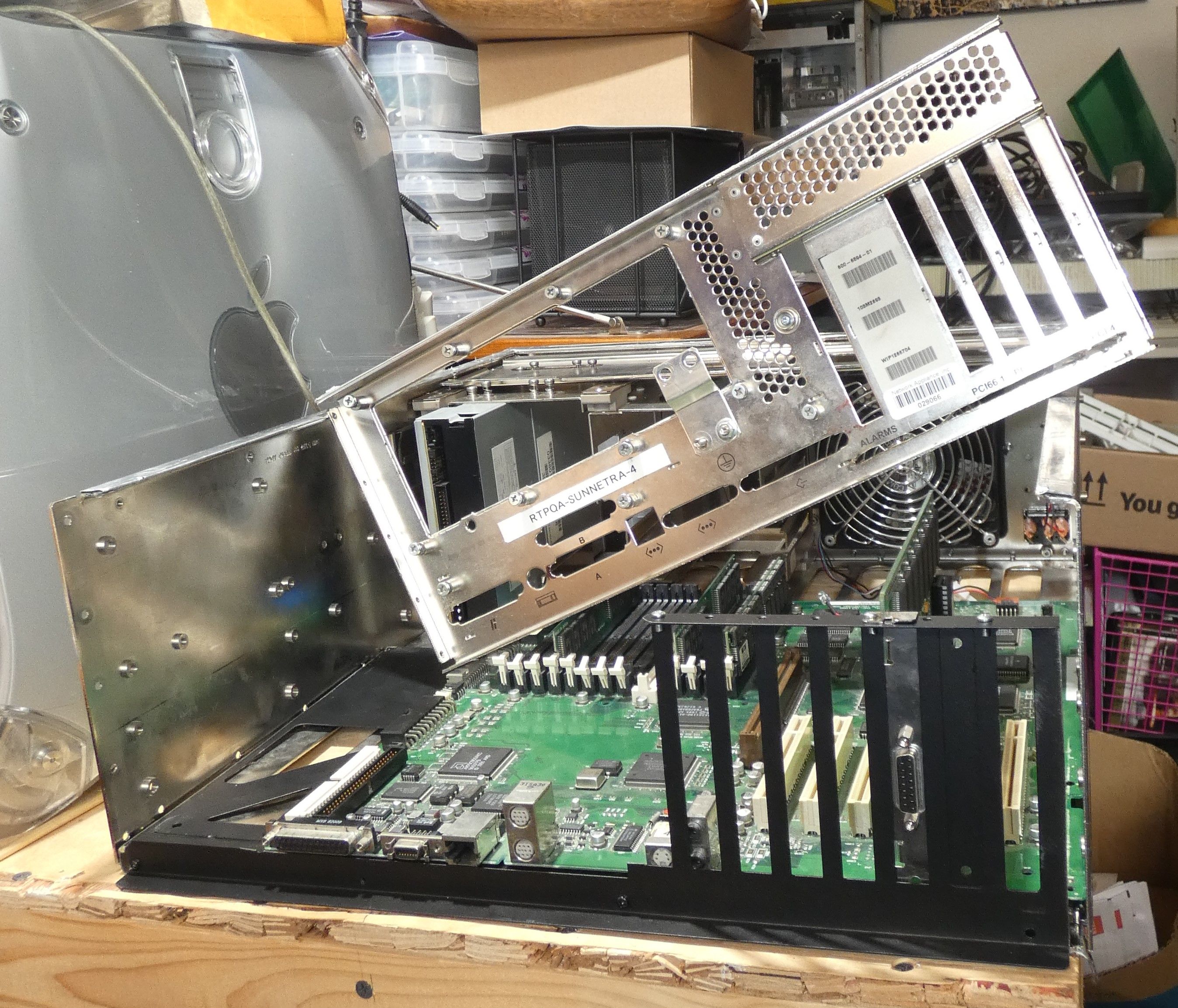

First update:
those ebay bitcoin mining rig chassis' are quite handy :)
Reactions: europlus

Looks like you had to shift the slots to the left for clearance as well. How much and in what kind of case design? Looks a tad too narrow for 4U?
only had to slice the PSU side off for this build, but then random bits of metal and a ton of JB weld to fill in all the gaps. printed a cover for the IO shield area as thats where i put the sff power supply. The case is actually a 15x15x7 junction box that had to be cut with a grinder :)

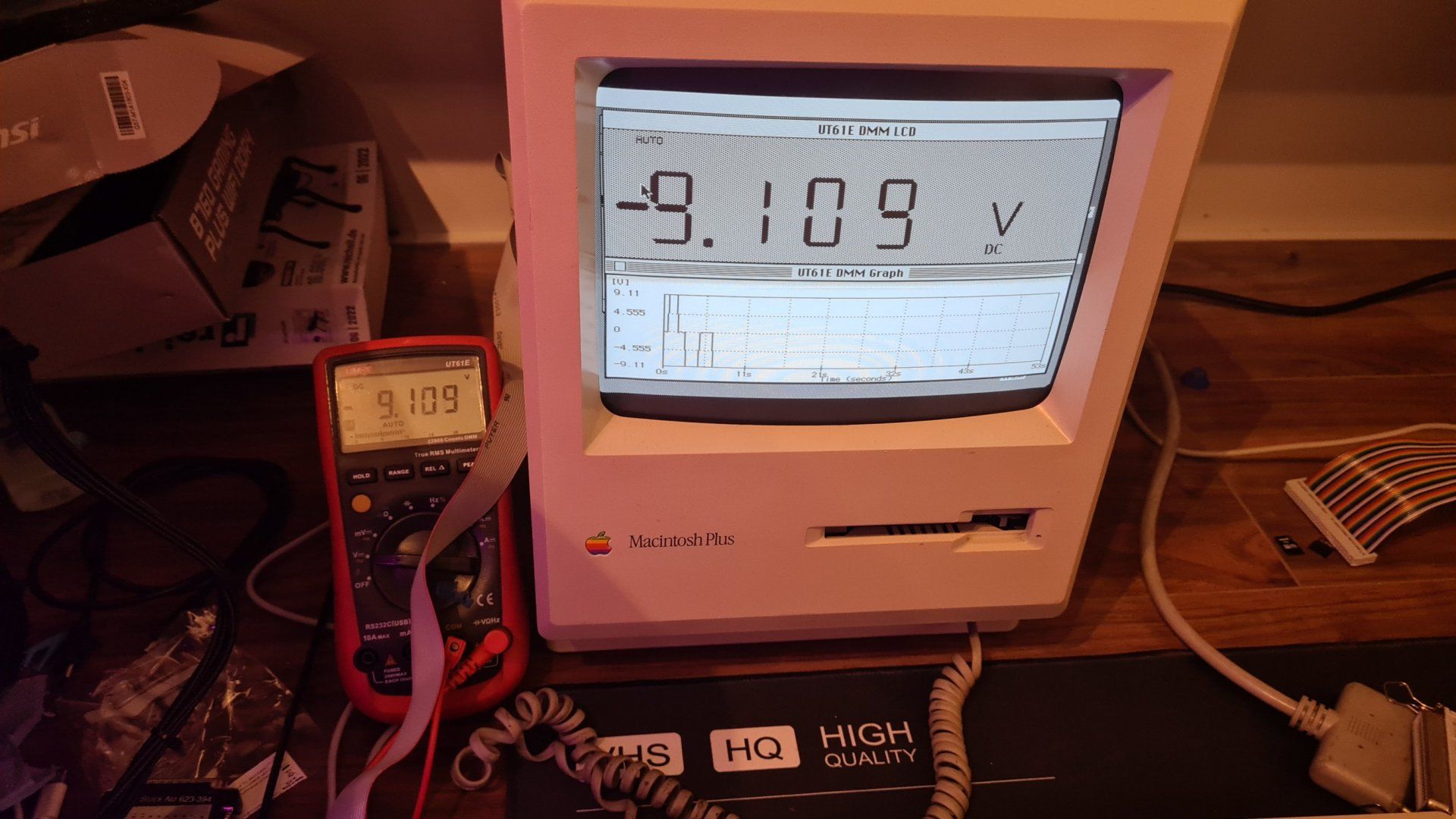

This is really a useless project but I am having a bit of fun after figuring out how to interact with serial data
A Digital Multi meter logger , specifically the one I have, the Uni-t UT61E
The meter has an optically coupled rs232 out, and after a bit of cable modding I was getting serial data on the Mac.
I used this to help parse the data
Serial data from the meter, and super alpha of decoding stream and showing it.
I have an idea of what the application will look in my head, this is not it, but it will do while I fix other things like double buffering. (to stop display update flickering)
SE30 does double buffer fine with this , but the Plus struggles with the update rate and drawing graph and then double buffer that , is just a little too much for the Plus.
My LCD fonts did not turn out right andI tried to make digits bigger too, but not sure that's the right direction to go.
