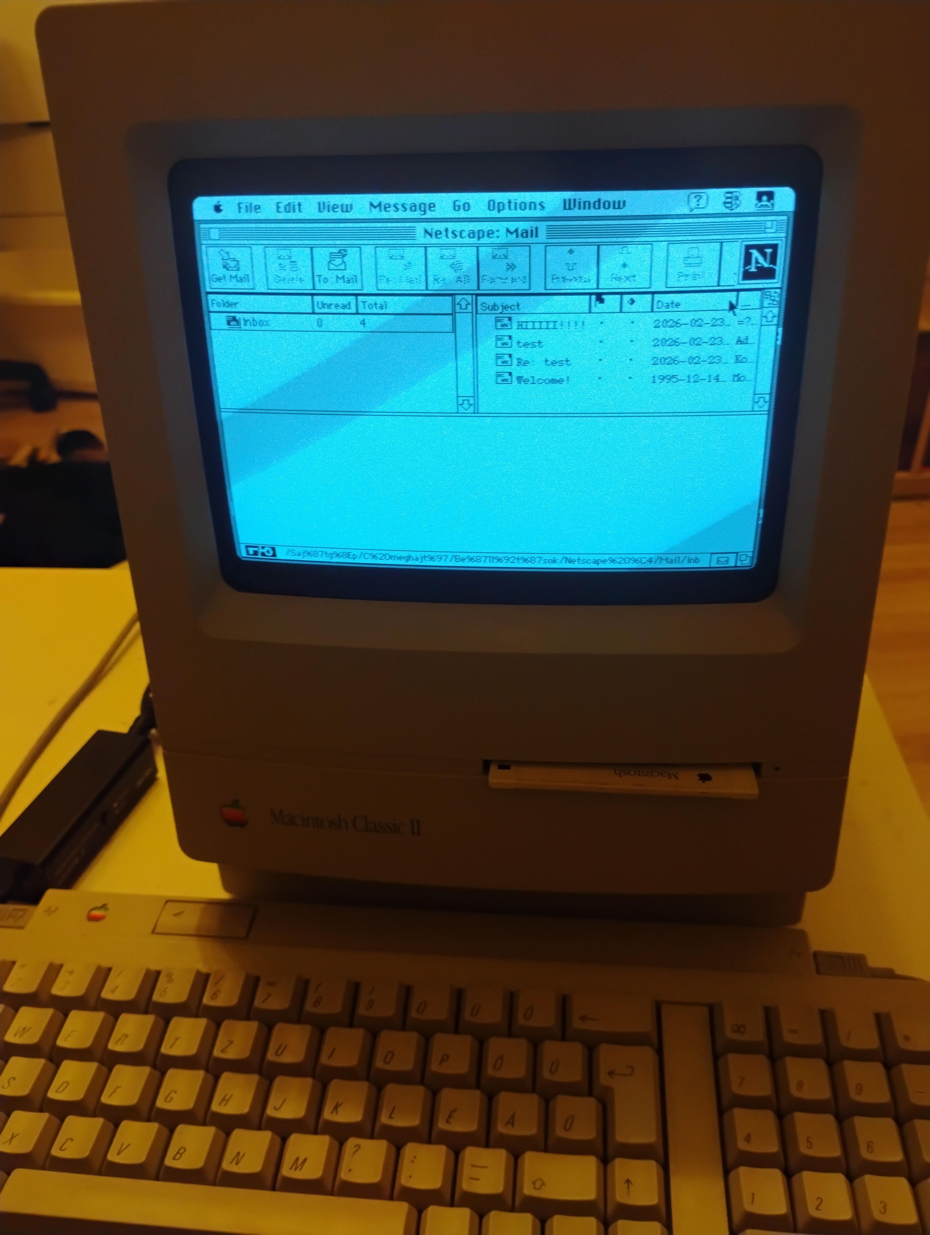

Just so I get to participate for the first time, I got wireless postscript printing working on my Classic II.
I also managed to get Netscape Navigator 2.0's e-mail management function to work, both send and receive, albeit that was back in late February.

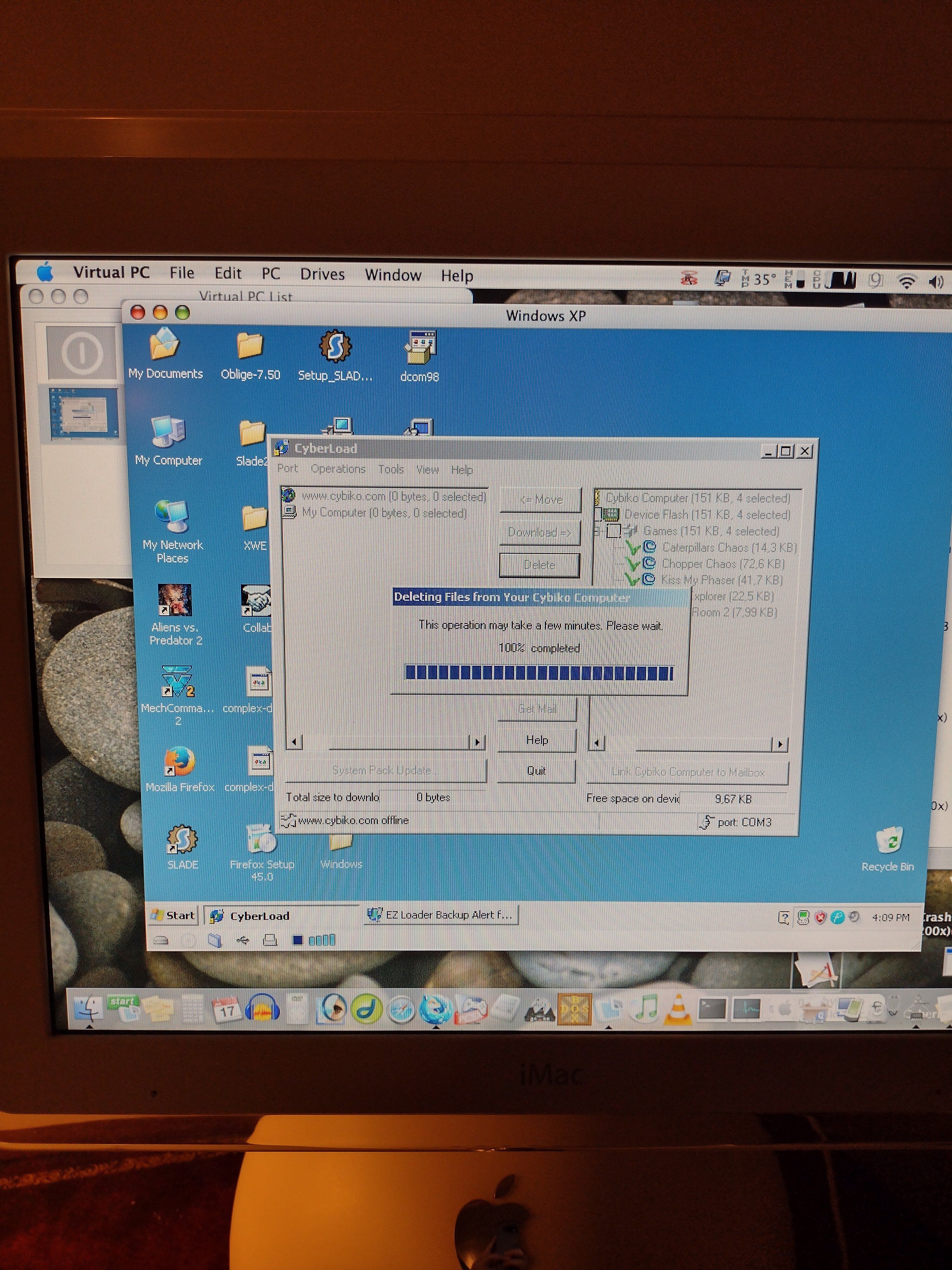

I've managed to sync an old Cybiko to an old Mac using a virtual machine.
I'm surprised this actually worked. Windows XP running on a 1Ghz G4 is a dreadful experience, but it eventually worked. I used an old USB-to-Serial cable that used a prolific chip, which was kinda hard to track a driver down. Installed the drive run the virtualmchine, told the Mac to pipe the USB function to the VM, and it just... Kinda worked. I was pretty sure there was going to be some kind of hardware abstraction issue somewhere, but not at all.
I could have used any other computer in my house to do this, but this sounded like the most fun. Now I can play all of these old and amazing Cybiko games.IMG_20260327_180931408_HDR.jpg

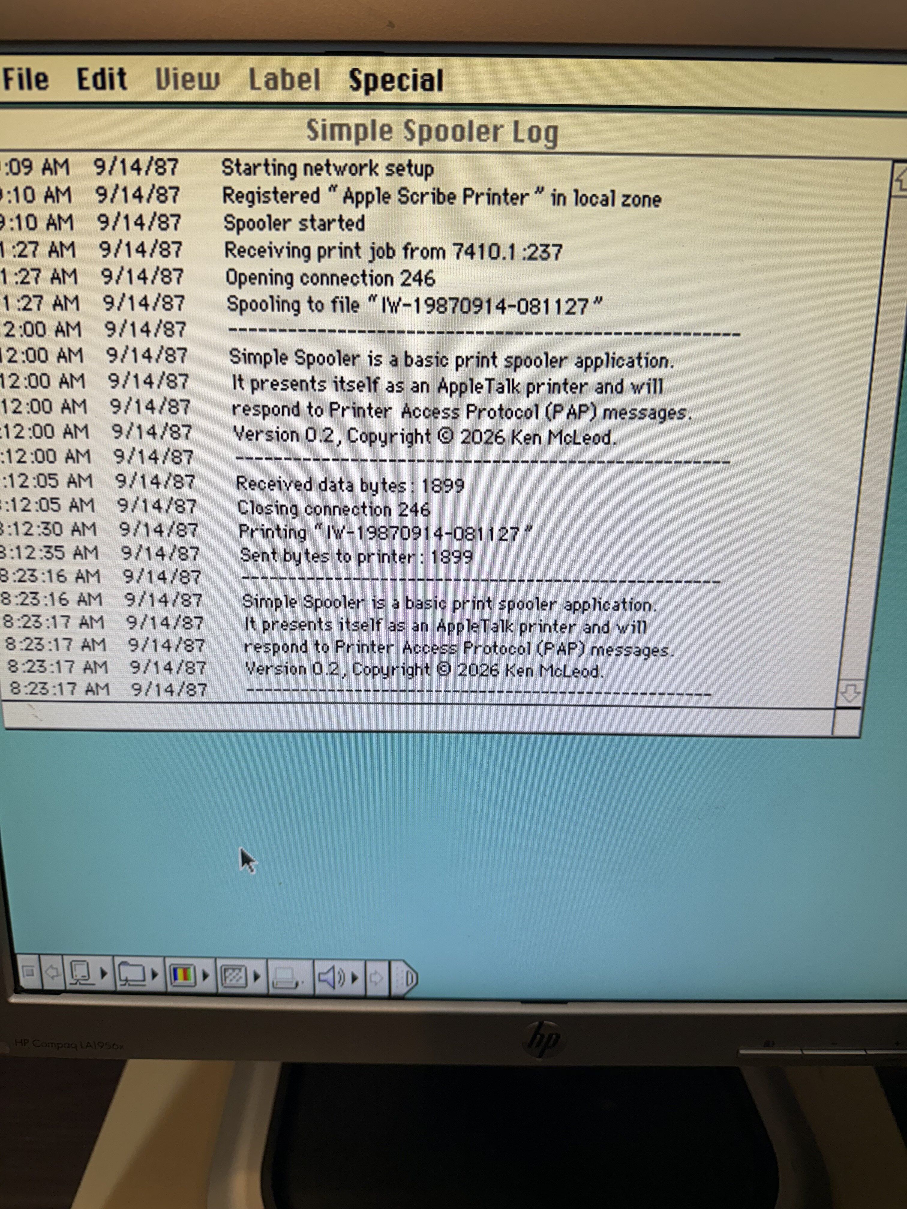

Five Stars!!! This is the last piece of what i was hoping to accomplish with my 2026 Marchintosh - with this tool i was able to share out my Apple Scribe Printer (a thermal printer mainly for appleIIc) but connected to my PowerMac6100/66av. It is now able to be printed to directly on my Localtalk network - and thus also to members of GlobalTalk . Thank you so much! (The zone is YUL_GLOBALTALK)

This is good to hear. Glad it worked for you! I didn't realize that the Apple Scribe essentially uses the same commands and can be treated as if it were an ImageWriter printer. The Apple Scribe reference manual seems to have a complete list of its supported commands so I'll go through them and see if there are any differences between it and the ImageWriter II. (Note there is an ImageWriter I mode checkbox in Simple Spooler, because the ImageWriter I doesn't support several newer commands that the ImageWriter II driver can send.)

I considered checking that box - but lets see what happens!
