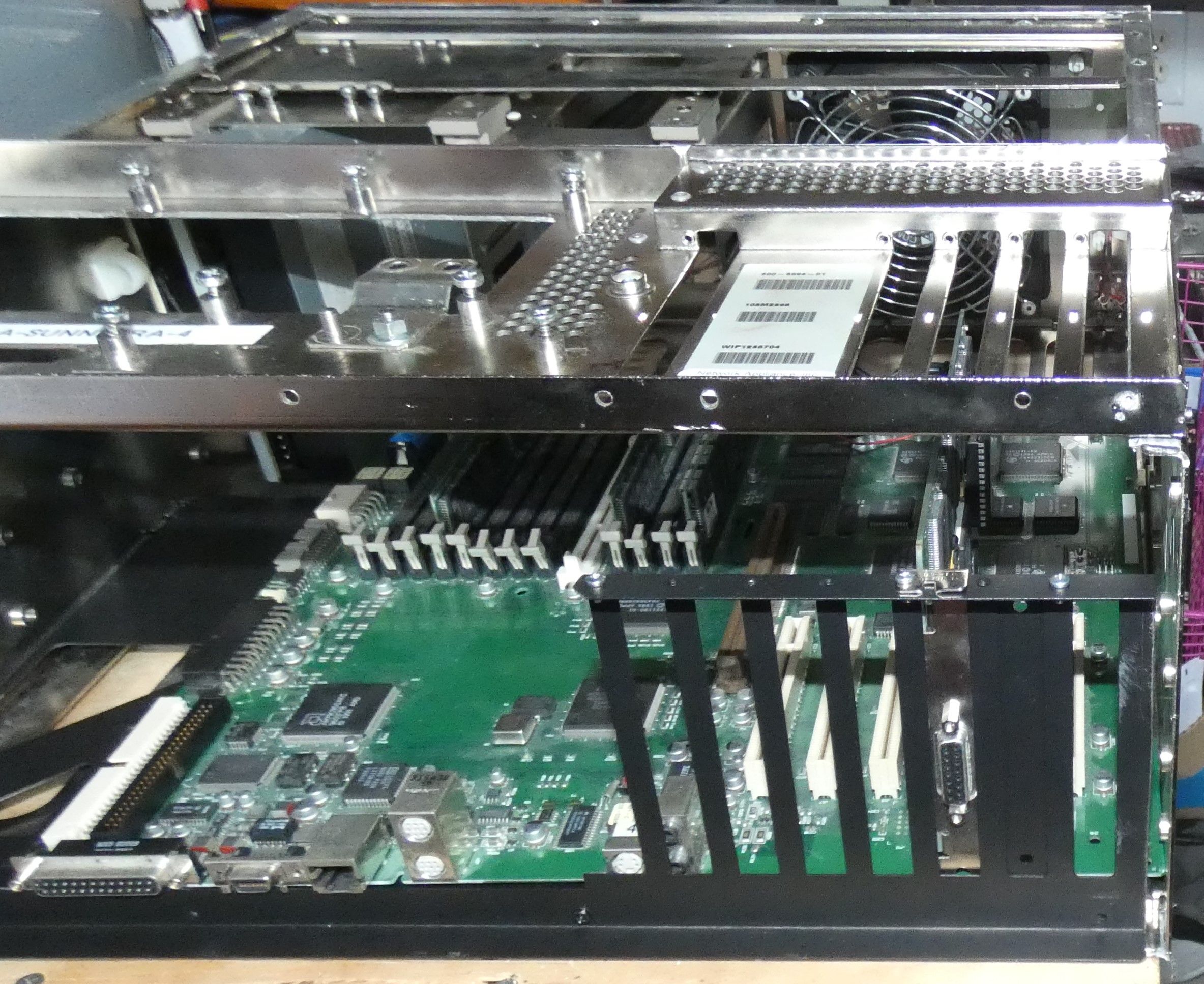

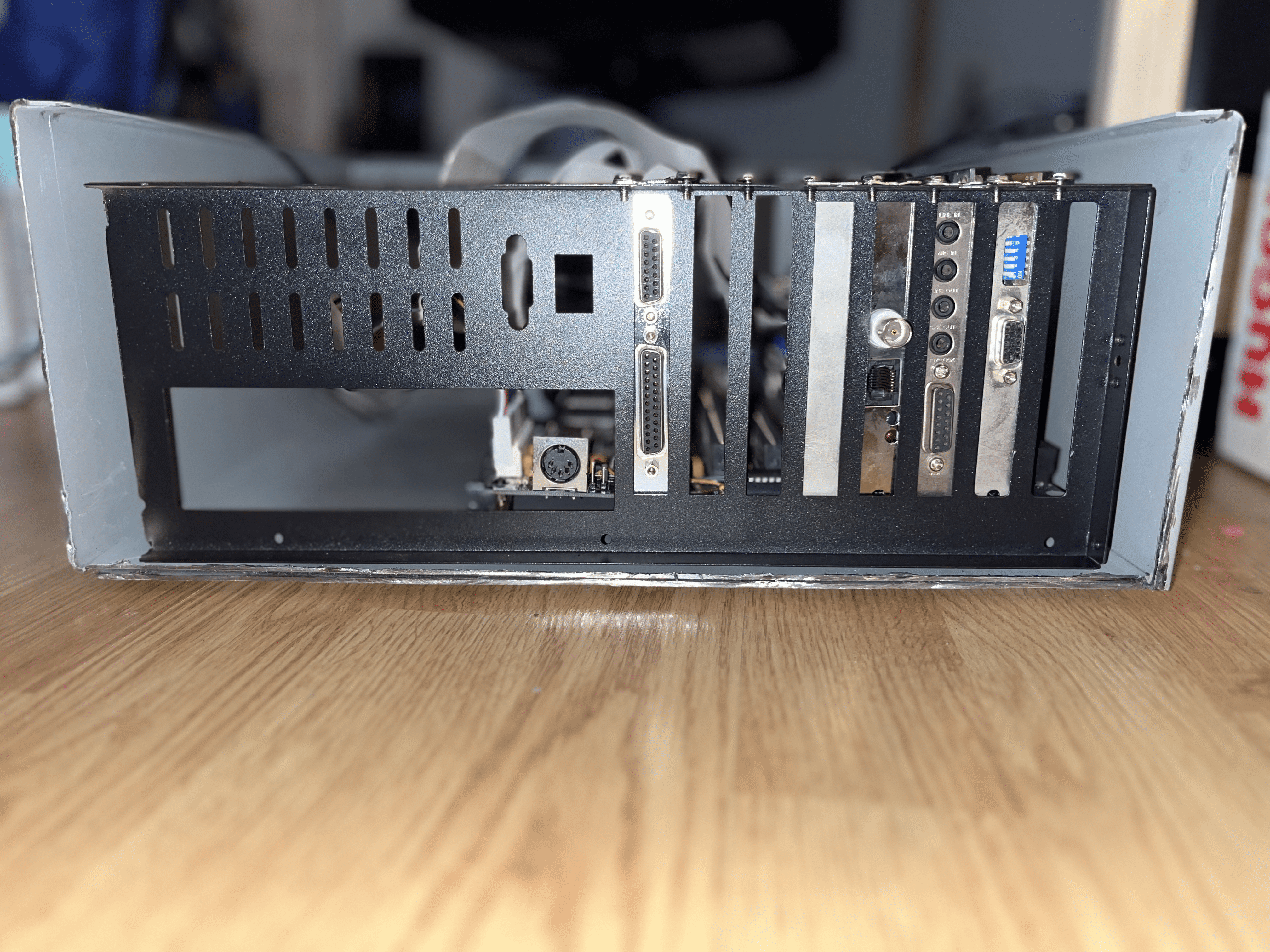

View attachment 27206View attachment 27207

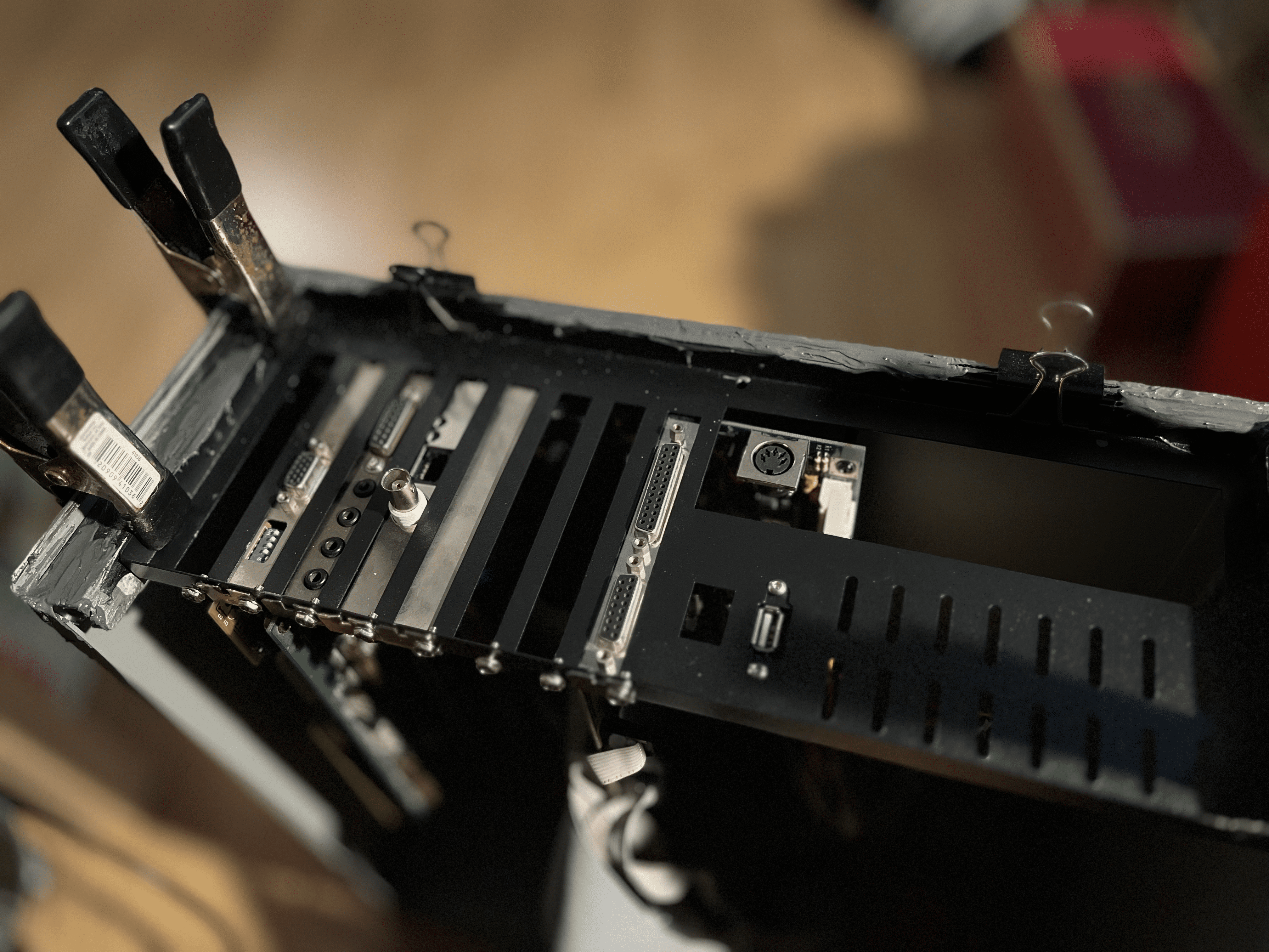

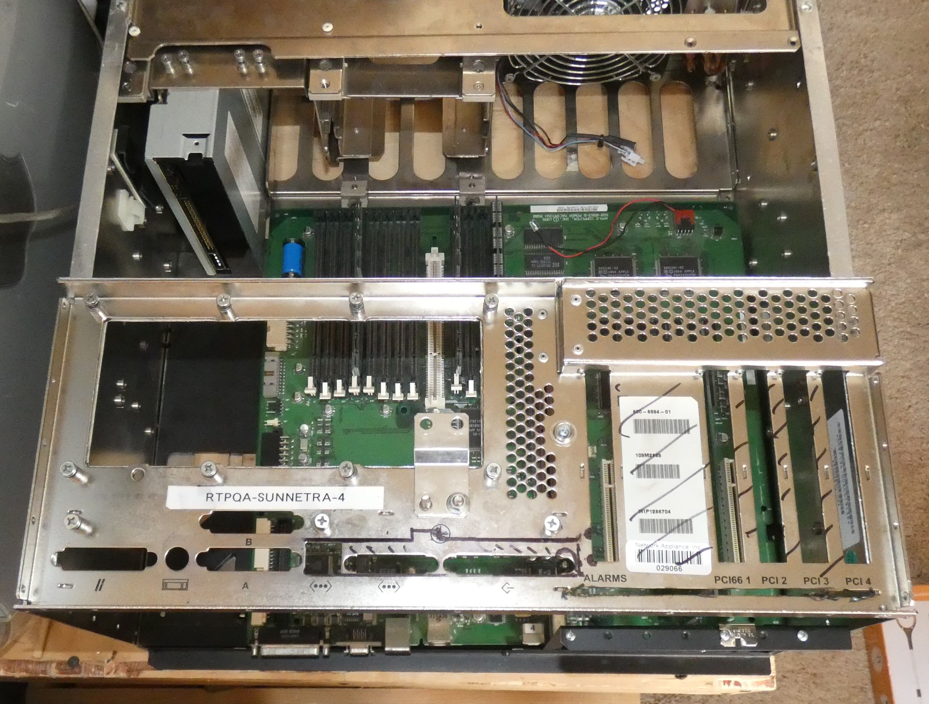

only had to slice the PSU side off for this build, but then random bits of metal and a ton of JB weld to fill in all the gaps. printed a cover for the IO shield area as thats where i put the sff power supply. The case is actually a 15x15x7 junction box that had to be cut with a grinder :)
In this shot it looks like you had the same kind of offset slot problem I have, in the other not so much?
Difficult to show the 3.8mm offset required to fit the 9500/PEx boards. But easy enough to see that the rightmost slot edge will be a perfect overlay for the resultant gap.
After the grlf flies home Sunday I can get down to the grinder/cutoff nitty gritty.
Crosshatched sections show the absolute minimum I could do in case mod, but will be doing a bit more to fair the new black slot section in across the back. DB-25 Port A will work for the SCSI connector if I file the ear out a little, even less as shown for the speaker/microphone ports above ALARMS. The indented slots for the backplane cover plate extensions had to be done, so opening things up a bit more than the crosshatched indications will be done.
These two shots detail the further cutback I need to do for to the tan plastic Netra board supports for fitting the PEx mobo. Will work nicely supporting the Board's Memory/ROM slots.

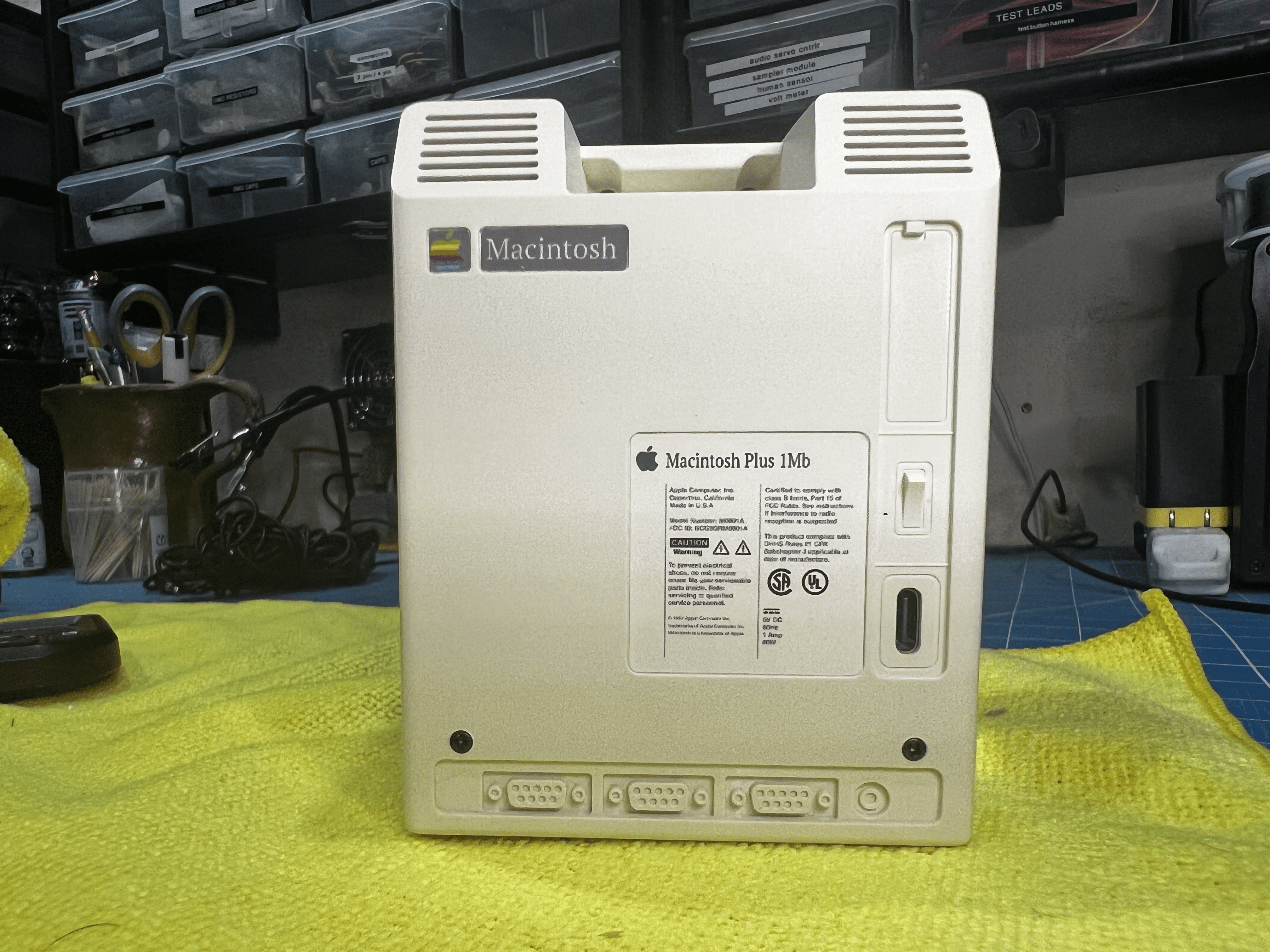

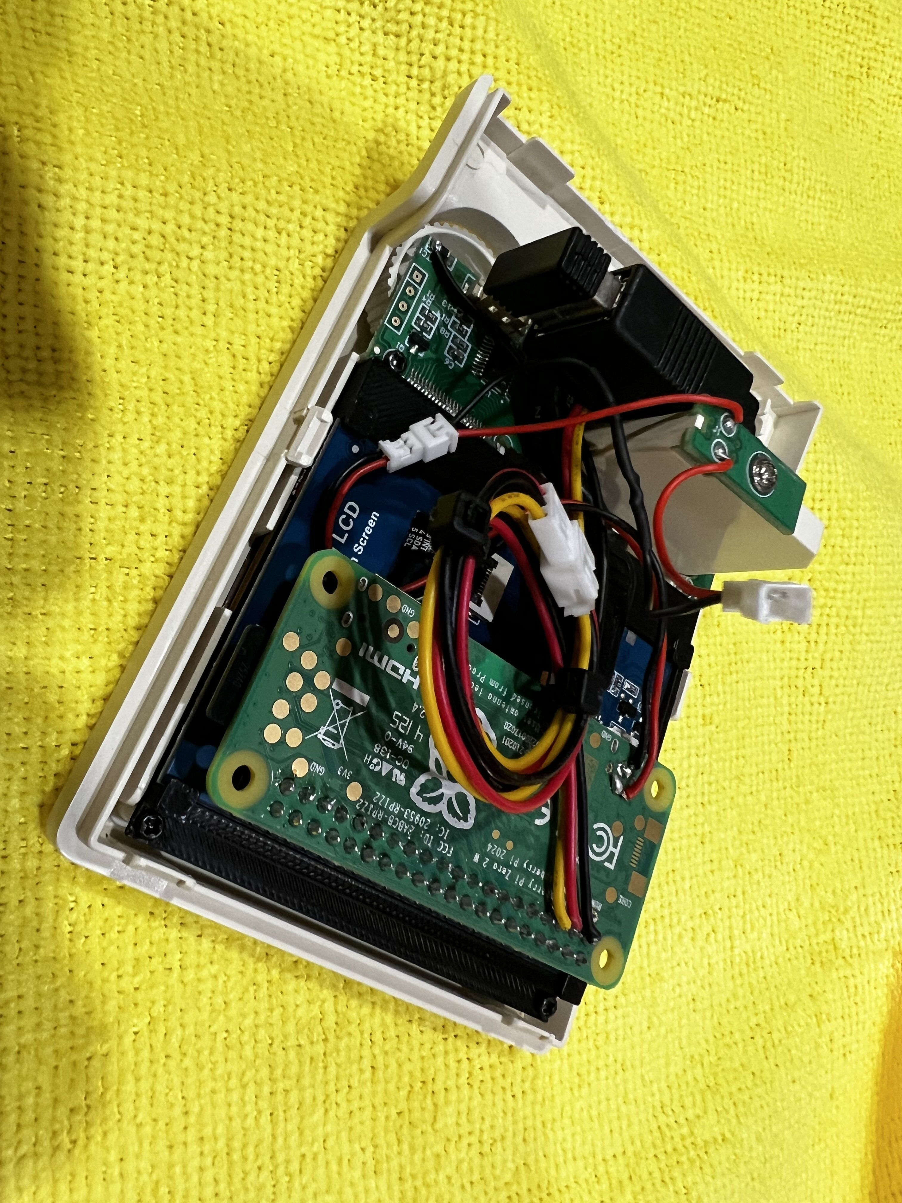

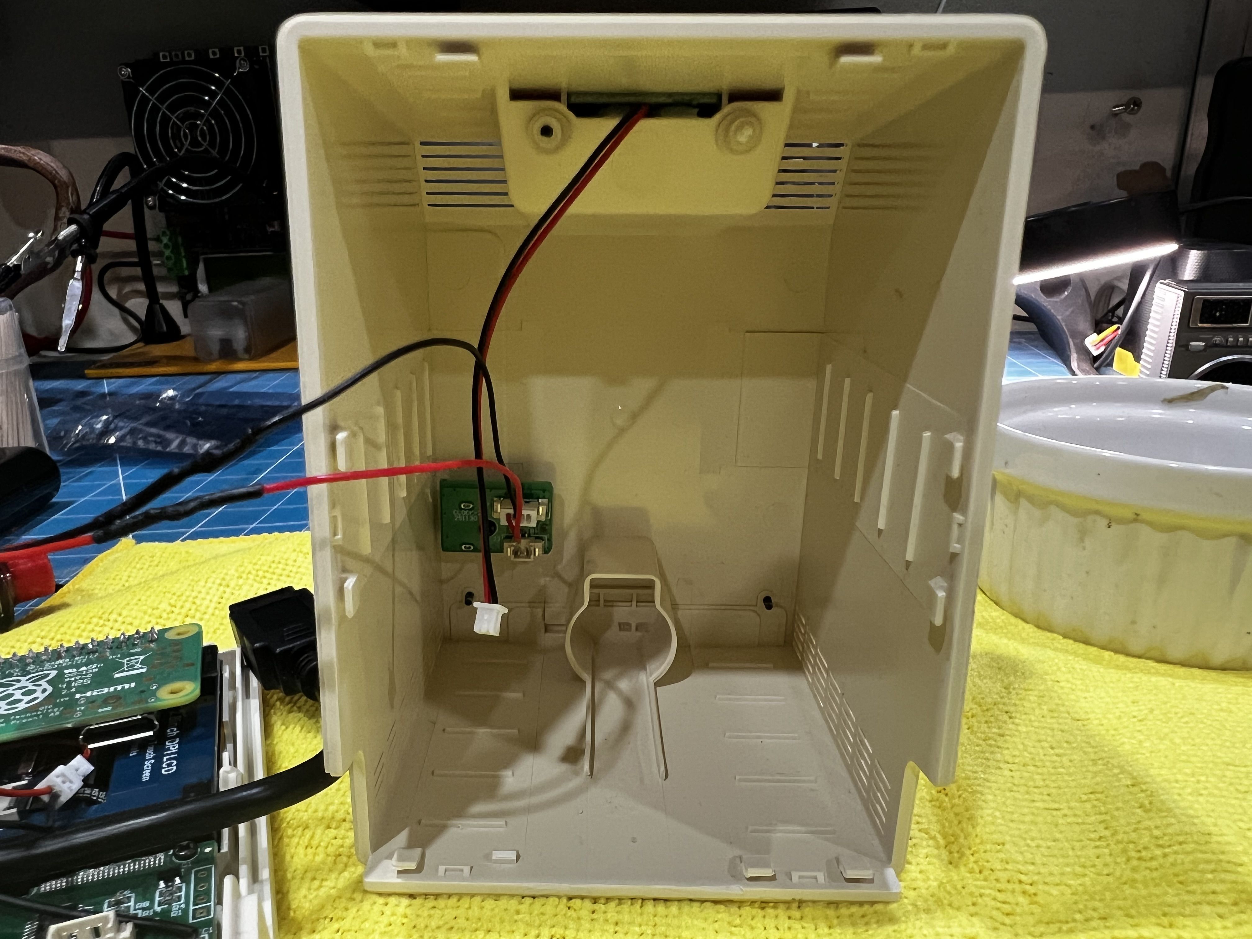

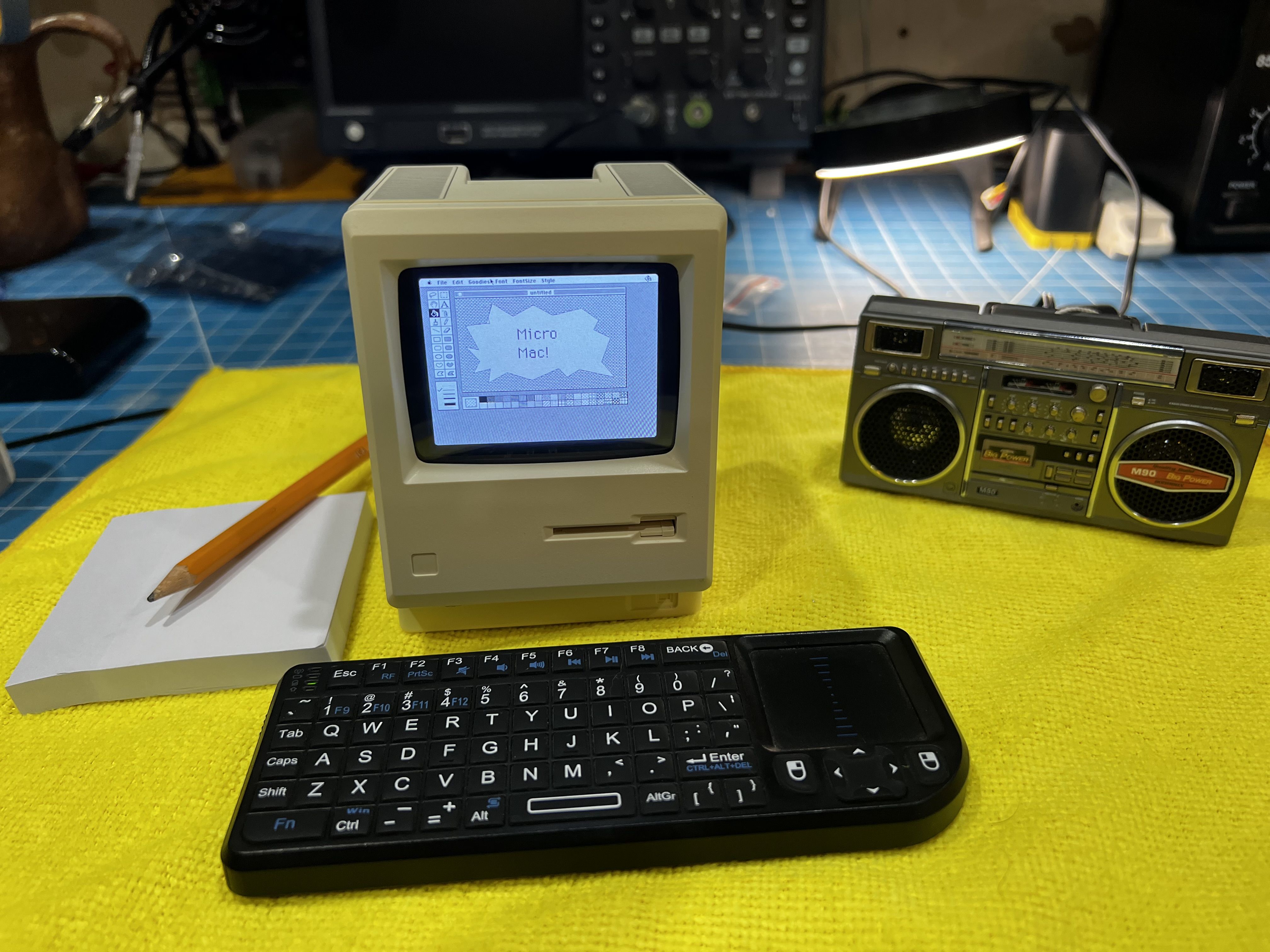

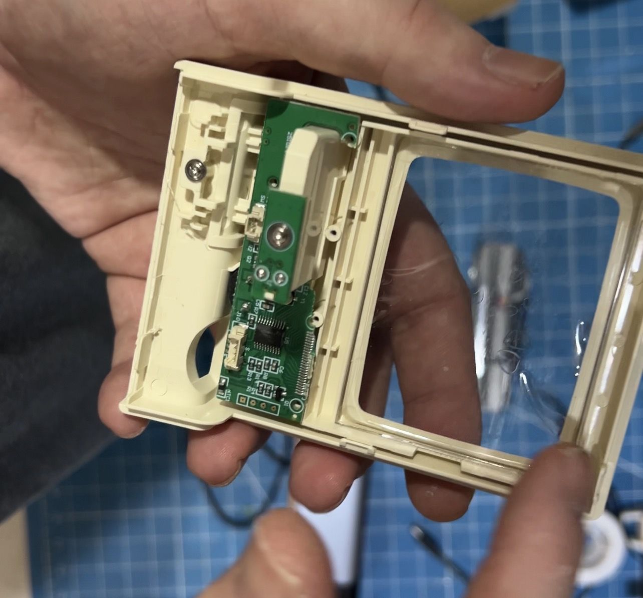

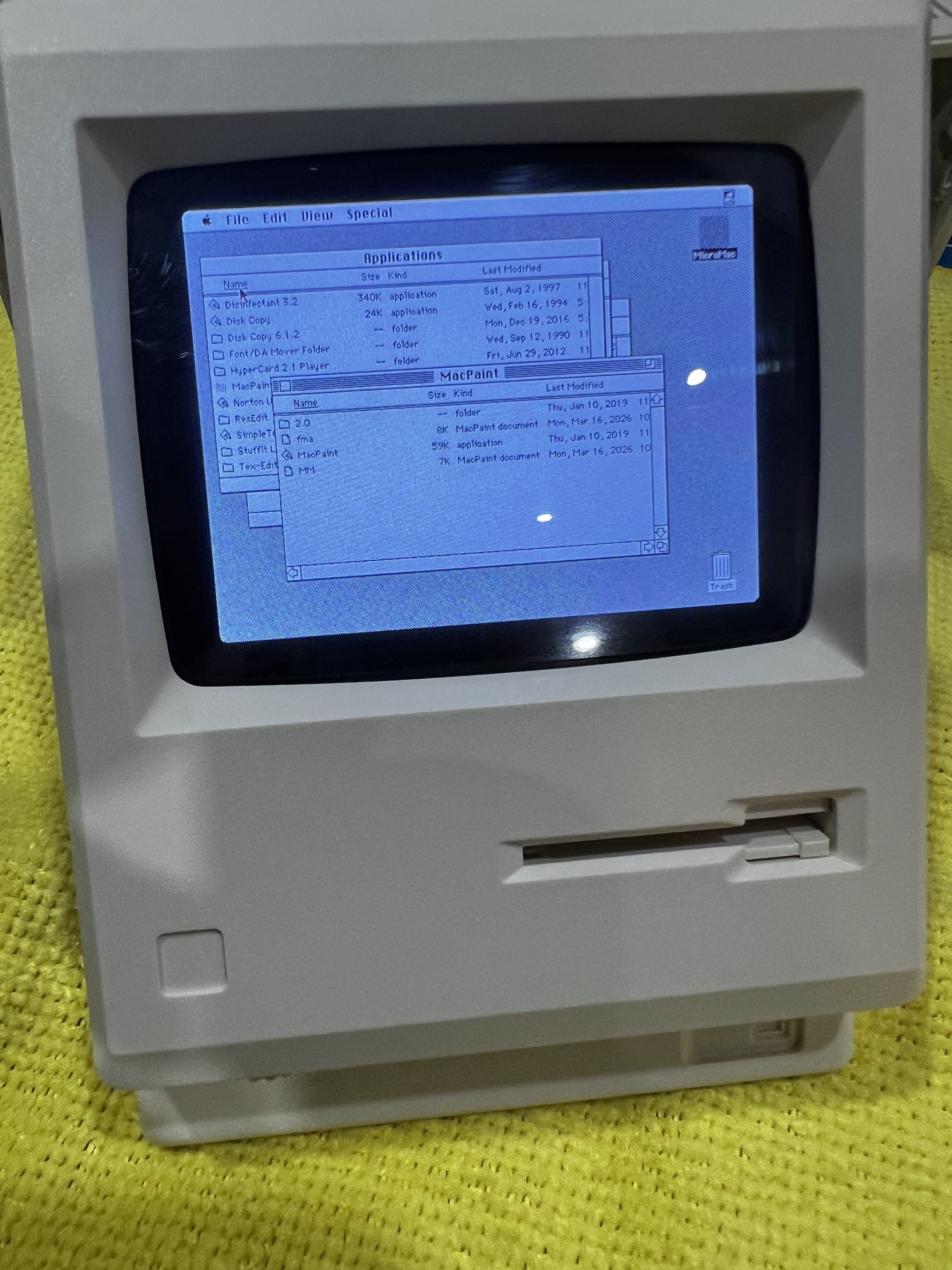

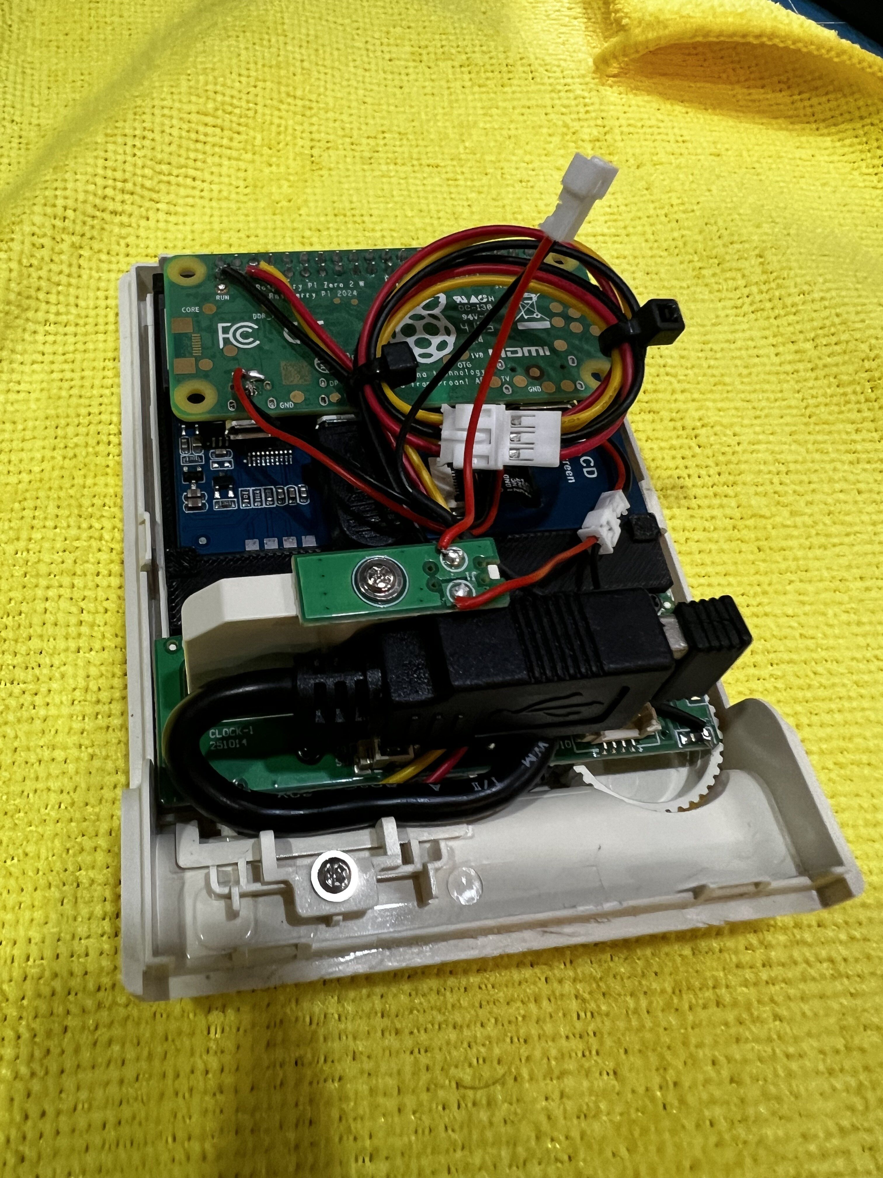

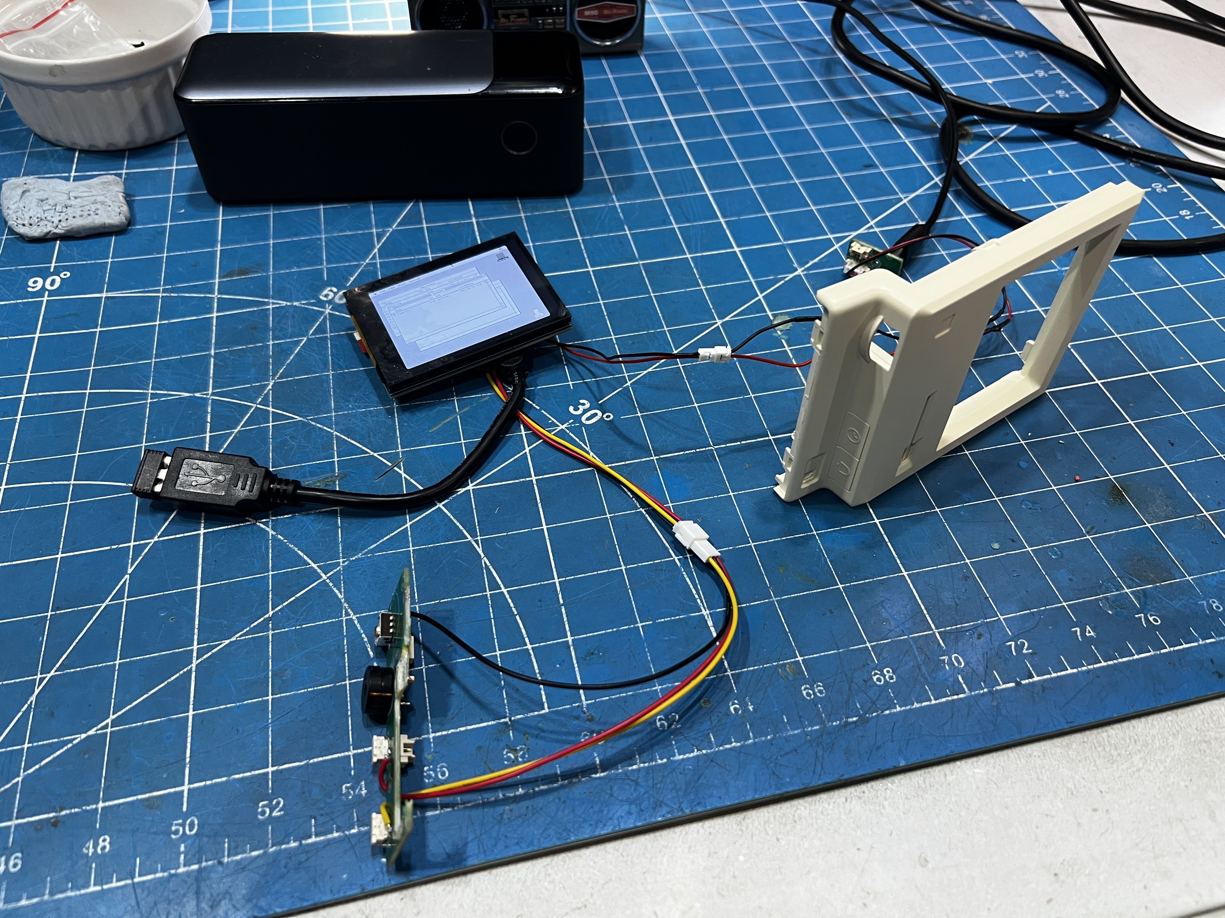

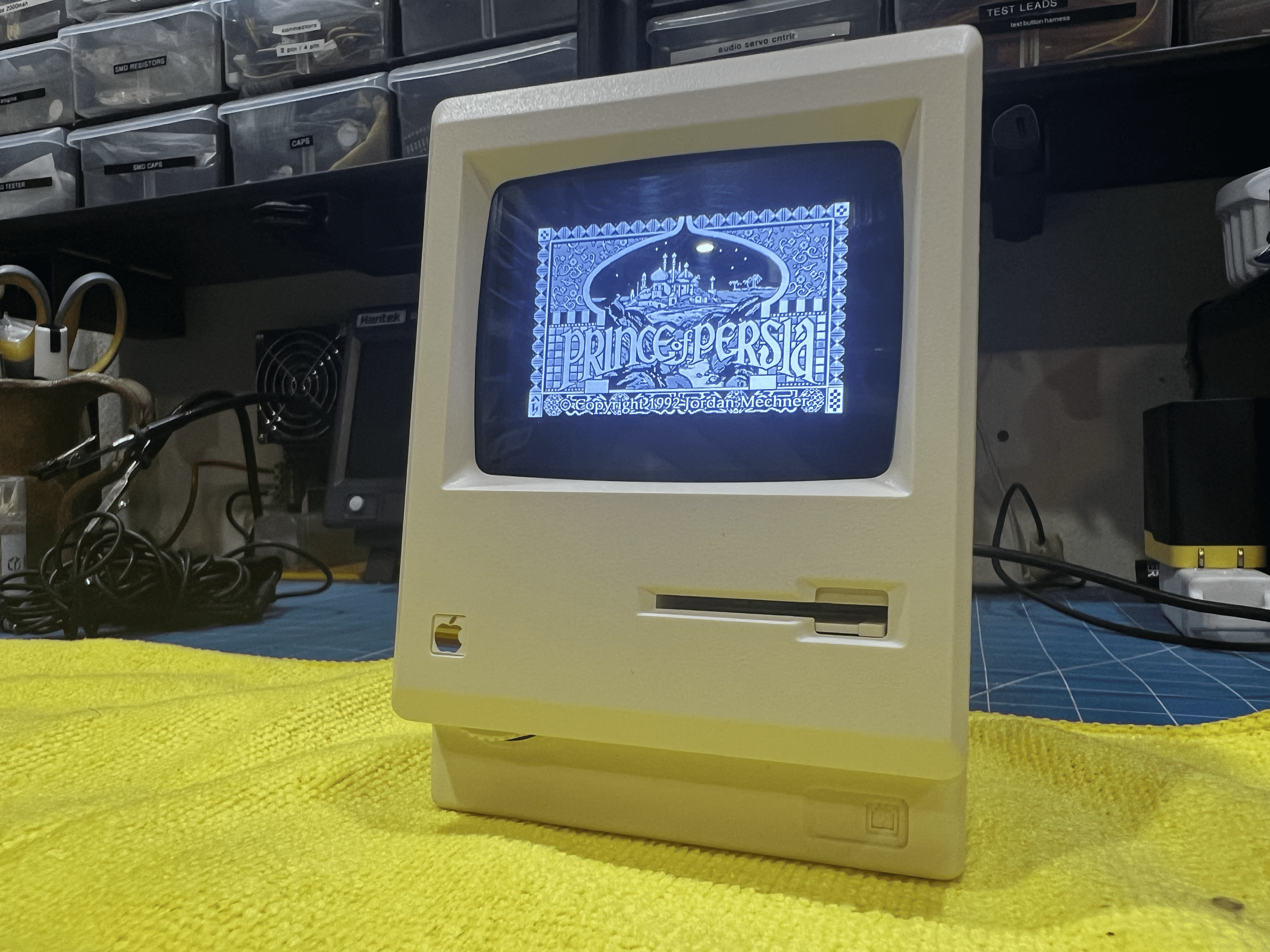

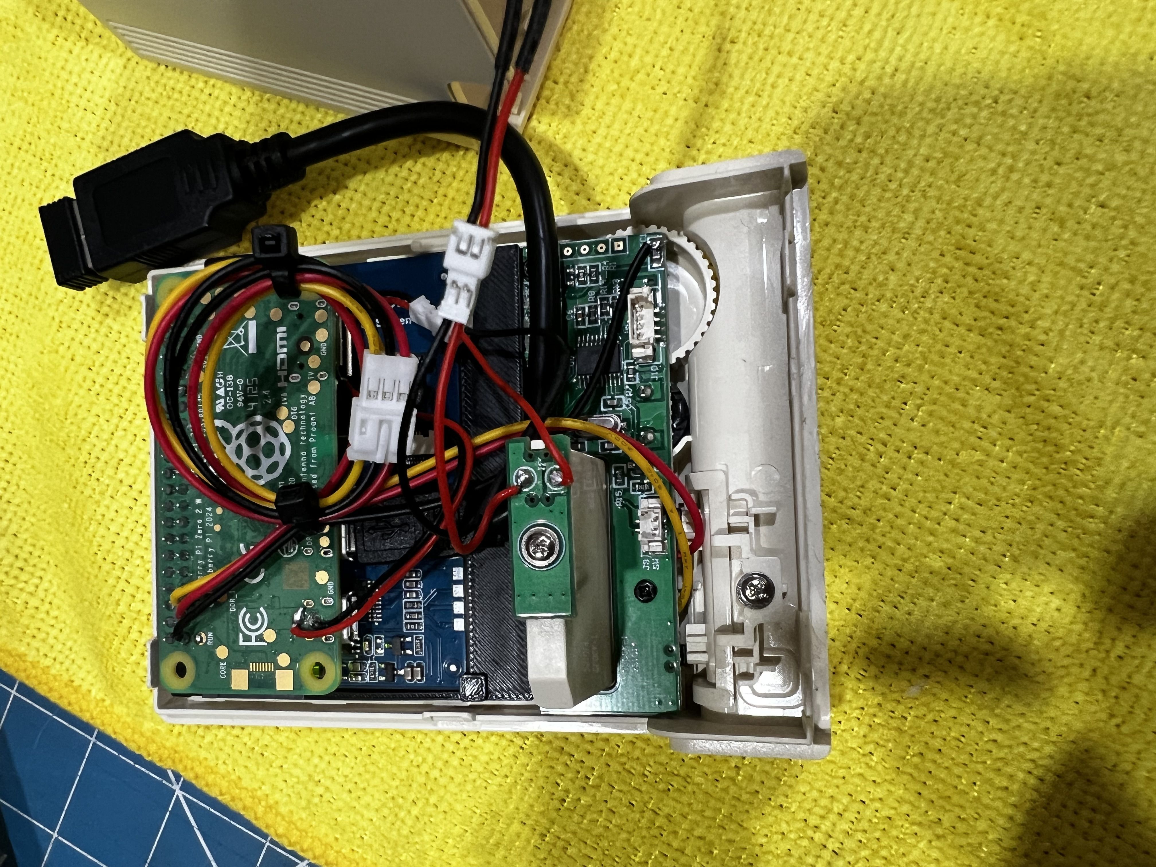

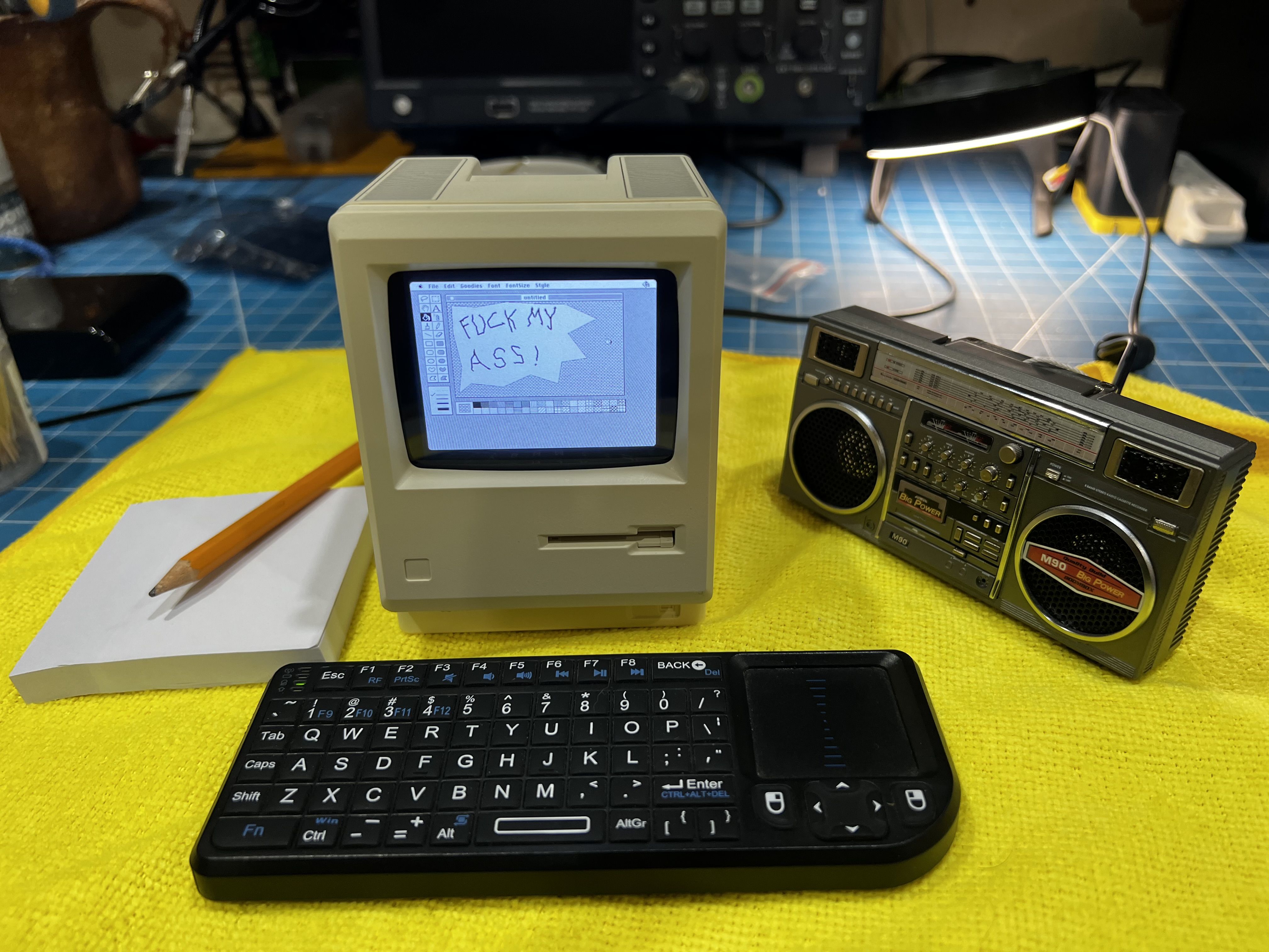

I just finished doing a MacClock to Mac Plus mod. Several have already done this but I wanted to take mine a bit of a step further.
I scaled and positioned the screen to fit properly and got the pi to boot directly into Mini Vmac without putting up andy "Raspberry Pi" splash screens.
Then I setup bluetooth audio so it auto connects to my bluetooth speaker.

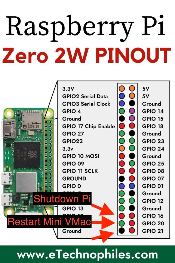

I hooked up the two buttons on the bottom right to a couple GPIO pins so the bottom left button Restarts the mac and the right button shuts down the pi.
The little floppy powers the pi down when you eject it and powers it up when you insert it.
And finally I added a USB dongle that connects to one of those tiny wireless keyboards with a mini trackpad.

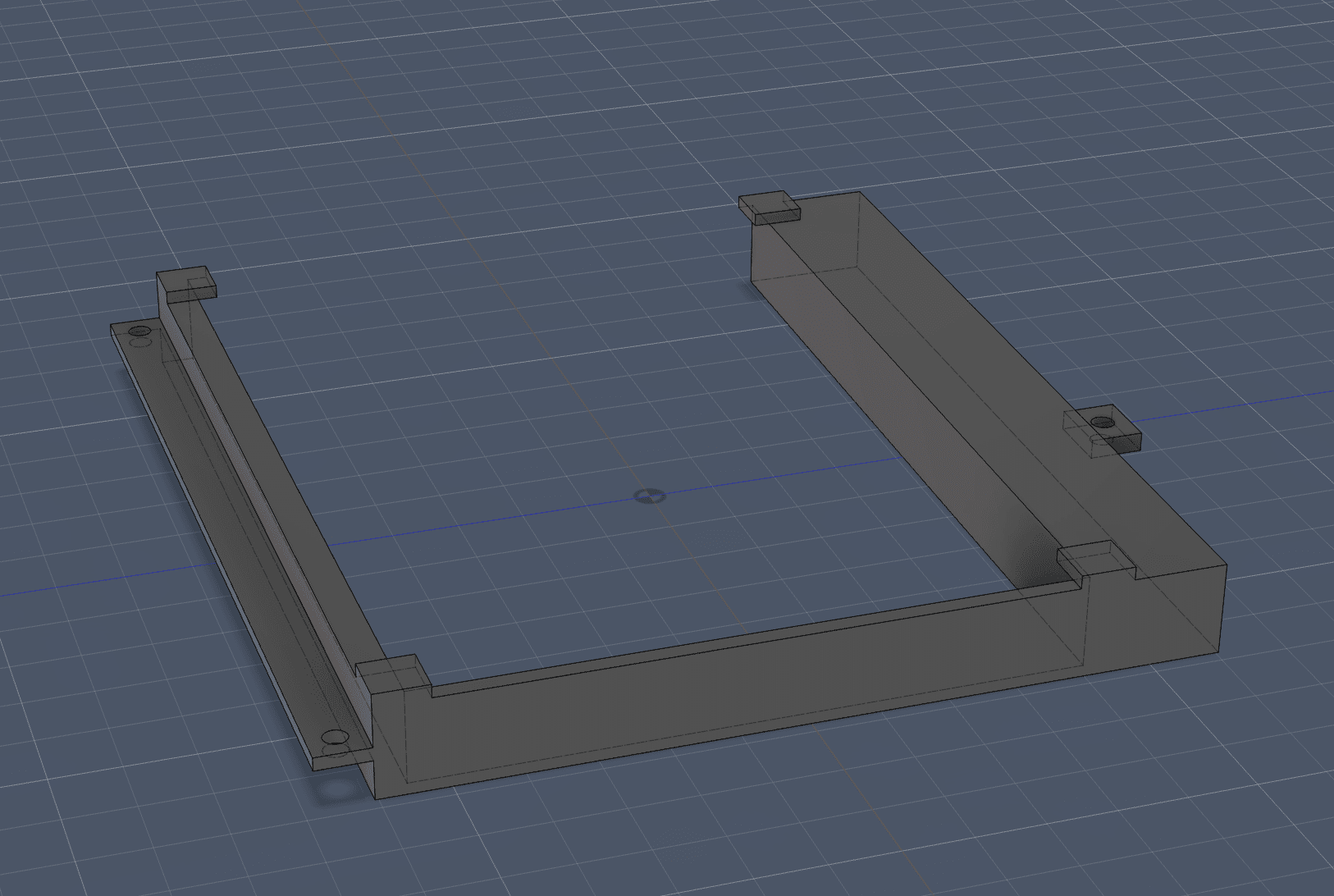

I made a little 3d printed mounting bracket that snaps the LCD and Pi in perfectly and screws into the existing screw holes. No need to cut the case up or do any mods to it other than adding the connectors to the buttons and floppy switch.
The only thing I had to do other than that was take a dermal tool to the original PCB to cut out the display and leave the portion with the buttons and knob.
It took a lot of mucking around with the OS to get all the services etc working right but it's pretty solid now. I just SSH in to copy disk images to it and remotely reboot it etc..
If anyone wants my STL, Disk Images, or Setup docs, just let me know and ill zip them up and put on my server.
Heres so photos!

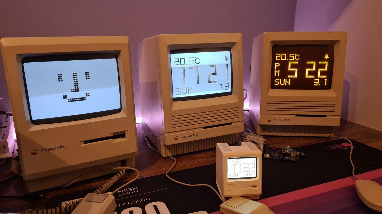

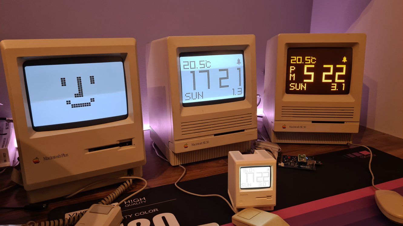

I made a program with Retro68 cross compiler with a strange likeness to the like clock Maclock. Watch out for the clock bug, where DAY does not match date. I find 1998 works for this year. @This Does Not Compute gave me the idea when he converted the clock into a vintage Mac, I wanted to see if I could do the opposite. I'm sure this will run on his tiny 'Mac' and restore Maclock function :)
Features:
  • Large digitized time display with blinking colon.
  • Date and Day of the week in a custom small font.
  • Double-buffered rendering for a flicker-free experience.
  • Inversion and Gray Background modes for different lighting conditions.
  • Alarm system with customizable time and multiple alert sounds.
  • Face mode (Happy Mac) toggle.
  • Dynamic Resolution Scaling: Automatically detects screen size (Compact Mac 512x342 vs. Hi-Res 640x480) and scales the digits and layout to fit.
Keyboard Shortcuts:
  • 'H': Toggle Happy Mac mode.
  • 'I': Toggle Inverted display (Black background).
  • 'G': Toggle Gray background.
  • 'Q': Quit the program.
Hello, nice to meet you.

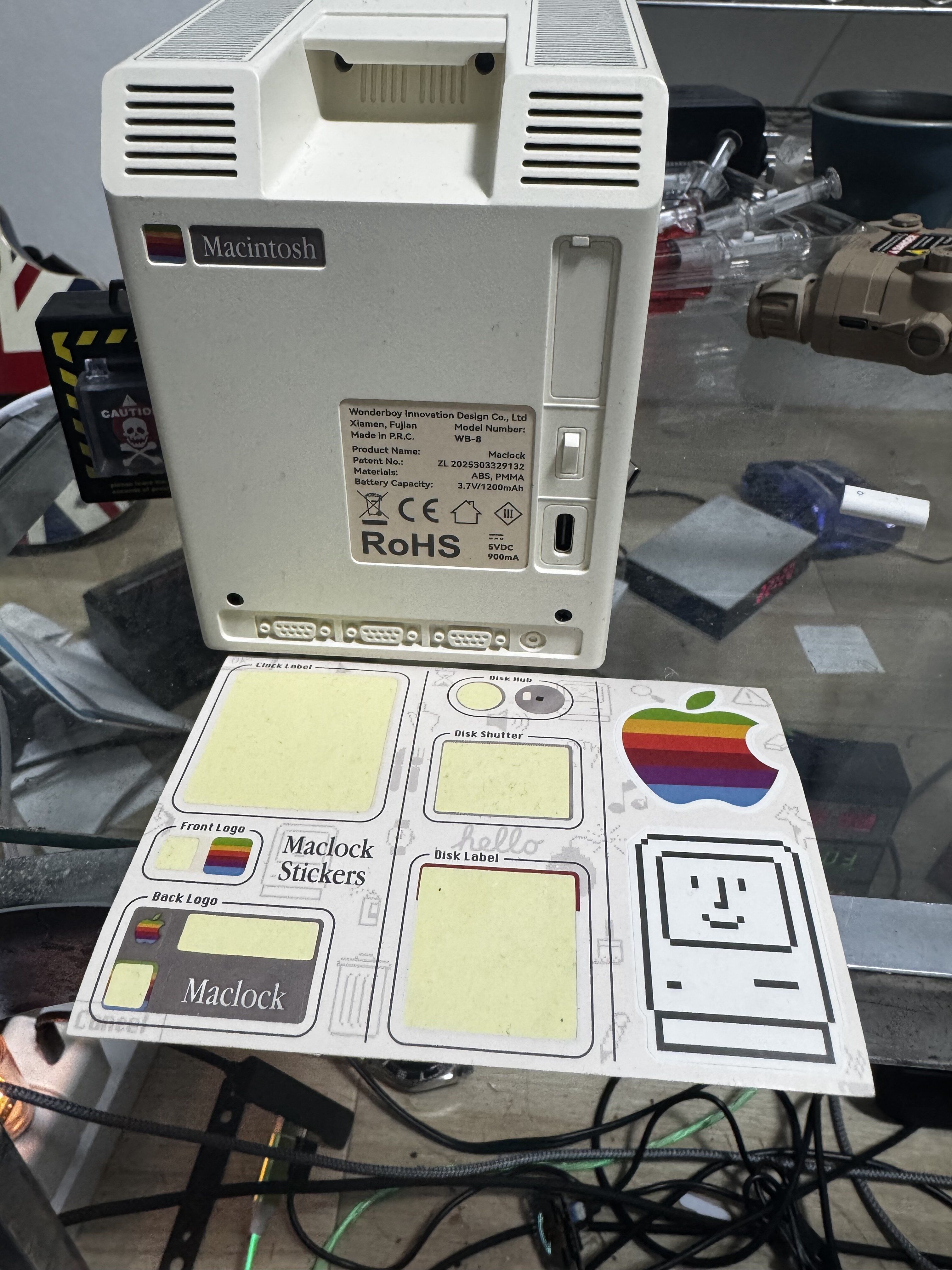

Ah yeah I saw your post that’s awesome. The opposite. I’m hacking and tossing the clock and making it a Mac and you’re making a Mac into the clock. Hilarious.
ya I’m still mucking with it. Going to embed a little Bluetooth module and speaker in it next. It runs system 6.0.8 good seems about the same speed as an authentic Mac plus. Prince of Persia is very playable.
Also mine didn’t have any Mac branded stickers so I made my own set and made the label on the back just like a real Mac plus.
I wonder if they got slapped by Apple and had to change their sticker.

I’m also curious about the Pi side of things —
how did you manage to boot straight into Mini vMac without showing the Raspberry Pi splash?
That illusion of “it’s just a Mac” from the moment it powers on is something I’m really trying to achieve too.
Reactions: europlus

Haha yeah I spent too much one time on those stickers.
I looked at the Mac plus and made one that’s a close match.
it came with stickers but no Apple logo just a rainbow colored square and nothing “Macintosh” and everything “Maclock”
The boot up isn’t perfect but pretty good.
theres 3 weird dots in the middle of my solid gray boot screen I haven’t figured out and for a second or so when the screen goes black you can see some text appear on the right rotated 90 degrees but not a show stopper.
On power up the screen turns solid gray first. And then turns black and the mouse cursor appears and then miniVmac starts up and you hear the system beep and the happy Mac appears.
One other minor issue is the “Welcome to Macintosh” message box is now not centered. It’s up and to the left a bit so you see both that message box and the happy Mac. This is because of the scaling I am doing to get it to fit right with the black margins on that tiny lcd panel.
To get the non Debian / Raspberry pi startup screen I created a custom Plymouth theme at /usr/share/plymouth/themes/macintosh/ Macintosh.scri
In this file is:
Window.SetBackgroundTopColor(0.75, 0.75, 0.75);
Window.SetBackgroundBottomColor(0.75, 0.75, 0.75);
And then a Macintosh.plymouth file with:
[Plymouth Theme]
Name=Macintosh
Description=Classic Mac boot screen
ModuleName=script
[script]
ImageDir=/usr/share/plymouth/themes/macintosh
ScriptFile=/usr/share/plymouth/themes/macintosh/macintosh.script
To autoboot I made a script in ~/.config/labwc/autostart
wlr-randr --output DPI-1 --transform 90 &
sleep 5
cd /home/sideburn/micromac && WAYLAND_DISPLAY=wayland-1 ./minivmac &
I also set the horizontal positioning there:
wlr-randr --output DPI-1 --pos 30,0
This shifts the screen to the left. To get it to center.
The scale is set and then vmac is compiled at that scale setting :
./setup_t -t larm -m Plus -hres 576 -vres 430 -fullscreen 1 -speed z -emm 0 > setup.sh
I had to put some sleep delays in and stuff to get vmac to force itself to the front. It was tricky and took a long time to get sorted.
I did everything from commandline through SSH. I never used the Linux desktop environment or VNC
In this file is:
[Plymouth Theme]
Name=Macintosh
ModuleName=script
[script]
sleep 5

what’s the front of your maclock look like, is it blank or is there a branding name printed on it? My first maclock has the company’s name on the front of it and THAT one came with the version of stickers that have alternate “Macintosh” and rainbow Apple logo.
The second one that I hacked does NOT have any company name printed on the front and its sticker sheet is same as yours but without any Apple logo or “Macintosh” versions. Only the square rainbow and “Maclock”.
fonts - no I used something else I found that was a close match. I forgot about Apple Garamond. Ya I used to do a lot of Flash banners and websites etc in the early 2000s and UI designed all my software so I’m a bit anal about that stuff too and actually what’s driving me nuts right now about my stickers is if you look closely the horizontal alignment is off and it’s not me my graphics are spot on but it is the Cricut cutter is cutting them with slight offset. I didn’t notice until after I finished but I may go back and try to calibrate it and do them over.
On the splash screen - at first I tried loading an SVG image but it didn’t work so I ended up just making it a solid gray fill with code and no images.
omg the rainbow Apple is crossed out!!!
Mine didn’t have anything printed on the front at all.
The sticker sheet had two rainbow Apples and two rainbow squares (the Maclock logo), so I put the Apple on the front.
Then I put the square + “Macintosh” on the back.
My guess is the batches changed over time.
Your first one might have been an early batch with the printed branding and Apple logos.
Mine feels like a middle batch where they let you choose between Apple or Maclock using the stickers.
And your second one might be the newest batch where the Apple logos were removed entirely and only the Maclock branding remained.
Honestly it wouldn’t surprise me if Apple warned them about using the logo and they had to change things.
What really caught my attention though is that big rainbow logo being crossed out.
The crossed-out Apple almost feels like the Maclock team being a bit sarcastic about the whole situation.
Also your setup is seriously impressive.
The floppy power control and booting straight into Mini vMac is such a great touch.
It really preserves that “ritual” of starting an old Macintosh.
If you're still offering the STL files, disk images, or setup docs, I'd honestl love to take a look.
I'd be really curious to see how you structured the boot flow and everything beh.
View attachment 27380View attachment 27381
Hahaha! I didnt even notice it was crossing out what was the big apple! hilarious.
my first one had the exact same stickers as yours... two options..
I think I am FINALLY done with this project (yeah right) and I just made a short video and posted a new thread here with links to the video and some new photos: https://tinkerdifferent.com/threads/micro-mac-plus-macclock-hackintosh-with-all-the-balls-and-whistles.5170/#post-45567
I will eventually make a build video and maybe do a GitHub. I made a lot of changes over the last day to the startup scrips so it is very polished now. I also added an AtTiny that connects to the piece speaker and plays a tune when you plop a disk in. Initially i did this because you needed some "signs of life" because the screen was black for so long. I had it also play a little 2 tone "im busy" jingle every couple seconds until the screen came up with the mouse cursor. But after i added bluetooth, that board plays a chime when it connects so there really was no more need for any sounds. I left the disk drop sound in there though.
yes I can you you the STL'S etc.
