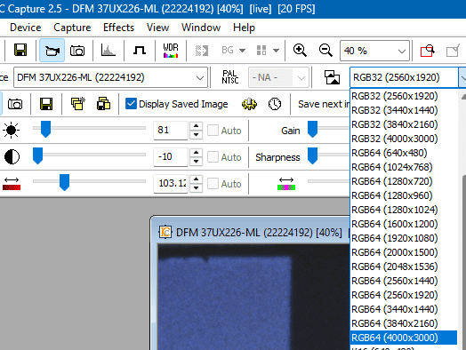

As this is based on dashcam technology, another clue is the weird 20fps. I filmed the LCD as the film was pulled through with a GoPro 120fps, and observed the sensor image is updating at 20fps. This is a bad sign. As a 20fps readout at 3280x2464 on this old SoC, is very unlikely. If the sensor is an OmniVision OV8810 (or similar), they can only read 3K at 10fps (it would have been better to see a 10Hz update)
Yet the same sensor does do 1080p up to 30fps. This is either binned or cropped, but likely binned. A binned sensor has a minimum of 2x2 resolution drop. 1640x1232 is the likely input image to the pipeline. This is still okay, way more information than Super 8 film is likely to hold. But I see less than that. When I test how much the reframing allows for left/right movement, to scan off the film, only about 56% is used for active picture. That would be around 932x700 for the good part of super-8. I'm resolving slightly less than that, more like 640x480. This part I've yet to determine.

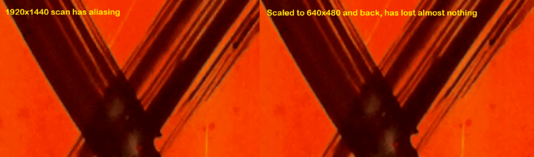

I felt the resolution is so low as I'm seeing odd artifacts at the spocket hole. From a 1920x1440 scan (Mac84's spocket here) the smallest detectable detail is always about 3 pixels wide. 1920/3 = 640.

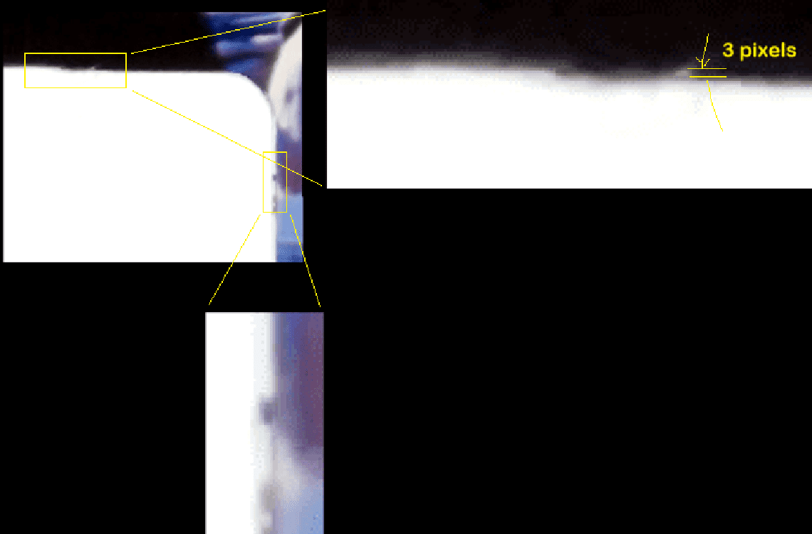

This could be a binning/debayer artifact at that bright edge, so I confirmed this by scanning some writing on the leader. Here is a crop of a leader only scan, no film grain involved. The image has aliasing that shouldn't be there, the aliasing is again around 3 pixels wide. Crudely confirmed but scaling the image down and up again, to see at what resolution the image information/detail is maintained.
As we are not getting the original source code, so the native sensor read-out is not available to us. I gather this is a M12 lens, that you can unscrew, and some users are changing the focus. My theory this is a 12mm lens (focal length), whereas it could be a 16mm, this would be 33% bump in scanned resolution, just be tighter in the framing (so camera alignment might be an issue.) A manufacture might choose a wider lens, to ease the tolerances, to make the device cheaper.

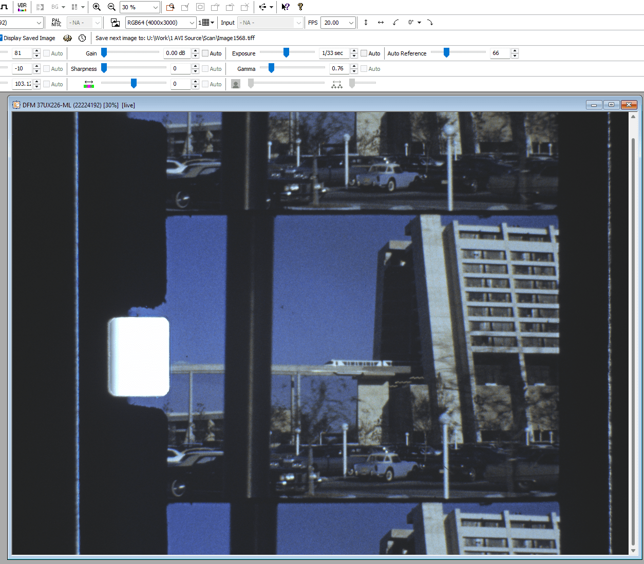

@fishgee Thank you. I have lens out now, and it appears to be an 8mm lens.
This is not great news, the lens is wider than I had expected. The active Super-8 frame will use 5.46x4.01mm out of an effective FOV of around 13.4x10mm. This about 40.7% on the active capture area. As I believe the image is binned to 1640, the active useful pixels are 688x516, very close to the 640x480 artifacts I was detecting. Marketing a 1728x1296 capture that is up-res'd from about 688x516 is a tad evil.
I have a 12 and 16mm lens on order to experiment.

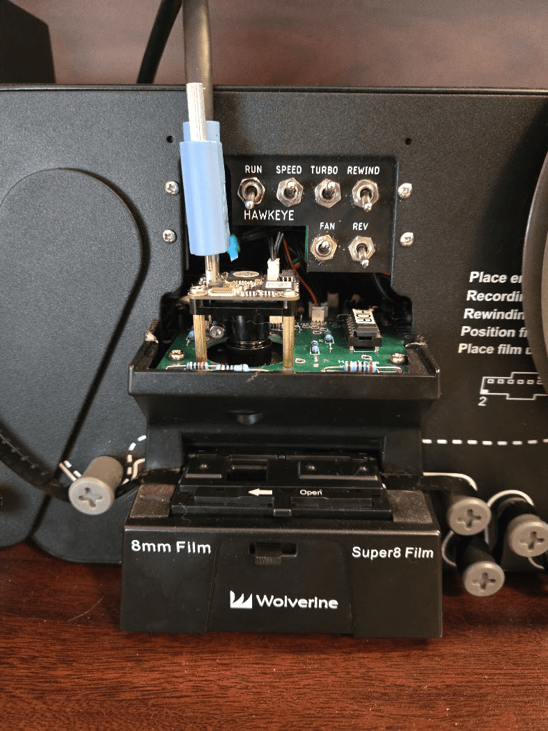

wnt2fly
Dec 23, 2024
16
21
Hi guys, wow I go away for a few days and look at you guys hacking this thing to pieces... So you guys are on the right track w/the sensor not fulling being used. I now have a frankenstein Wolverine with the Hawkeye modifications (I use the Eumig for fast rewind and for applying FilmGuard, it is not connected to the wolverine. The camera uses the IC capture software that allows you to set the resolution, which ranges from 640x480 up to 4000x3000 However, to properly capture at 2560x1920, metal risers are installed to size the image to be a bit larger than the film frame. You can see all of this in the attached images.
So yes, getting the right lens and the right distance from the film is critica. You won't see any improvements in resolution until you pull back the camera with risers, which then will require a different lens. This hawkeye system has a metal lens on it with an adapter to accomplish that.
@0dan0 you should look at https://drive.google.com/file/d/1e1cqvgu3F3VrwqnRD-9OUE_nICm1v9r5/view You probably can use the adapter that the designer used and possibly the lens as well.
@Joe90 I was in touch with a developer/reverse engineer expert on Upwork who looked at the code, he was going to quote me to do the work, but it looks like you are getting there as well. Besides whitebalance, the other thing that has to be fixed is the autoexposure being too sensistive.
Reactions: Federico and Umba67
wnt2fly
Dec 23, 2024
16
21

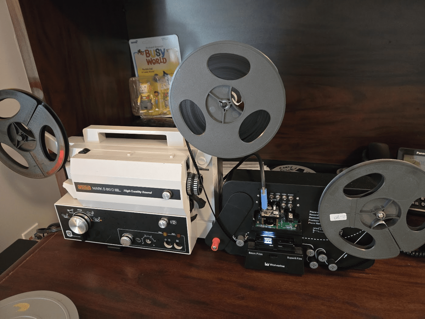

Also here is the end result of the Wolverine Hawkeye after my workflow:
If you have source files you'd like me to run my workflow on let me know, while I don't have a kodak machine anymore, I'm happy to help perfect the workflow. It's mainly running through a slimmed down version of VideoFreds scrip that was updated bys someone else, sometimes NeatVideo, which I run very light to preserve grain, color, crop, resize, sharpen and then focus fix.
Here is a size by side comparison of the Kodak unit (w/a higher resolution) vs the Wolverine Hawekeye. I think w/everone's help we can get the kodak to get close to the hawkeye. (ignore the resolutions in yellow, I typed them wrong. The kodak was at 1920 as well

wnt2fly
Dec 23, 2024
16
21
Wow, that's amazing video.
So do I have this right? You are using a DFM 37UX226-ML camera, via USB to a Windows PC running IC Capture software to capture the images? Is the Wolverine just a transport deck for the film at that point?
I found these links:
https://www.theimagingsource.com/en-us/support/download/iccapture-2.5.1525.3931/ software is free it seems.
https://www.theimagingsource.com/en-us/product/board/37u/dfm37ux226ml/ looks like the camera is around $330 US
I didn't have access to the Google Drive link you posted. I'll request it.
This may turn out to be a long journey.... but so much fun.

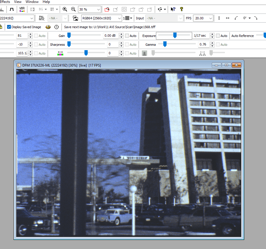

Correct, however the designer of this made his own PCB that the camera sits on, includes an HDR chip as well (haven't tried that feature yet). But yes the wolverine is just the transport mechanism, as well as the light below. Agreed this is not a cheap solution, but it has all the control we want and is probably the next best thing until you get into the $8-$15k machines.
Correct software is free, not sure if it can find other cameras, maybe you can USB to the camera in the wolverine and bypass the firmware? i don't know..
Introduction to the wolverine here as well.
