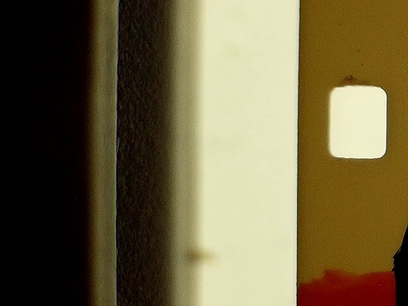

Small break through. I have determine one location when the active sensor region initialized and add some new code for a wider FOV, and therefore more active pixels from the sensor (ready for a lens swap.)
LCD is freaking out, this is one of the better frames.
I found before the above hack the maximum image to the processing pipeline is 820x500 pixels. I tried push this to 1280x960 and 1600x1200, LCD was unstable for both. When I press record the capture region re-initializes to the smaller area (this is other location I still need to find.) If this instability on the LCD is what data looks like, that will bad new for high-res encoding. I'm hoping it something and encode will be good.

Today's progress report. I'm now encoding the wider image (clip below). The largest area I can scan is 1920x1440 (rather than 820x500), yet the video is still offset. This suggests that the video 1920x1440 is windowed from the sensor's 3280x2464. GoPro HERO HD (same era, similar tech) used to crop for 1080, 720p was binned with a FOV 170°, whereas 1080p30 FOV was only 127° (using the center of the lens.) The scanner is doing the same thing, although this is technically better than binning the sensor, the lens performance will now need to be better. This lens is likely pretty crappy, you can see some barrel distortion to the edge of the film frame, the replacement glass will need to be way sharper.
The final issue is the color is very wrong. The console is spitting out errors like
ERR:_SIE_ChgPar() CFA need to be R,
what I believe means the wrong Bayer phase, reading blue or green, when I should be reading red. This happens at any resolution I'm hacking this too, so not a good hack yet. Nothing has said yet, "this can't be done", either a new lens + FW, or moving the camera closer + FW, increasing the effective resolution of the scans 2 to 4X (pixel count.)

I was able to get this to work: original on the lens, 8mm with extension tube on the right. However as this is cheap, non-macro glass, the focused image was soft/mushy and not an improvement (I will only show improving steps.) I have the correct macro lens arriving sometime on Monday.

I was about to give up, it took about 150 builds to allow the use of the lens' full FOV, without the color going wrong.
New lens should be arriving Monday. I still feel the image pipeline is still losing resolution somehow, so maybe none of this will work out. The challenge has been fun.
