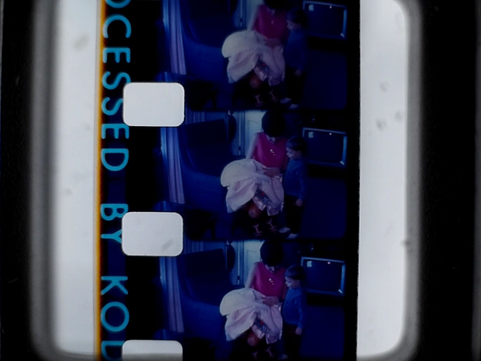

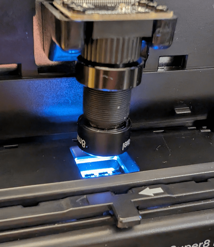

Have my new macros.
Surprisingly does get the film mostly in focus, some edge softness.
However, is confirmed my fears that there is something else limiting the resolution of this system.
So while new lens has almost perfect coverage, it is not improving the resolution as expected, there still seems to be some low-res stage that the image processing is operating at. When at max zoom out, there shouldn't be upscaling halo artifacts we see here (highlights have darker dots in the middle.) These dots are not present (less so anyway) when setting the Reels zoom-in to max. This is not a lens artifact, to get generating in the processing pipeline. This is all with sharpness set at -2.0. So while the hacked firmware is reading a full 1920x1440 image, and encoding at 1600x1200, there is interim processing at 640x480 or similar.
Anyone want to help be find this next stage of the hack?

Have my new macros.
However, is confirmed my fears that there is something else limiting the resolution of this system.View attachment 19963

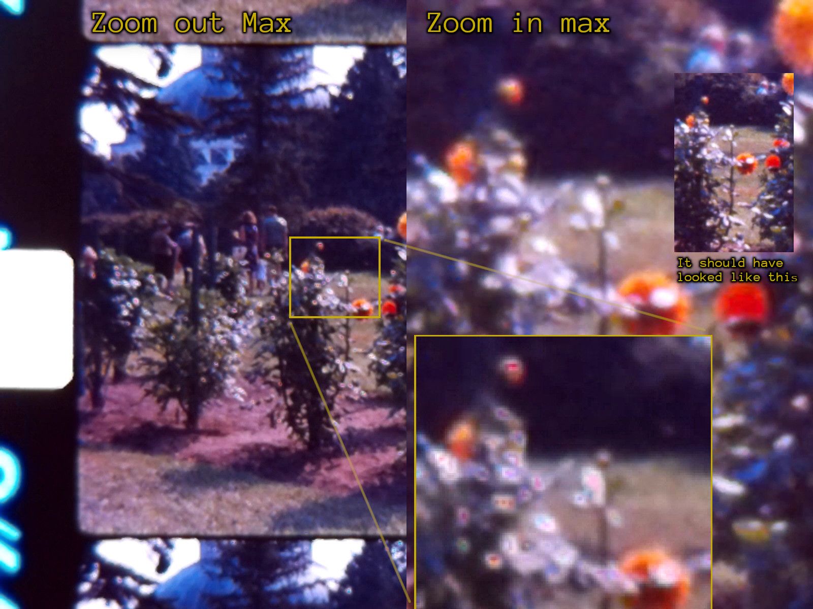

I have now proven this hardware is capable for a 2K scan (1920x1440).
Now while it is has issues, major glitches, this is a pixel of pixel encoding at 1920x1440, no interim scaling.
I'm seeing details that have never showed before, the sharpness of the sprocket edge, and one pixel thick scratches, no aliasing anywhere.
Also the above image is at sharpen 0.0. Clearly the sharpness was tuned for this resolution (i.e. Dashcam res), not the crazy results it get with the cropping region of the default lens.
Attached is the current work in progress build, no not use unless you want develop on it.
Search on strings HACK PT1 and HACK PT2. PT1 is the preview setup, and PT2 is the record setup, lots of new code in there.
If you zoom-in the capture works correctly, like stock FW, as the working frame buffer shrinks to 840x632 (and smaller.) All the code changes is the width, height and pitch of the frame. At the larger sizes we are getting buffer corruption, same memory is being used twice to different purposes. Maybe somewhere in the code there assumptions for buffer size. The SoC has plenty of memory, so this is fixable. I just don't have any strong leads.
I never never worked out where the 840x632 (res at max zoom-out) is originally computed, only where the results of that computation are stored. The hack modify places where the resizes are stored in memory. I expect something is using the size before I modify it, so frame buffers are allocated with the wrong size. Also frame buffers are likely allocated once on startup, so find that, we may have a stable working solution to upgrade a standard def res. scanner to be a 2K scanner.
This is a demo of how far the resolution can be improved. Both are crops from 1920x1440 encodes with a higher bit-rate. Left is a new lens using most of the sensors capture area, right is the stock lens with a much smaller capture area.

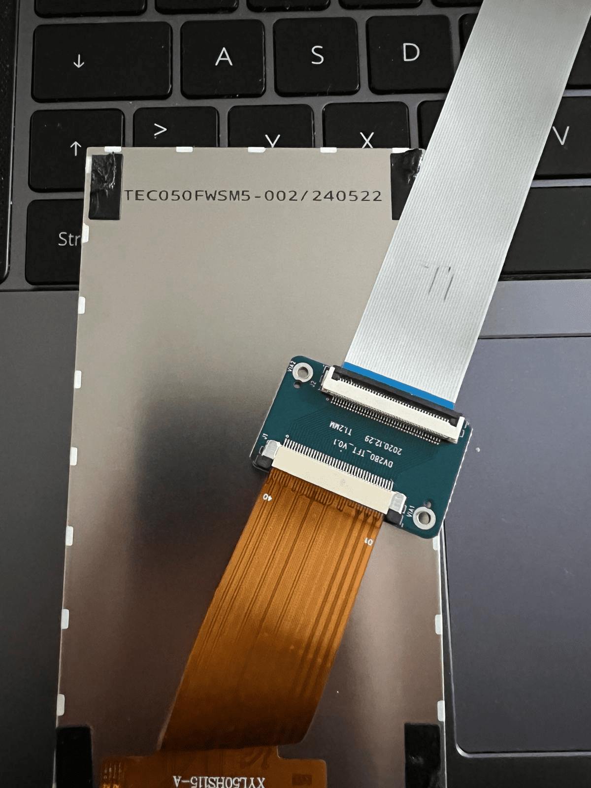

I'm diving into where the frames are stored in memory, and have run into a new question. When the system boots it reports:
I always read that 1024 as 1GByte. Yet that Mb <- seems to be Mbits. Only 128MBytes, that is tiny. Does anyone have the parts list, or images on the underside on the mainboard? I'm looking for the part number for the DDR memory. When I do a memory dump, the data repeats every 128MB, so it seems confirmed.
Having a small memory, might explain the tiny frame buffer Reels has designed for.
Oh interesting, I think I saw 1GB, but that divided by 8 is 128MB.
I think there is a Novatech SOC which I think has embedded memory. I’ll attach some photos to this post, but I don’t think I see any other chips that could be RAM related.
