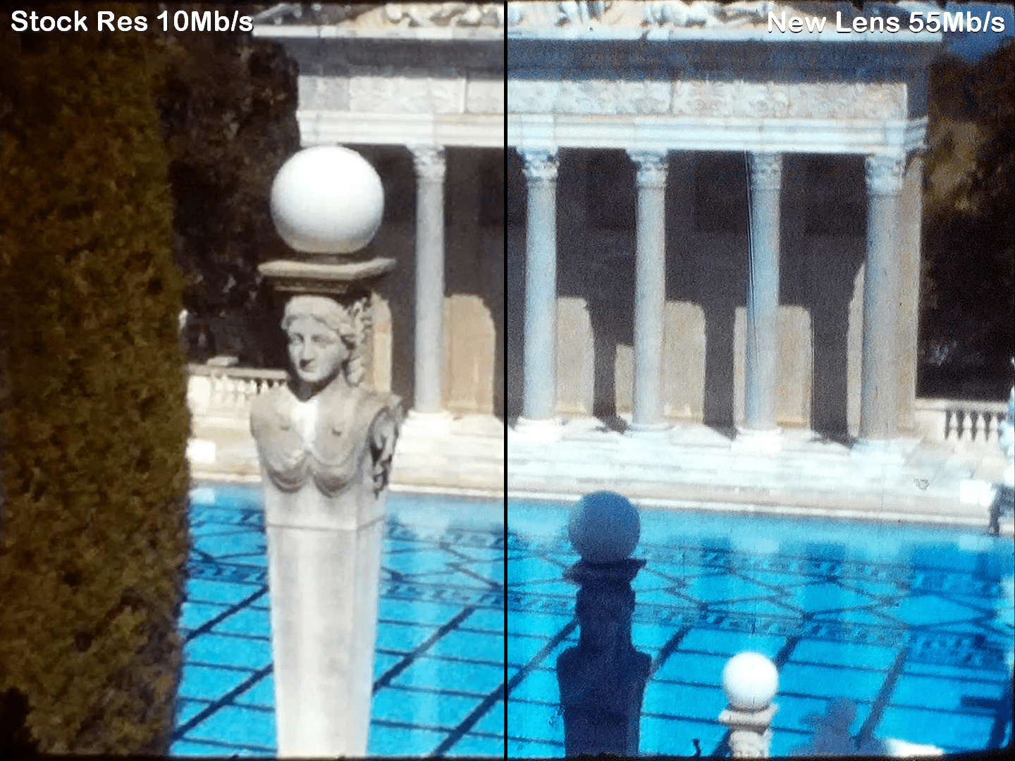

Hello 0dan0,
I have a question, is the image with stock res 10 already with the patched ABW? I ask because the right part of the image has a blue cast on the building columns that is not noticeable on the left side. However, a beamer salesman once told me that you should not judge the quality by still images, but always in normal playback. Therefore, it can also just look like this in the still image. Otherwise, as always, great work 👍
Jan 13, 2025
419
561
Left is completely stock, with original auto white balance, and yes is happens to get the WB pretty good for this segment, but it all over the place through the video. The fixed/locked WB is a tad too blue, but is easy to fix in post.
Here is a short version at 4K, as youtube preserves more at 4K (do play at 4K, as the HD encoding on youtube is bad.)
