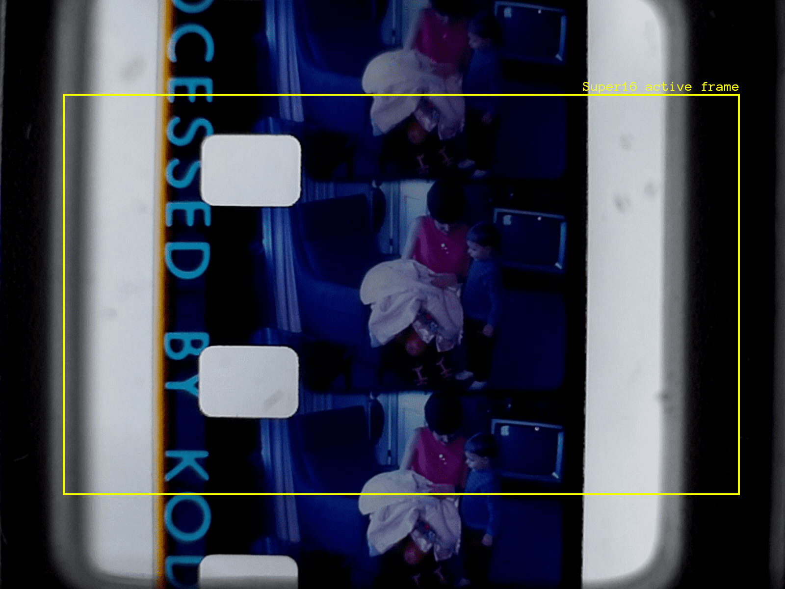

Hey guys, what you are doing with the Kodak reels is incredible! I'm very inexperienced in the "hacking/modding" world still but I had a thought and wondered if you guys think it's possible.
What do you guys think about a 16mm mod?
Do you think it is possible to physically modify the viewing window for 16mm film? I haven't had an opportunity to open my unit up yet, but from what I can see the exposed light is at least big enough to shine between the perforations on 16mm film. It seems there may be a little more light area that I can't see since switching from super 8 to 8mm shifts the entire plastic view guide. My idea there would be to 3d print a different view guide.
I saw user @wnt2fly included the wolverine hawkeye mod on the forum and it seems to keep the view gate area open. I would probably 3d print several different gates (super8/8mm/16mm) and swap them out as needed.
Next would be modifying the film advancer. Now physically I think it should work? I haven't plugged in my unit to see how the movement works (before I got kodak I thought it may be a sprocket) but looking at it this morning I saw a tiny single piece of metal sticking up on the left side of the film guide. Has anyone that's opened the kodak looked closely at these parts? Does anyone know if it advances like a shuttle with teeth (like on a projector)?
I'm assuming (haven't looked at any of the firmware or code on a computer yet) that it would be possible to adjust the timing and positioning for the advancer in the software. The only thing here that I think might really trip up the process is figuring out how far that tiny prong can move (if it can move side to side far enough to advance slightly wider film, a difference of 3.26mm). As far as I understand, right now it can move the film 4.23mm, but for 17mm it needs to move the film 7.49mm.
I know it's ambitious. What do you guys think? Is it possible? Is there anything I'm overlooking that might make this impossible?

@Gwennia This was one of my earlier observations while improving the resolution, the original lens's FOV fully covers what is necessary to scan a 16mm film. It was like the origin optical system was designed for 16mm, not 8mm, even the current light bed is pretty good for standard 16mm.
Using the new firmware, zooming out (the limiters where removed) with the original lens, here with Super16mm picture region overlayed (even Ultra16 would work):
So the only issues are mechanical, as today hacked firmware would support it. Just 3D print the film path and guide, and resolve the socket feeder.
P.S. As I'm hacking Type A & B, I will retry the above image with the image resolution (using the stock lens.)

Yes! Your attached picture is what gave me the idea actually! I noticed that there seemed to be quite a bit of extra light bed aread around the super 8 film. I started researching the super 8 digitizer because I thought all my film was super 8. When I went digging through the boxes I realized half was 16mm. Then, after scouring the internet I found that there is no consumer level digitizer option for 16mm and the only option is to diy completely from scratch. (I have a plan for that if this doesn't work out.)
If the socket feeder can work, then ideally I would have 3d printed plates that I could swap out, and I would reflash the firmware for whichever film I wanted to digitize at the time.
