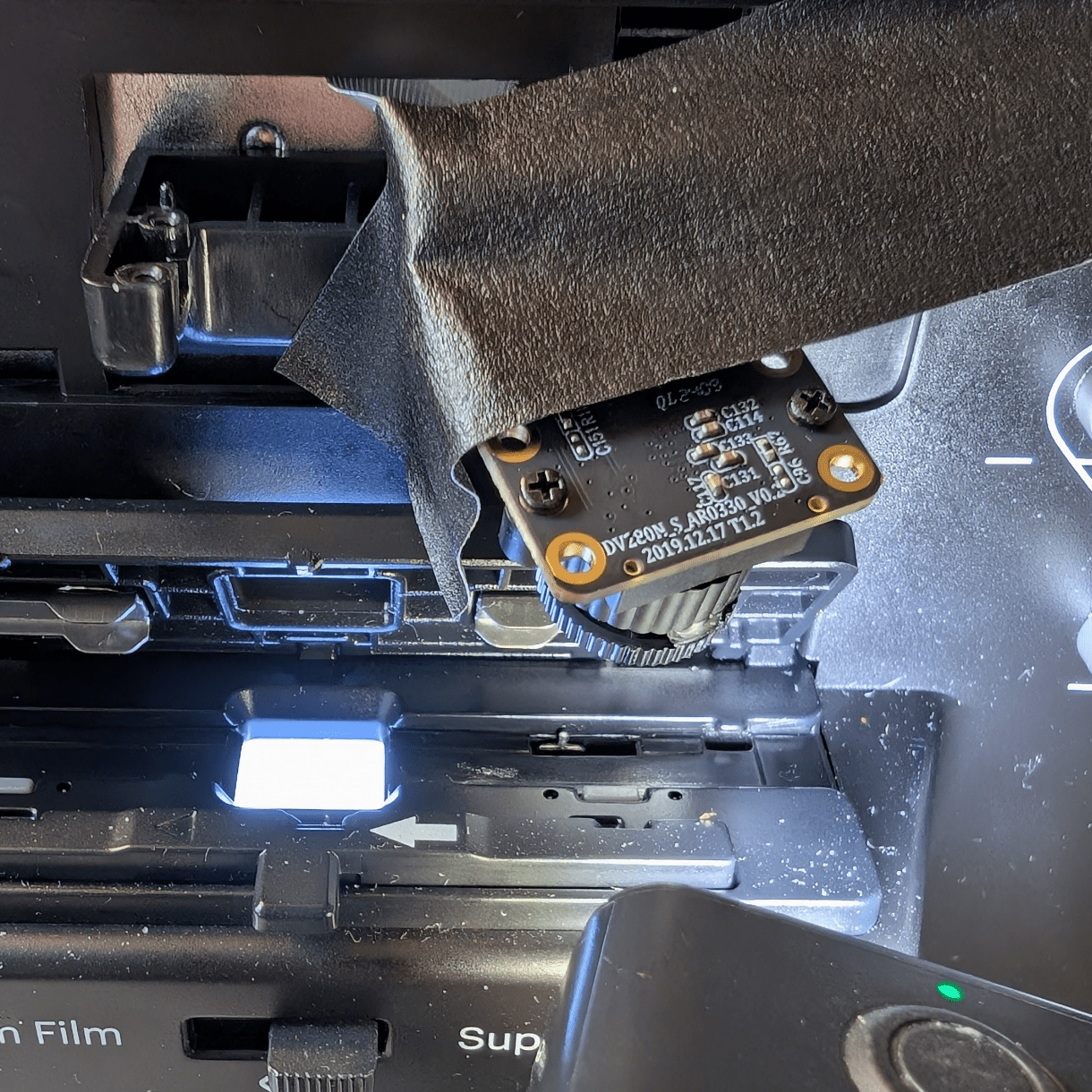

I might need help to find the trigger for the motor step function (and/or the frame grab function.) Even on the stock lens and firmware, you will occasionally see some instability at the bottom edge of the frame. This is a rolling shutter artifact, as the frame is being grabbed, at nearly the same time the film is starting to be moved. You can see this as unwanted motion on the bottom of the frame. See video example. Why the timing is setup this way is bizarre, more sloppy engineering. Unfortunately with a lens swap this happens more often, as the large sensor readout window takes longer, the full frame readout could be up to 40ms (25fps is the video mode used). With the stock lens the only the middle ~500 scanlines are used (compared with my 1200), so it readout will complete up to 16ms earlier.
In other news: Busy week, progress on Type-B is slow, have not started on Type-A yet.
That's interesting about the rolling shutter artifact on the bottom of the frame, when I've only experienced on the top of the frame (and only occasionally). Your explanation about why it's more pronounced (now after a lens swap) makes perfect sense, but I still can't figure out the reason for the variability of this issue in general. Why it happens sometimes but not others, is simply beyond me. And unfortunately I wouldn't have a clue about the motor step or frame grab function. That being said, if the community here is able to access and adjust that, I would imagine it could open up a whole host of new possibilities that could further increase the quality from this machine.

I too very occasionally see the error on the top of the frame (~2% of captures.) That is more baffling, as it might suggest there is no good timing between the motor control and the frame grab.

I found a large degree of timing variance between captures, although it doesn't seem to drift within a capture. The unit tested has stock firmware. The frame grab is generally upon the start from pin reset (stage e). All these captures are after the pin was retracted from the film, but the timing very sloppy, approximate 100ms of error observed.

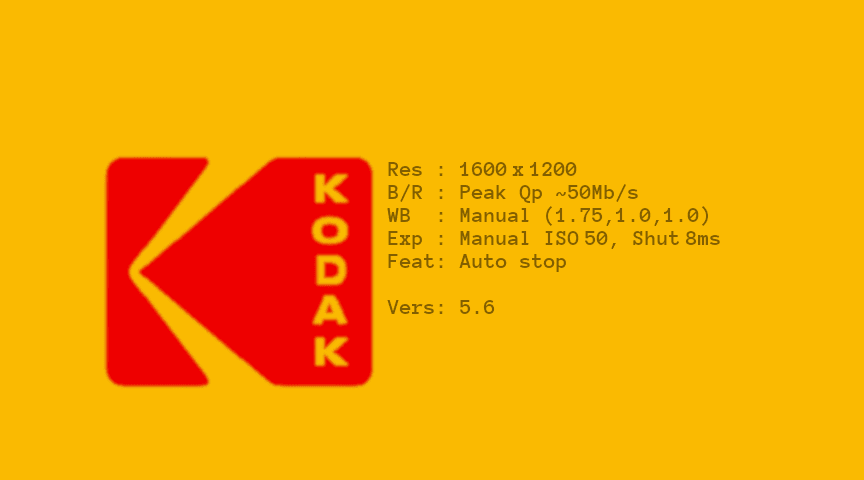

Version 5.6 attached
This is the first version with both manual white balance and exposure. While the code changes for manual exposure are small, there a lot other changes in this build. With each version I change the boot screen and shutdown screen JPGs. There are the same image, yet they are stored twice. The code now uses the same address for boot and shutdown, freeing up a large amount of space for code extensions. All my hacks are now at 338f28 to ~ 33a190 with room to grow. I have restore all the old "audio" code. This might make porting easier.
New boot screen:
Is this firmware a model C version?
New boot screen:
Is this firmware for the C version?

All my updates are currently C version only. I do have A & B units now, but other projects (like work) have got in the way made progress on those model slow.

Thank you for the feedback. You should switch to V5.8 as the also fixes the missing full range flag in the video header (more dynamic range without color correction, or it saves you the ffmpeg step.)
