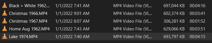

I'm using the 5.8 version right now, and the file sizes for 3" - 50 foot reels is coming in just under 700MB per reel. I realize the B firmware isn't available in version 5.8 (yet ;-) ), but it should give you some indication of what to expect.

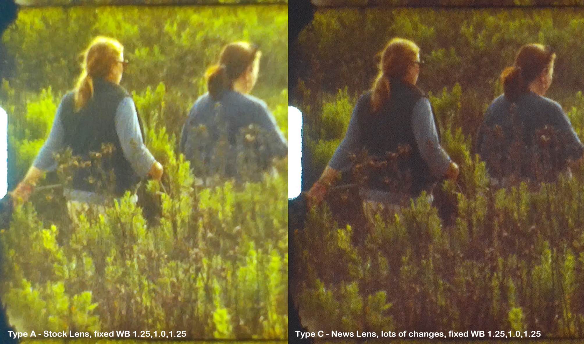

I'm still around and need to revisit more Reelz hacking. I finished scanning all my families 8mm and Super8 from the 60s and 70s, about 4 hours run time, so that took a while. So I needed new sources to continue this hacking hobby. So I'm now shooting my own modern 100D Ektachrome, using a Super8 camera from the 70s. Also can now do film development at home, so other that film and development chemicals, I can shoot, develop and scan in about 3 hours. I did find the fixed WB was wrong for modern film, and my development look, so I need to add a user control for WB Auto and manual.
I'm very slow hacking Type A and B units, now with fixed WB, not much else yet. Having units at different stages helps for progress comparisons.
Shot this film yesterday:

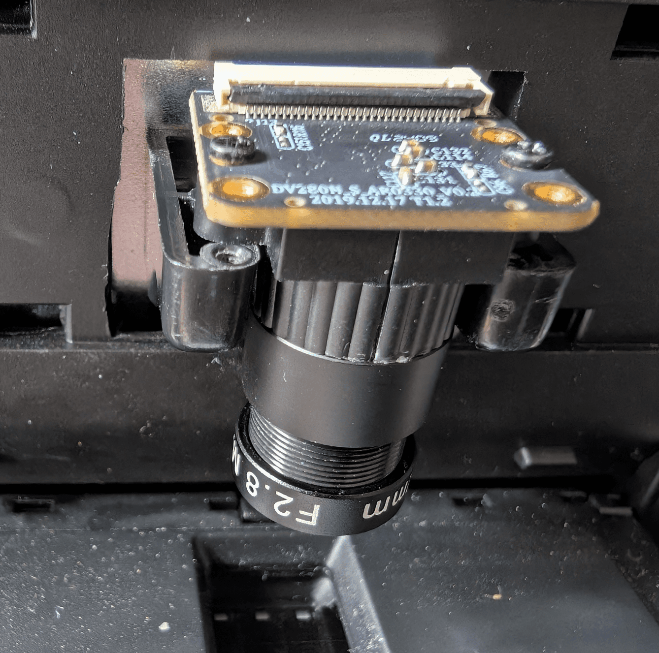

Curious if anyone has a second source (US distributor maybe) for the lens? It seems that store is the only one that has specifically the 2/3 frame and narrow FoV lens, I've seen plenty of places retailing similar lenses but with a 1/3 frame and slightly wider FoV. That lens seems unique to Scorpion Vision.

The Scorpion Vision lens is very good, but technically overkill for this system. We don't need a 10MP 2/3" lens, as the sensor is only 1/3" and 1600x1200 is only 2MP. So a 1/3" lens can work, the issue is it must be designed to be a macro lens. I went through a dozen (cheaper) lenses, but none could focus at the distance needed, or if I could get a focus, the was other artifacts like halos for using the lens beyond its design. Very likely there are US suppliers for a nice 12mm macro for 1/3" with a 2-3MP rating, but so few vendor spec. the minimum focus distance.

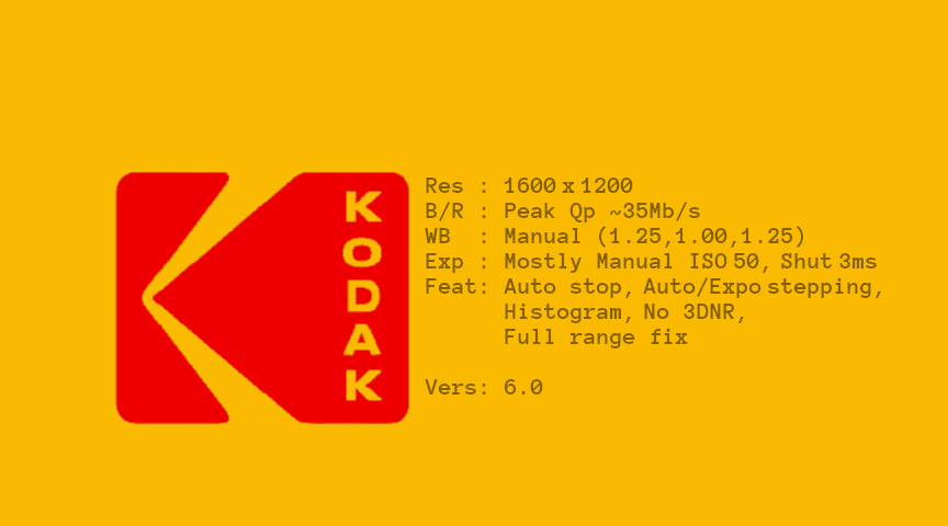

I have now Type B and C running all the current hacks, unfortunately the Type A (with the same changes) crashes on boot. I expect there is a device drive address change I haven't handled yet.
My default (fixed/manual) white balance has moved to better match the modern film I'm scanning. Manually editing the .rbn for other WB values is not too hard.
Attached are V6.0 for Type B and C
P.P.S. I just fixed the color reversal error in Type B. I had just missed a 4 bytes in the port from Type C.
  • FWDV280-TypeC-V6.0-0dan0.zip
  • FWDV280-TypeB-V6.0-0dan0.zip

Are you planning a Lens upgrade, as that create the biggest benefit? I'm in the process of replacing the lens on my Type B unit, to match my Type C. I haven't set the mounting position yet.
