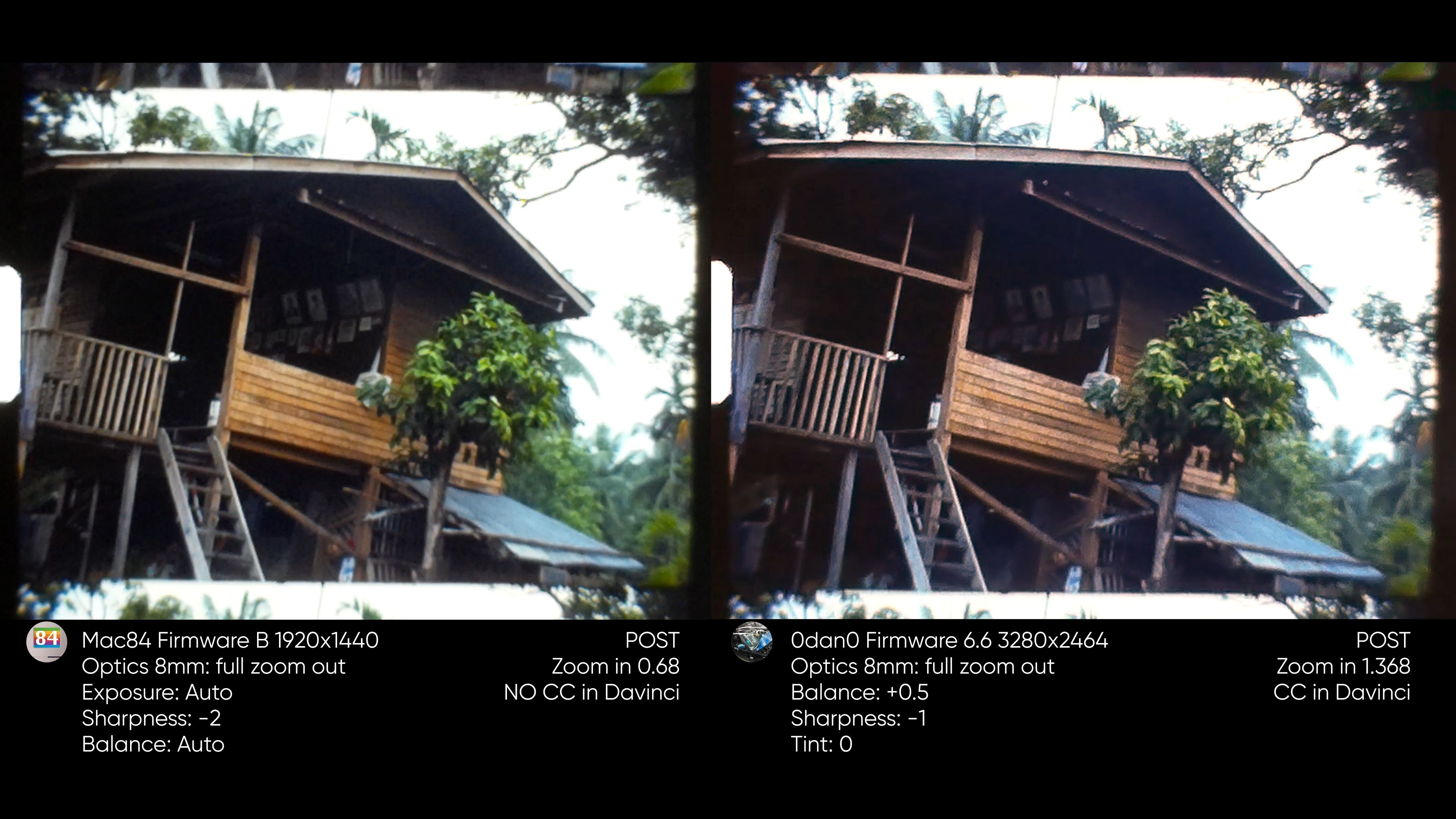

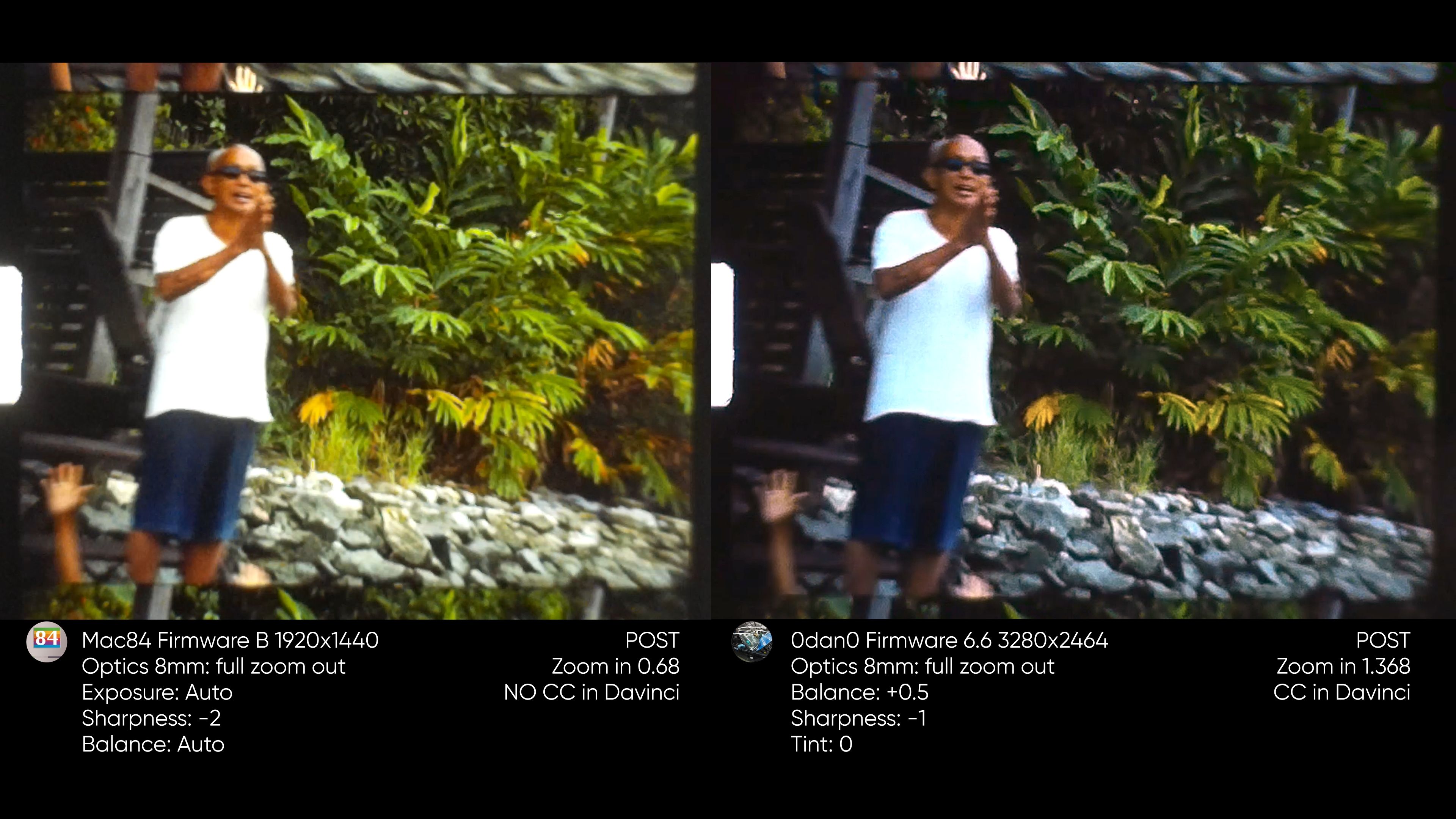

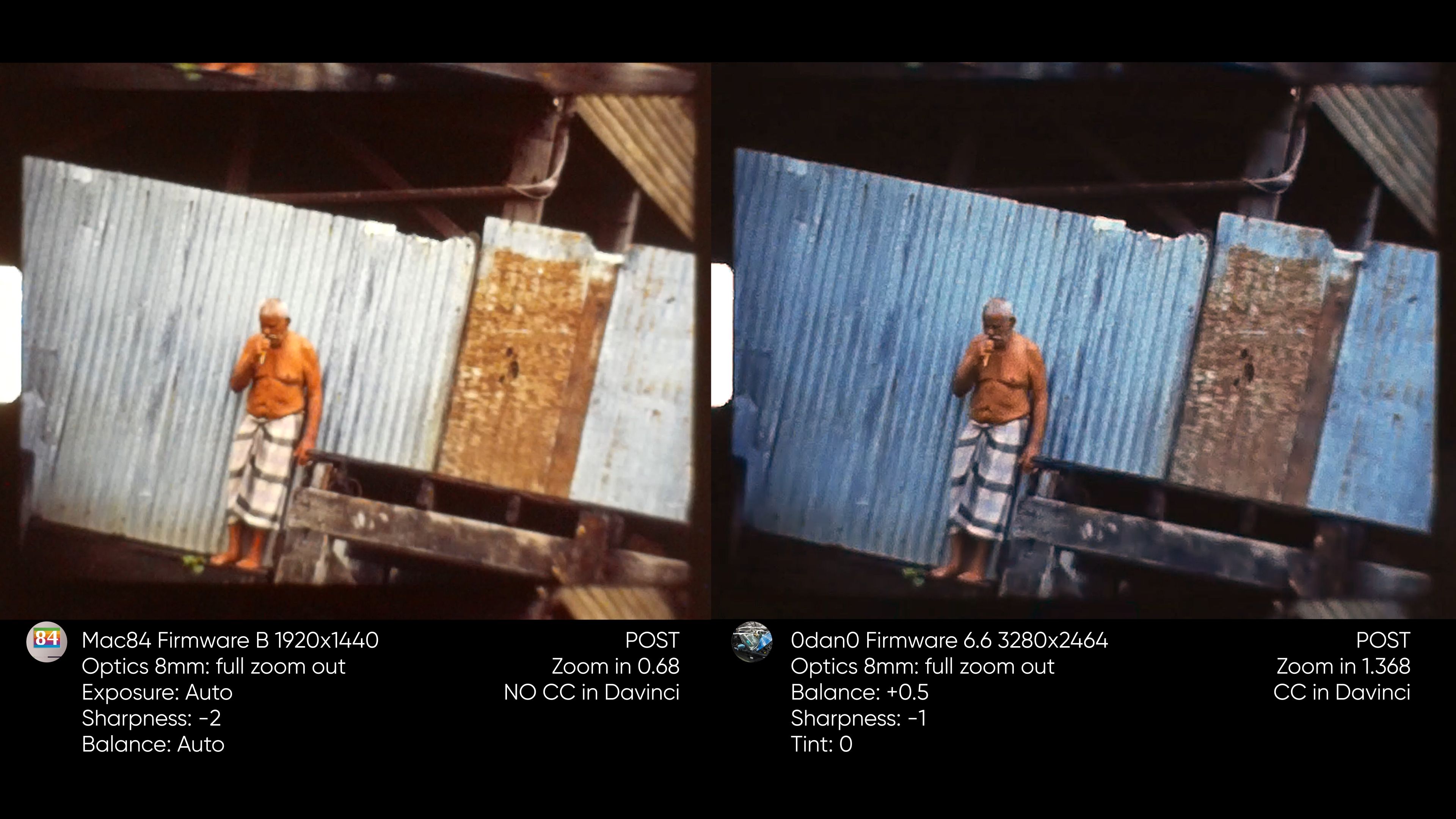

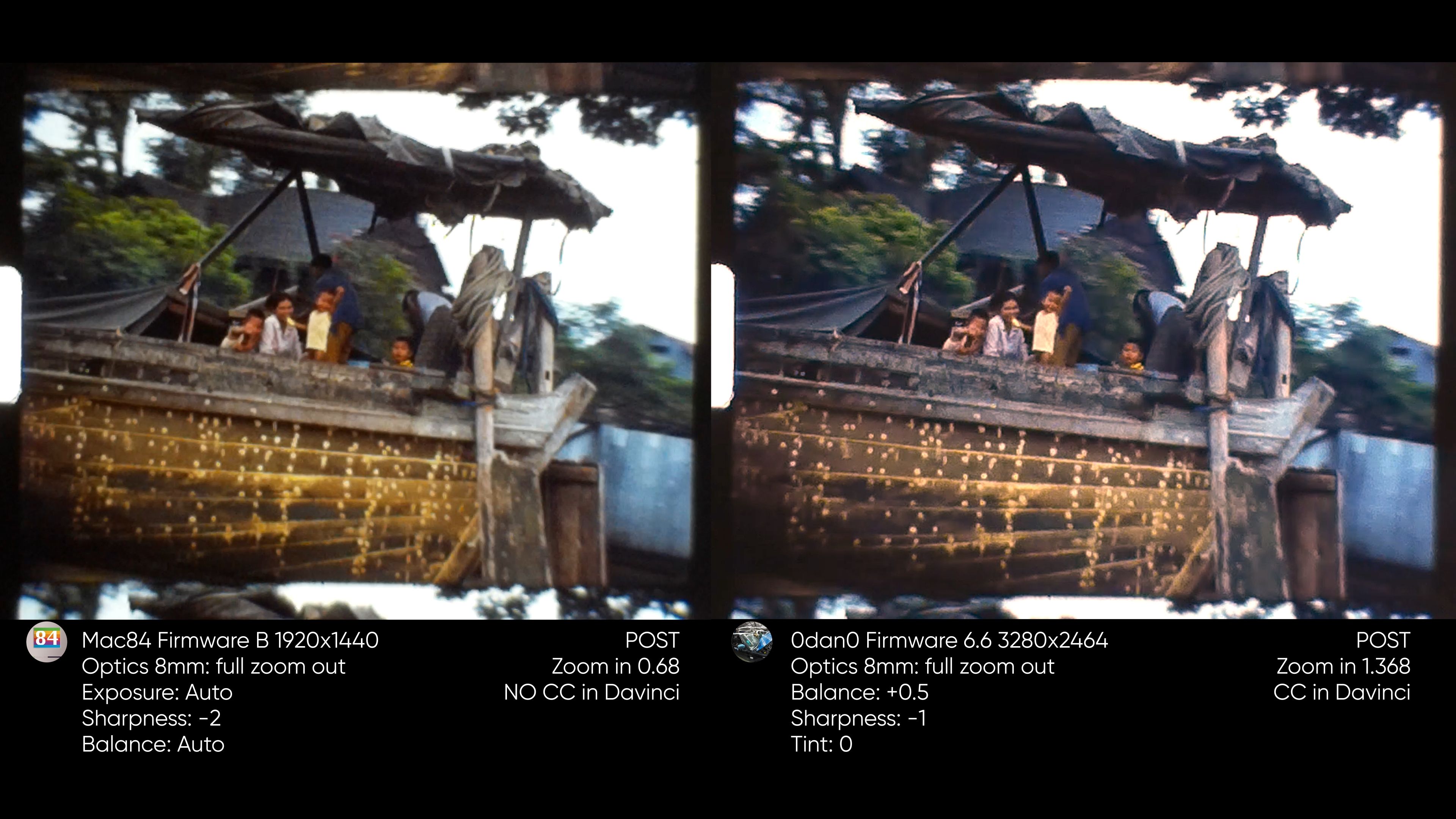

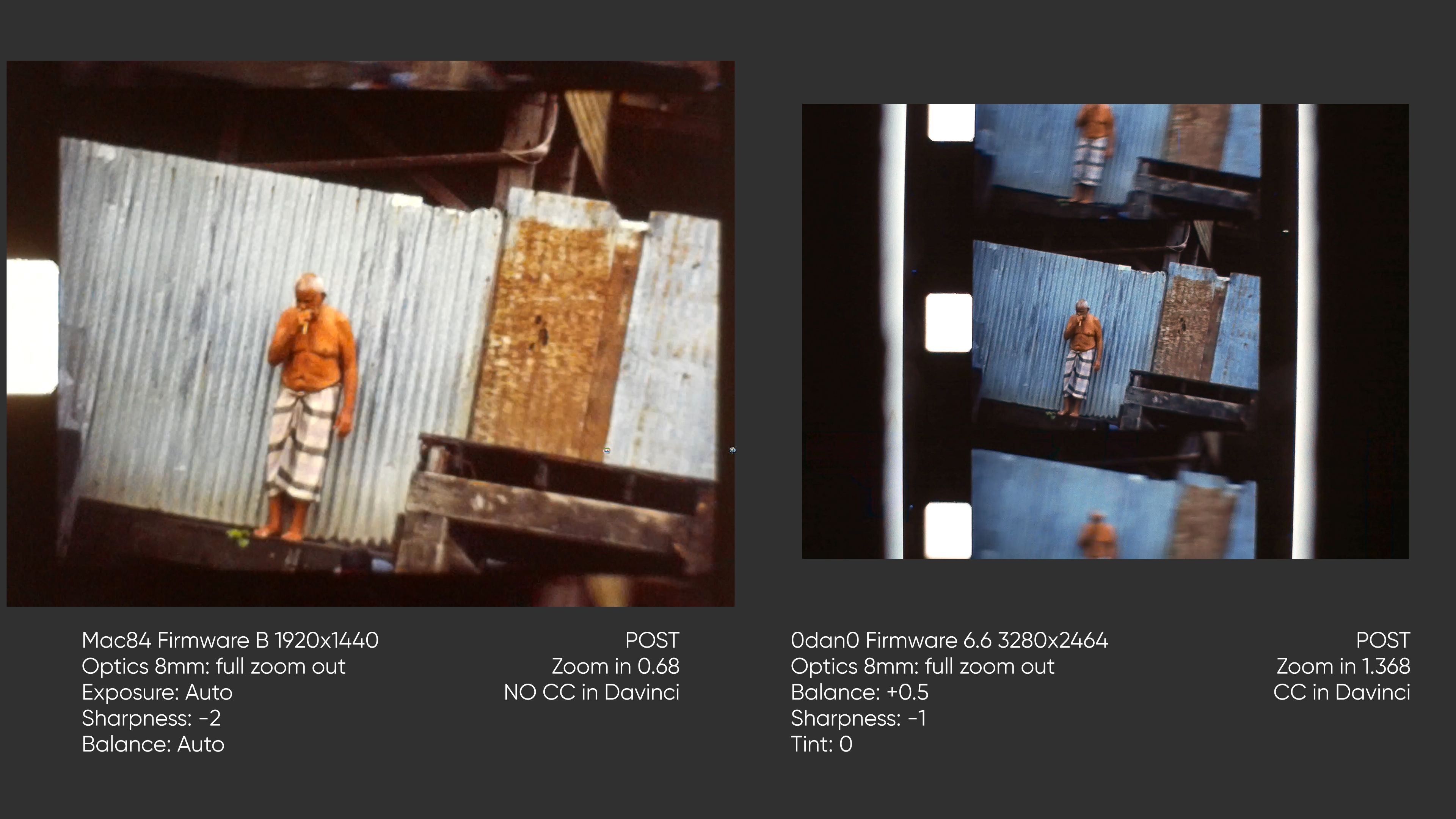

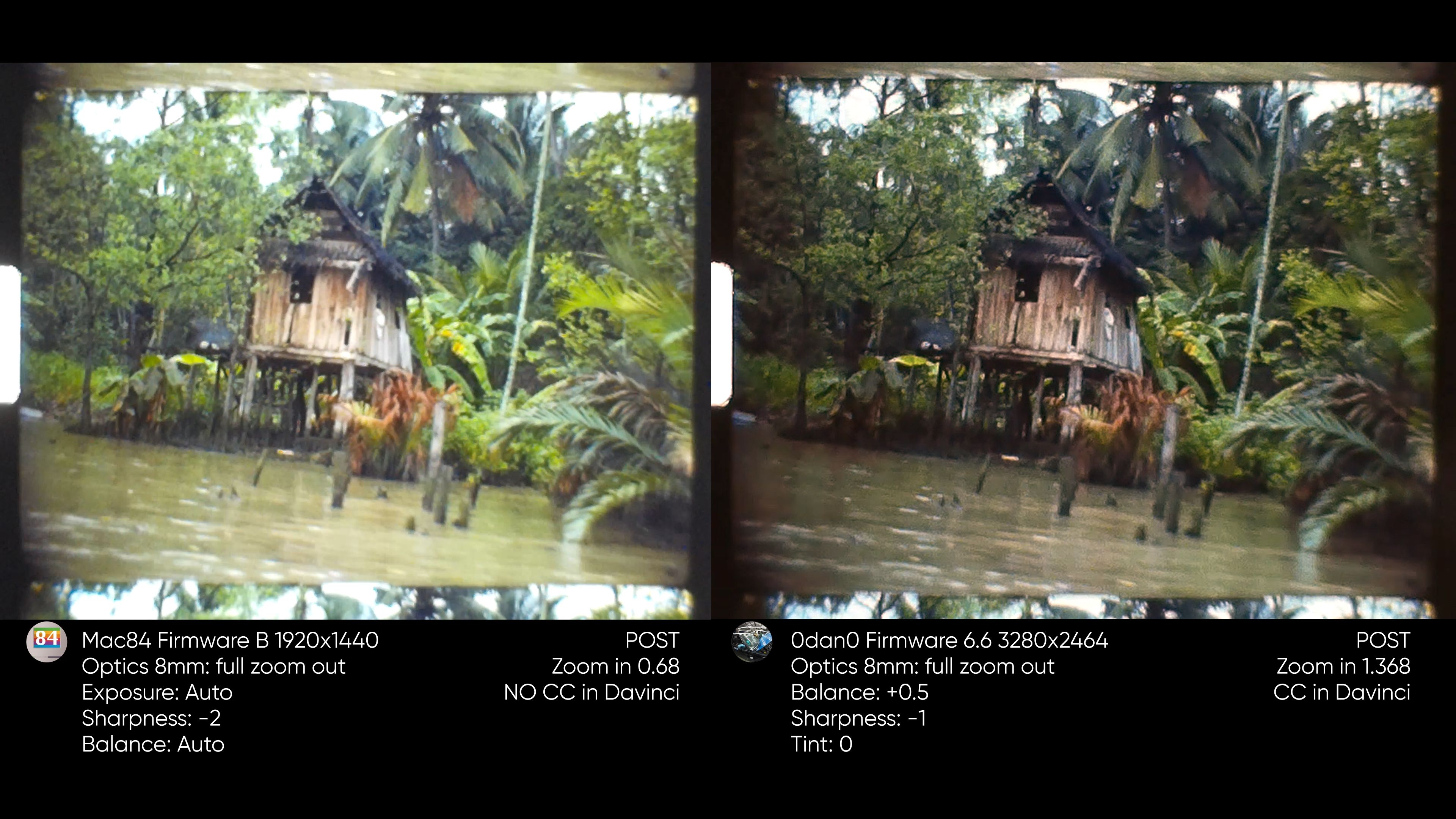

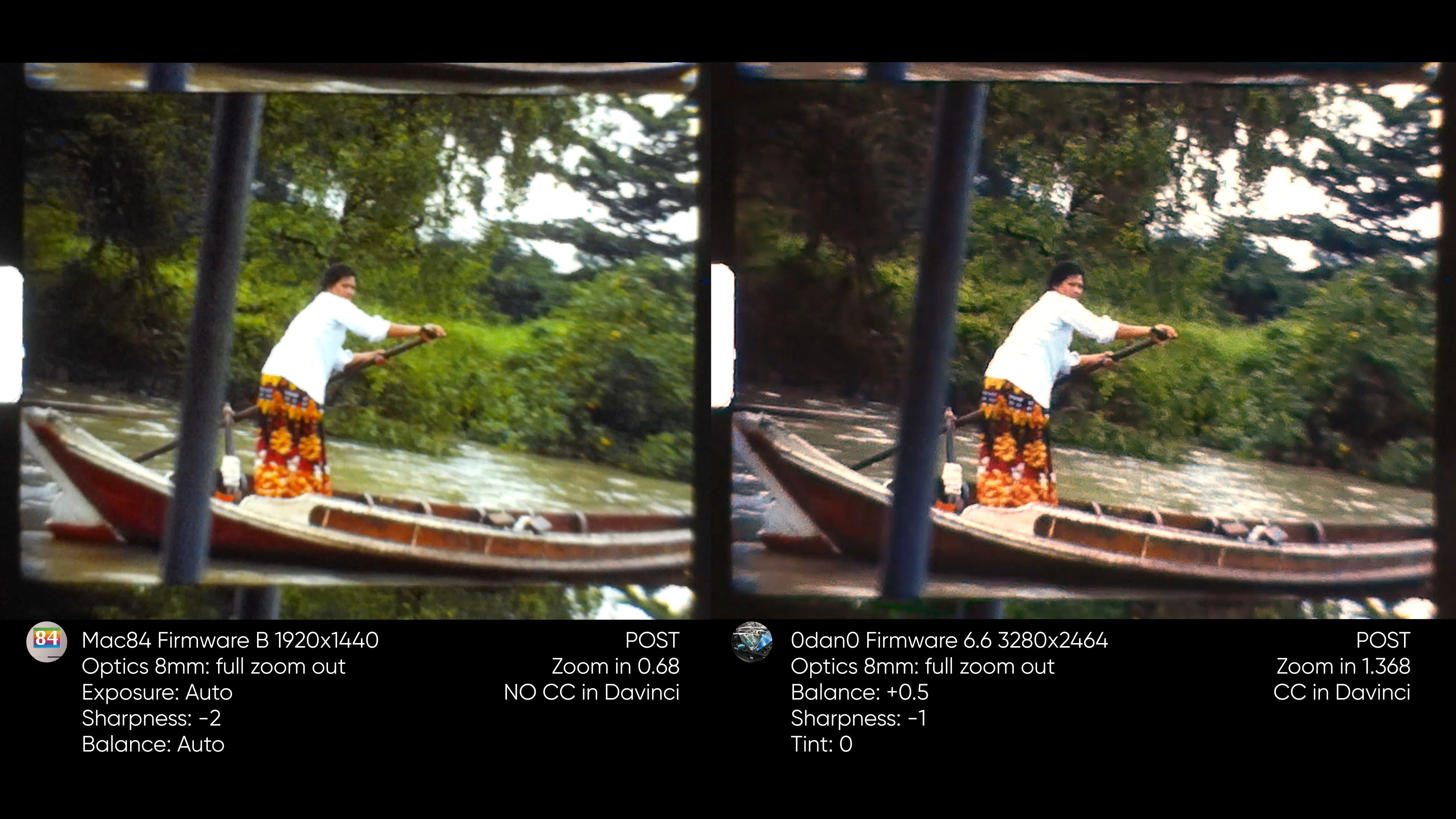

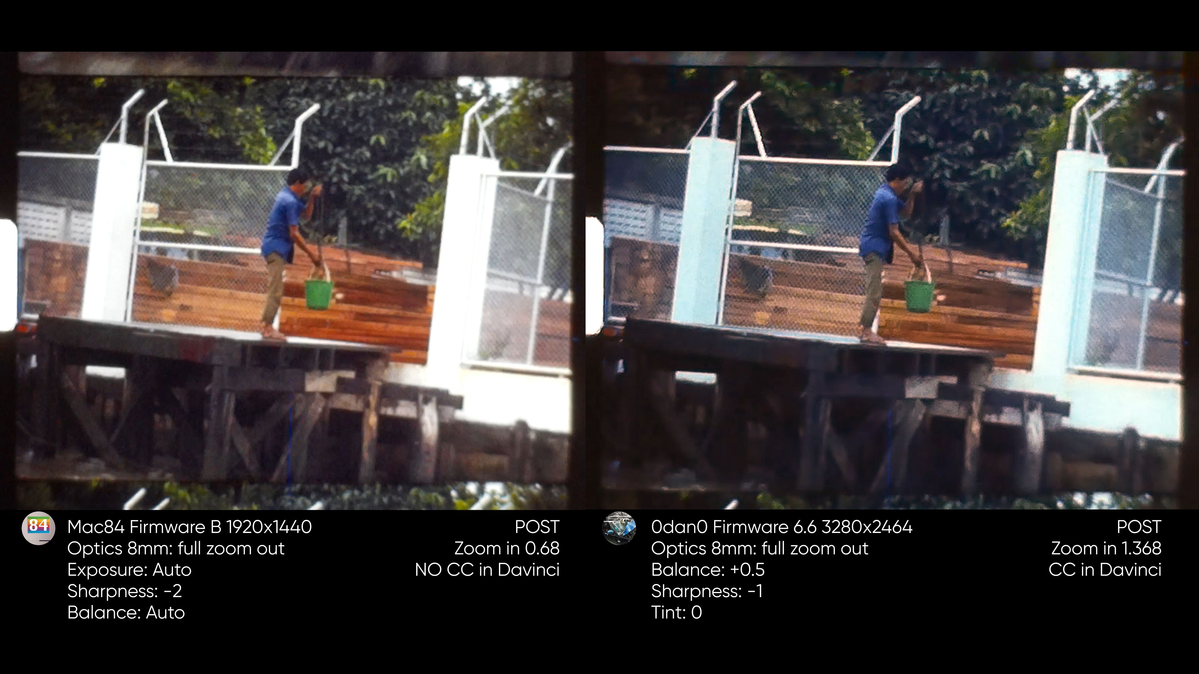

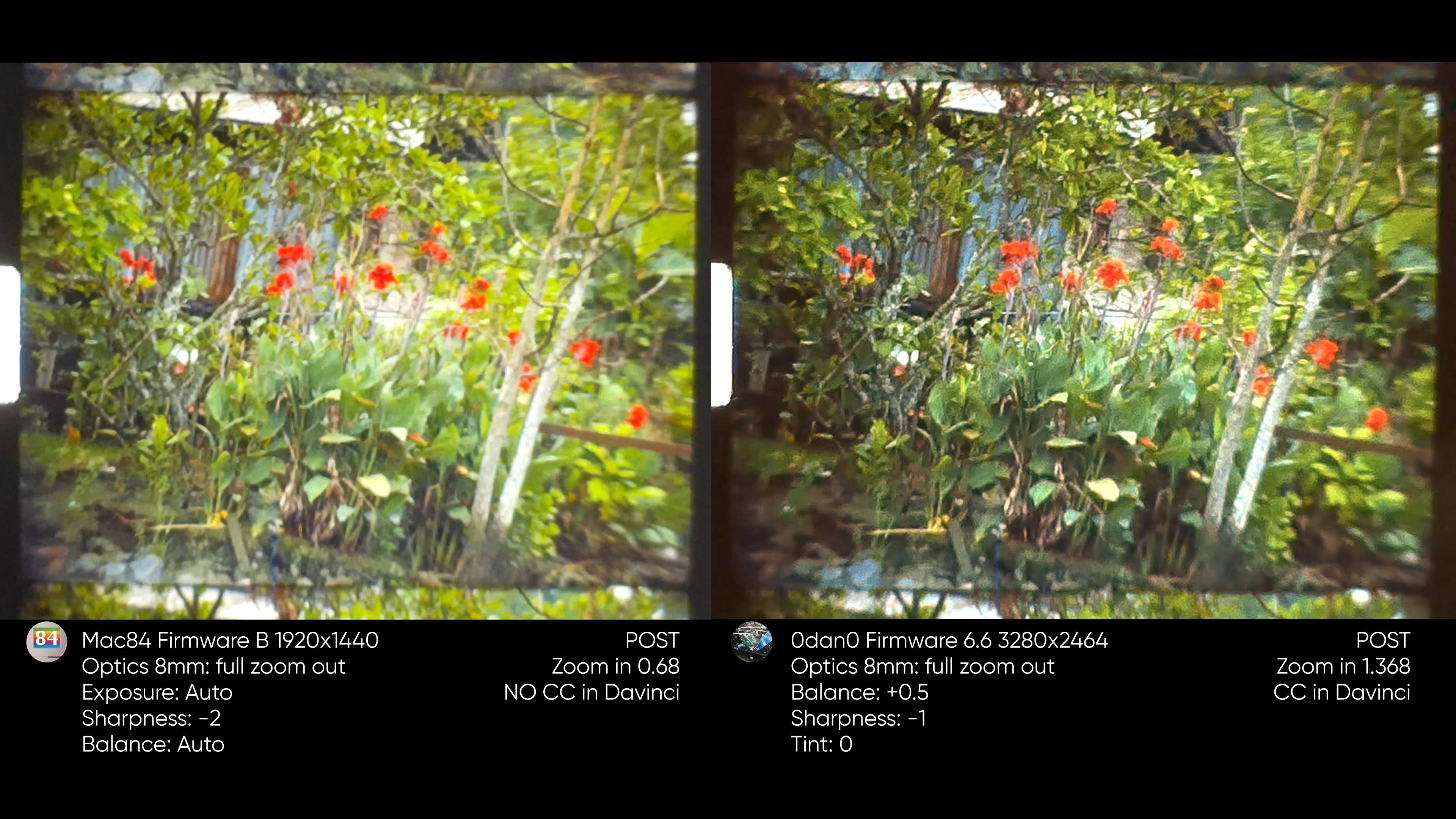

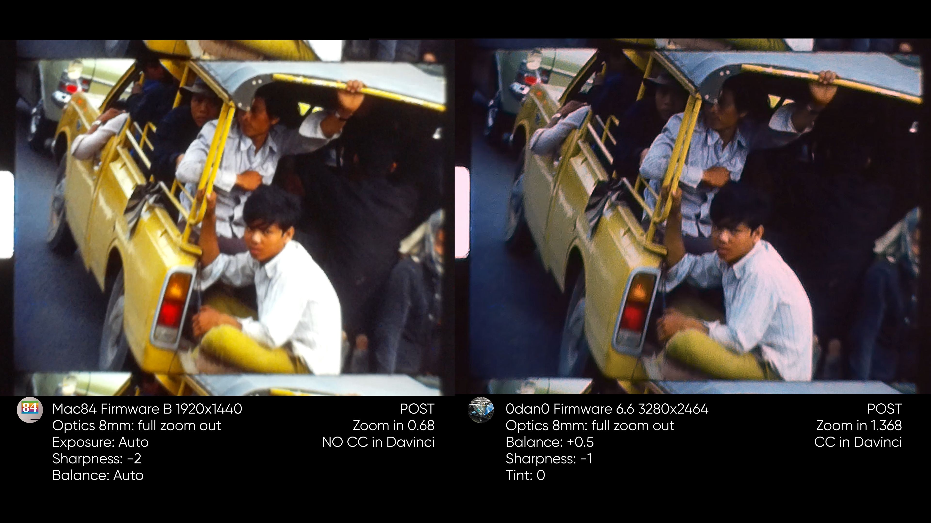

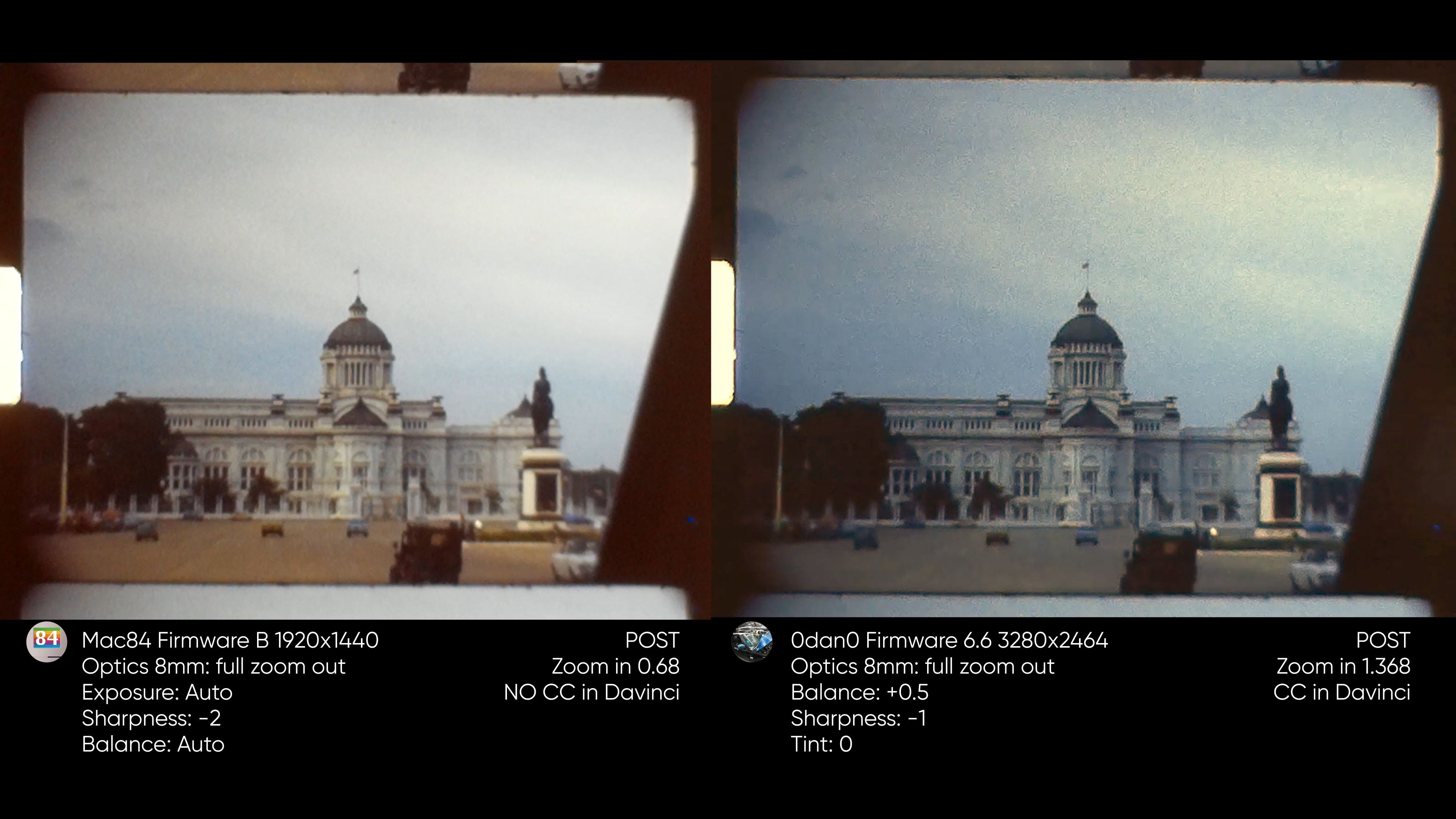

Umba67
Dec 4, 2024
Hello!
Thank you Mac84 and 0dan0! And all the other participants of this group.

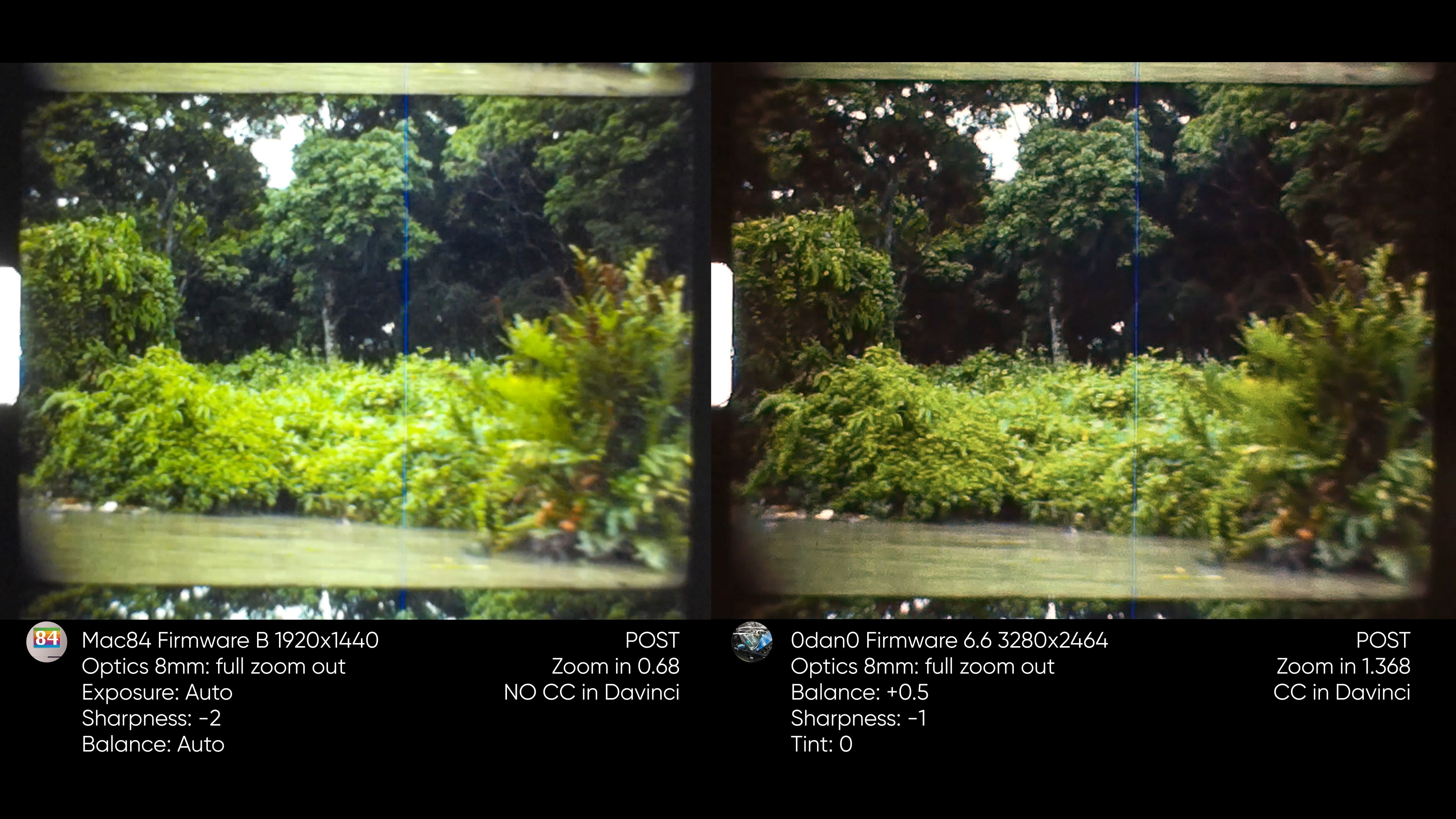

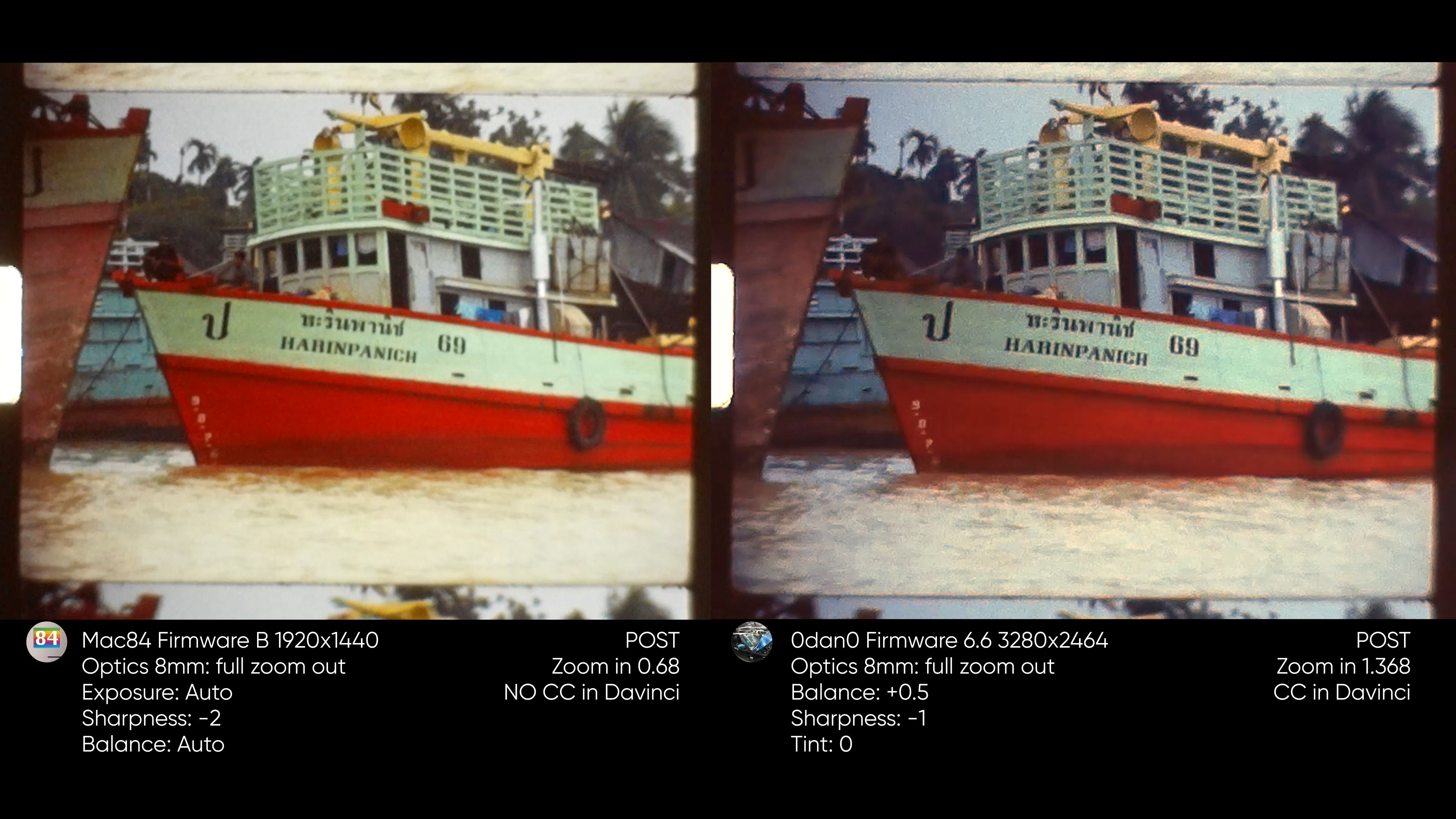

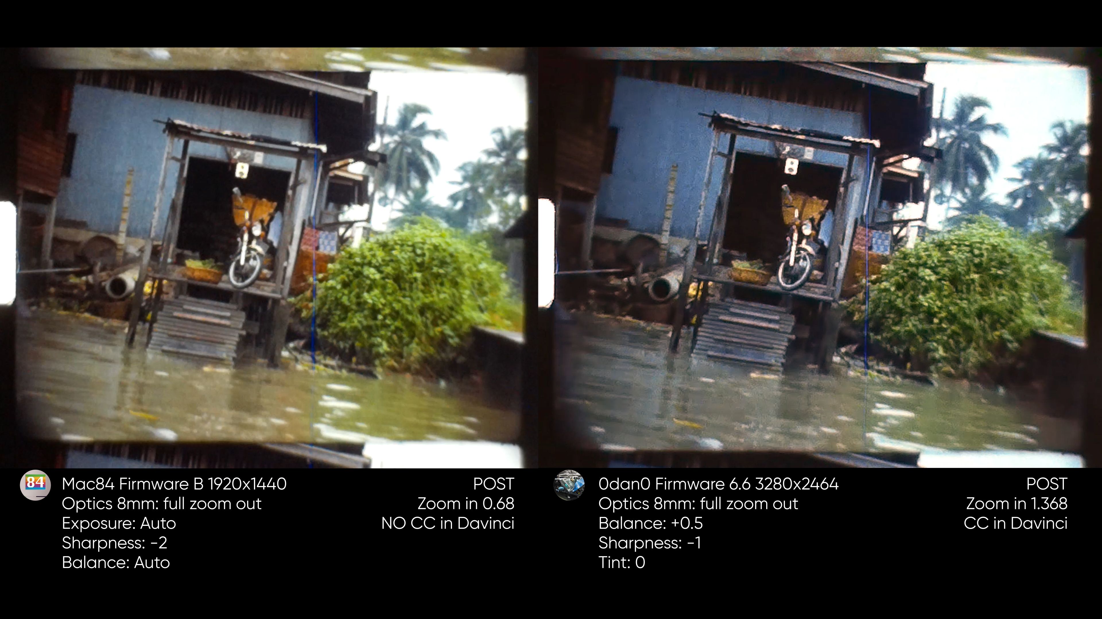

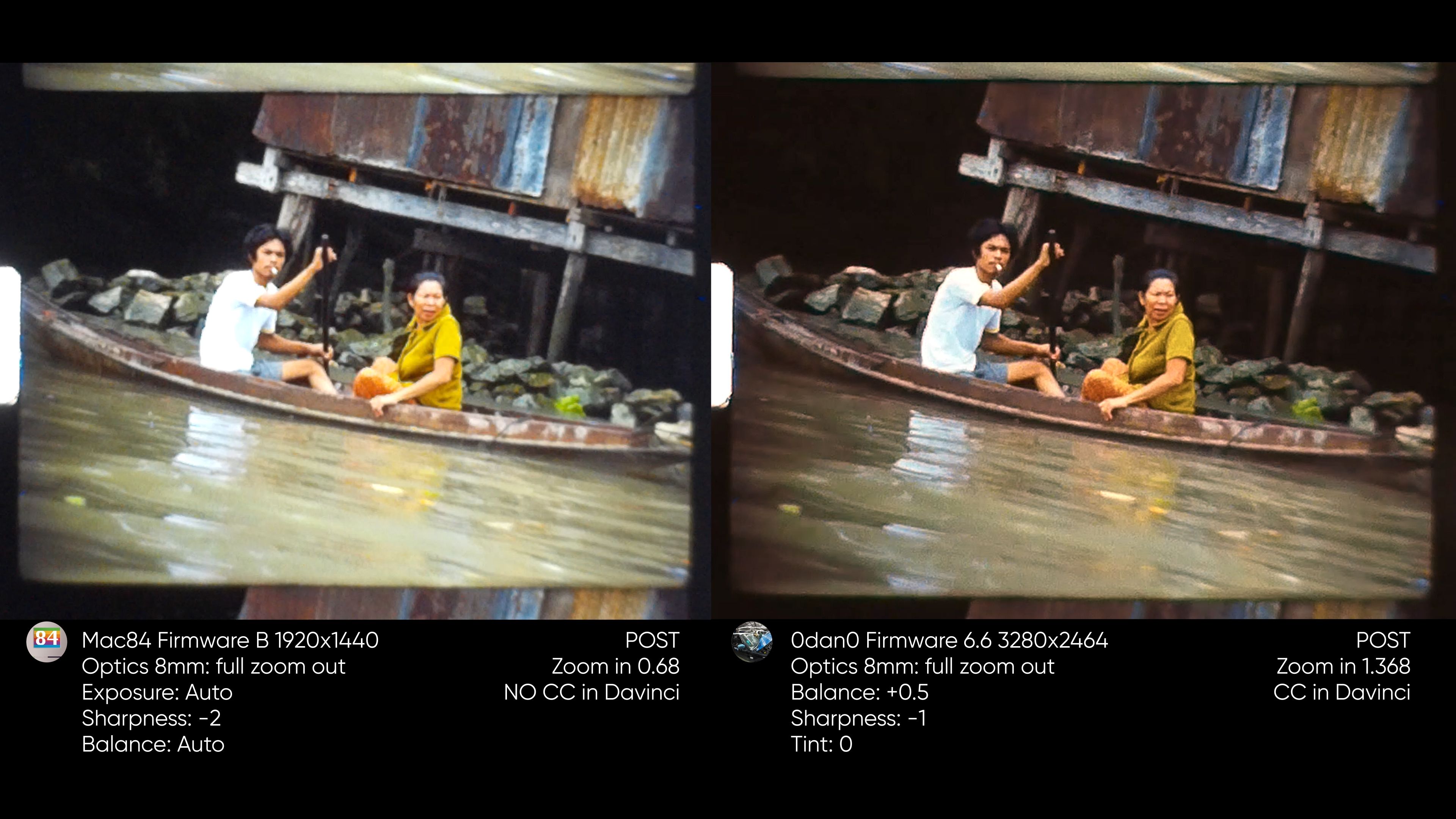

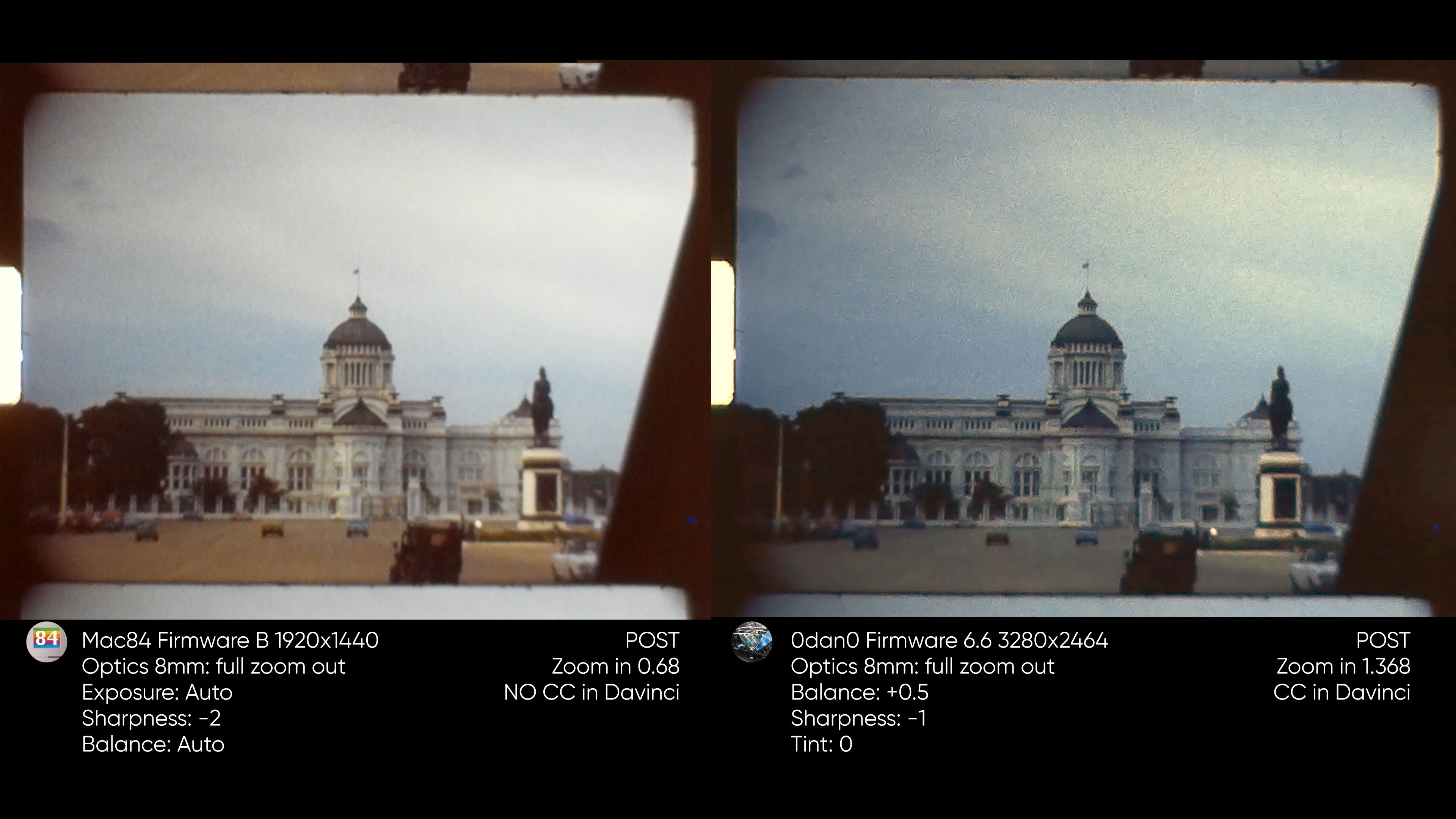

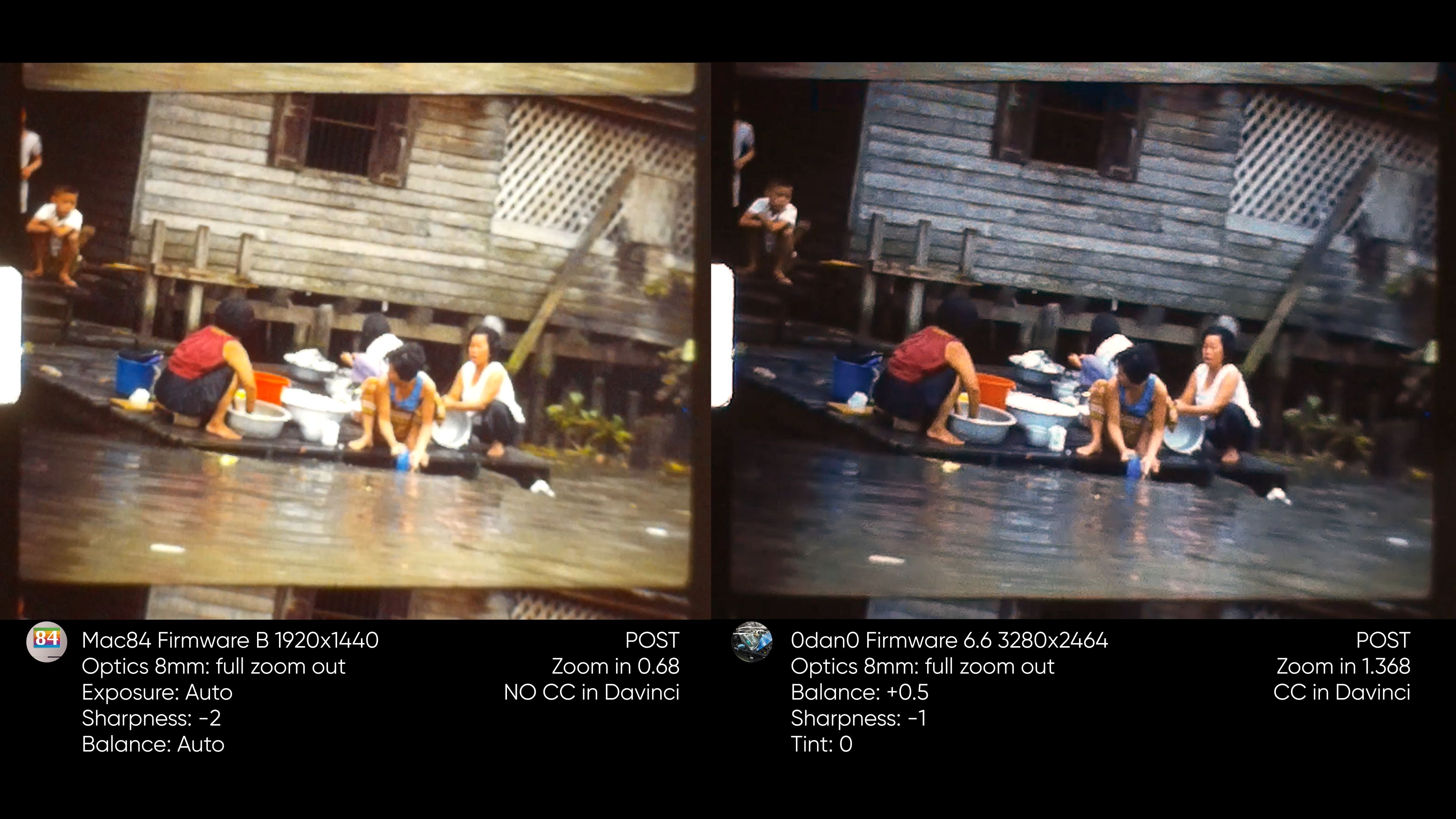

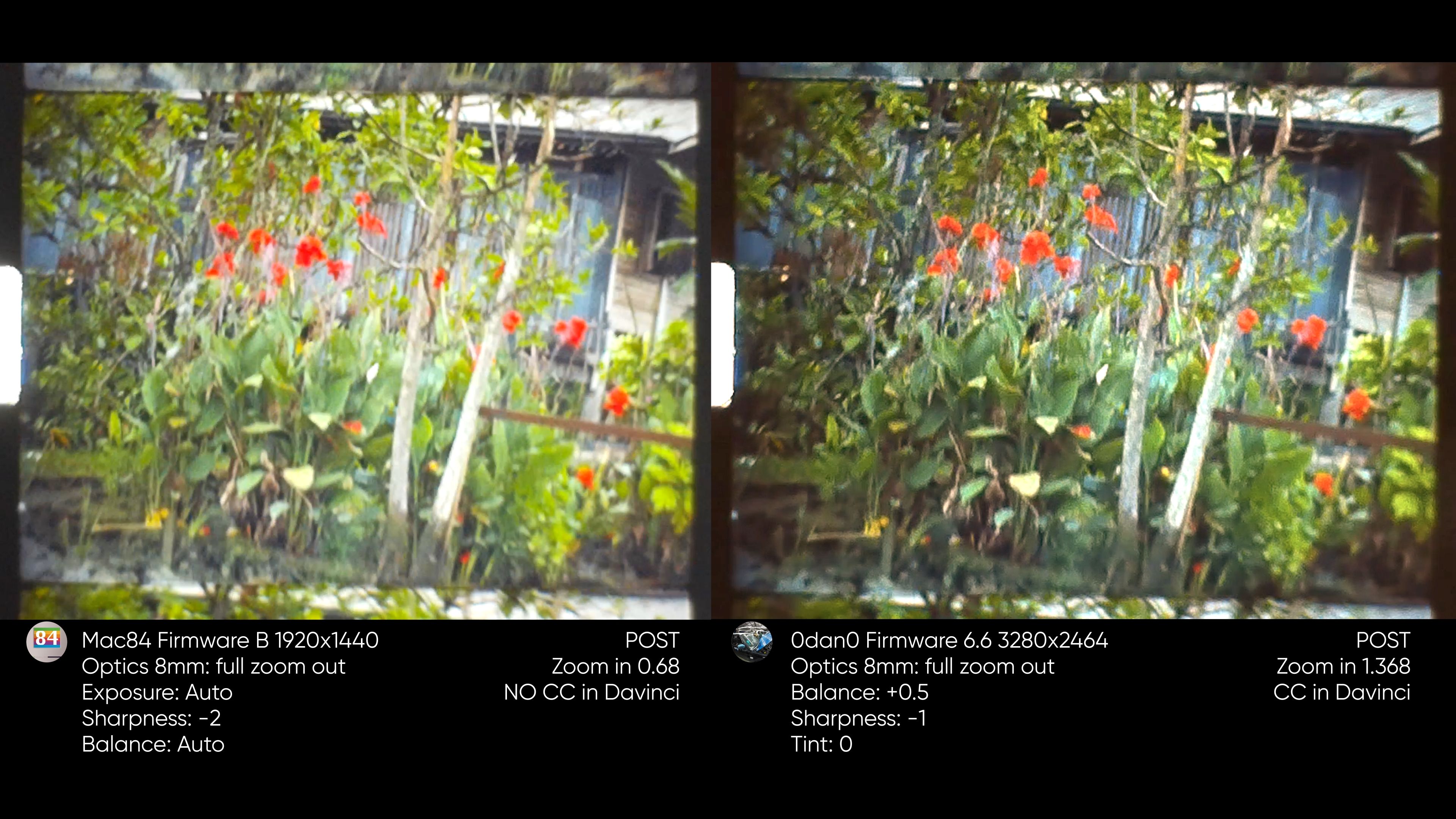

Last night I flashed the version 6.6 B released by 0dan0, and I run a comparison test with my previous scanned Super 8 (that dated back to dec 2024 when I first stumbled into this thread).
I'm waiting for the lens and gears to mod the scanner, you can watch the first result.
Both were scanned at full zoom out, then blown up to fit side by side into a 4k frame. The ver 6.6 is blown up more because of the small portion of interest of the frame.
@0dan0 I did three different scans, before I choose the one you see, with Bal +0.5 and Sharpness -1. I need to practice more ... I didn't get how to use the controls.
The color correction was done on a hurry (I started yesterday night :) ) some plates are inconsistent with the others, but some are quite good! (in my humble opinion). Not a n easy one with many blurred scenes.
From a passionate hobbyist Thank you again!
Deano
Jul 24, 2025
10
19
Hello!
View attachment 22593View attachment 22594View attachment 22595View attachment 22596View attachment 22597View attachment 22598View attachment 22599View attachment 22600View attachment 22601View attachment 22602View attachment 22603View attachment 22604View attachment 22605View attachment 22606View attachment 22607View attachment 22608
Your side by sides are amazing to see! How were you able to get 3280x2464 output with the 0dan0 Firmware 6.6? All I'm able to achieve is 1600 x 1200.
Umba67
Dec 4, 2024

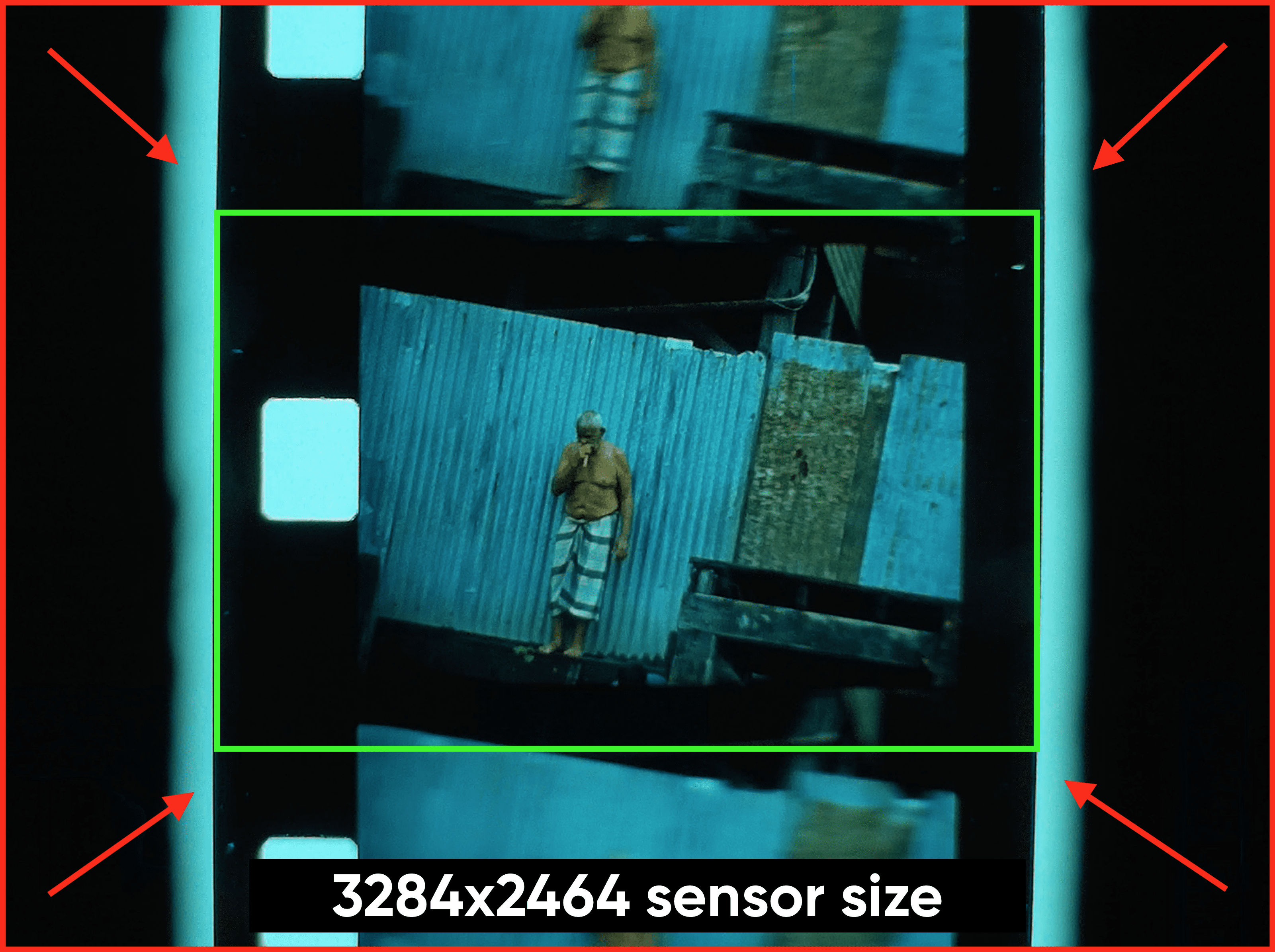

Hello Deano, you are right.

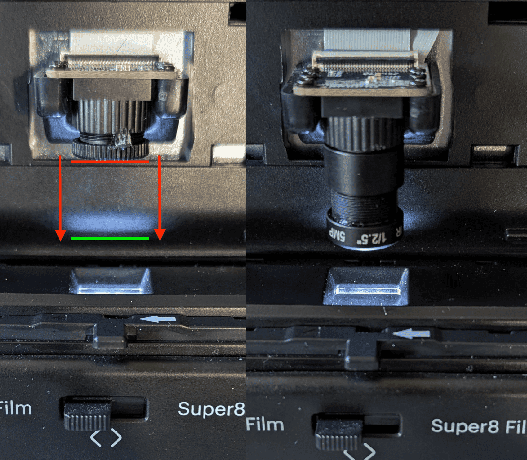

I didn't explain myself well, sorry. I meant that after flashing the firmware, the sensor with mac84 captures 1920x1440 pixels, while with 0dan0 it captures an area of 3840x2464. Then Mac84 outputs a file with a resolution of 1920x1440, while 0dan0 1600x1200.
Original Mac84 capture, Kodak Reels zoom set to full out (no digital zoom) lens 8mm:
Original 0dan0 capture, Kodak Reels zoom set to full out (no digital zoom) lens 8mm:
I used some black tape to mask the "white" area of the sensor to increase contrast (cit. 0dan0).

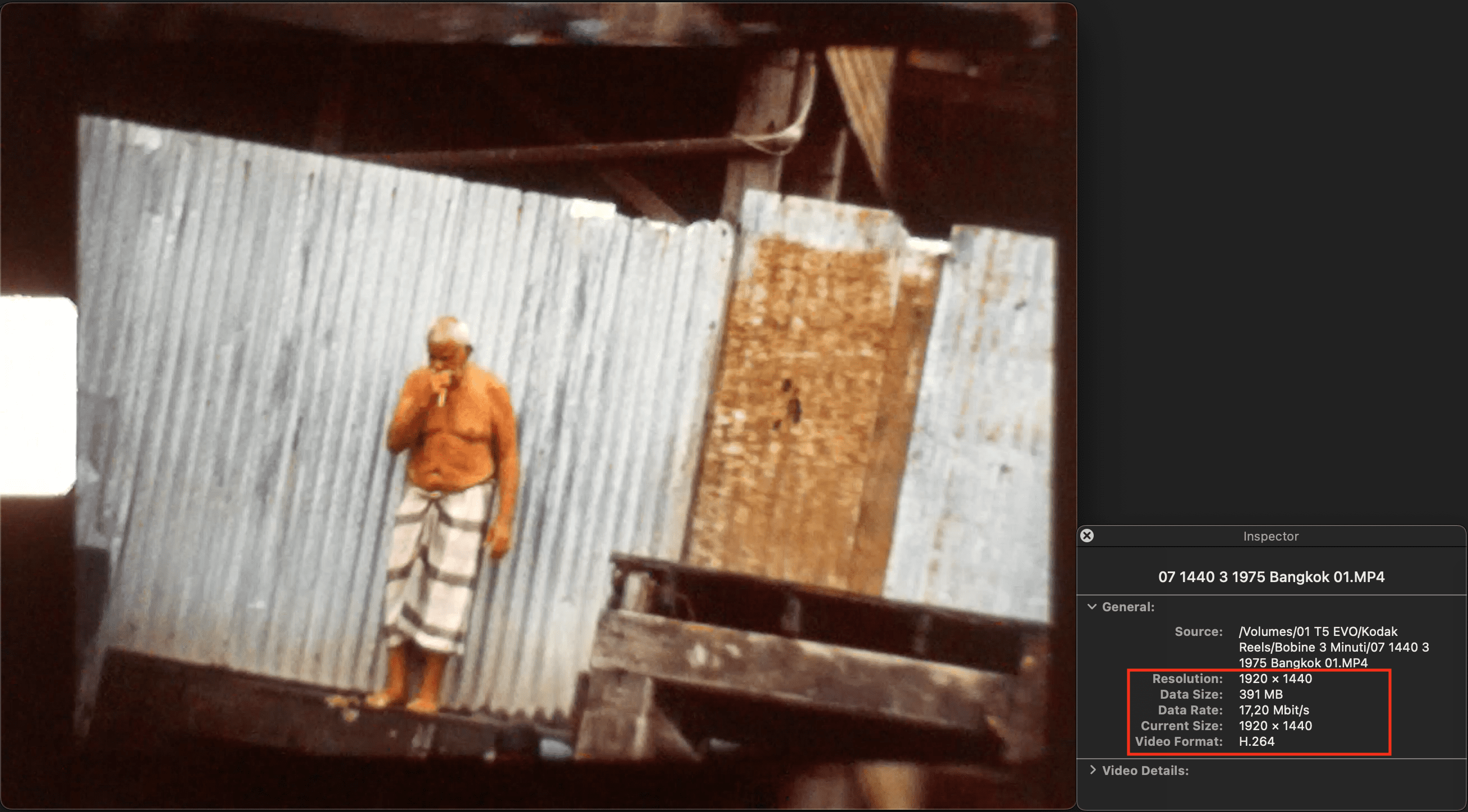

If I compare the native dimension in Davinci this is the outcome on a 4K plate:
So Deano you are right!

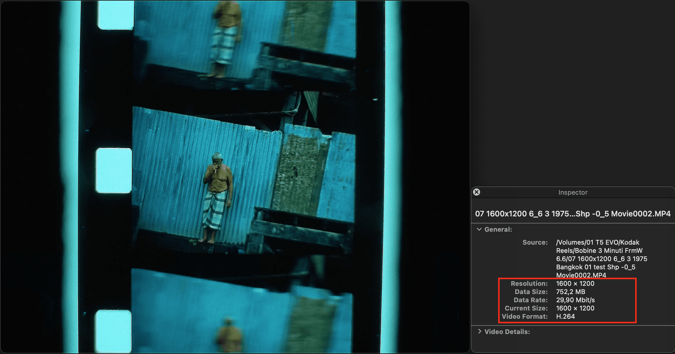

0dan0 file has less resolution and it is smaller than Mac84. It is a 3280x2464 downsized to 1600x1200 with a bit rate of 30-35 Mbit/s that doubles the Mac84 17,5 Mbit/s.
I need to get closer to the film in order to fill the 3280x2464 unlocked sensor with only the frame of interest, discarding the rest of the frame.
The 4K clips by 0dan0 on YouTube show that if you upscale a 1600x1200 clip to 4K, the result looks very good (to me).

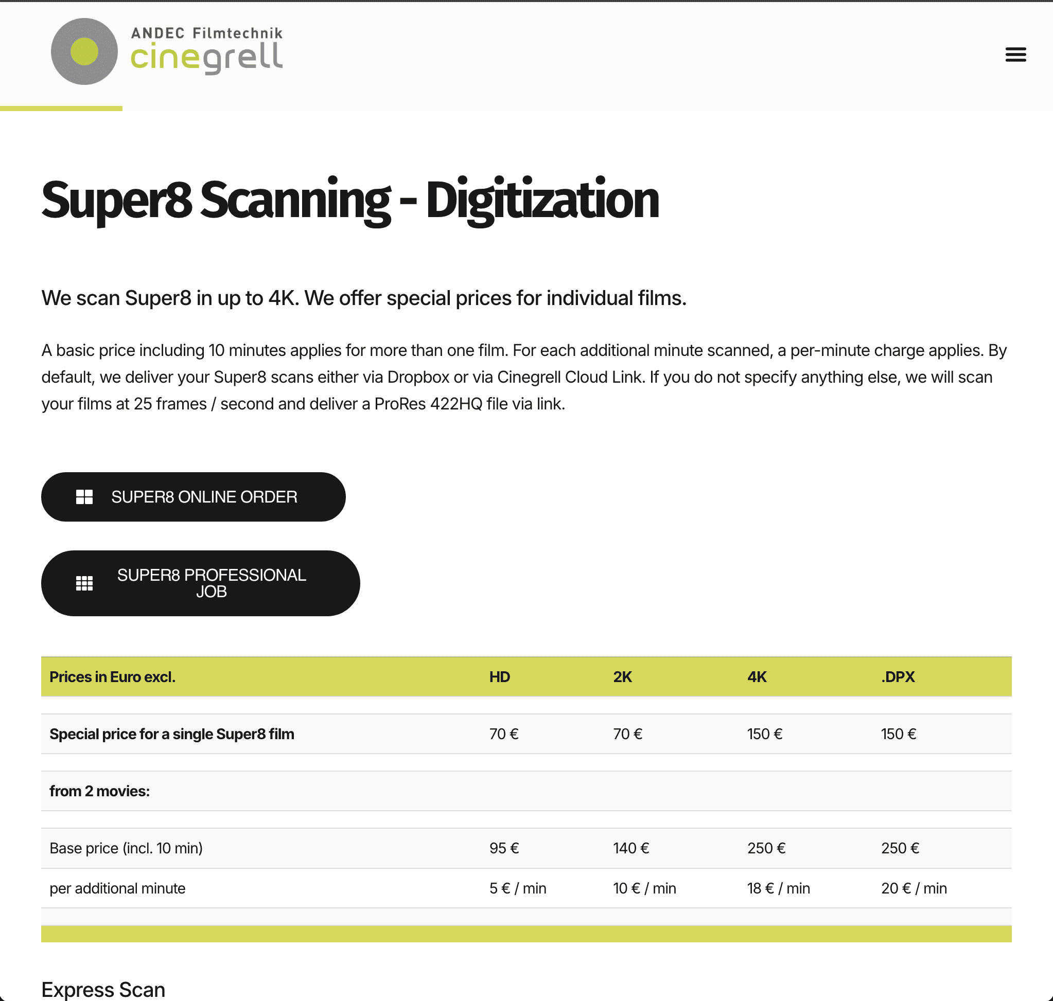

I have 29 3min rolls and 24 30min rolls of Super 8 shot by my father, I was already satisfied with the outcome I got with Mac84.
If I want them scanned from a professional lab (ONE 3min roll in 4 K= 70-100€) I'll face an expense that is al lot more than the investment for the Kodak Reels + Lens ecc + my time.

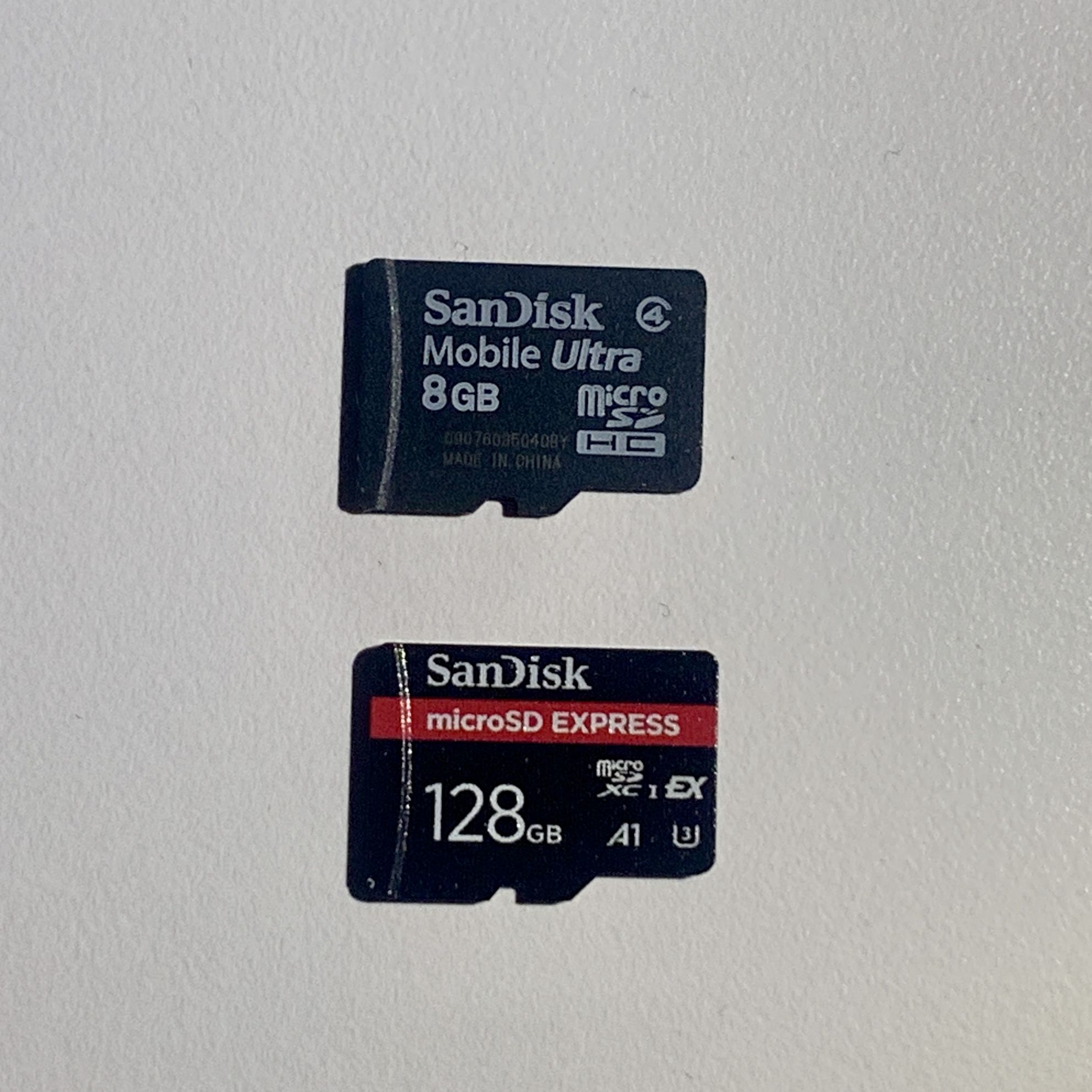

Umba67
Dec 4, 2024
I have some feedback:

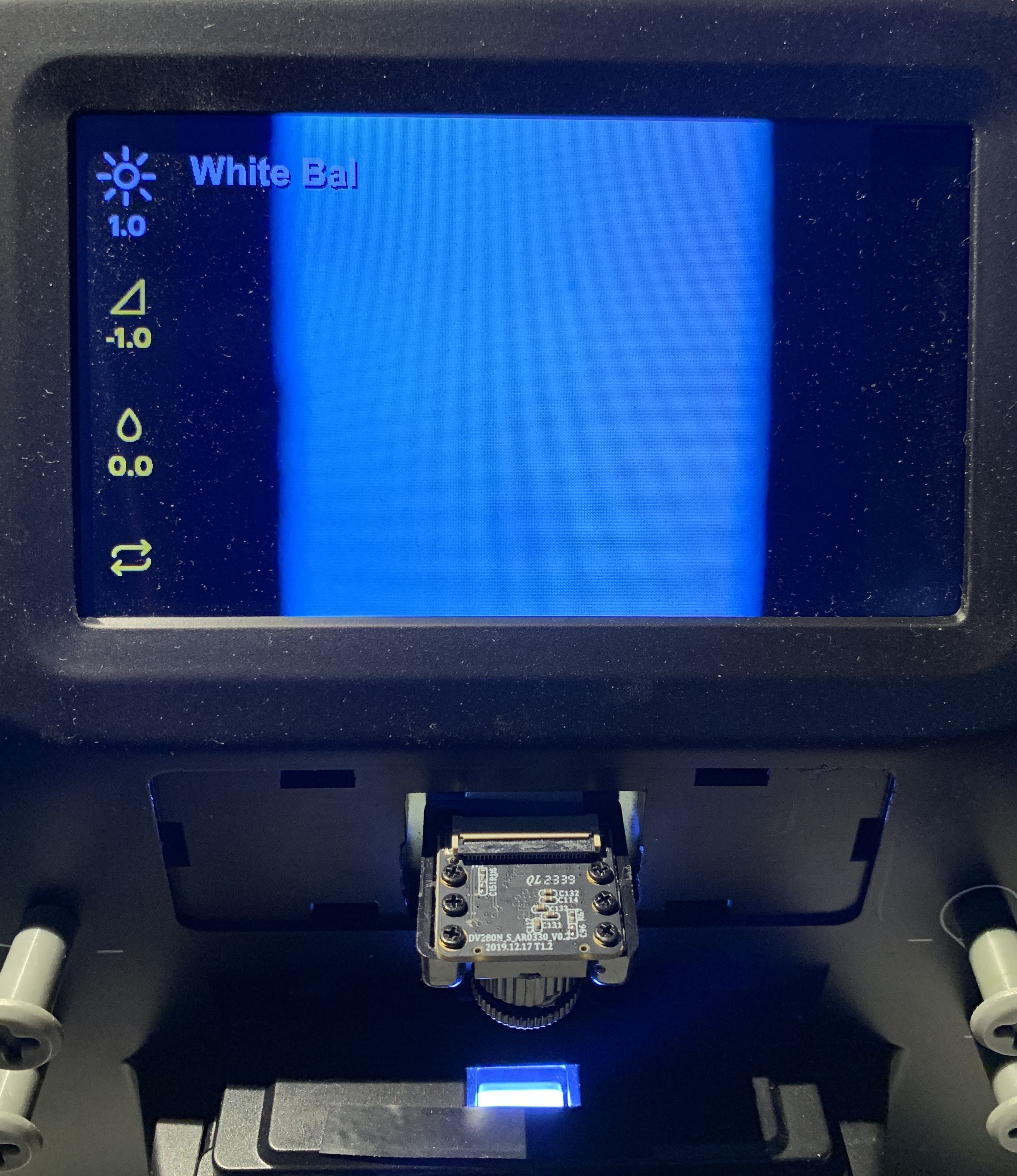

1. to install the 0dan0 6.6 firmware I have to use an 8gb memory card formatted FAT32. The 128 Gb card won't be read
2. to save a clip to the card I need to use the 8Gb card, the 128 Gb (FAT32 or ExFat formatted) is not supported.
With Mac84 there is no issue using the 128 Gb card.

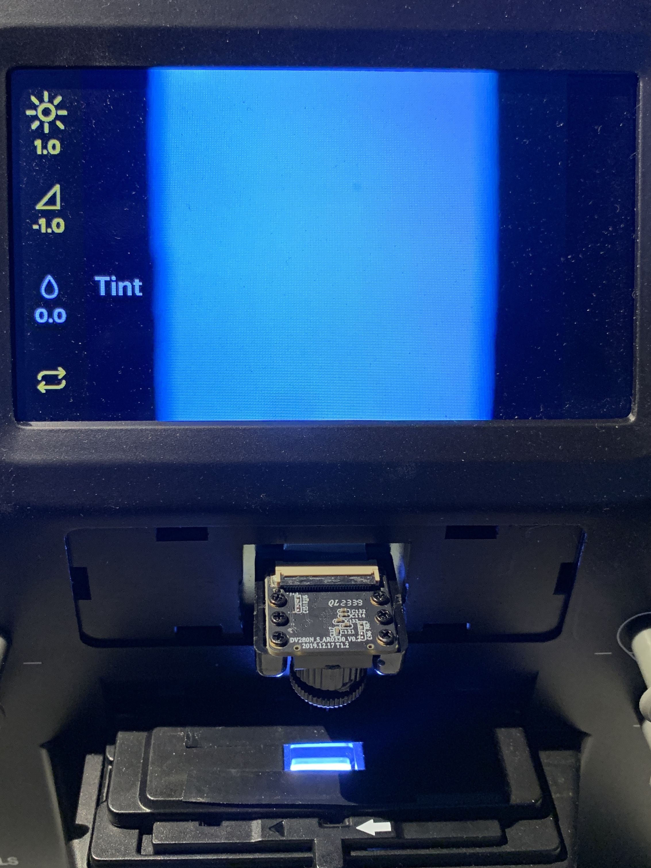

3. How to balance color with 0dan0 6.6? I set a +0.5 or 1.0 that has a bluish tint. The TINT command is now controlling Saturation?
Thank you

This is not how resolution works. The sensor has maximum of resolution of 2304x1296 (Datasheet - https://files.niemo.de/aptina_pdfs/AR0330_Data_Sheet.pdf ) the encoder has a maximum resolution of 1920x1440. But the stock firmware (even bit-rate enhanced) only let you view the middle ~600x400 pixels, then scales that up to 1920x1440, or 1728x1276, etc. (not resolution, just blurry pixels.) All the processing is done at 600x400, this is why you don't really see film grain. In my hacks, I took away the processing restriction, and allow you to read and use more of the sensor. It is still a tiny, low res sensor, but I do have it natively running at 1600x1200 stability. The problem is that the lens is wrong, the area of 8mm frame, only shines on the middle 600x400 pixels on the sensor, no matter what firmware. It is a hardware issue. You have to replace the lens to get more resolution, as shown in my demo here:
