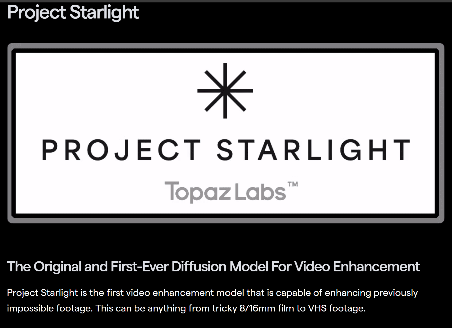

Hi. Are you using Topaz video AI ? Starlight model ?

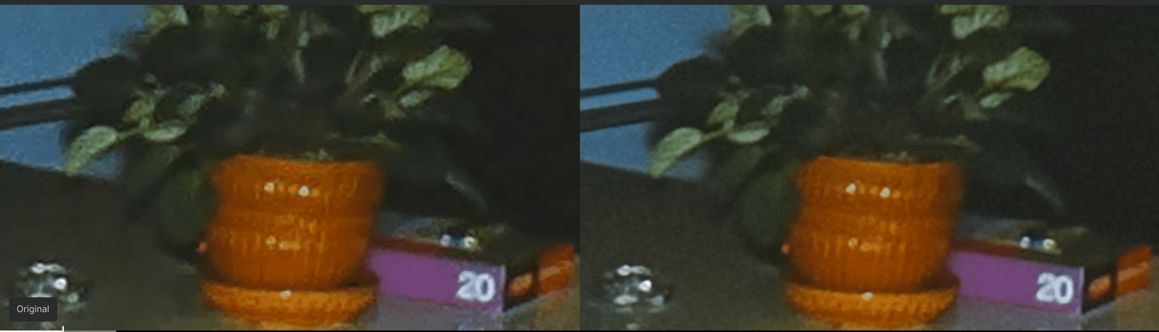

This is an example of reduced compression artifact and adding grain similar to original. All done with Topaz Video AI.
No. Starlight is not for starting with hi-res; it is for low res. I use a variety of filters in virtual dub, and then I utilize a few settings in topaz...
I really like the reduce compression feature of Topaz Video AI. Based on this, I finally have taken a look at it's trial version. I have and like Neat Video NR, but I may splurge on TVAI to help reduce compression artifacting. Even with 0Dan0's work in improving and optimizing the bitrate via firmware, there are still post-processing improvements that I am interested in.

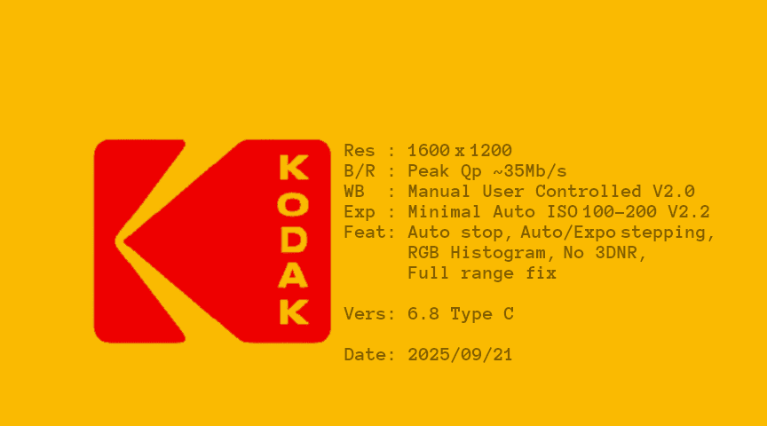

v6.8 - New firmware hacks for all Kodak Reels versions (A, B & C -- attached)
We now have white balance control for Kelvin and Tint, so full manual. We also have a RGB Histogram to help with you white balancing. The white balance control in pictures settings will only change the red to blue balance (Kelvin) with 9 discrete settings. Out side of the picture settings, even during capture, you can change the tint (green) by a longer press in Left or Right buttons (decrease or increase the green.) The green tint will be remember, even beyond a firmware update.
So many other small changes. I'm no longer seeing jitter on my hardware, but I have some code in there to help, just in case. It seems I skipped v6.7 (or never released it.)
Several of the extensions are now in C code, so let me know if you want to see that.
