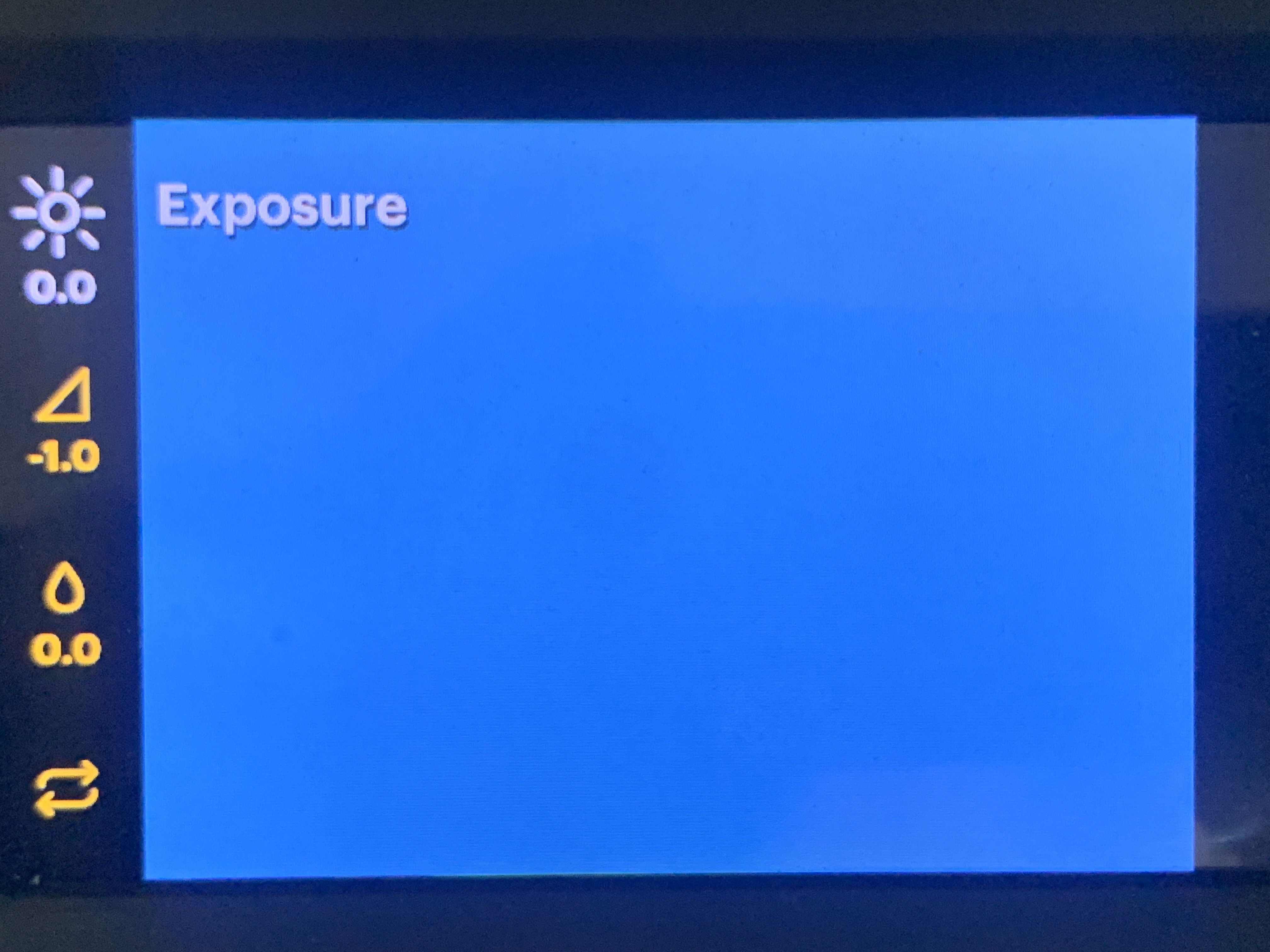

Thanks for the answer, I have to use version C. And I have a problem with the white balance on this one. It goes a lot towards the blue shade.

White balance is now adjustable in the 6.6 version. Just go to the where you adjust sharpness and there is a white balance control now.

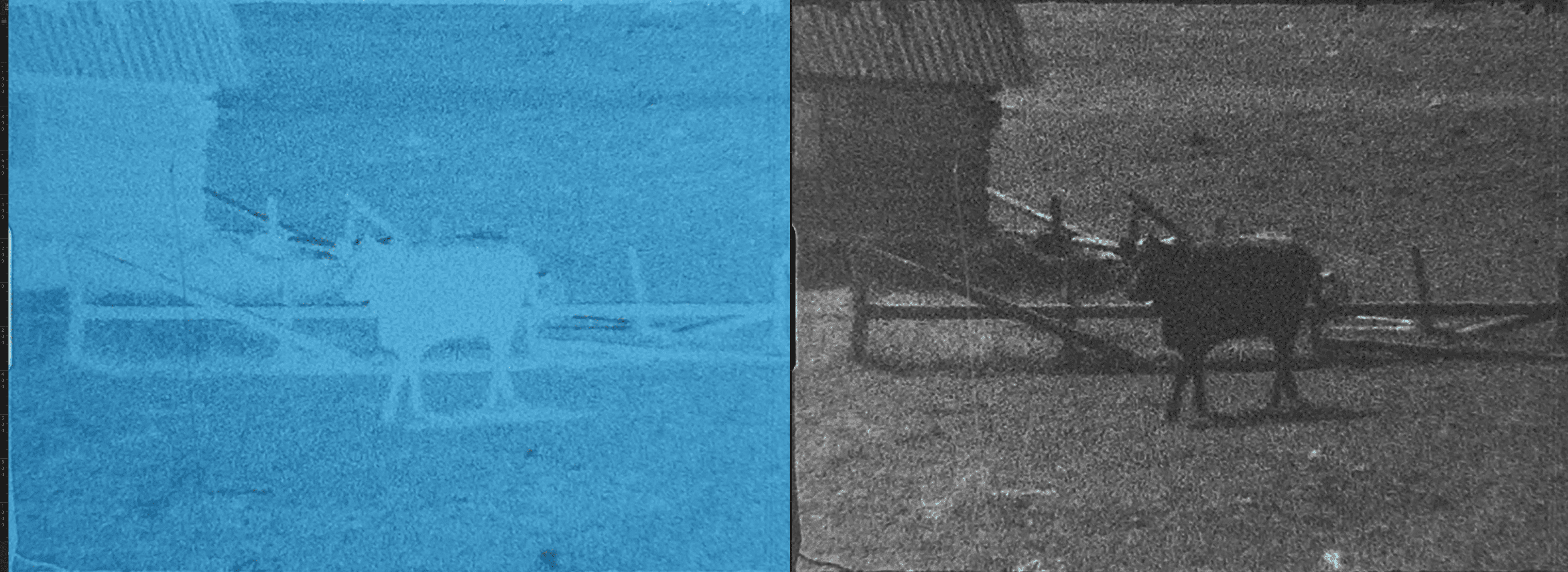

New update.

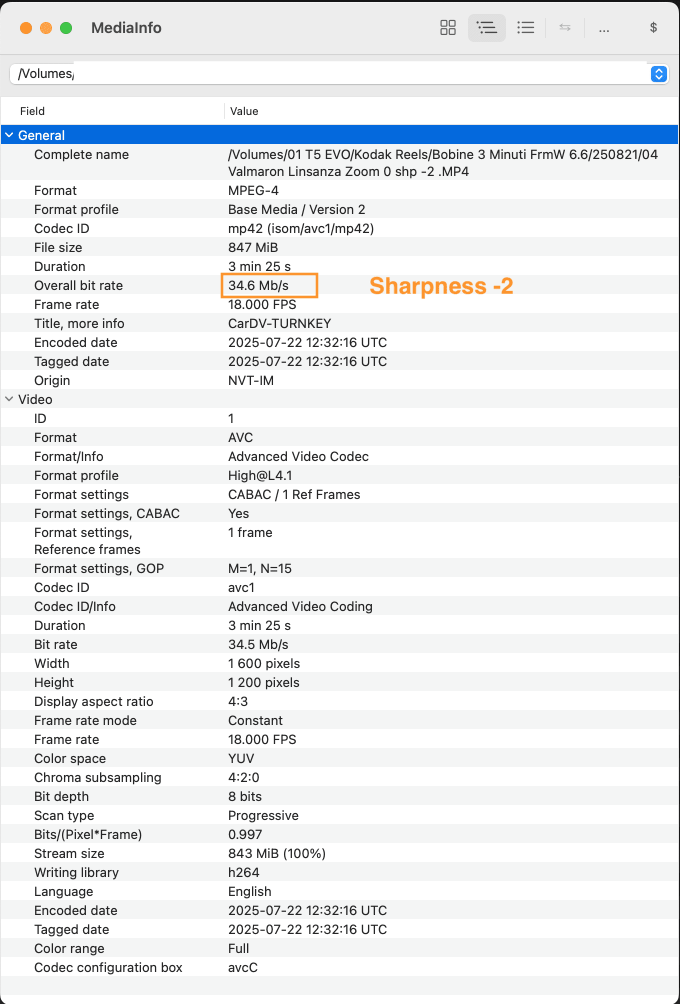

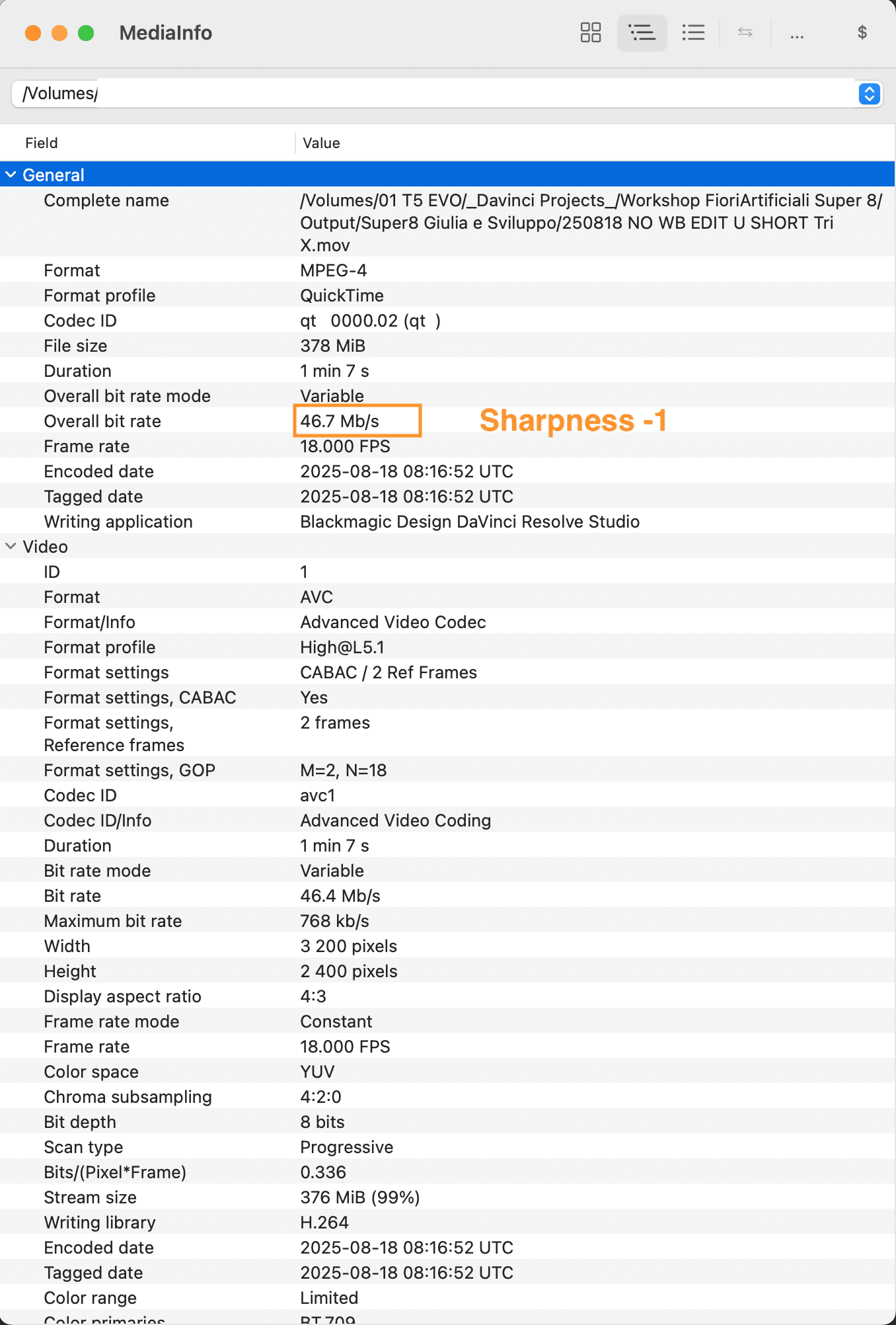

The Tri X film is a nasty one with a lot of visible grain and the development in Caffenol accentuate it.
My attention was captured by the high bitrate that the previous clip had eq. 46.7 Mbit/s, well above the 35 Mbit/s 0dan0 set.
So i tried to to reduce sharpness more, at -1.5 and -2. At -2 I hit the sweet spot of 34.6, loosing in definition but removing the jitter effect quite completely.
The clip now is usable, a little muddier but usable. Maybe there will be some software improvements in the future.
I also removed the ghost images converting the clips to monocromatic in Davinci Resolve.

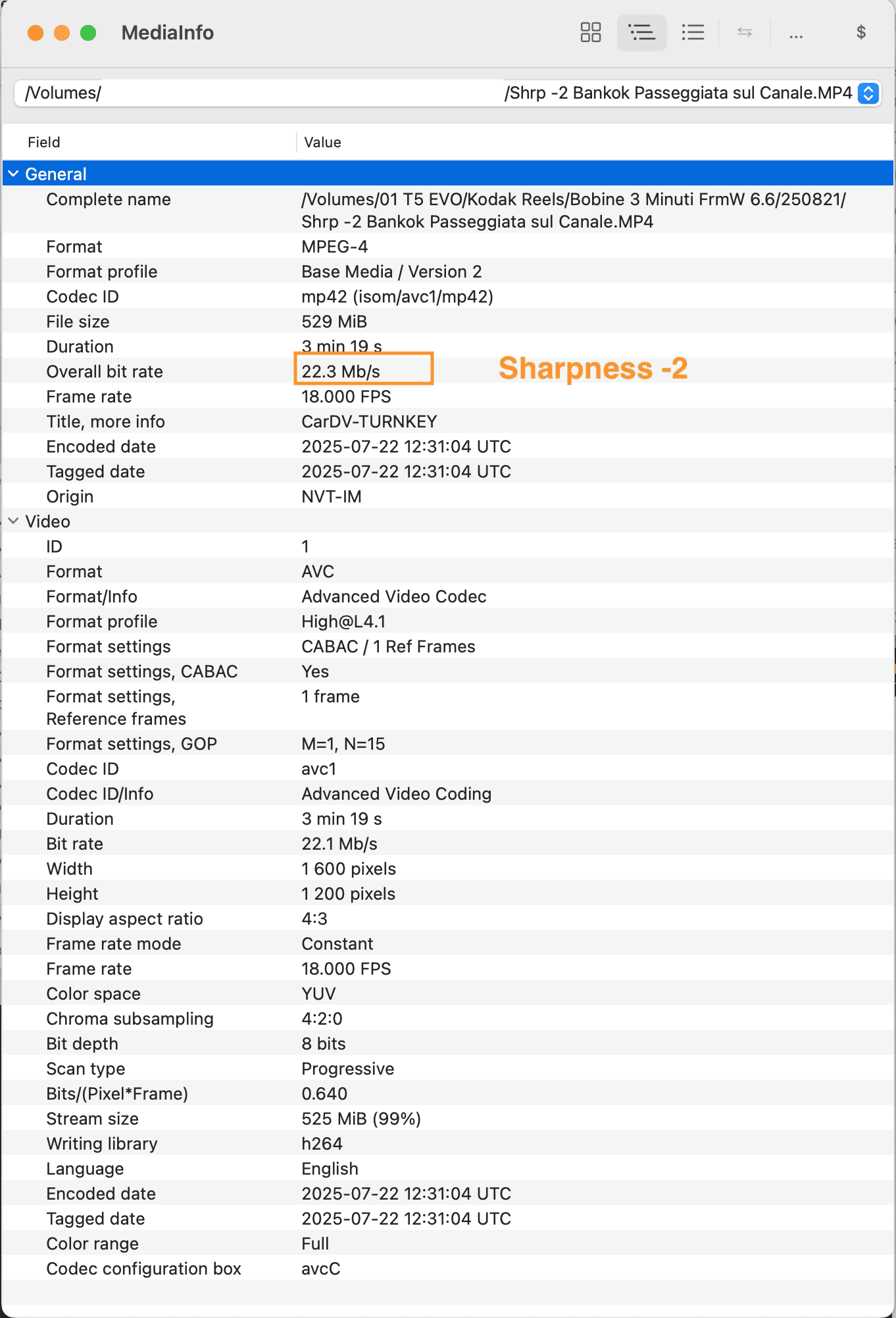

I digitized again a color film, (an Ektachrome 40 developed in 1975), with a bit ate of 22.3 Mb/s, sharpness -2. The image suffers from jittering in the upper part of the frame and is also visible the ghosting.

Under the picture setting "Exposure" is replaced with "White Bal", for a manual, but fixed, white balance control. You should not need to reflash FW to change the white balance any more.
White Bal. values to their RGB gains
White balanceRed gainGreen GainBlue Gain
2.01.751.251.0
1.51.51.1251.0
1.01.3751.01.125
0.51.251.01.25
0.01.01.01.0
-0.51.01.06251.125
-1.01.01.1251.25
-1.51.01.18751.5
-2.01.01.251.75

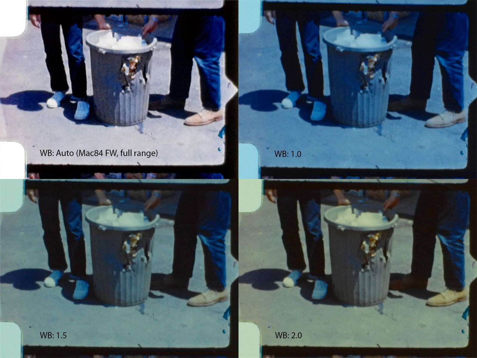

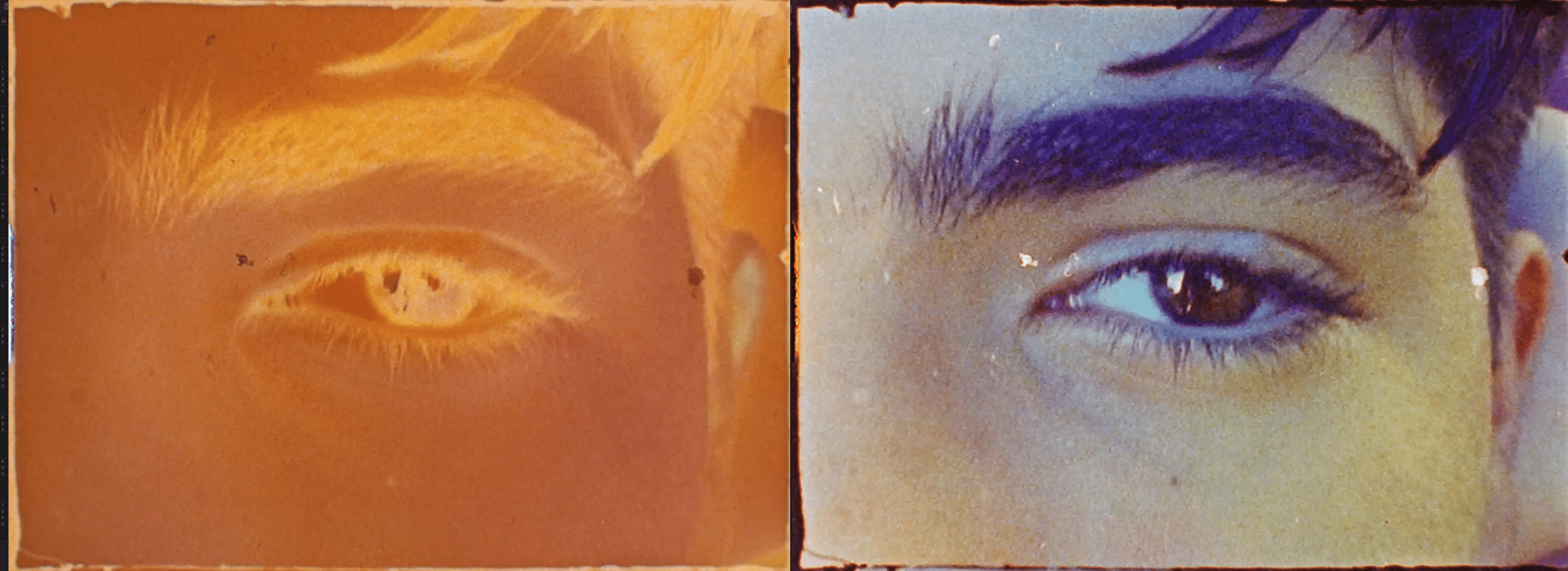

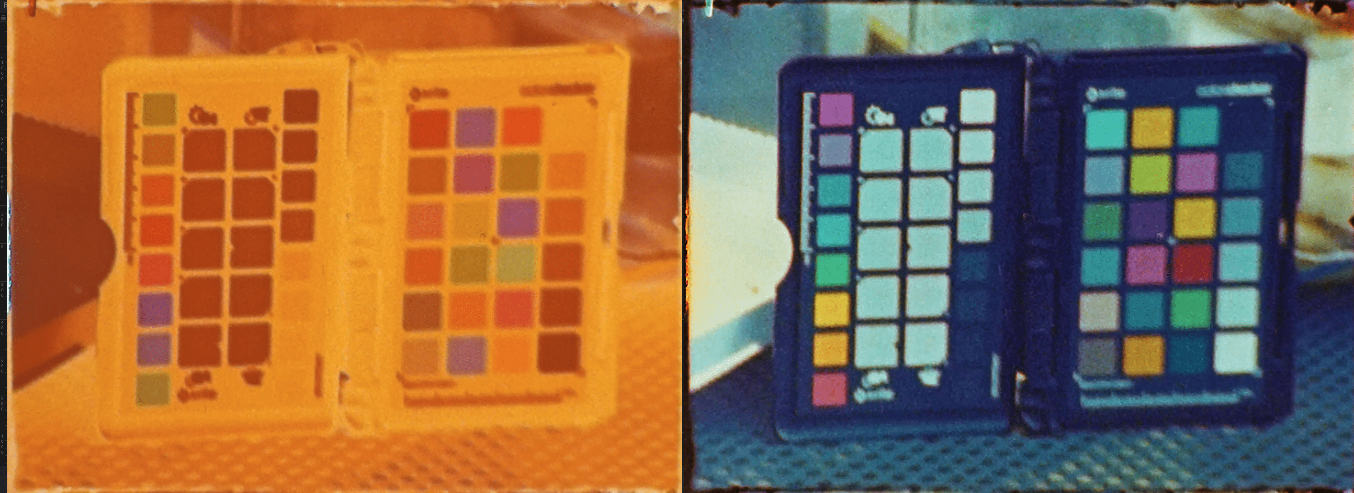

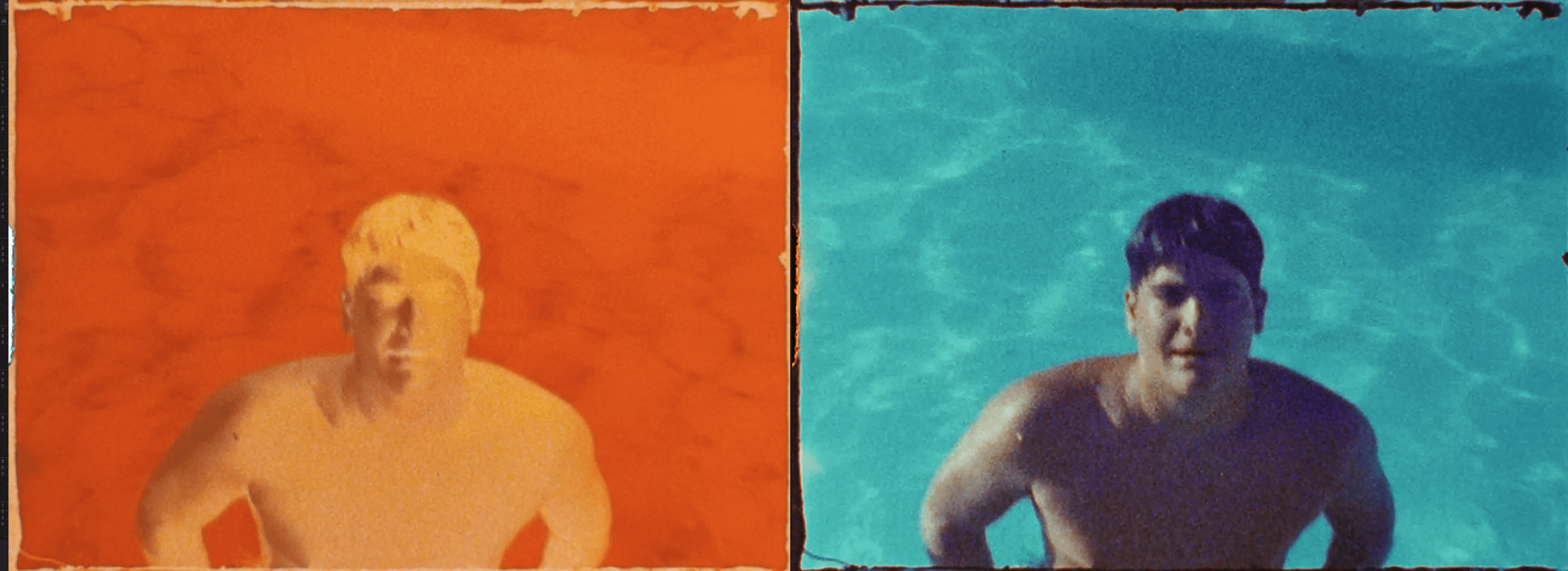

I'm finally starting some test scans utilizing the v6.6 Manual User Controlled White Balance setting to determine the best setting for my old films (8mm from 1950s & 1960s. I have a couple of observations that relate to @omega's statement above about +2 not being enough:
With 3 brief tests (WB: 1.0, 1.5, 2.0) this footage requires varying amounts of post color corrections. For the purposes of evaluation, the color correction was applied using an Auto-Color feature in Adobe Camera Raw that adjusts Temperature and Tint, and provided the following read-outs:
WB 1.0 required increasing the Blue/Orange Temperature slider to +50 (out of -100 to +100)
WB 1.5 required increasing the Blue/Orange Temperature slider to +29 (out of -100 to +100)
WB 2.0 required increasing the Blue/Orange Temperature slider to +12 (out of -100 to +100)
All 3 (WB 1.0, 1.5, and 2.0) required increasing the (Green/Magenta Tint slider to +25 (out of -100 to +100)
For visual comparison, here are the 3 test scans (with no post color adjustments), and I also included a previous scan using Mac84's firmware (with the stock firmware's Auto White Balance).
I know almost nothing about color science, except that it's not straightforward. And I imagine that old and faded (and amatuer!) film will have a wide range of color issues. That being said @0dan0 I'm wondering if your RGB gains could use further adjustments. 2 specific suggestions based on my very unsofisticated test:
  1. Proportionally increased Red gains
  2. Decreased Green gains
These would apply to at least the WB 1.0, 1.5, 2.0 options I tested. Unsure what might be helpful for WB below those.

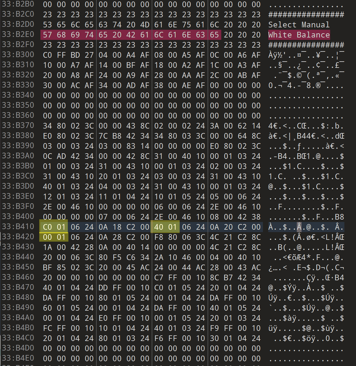

I never encountered film that blue, and I was guessing what WB values might be useful. I'm away from any scanners at the moment. And the table of histogram values are compiled C code, making remote debugging more tricky, but I think I found the RGB gain for WB 2.0.
0x1c0 - 1.75
0x140 - 1.25
0x100 - 1.00
As these gains results in too much green, try changing the "40 01" to "00 01". If that is too little green, try "10 01". This is hard to get perfect with a single axis WB control, would be improved if it was separate kelvin and tint controls. I could hijack the the "tint"/saturation control. I will think on that.

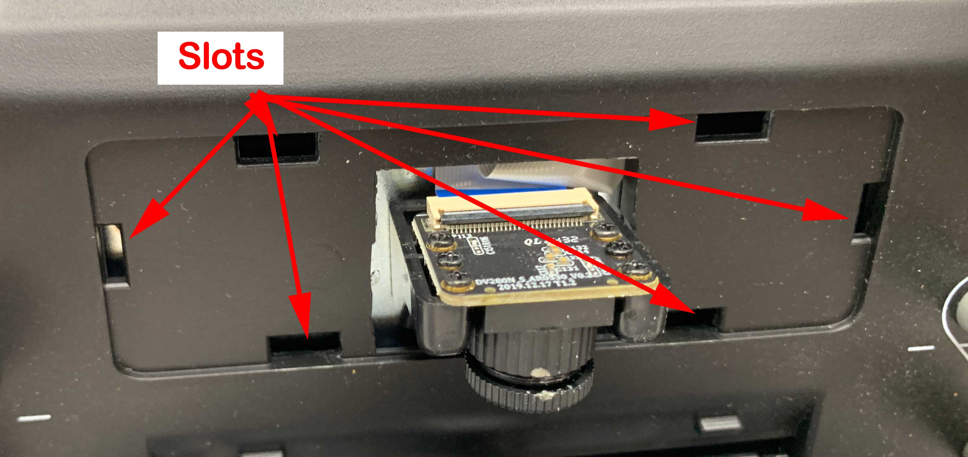

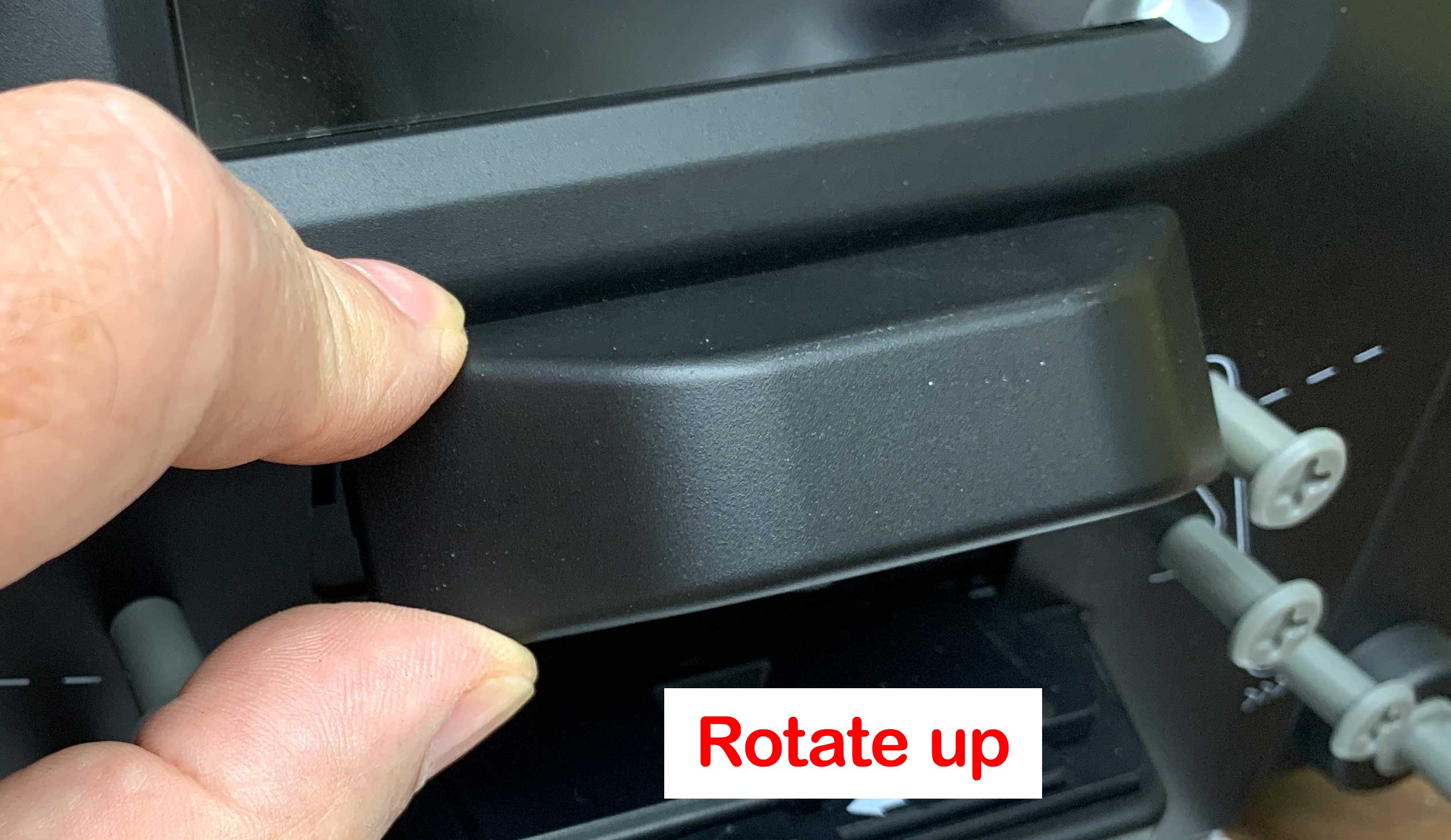

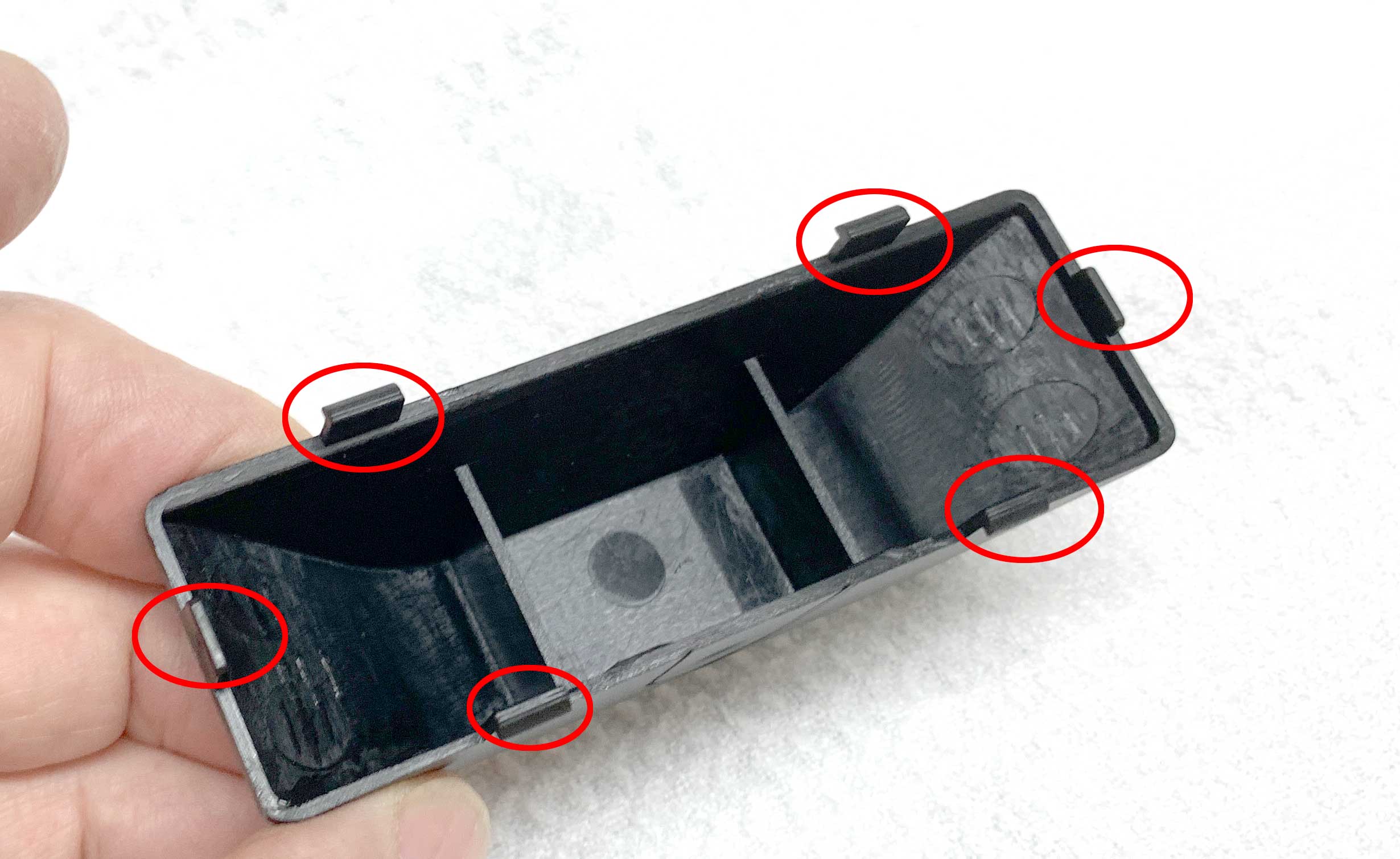

Can anyone tell me how to remove the lens cap? I thought it was snapped on, but I can't. I would like to check if the focus is OK.
The cover is held in place by 6 tabs that click into slots in the face of the scanner. To get it off from the front, push up on the bottom of the cover to bend it and release the two bottom tabs. Rotate up carefully to release the side tabs, then fully remove it from the scanner. See pictures.

Thank you very much for the pictures and instructions. I checked the sharpness. I tried turning it a little to both sides and it looks like I ended up in the same place.

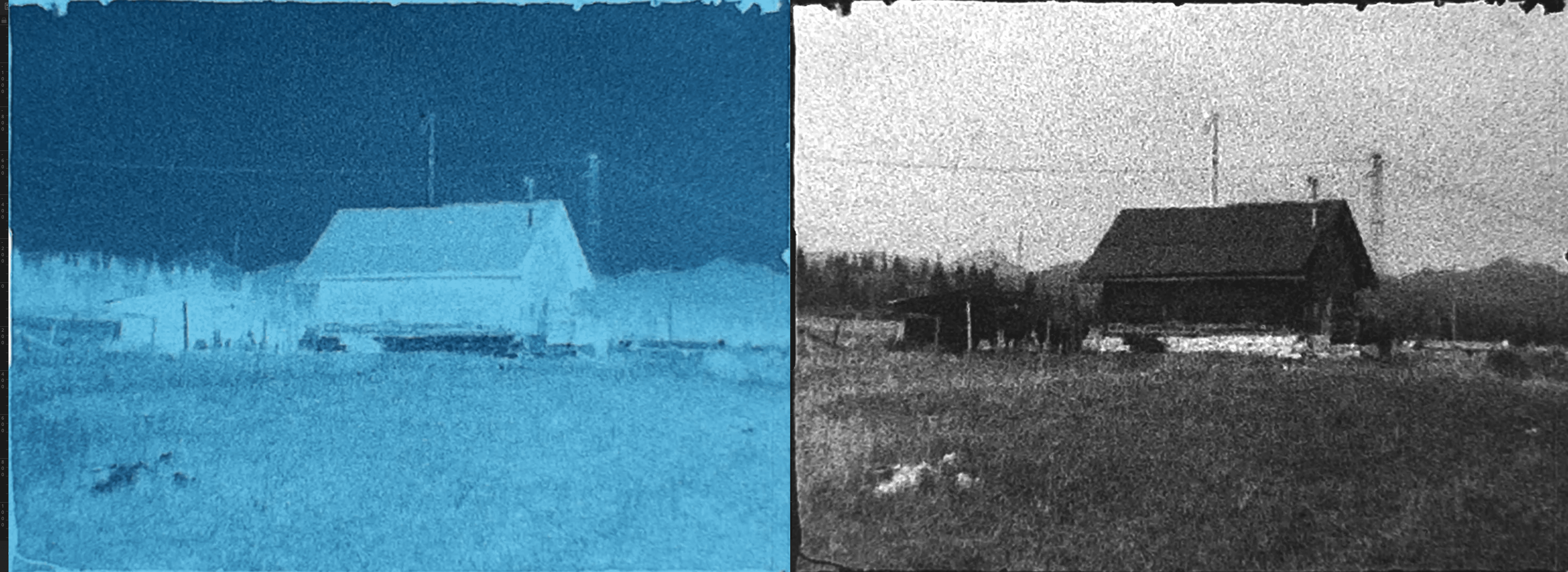

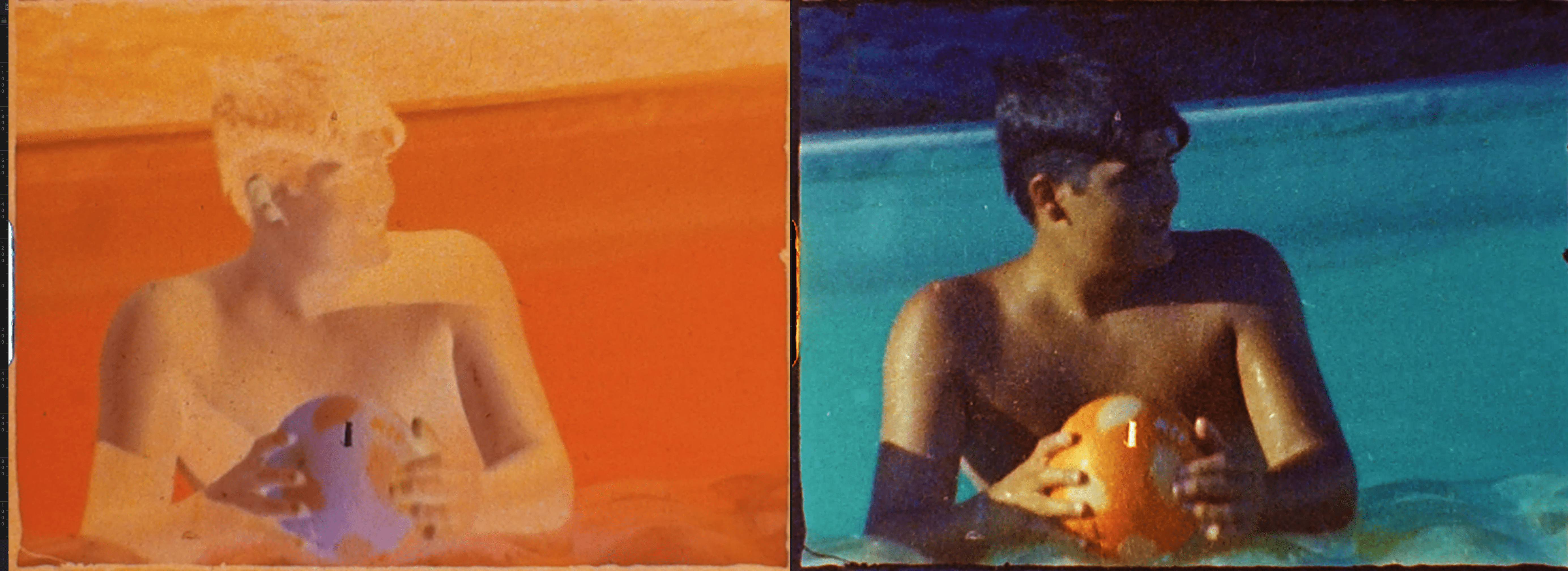

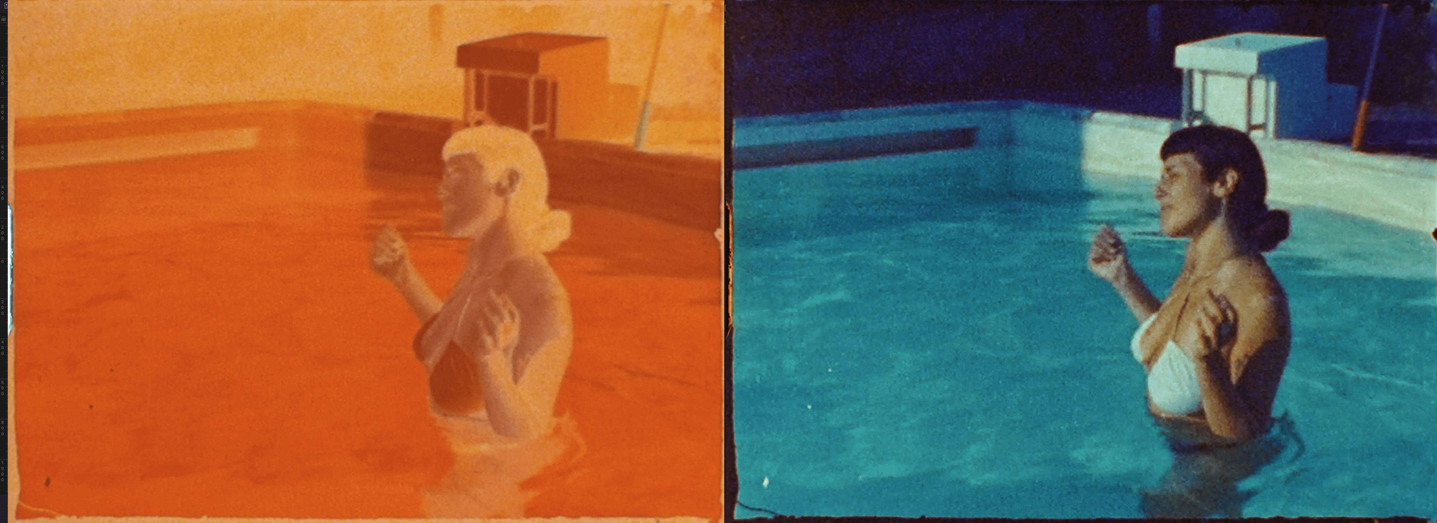

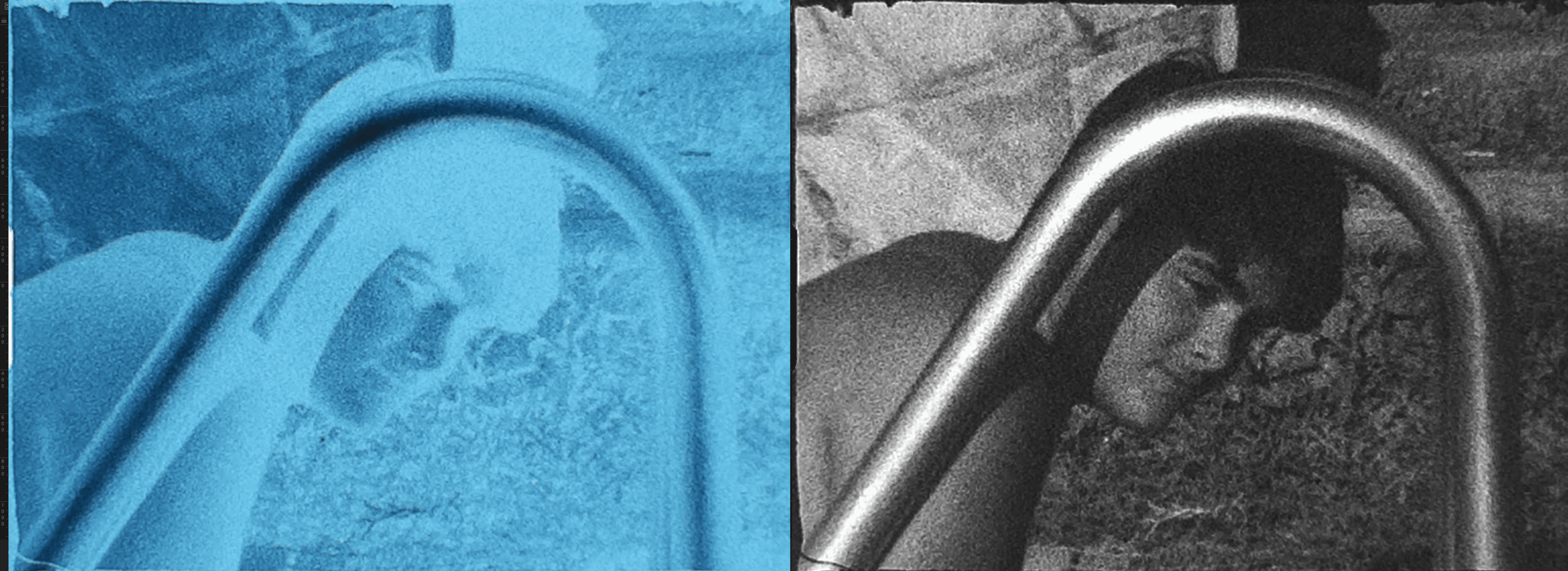

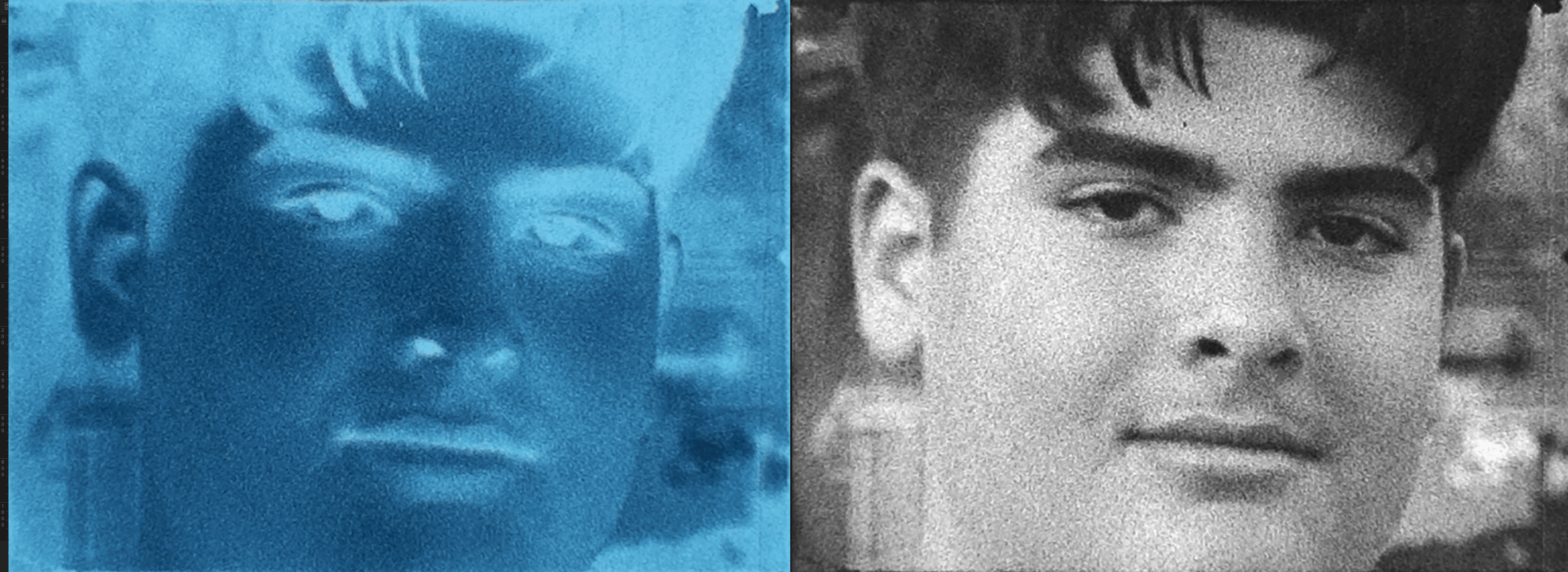

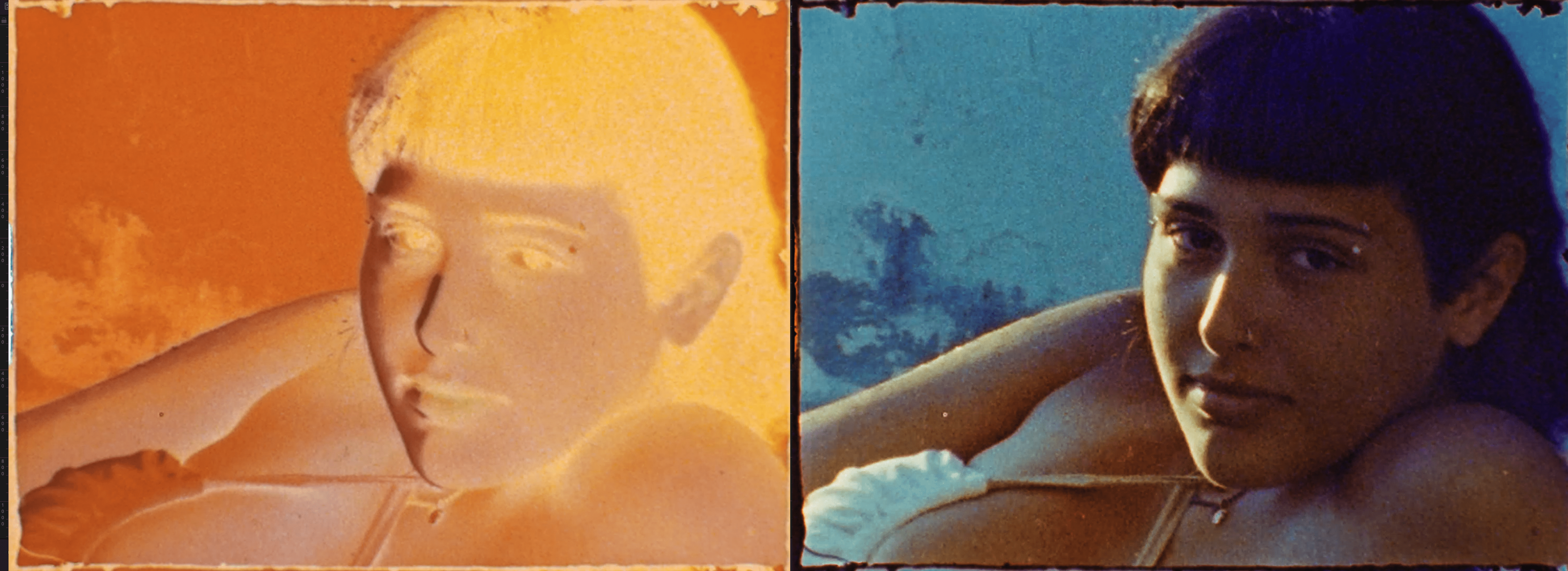

here some shots of the scans I did with V. 6.0, negative and positive.

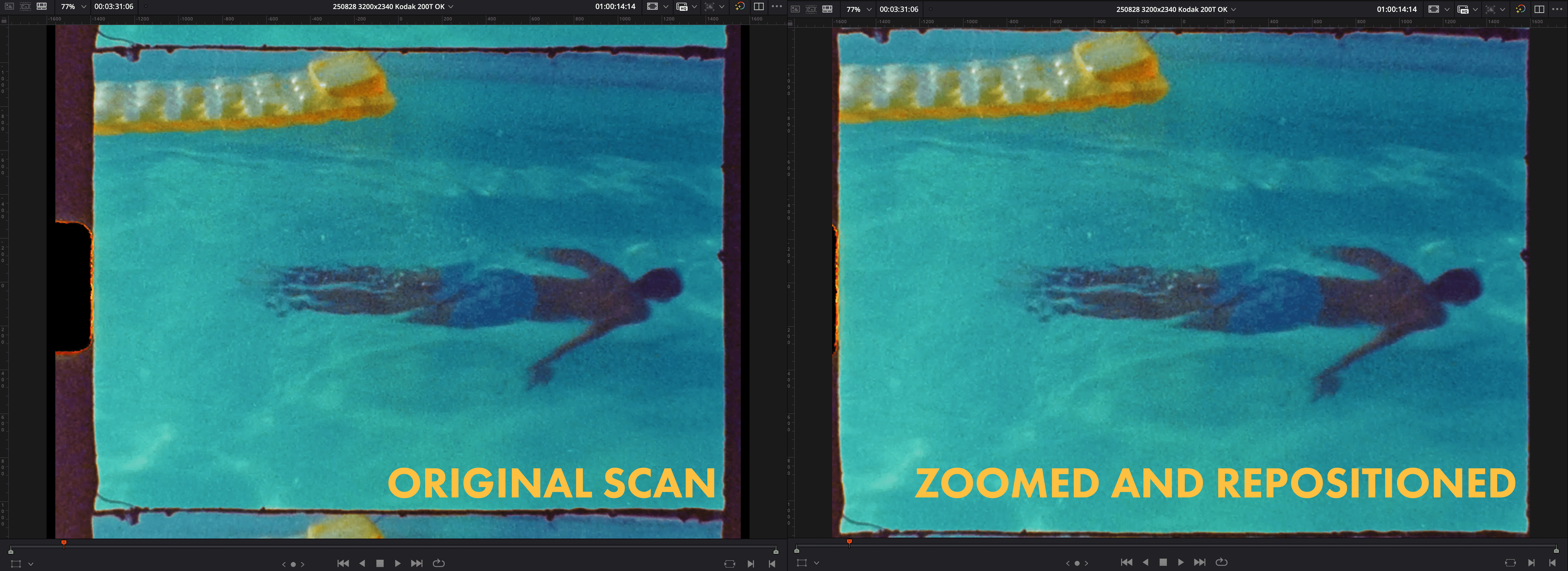

I graded them in Davinci Resolve. I moved away definetly from Premiere Pro three years ago, I've been "studying" Davinci for more than 15 years now, and I'm a big fan of it. This premise is to say that for me the important thing is the resolution and stability of the frames, because then I can correct the chromatic dominants if necessary.

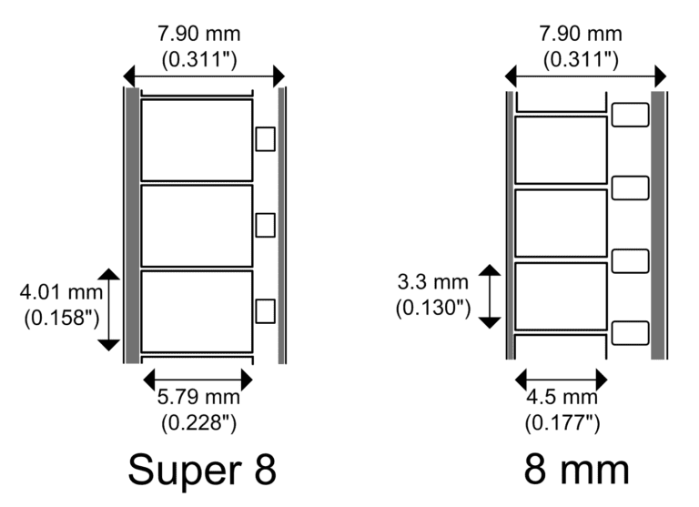

All these shots are natively taken with firmware 6.0, WB (Exposure) 0 Sharpness -1 Tint 0. I enlarged them a thad to fill the frame of 3200x2340 (dimension of a super 8 mm frame 5,79mmx4,01mm ratio 1,36...).
Negative - Positive Color - Kodak Vision 3 200T
Negative - Positive BW - Kodak Tri X

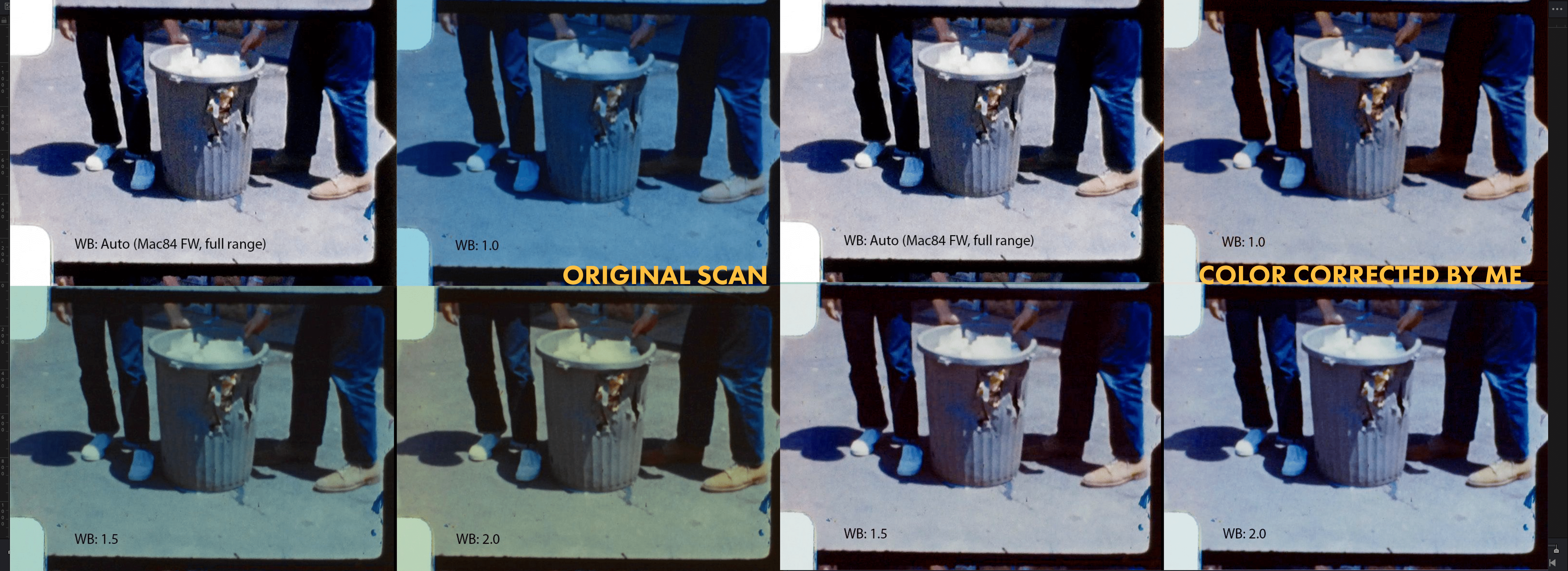

Finally I took the picture posted by ThePhage and I tried to match the Mac84 Scan.
They are quite close, I'm not a pro colorist. The original image is 214Kb. To me removing dominants color is always a challenge.
I followed the steps from Vladislav Novickij, that has a different approach in color correction.
