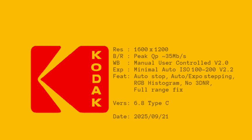

v6.8 - New firmware hacks for all Kodak Reels versions (A, B & C -- attached)
We now have white balance control for Kelvin and Tint, so full manual. We also have a RGB Histogram to help with you white balancing. The white balance control in pictures settings will only change the red to blue balance (Kelvin) with 9 discrete settings. Out side of the picture settings, even during capture, you can change the tint (green) by a longer press in Left or Right buttons (decrease or increase the green.) The green tint will be remember, even beyond a firmware update.
So many other small changes. I'm no longer seeing jitter on my hardware, but I have some code in there to help, just in case. It seems I skipped v6.7 (or never released it.)
Several of the extensions are now in C code, so let me know if you want to see that.

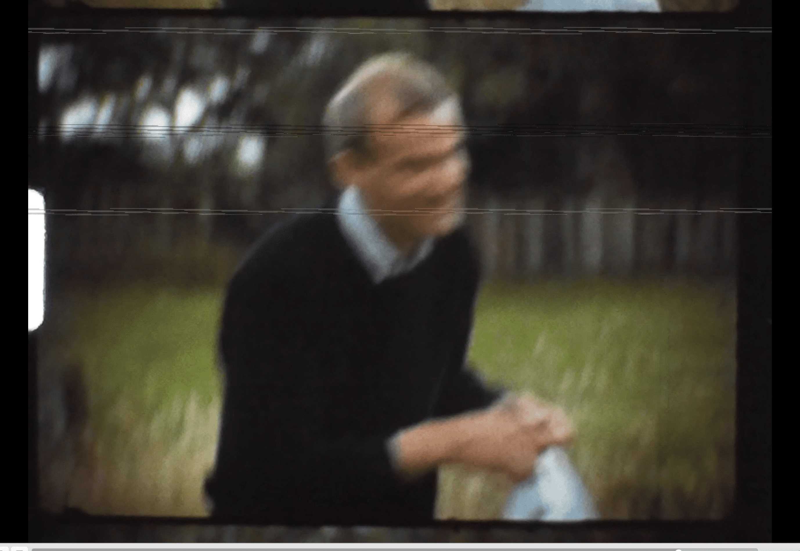

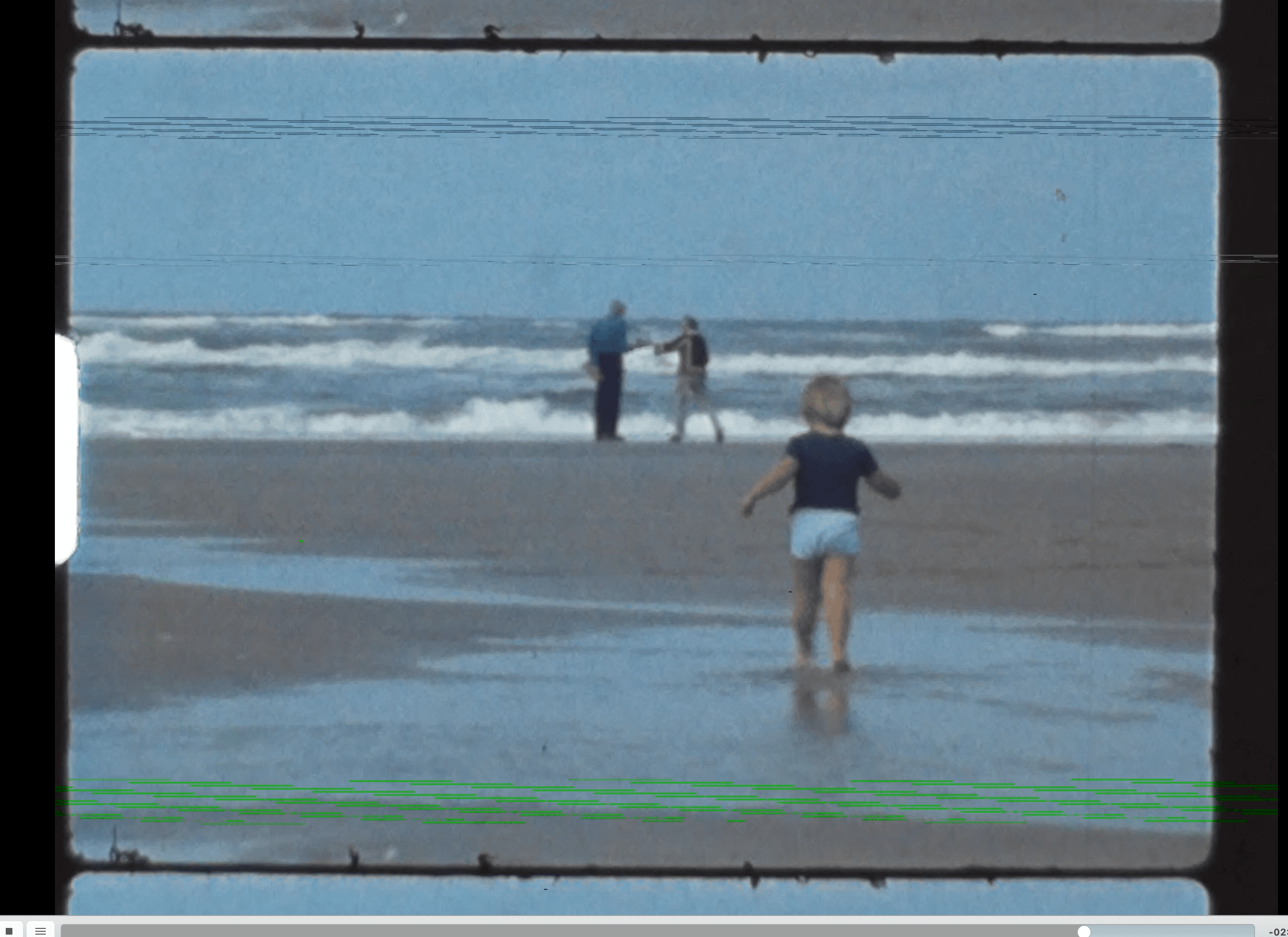

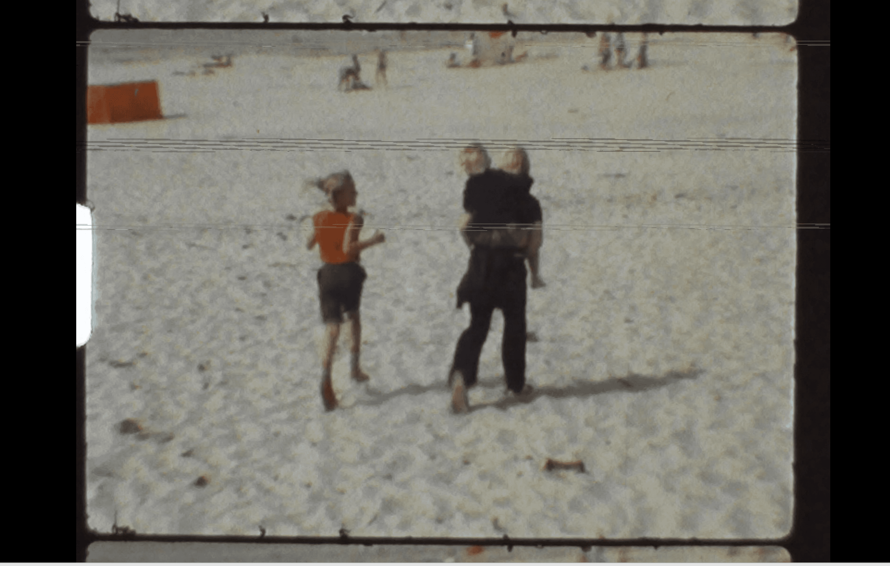

I have installed the 6.8 firmware, there is less jitter but still a lot at the end of the reel. Now I also get weird digital horizontal stripes sometimes in the picture. What could that be? Thanks for all the work!

My experience is that the shaking is caused by dried or poorly cut film. The gripper on dried film does not fit exactly into the perforation. On poorly cut film, the gripper does not have the strength to advance the film. Both of these problems are indicated by a loud clicking sound.
There is no difference in sound (I know the sound you mention). It's always in the last quarter of the reel. Maybe my kodak is just crappy.
With larger reels, the histogram disappears at some point, and horizontal lines shows up.
Yes, when? Look at the encoded file, and at what frame or minutes and second offset does it occur?

I think I've updated the firmware correctly, but I'm not sure how to check it.
My serial number starts with a C. I used the helper tool, which recommended firmware version B. I tried that, but got a crazy-looking screen. I tried the A version and finally the C version. The unit seems to work with the C version, but I don't see many other options for adjustments.
My first test result seems fine, though. At least good enough for archiving old family footage.

Thanks for the feedback. The firmware lookup took is based on the principal of the now offline Kodak firmware update site. It used serial numbers to determine which model the firmware should work. However, Kodak removed this website, so a lot of guesswork is involved for units beyond the serial numbers listed. At the time their tool was active, only "A" and "B" model units existed. Therefore, version "C" required some guesswork based on serial numbers submitted by people here.
Feel free to ping me your serial number so I can maybe help figure out how this works better.
Keep in mind, my website only modifies the bit rate and resolution. It does not include the excellent mods done by @0dan0. Those can be found through various posts in this thread.

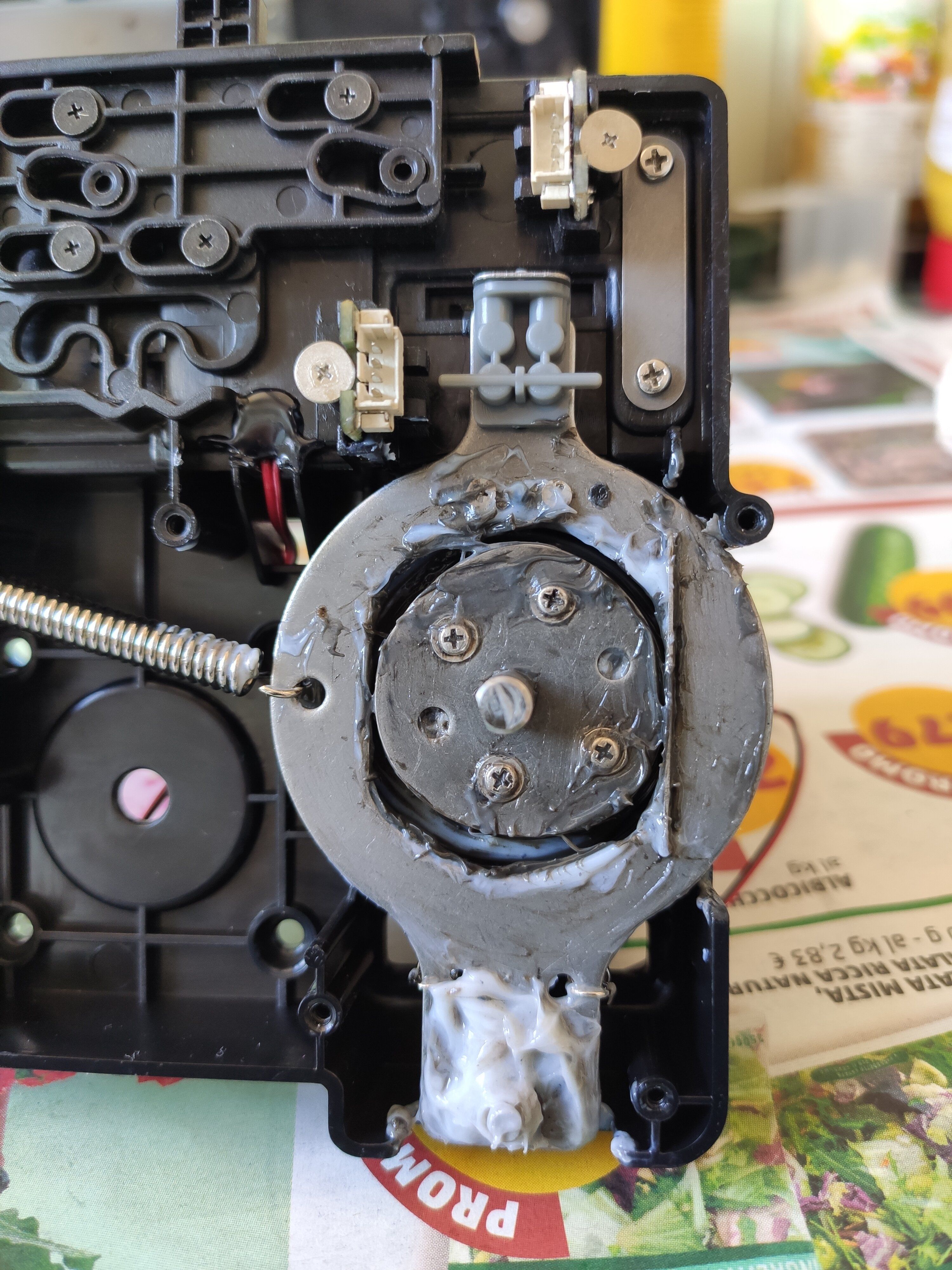

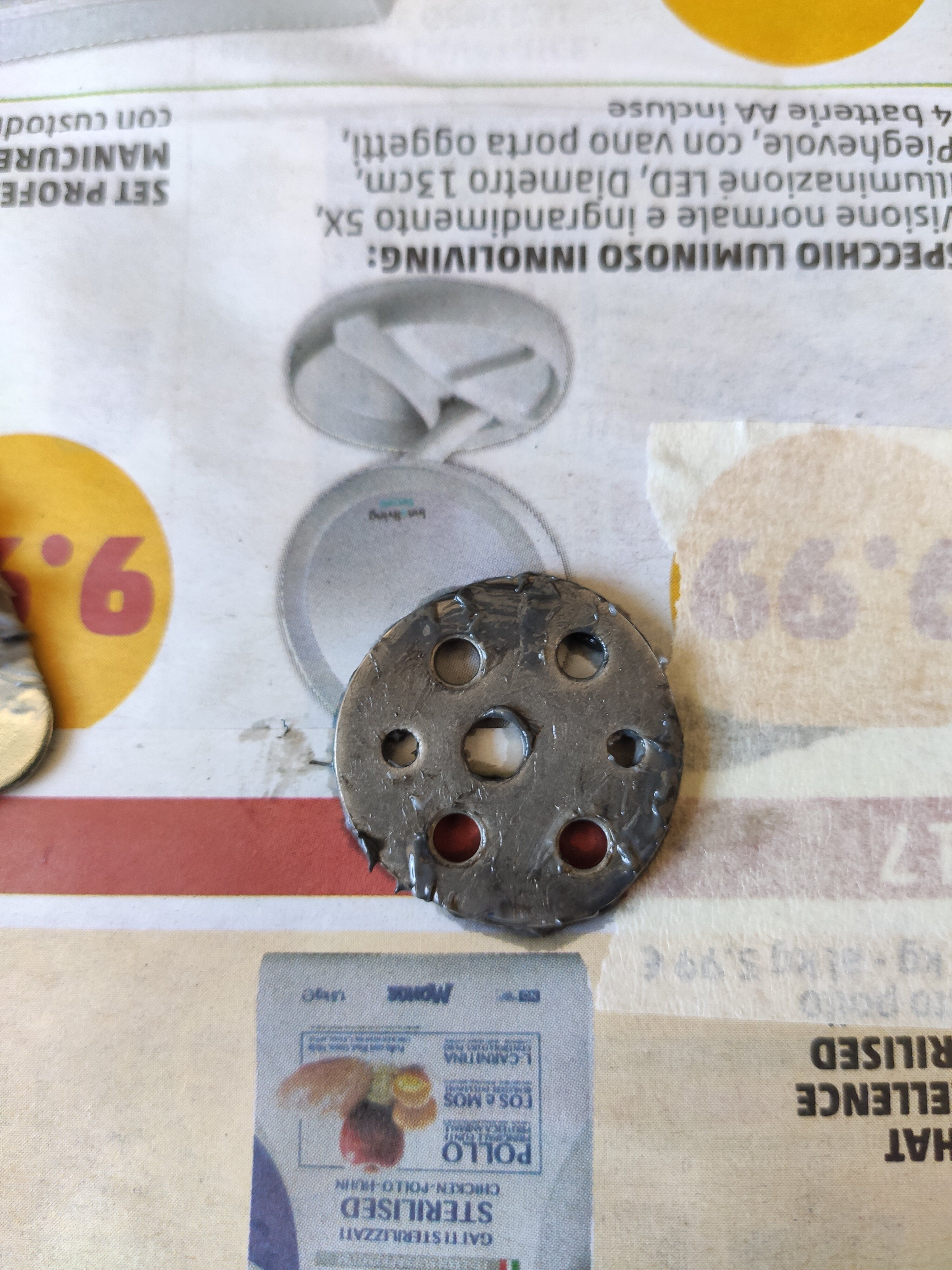

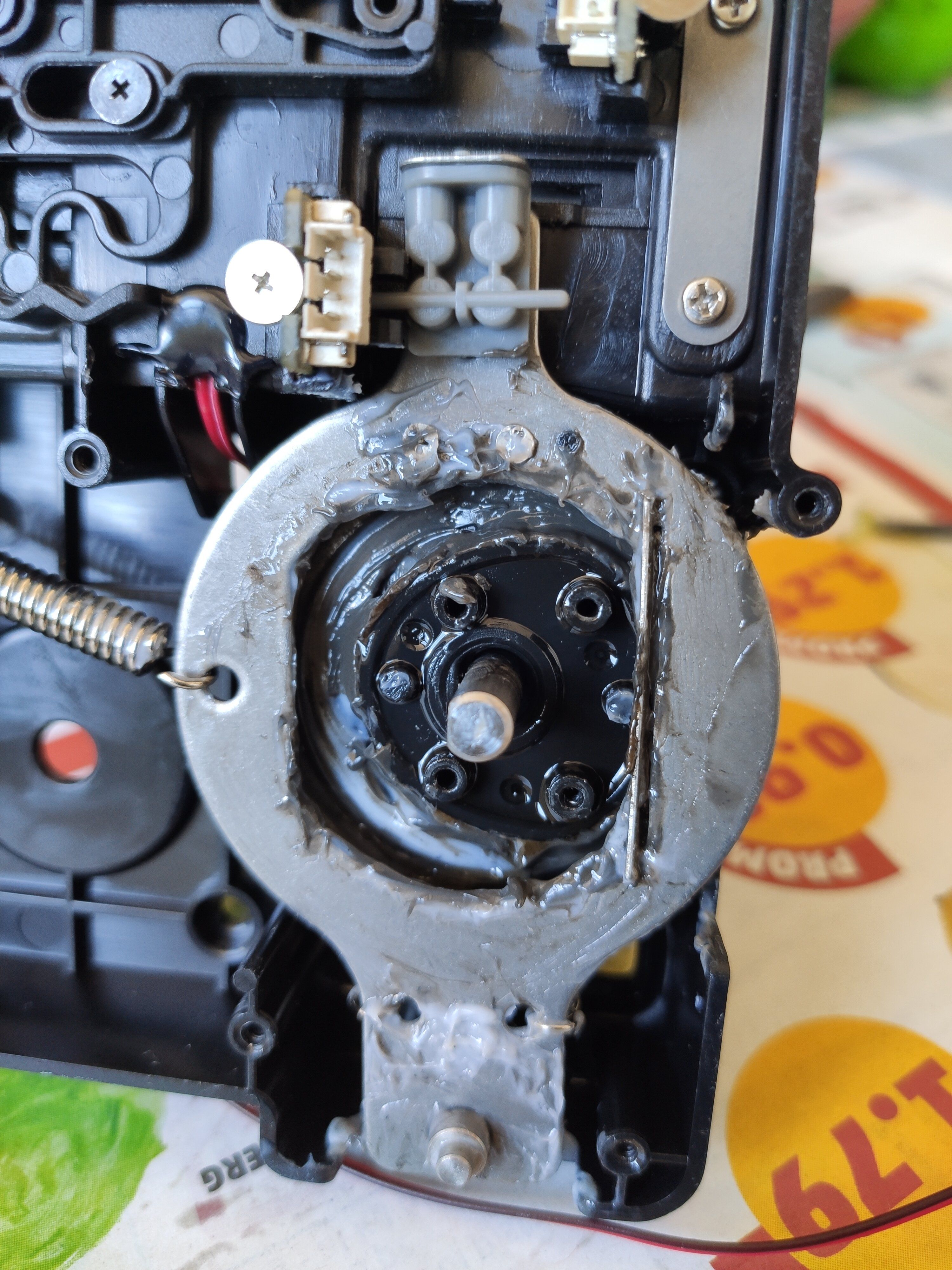

I decided to dismantle the whole mechanism under the grease. I found that there is no way to alter syncronization. The cam is held in a fixed position by 4 screws on the black gear, which is vinculated by a notch on the motor axis. Also, sensor can't be moved. Finally, pin is vinculated by two plastic pins to the bracket. You can see all this in pictures below. I think the only way could be via firmware, but I'm not qualified for this.View attachment 22375View attachment 22380View attachment 22376
Hi @KODIAK , I'm curious to know if you've managed to fix the problem with the pin?
Rather than the final position of the stepper motor, it seems that the round, eccentric component in your second picture is mounted 90degrees to the left (or right). If we consider the full rotation that brings the pin (in a correct machine) from all the way right (0 degrees), to the far left (180 deg) and back to the right (360 degrees rotation) yours start at 270 (or 90, maybe).
Would it be possible to put it back rotated 90 degrees on one side?
I might be completely wrong, but that was the first thing that came to my mind.

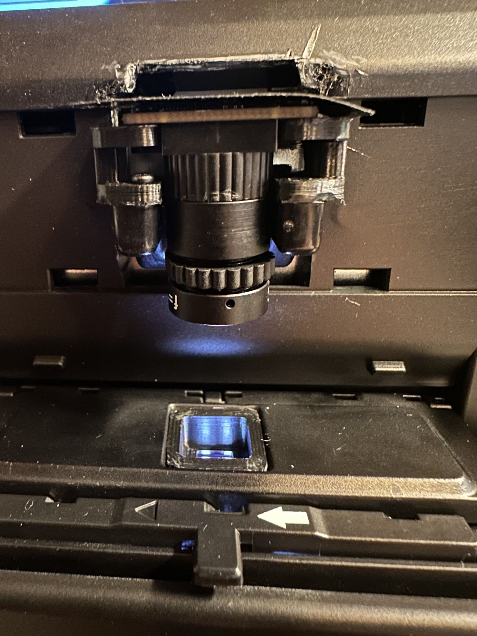

Hello all. New guy here. Just thought I would share my experience with this excellent thread.
I bought my Kodak from Amazon in July 2024 and have a serial# that begins with an A, and is A2724148BK00166. It did not match with anything in the tool from Mac84, so I tried all 3 versions of Odano's FW and version B works great. While A and C both caused issues, I had zero problems switching between versions. Just remember to read everything in Mac84's instructions.

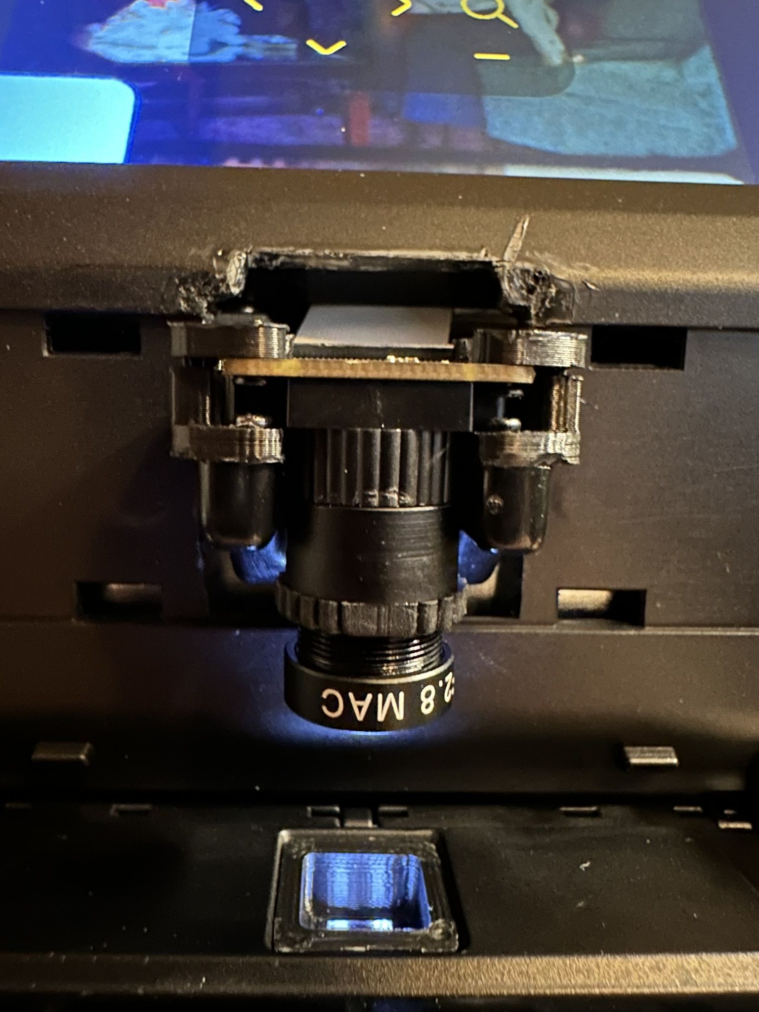

I purchased the spacer, locking ring and lens as outlined. The lens was $79 and shipping was $100 (I don't know how much would have been saved using the forwarding service). It was in the states within a week, but then DHL notified me that "duty" had to be collected from me for $62. I lost another week trying to argue with DHL about it, but they stuck to it ($45 duty and $17 tax on the duty). Although the part was coming from the UK, it was listed as Chinese origin. Keep this in mind if you are thinking of taking this route. Worth it to me considering the number of reels I have.
As an idea for others, check with your local library for availability of 3D printers. My local had 3 brand new printers. To print Odano's parts cost me a whopping .75 cents. and took less than hour of prep, setup and print. Did the mounts and the insert.

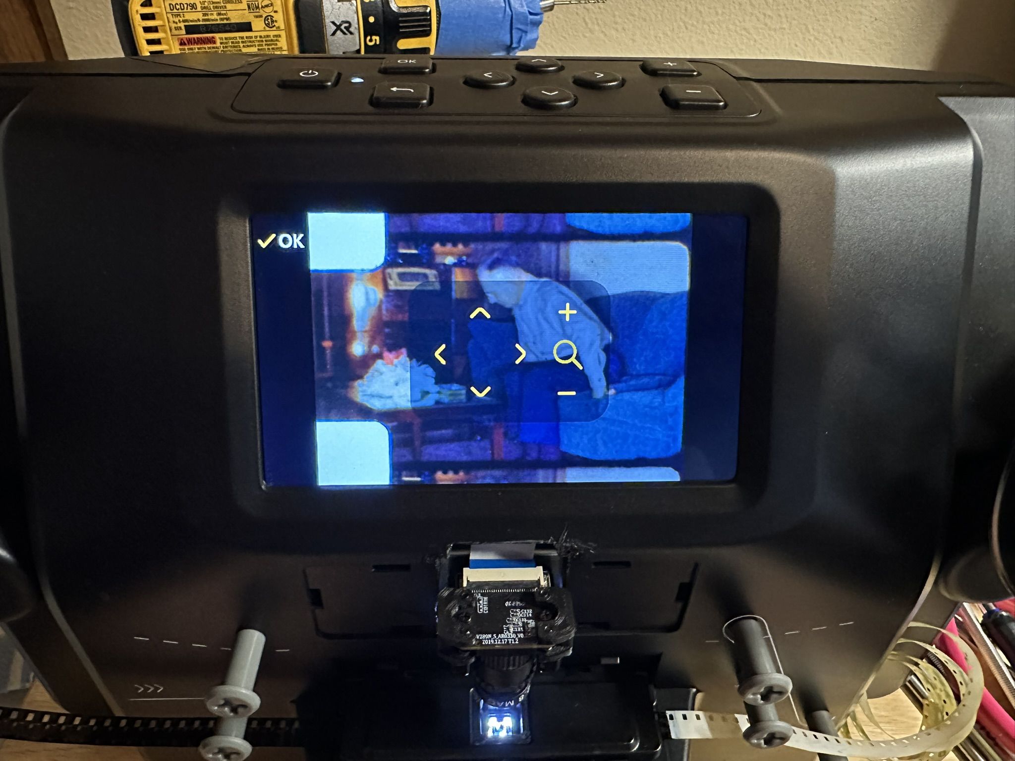

Once I had everything mounted, I had an issue that others must not have experienced. I included a pic of my setup (like Odano's). I had the lens spacer screwed in completely, then as I was screwing in the lens and trying to focus, I ran out of available internal spacer thread to screw the lens into the spacer just as it was coming into focus. What to do? After playing with the height of the lens assembly, I was able to get to enough focus adjustment by installing the circuit board underneath the top mount (see pic). Once I did this, the framing was out of square, so I had to open the lower mount holes just a bit to allow a little twisting of the mount to square up the frame. In case you are wondering, I did look for the same exact screws from various hardware resources, but these were difficult to find. I ended up finding a laptop screw kit with micro screws and used the flathead M2*4 screws, which worked perfectly. Little different thread pitch, but held much tighter. Got the focusing dialed in and now need to ask some questions.
1) Has anyone experienced the same issue with the lens? What could I have done wrong? I am not seeing anything.
2) With the lowering of my lens, is the area of capture changed from what others are capturing? I believe it was suggested to NOT use the Kodak zoom, capture the entire frame and crop later. With that, does my framing mirror others or am I getting too much of the top and bottom frames included? (see pic below).

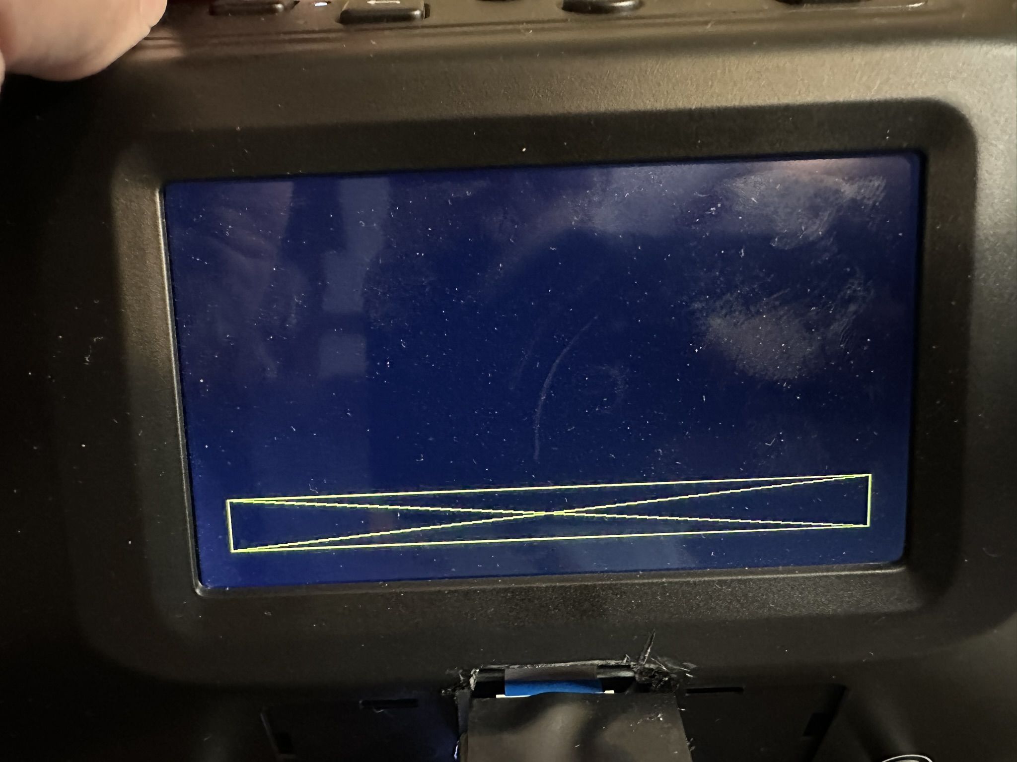

3) When I tried the latest version of Odano's 6.8, ver B, when I hit capture, I ended up with a rectangular X (see pic) for a few seconds before it goes back to the menu. Reverting back to 6.6 works.
