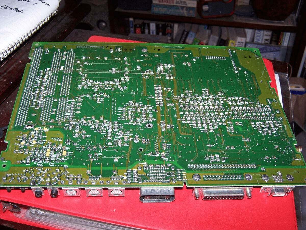

Yes, it is a mess there isn't it (eBay photo for reference)

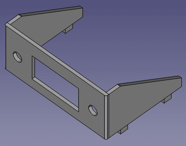

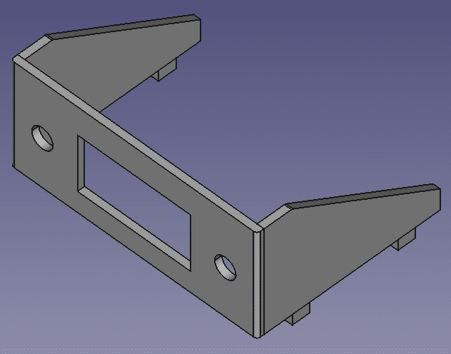

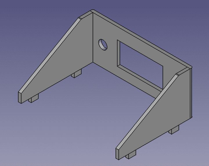

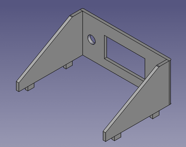

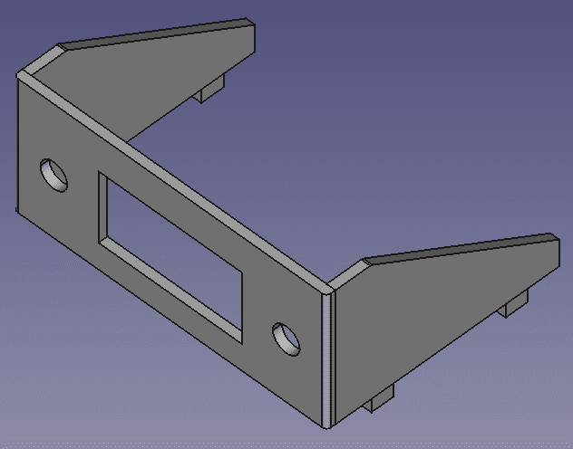

Options I'd consider...
  1. Unlikely to be enough room, but you have a little flexibility to move the VGA connector forwards and backwards, even left to right, to get small pads between the rows and columns on the HDI45 footprint. Not a fan of this one.
  2. Double stack PCBs. Lower PCB for connecting to the footprint, upper for the VGA port. There is enough height in the rear opening on the case.
  3. Go back to making an L shape from PCBs, then you don't have the issue.
For low volume stuff, I'd actually consider cutting out a bracket in (1mm? 0.8mm?) steel that went into the four ground / mechanical soldered connections on the PCB and provided a panel mount for a regular VGA port, and then just hand wiring to the small number of pads you need. Makes the whole thing a couple of hours with a grinder, a printed template and a standard solder bucket DSub port.

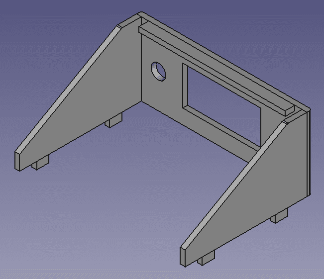

Tum te tum...
Edit : an extra fold tab at the top is likely needed for rigidity - it will be harder to include if you don't have the right tools, but worth it. Sorry the folds don't look like proper sheet metal folds, I haven't used this cad software in 10 years and never have much.

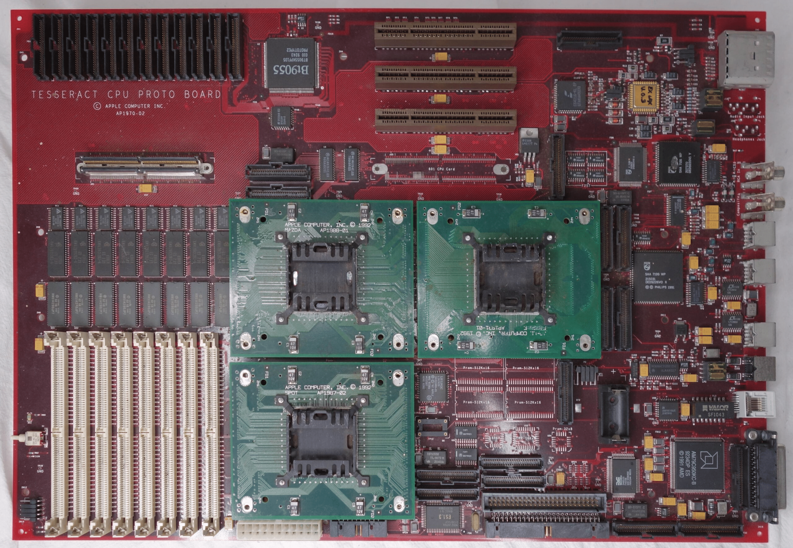

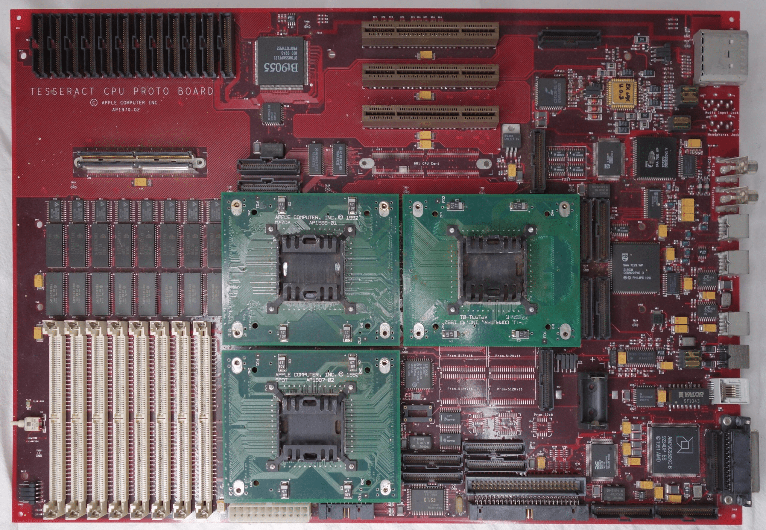

Unrelated, but Apple were putting the HDI-45 on the dual 601 CPU prototype that they cancelled - the tesseract project that the PDM / 6100 and family was the fallback for.
Wait, three PPC601's on a board??

@phipli absolutely love your work here, but scale is problematic.
Your lug holes will be nearly tangential to the bend lines on the sides. Nuts won't work and I don't think heavy enough metal to tap would be a workable alternative. Too much work even if possible.
I'm wondering if the shield slots are large enough to heat/moldover/weld(?) pins on the bottom of a printed chassis to the bottom of the PCB? Can't remember the name of the process Apple used to attach heat shields parts to case plastics.
Anyway, drilling the slots out to round and bolting up a printed chassis for the connector ought to work fine?
I'm afraid that I don't quite follow, the issues you raise aren't things that I was worried about and I'm not 100% sure which features you mean - regional dialects can vary a lot for this sort of thing - lug can mean several things, in this context it could mean the threaded parts that go through the VGA port, or the four tabs for the bracket itself - it isn't usually a technical term except in the context of cable mounting lugs perhaps. I'd been worrying about a some difficulties, like corrosion prevention, thermal mass, and order of operations, but the first - you can plate at home, the second, pre-heating and a good iron, and the third I'd worked out a workable order.
Are you worrying about distortion due to the proximity of the VGA ports mounting hole to the fold? That shouldn't be an issue, the face with the openings can be clamped during the fold, or alternatively the holes can be drilled after the folding is complete.
Threading? Nothing on the part needs threading? I'm not quite sure where you mean? It sounds like you mean into the four tabs... but that isn't what they're for - they're for soldering. The thing I'm wondering here is if I'd need to go down to 0.6mm steel to help with the thermal mass. The thinner the metal used, the more critical the extra fold in the third picture I put in the post afterwards becomes, that is for rigidity. I'd fold it with extra length, and then cut it down afterwards - it is difficult to fold things without sufficient material.
Dimensions on the mounting face are vaguely accurate (I measured connectors with a ruler), to build I'd measure accurately and prototype in cardboard. But the tabs that go into the PCB have just been guessed, and the length of the two... "wings" have only been eyeballed. My 6100 is in use so I'm not able to take measurements atm.
Some of the other things you've mentioned, I realise I probably haven't specifically mentioned it, but my intention was to solder the bracket in place, in a similar manner to how most ports are mounted on a mac.
A 3D printed part could potentially be fixed by applying heat to the four tabs like you say, but I don't have a 3D printer - I'm more of a metal kind of person.
Really sorry if I'm misunderstanding, well, I know I am, I don't quite follow your post.

Could that be 3D printed by PCBWay in metal?
Should be fine for that, probably a little expensive. Likely cheaper to get it laser cut locally and even folded. Then you'd just need to plate it at home to stop it rusting.
Just two - I think you're looking at the prototype chipset chips.
The CPUs are missing - one connector has been torn off and you can see 601 in the silkscreen footprint, the other is still there.

More likely to be PDS. O.G. PCI only dates to around 1992 and Apple had no compatible ecosystem at the time.
I believe they are probably what Apple called "BLT" (probably doesn't stand for Bacon, Lettuce Tomato). This is what was used for earlier revisions of this project - Jaguar and Hurricane.
Couple of extracts from Apple docs from the period.
