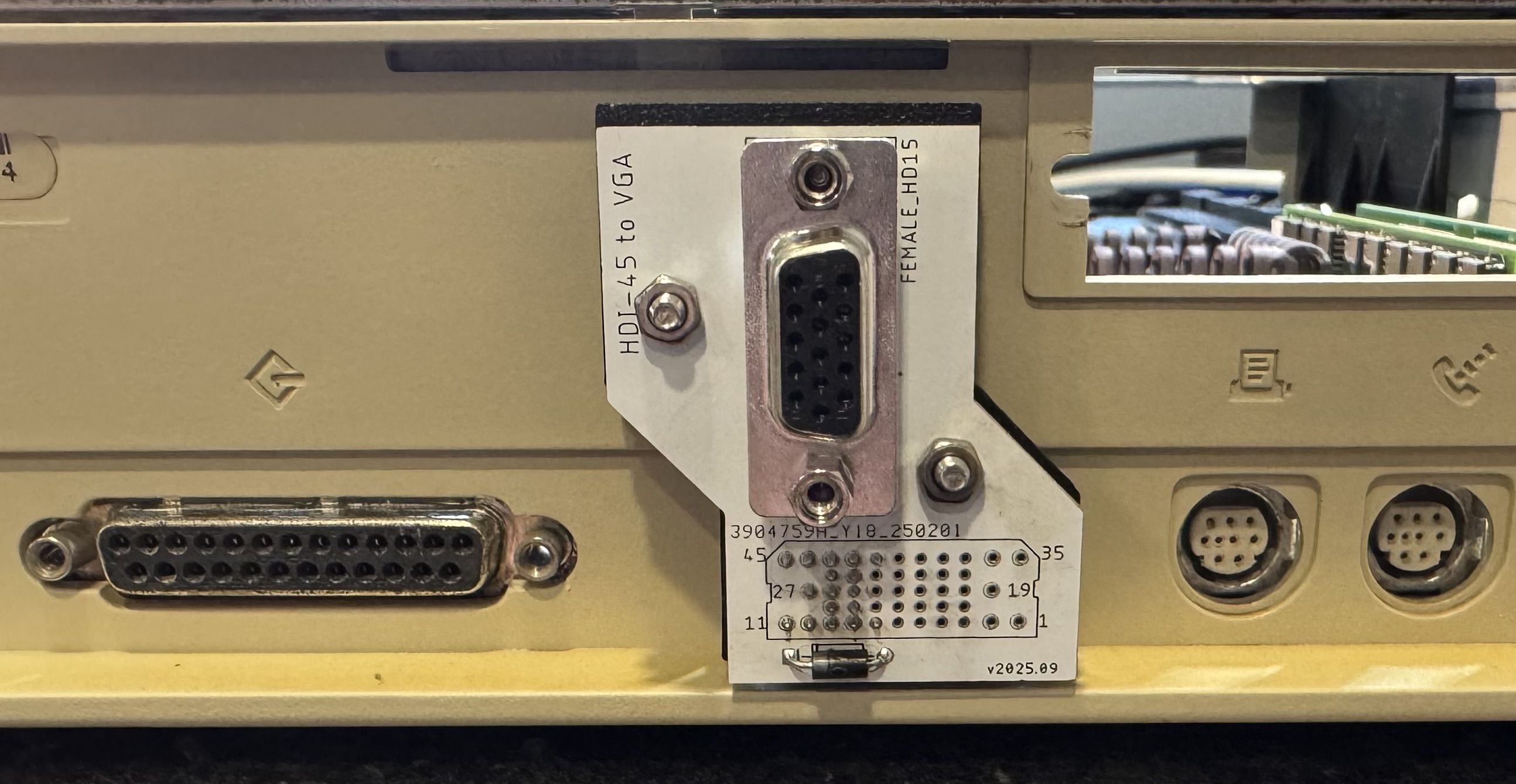

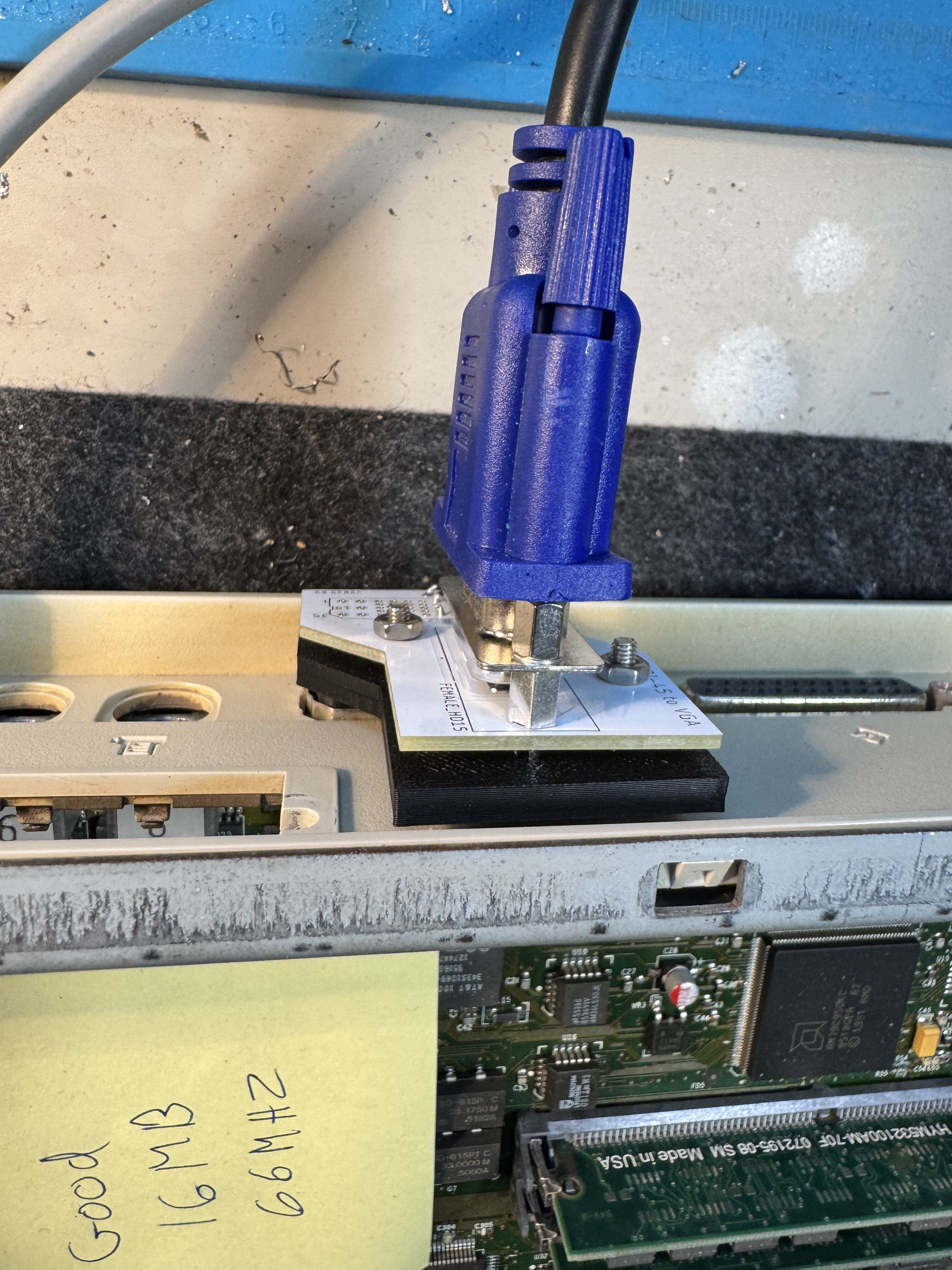

Here's a video of the full case. It's not quite sitting perfect because it was designed to have a PCB sandwiched in there, but It seems to have good stability. Trying to optimize for low print times and lack of need for supports.
As you can see the shroud makes the adapter really stable when plugged in (in addition to ensuring the pins are aligned on insertion). Really excited to get the official PCBs made up and in use in these. My current estimates for these is the following to produce 5:
Great job and love that video.

Yeah, it's actually coming back closer to my original idea of an adapter. Originally, I was trying to come up with a way to build a 2 PCB adapter (one with just the HDI-45 pins, then a bunch of wires connecting them to the HD-15 or DA-15 connector. That soldering job would have been a nightmare, considering the pin spacing on that HDI-45 connector.
When I realized that challenge, I did consider the port replacement idea, thinking it would be easier than the adapter, but the idea of an offset PCB seems like it is the ideal solution.
Also, I just plugged it into the 8100 and I think it will likely work just fine without adjustment.

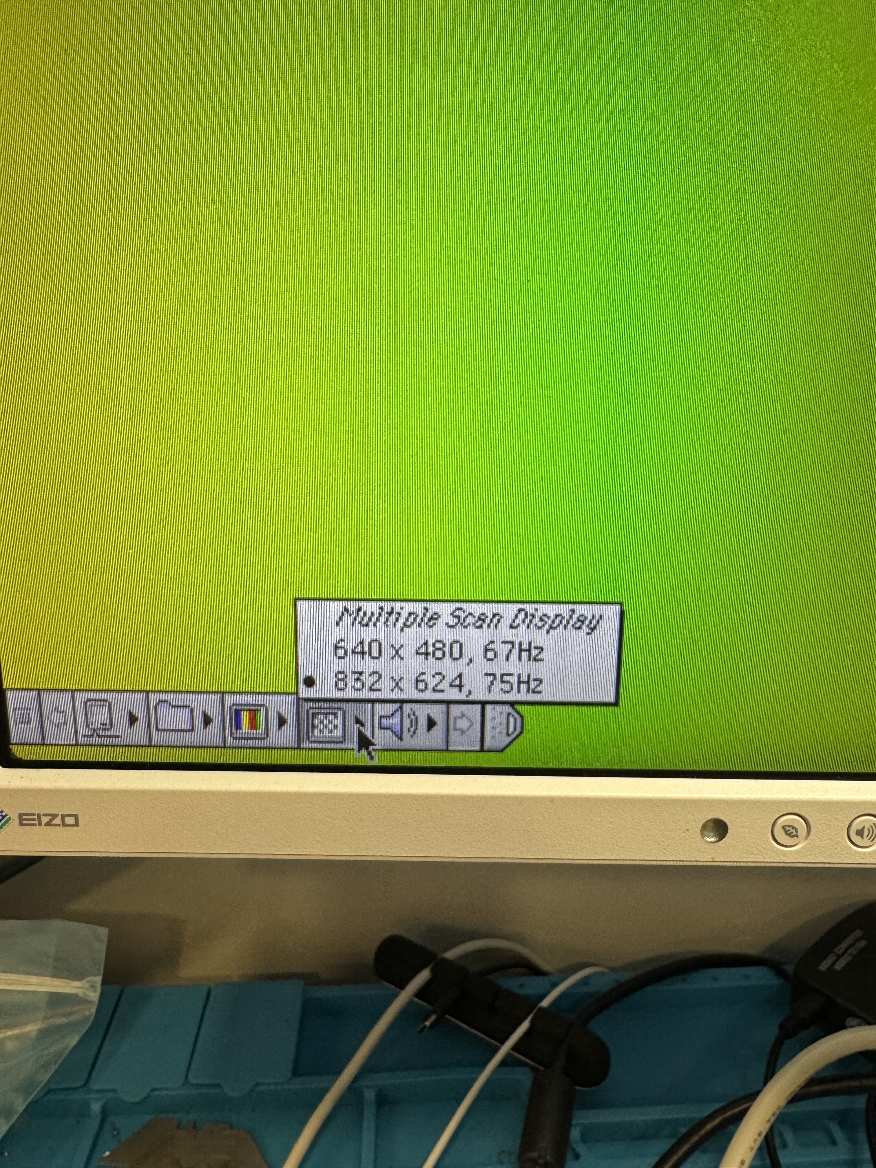

The JLCPBC order of my very early design (no diode, HD-15 right angle connector. One thing I learned and will adjust before the final version is that apparently the HD15 templates in Eagle for the connectors are not universal (rookie mistake). I had to bend the two outer rows outward to fit the holes on my board. But, I soldered up the longer 19mm headers on the HDI-45 side first, then forced the HD-15 connector in place (I actually used one of my straight pinned version because it was easier to get the pins in the right spot).
It was one of the very early designs that I hastily ordered on PCBWay because I wanted to verify I could make a working PCB, so it is much wider than the current PCB designs. So I taped one of my current shrouds onto it to help with alignment, plugged it into a 6100, and fired it up:
I was a bit surprised because without the diode, I got multiple resolution options:
I thought it was going to only give me 640x480. I still plan to add the diode, but this version would likely have been just fine for the 6100s, since I believe they were limited to 832x624 anyway. But maybe for the 7100 / 8100 machines, they can take advantage of the higher resolutions.
So, I confirmed the two things I wanted to with this test:
1. I was able to design a functional PCB and generate the appropriate gerbers to produce a working product
2. I don't notice any issues with the signal quality due to inappropriate grounding or routing of traces.
I will likely try to update my connectors to ensure they match the actual ones I ordered, and get them ordered. I want to get them in hand so I can tweak the fit and placement of my 3d printed cases. Once all done, I will start a new thread with the location of the PCBs, 3d files, and guidance on assembly so people looking to do this won't have to follow my rambling story with multiple design ideas that lead us to finally a good, clean, workable design.
A diode from pin 10 (SENSE2) to pin 7 (SENSE1) with ground on pin 4 (SENSE0) is for MultiScan 21" displays.
VGA uses a wire instead of a diode between SENSE2 and SENSE1 with SENSE0 not connected.
#41 #42
Without a diode, the only multi resolution modes available are for VGA and Multiple Scan 13" or 14".
The latter requires a line from sense 2 to sense 1 in place of a diode with ground on sense 0.
If you have just a ground on sense 0, then it's 640x480 67Hz only.
That explains it. I must have misread the post from earlier about the behavior.

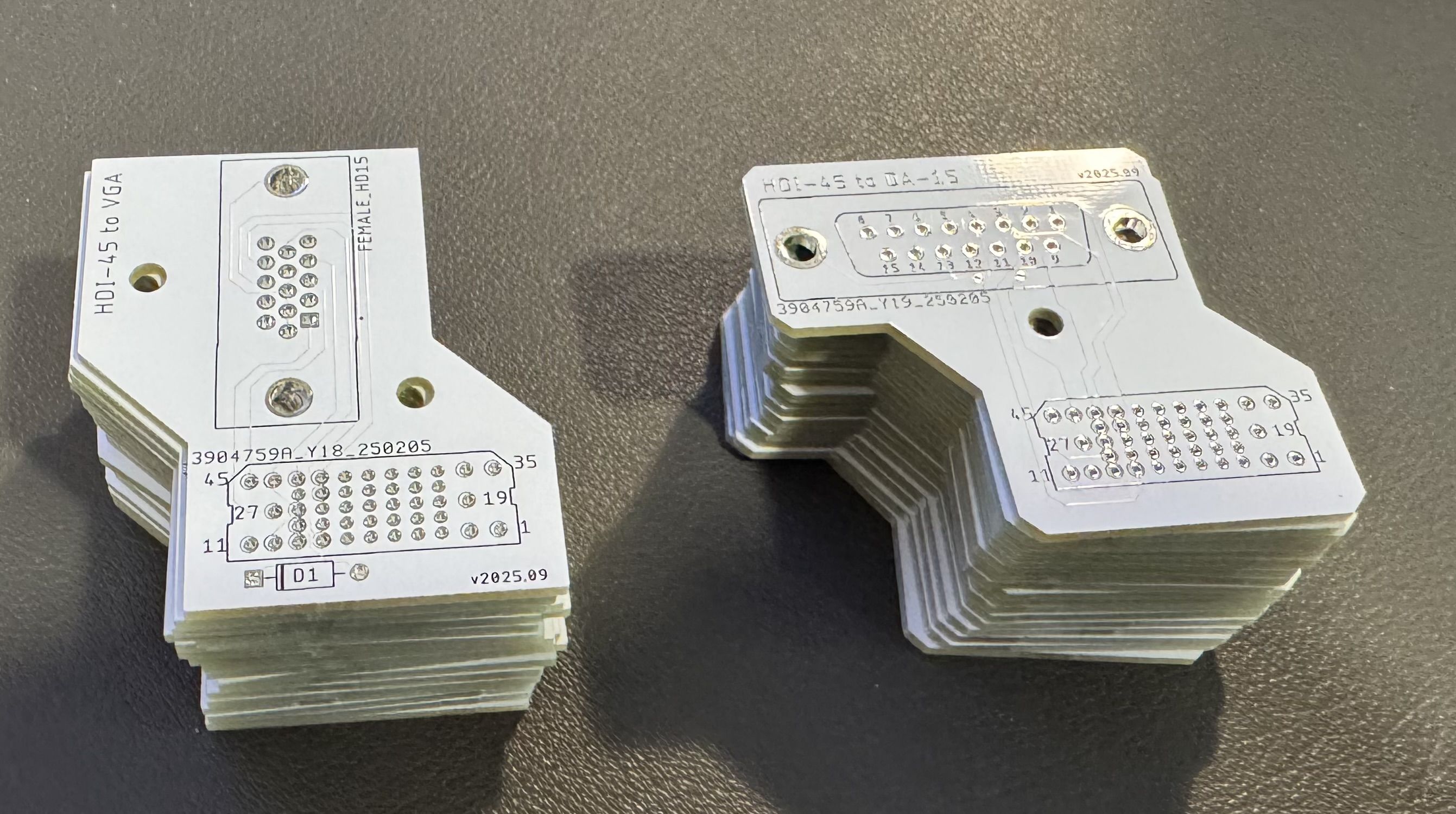

OK, just returned from a work trip and had a nice little present waiting for me when I got back.
Lots of PCBs!
I wanted to make sure the diode worked and the rest of the PCB design was functional, so I soldered the 2.0mm spaced pins, added the diode, then added the HD-15 connector. Used a trial run of my 3d printed backplate with the shroud for alignment (it was a bit off so I had to enlarge the holes), and gave it a test run. Fortunately, it works perfectly, gives me the resolutions I was expecting, and doesn't block anything critical on the 6100. I will have slightly different cases for the 7100 and 8100, but I'm excited to say this version works.
I'm going to solder up one with a DA-15 connector to confirm it will work with my DOS compatibility cards / Y cable. I adjusted my case and am printing a full set (top and bottom) to confirm fit. Once I feel good about it, I will publish the files to GitHub.
A few lessons I learned. First, at least with the white PCBs that I am using, the rings I tried to put around the important pins are impossible to see, so I'll probably make those markings bigger. I also will move those markings to the back side of the board as well, as that is where you will be inserting the pins, so it will be more helpful there. Second, if using the 3d printed case with the pin shroud, you don't need any of the pins on the left side I originally marked as needed, because the shroud handles the alignment, and I originally added those pins to add with proper alignment. So I'll likely remove those from the markings and mention they are optional, really only needed if you aren't using the 3d printed case and are running with a bare PCB.
Lots of PCBs!
View attachment 20246 View attachment 20247 View attachment 20248
