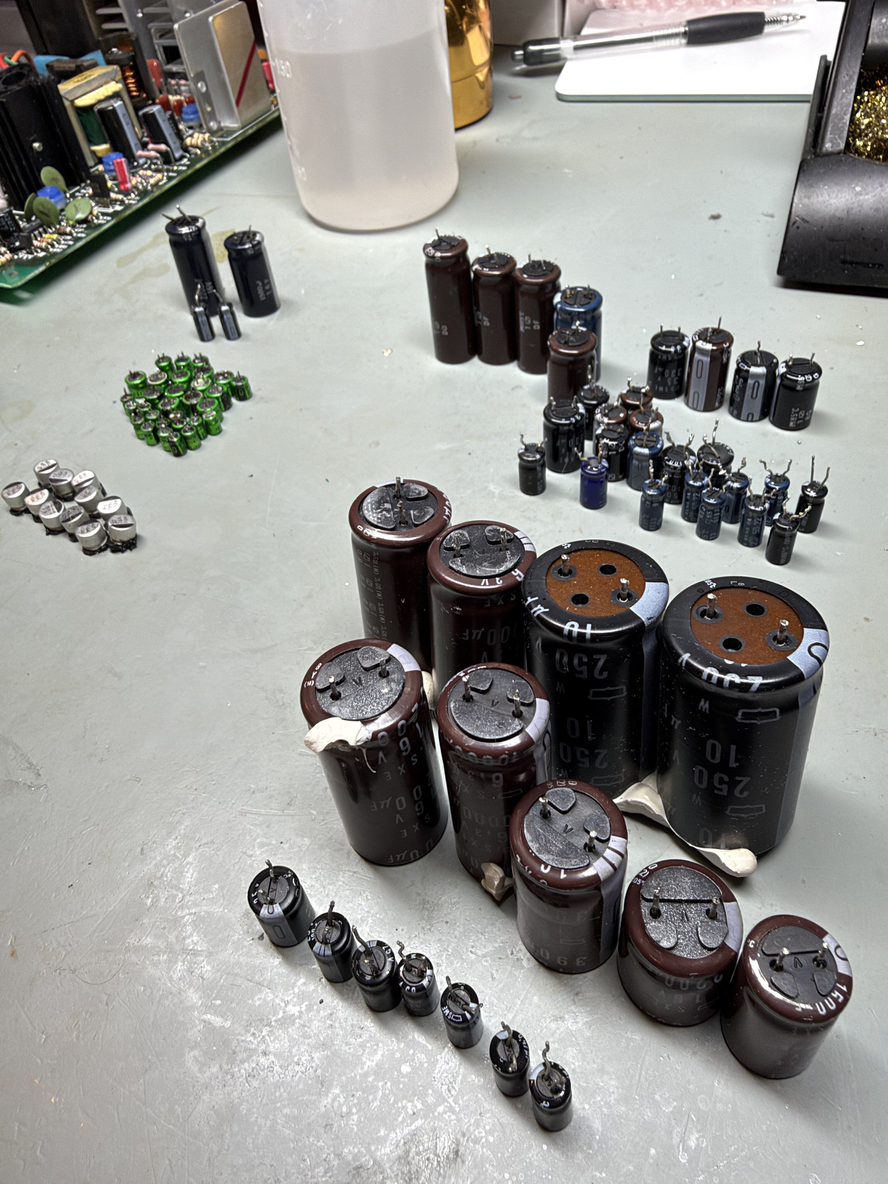

I finished recapping the analog board on the MegaPixel display. Though it seemed to be working fine, many of the caps were out of spec or outright bad.

While I was at it I measured the caps pulled from all of the other boards. So many!

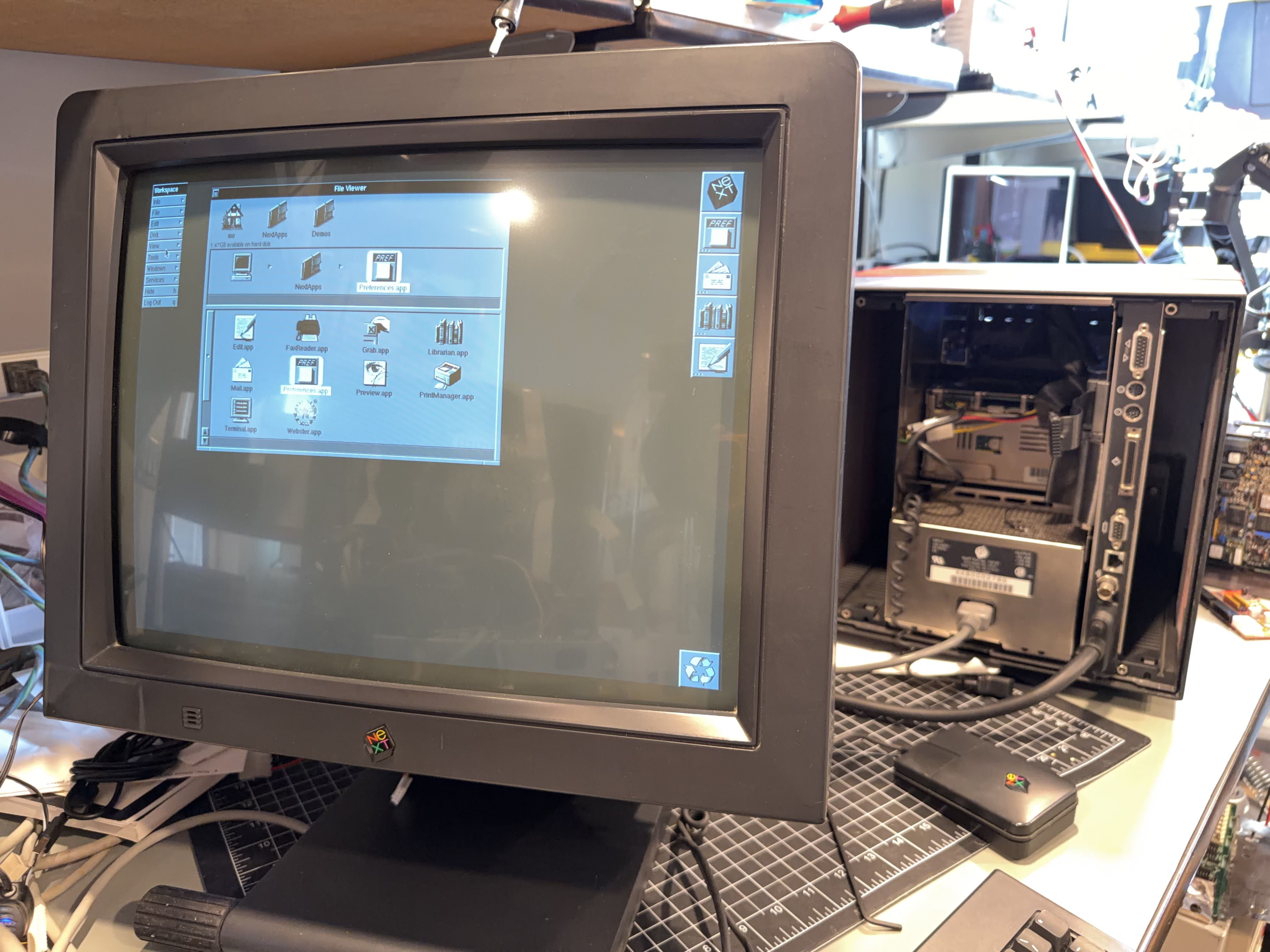

Almost 100 capacitors later and this machine is working again. I need to adjust the CRT a bit, but otherwise she's working well!
