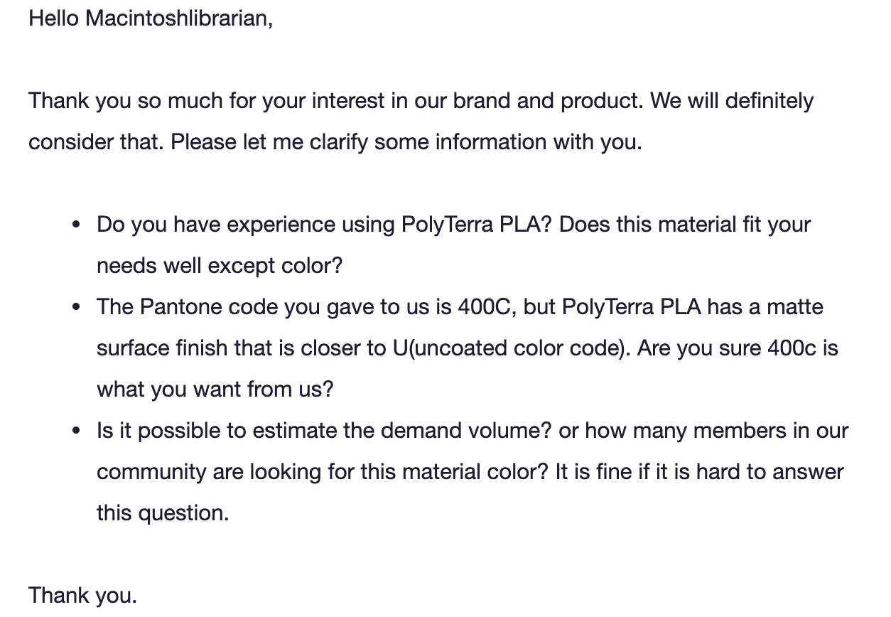

I contacted my favorite filament provider Polymaker about creating a PLA filament in a 400C color.
I love their Matte finish PolyTerra PLA - and the fact that it comes in a recyclable cardboard spool.
I think they are willing to work with us to get this color produced - hopefully at a lower cost than the current source.
Here is the email I received from them.
Let me know if this is something the community wants to pursue!

jcm-1
I dont want to step on anyone's toes here.
