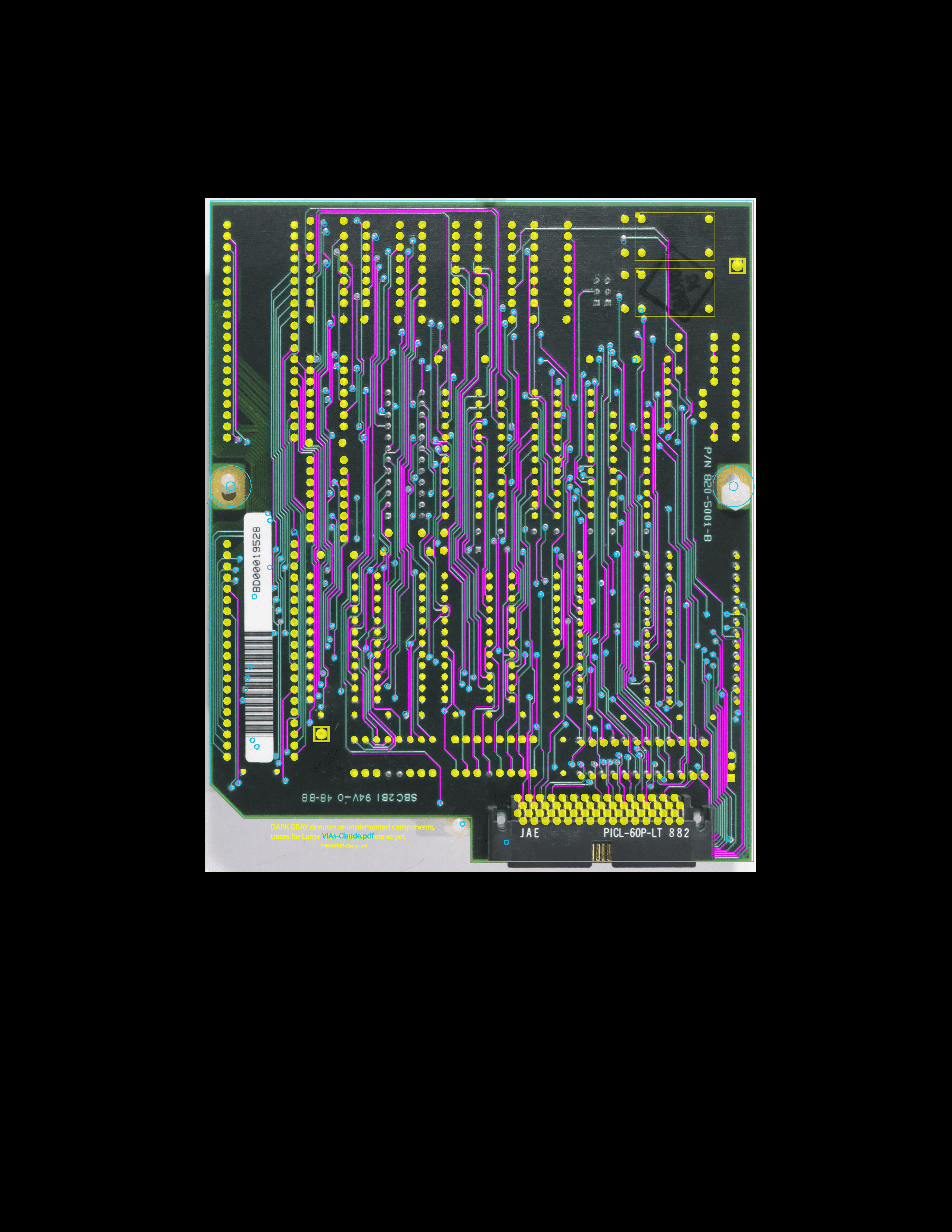

Thanks @JDW Very interesting comments about workflow there, but . . .
Definitely headed toward KiCAD, but only after a few more steps. Illustrator suffices for Claude assisted schematic capture required for that platform. For that I need a pristine scan of the solder side of the board, bullet four above, then . . .
1 - Claude does an accurate drill map for the entire board from the scan
2 - desolder components above the VRAM/ROM line (North 40)
3 - take pics of all newly exposed traces
4 - install wire wrap sockets
5 - re-populate components, TTL to be sourced new
6 - test for function
At that point the "South 40" section components are desoldered and steps 3-6 are repeated.
From my AI doodling, schematic capture is easily achieved. A daughtercard that slides down over the "North 40" wire wrap pins will be designed (likely in KiCAD) for connection to the FPGA Project Board. That's a very simple bit of tracework for now that's almost unrelated to the full card's Schematic Capture, which will already be in the can at that point. Photos of the Component Side traces are entirely adequate, the bare board High-DTP Scan is done of only the solder side. Tearing it down and rebuilding it is done in three steps.

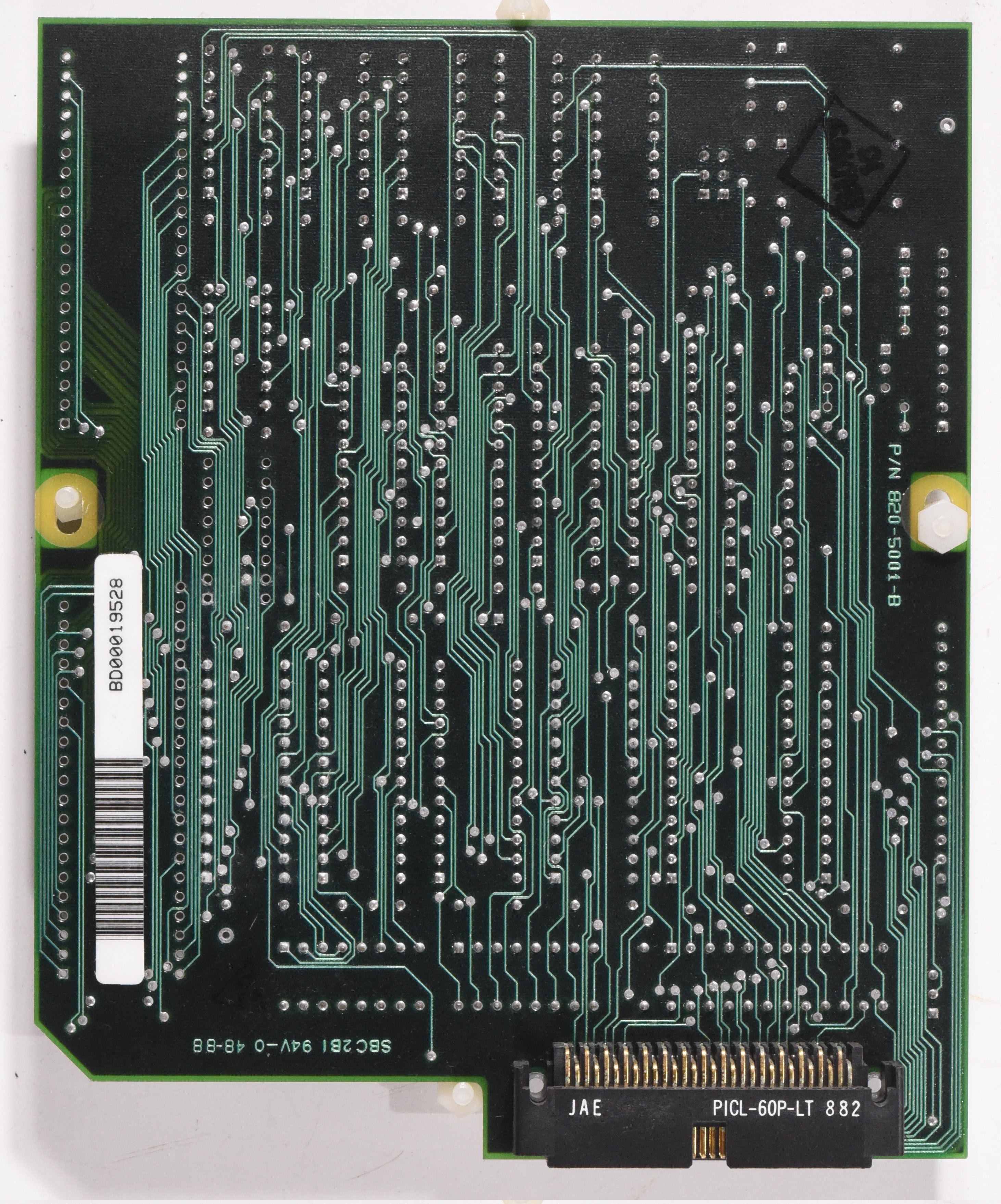

I have serious doubts about an LLM model's understanding of the makeup of a four layer board. Shining a light from underneath as suggested is a fool's errand. No light can pass thru anything but a thru Via or the ring of light surrounding a thruhole. Power and ground layers are obvious by examination.
I have no idea what the models are babbling about in regard to traces that clearly exist along the edge of either the power or ground layer. As it's a bus connecting larger, higher capacity, unimplemented ROMs outside areas where shielding active component signalling is required, it makes sense to me that Radius cheated by appropriating a section of one of the two inner planes:
View from the other side is a solid plane, layer two or three. So much for advanced intelligence, no?

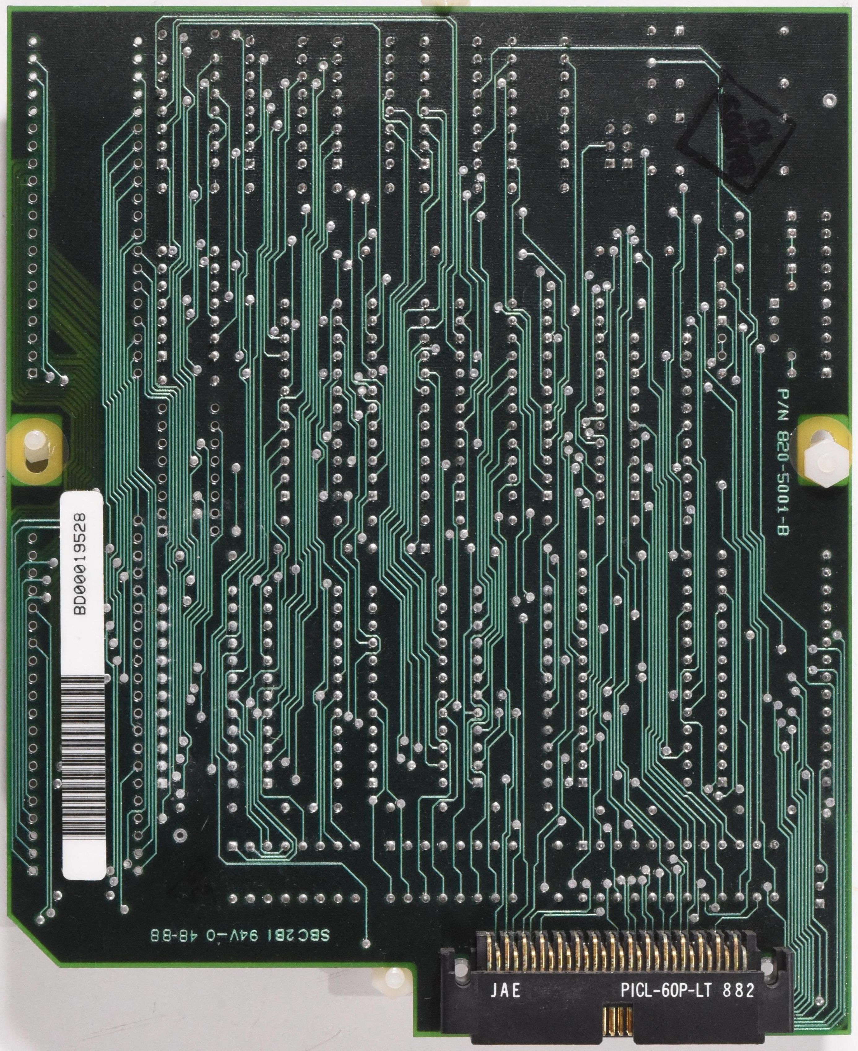

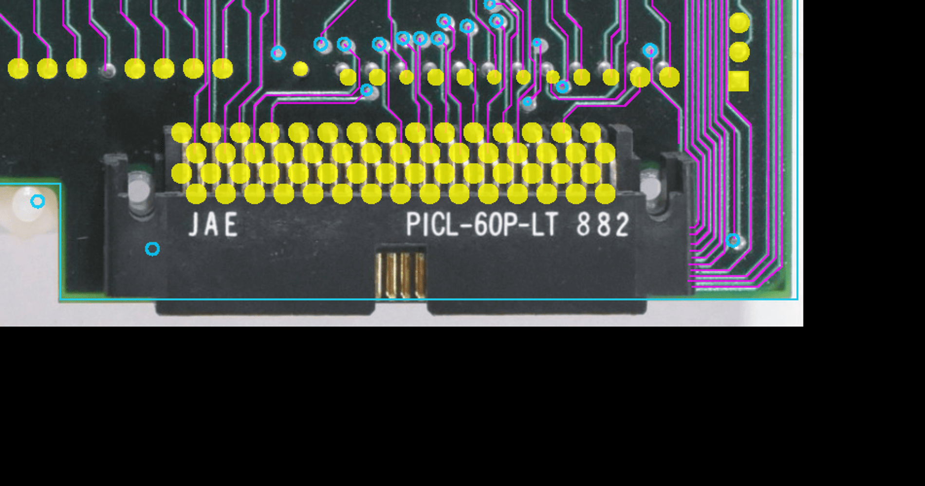

[Uploaded image:]
The photo came through this time. It shows two sets of traces, and they're different.
What's in the image
  • Bright, sharp traces are on the surface you photographed. That includes the two vias off the top pin row and the bus fanning into the lower pin row.
  • Faint, soft-edged traces sit below the surface. There's a diagonal group of about 6–8 parallel lines between the two pin rows, plus a horizontal group that curves around the "528" label and the yellow pad. These are what Luna called a bus. Their blurred edges mean you're seeing them through the board material.
  • The dark rectangle on the right has straight, sharp edges. That's consistent with solid copper on another layer blocking the light, which could be the plane. The faint bus runs along its left edge.
The open question: the faint traces could be inner-layer copper, or they could be the far side's traces showing through the board. Old boards are thin enough that the other side often shows through. A photo on its own can't tell those apart. Luna couldn't either, so it hedged.
How to settle it: mirror your solder-side photo, lay it over this area at 50% opacity in AI9, and see whether the faint traces line up with solder-side traces.
  • If they line up, it's the far side showing through. That also tells you there's no inner plane in that spot, because solid copper would block the view. The board could still be 2-layer.
  • If they don't match anything on the solder side, they're inner-layer traces. That confirms at least 4 layers, and it means some connections will never show up on either photo. Those are the ones that end up in your "VIA Connections Up Yonder" and "WTF?" categories.
Signs to look for on the board itself:
  • Inner-layer traces usually start and end at vias with no visible trace leaving them on either side.
  • Try the backlight check on the dark rectangle. If light doesn't come through, it's plane copper. If it does, it was just a darker patch of solder mask in the photo.
If you attach the matching crop of the solder-side photo, I can do the overlay comparison here.

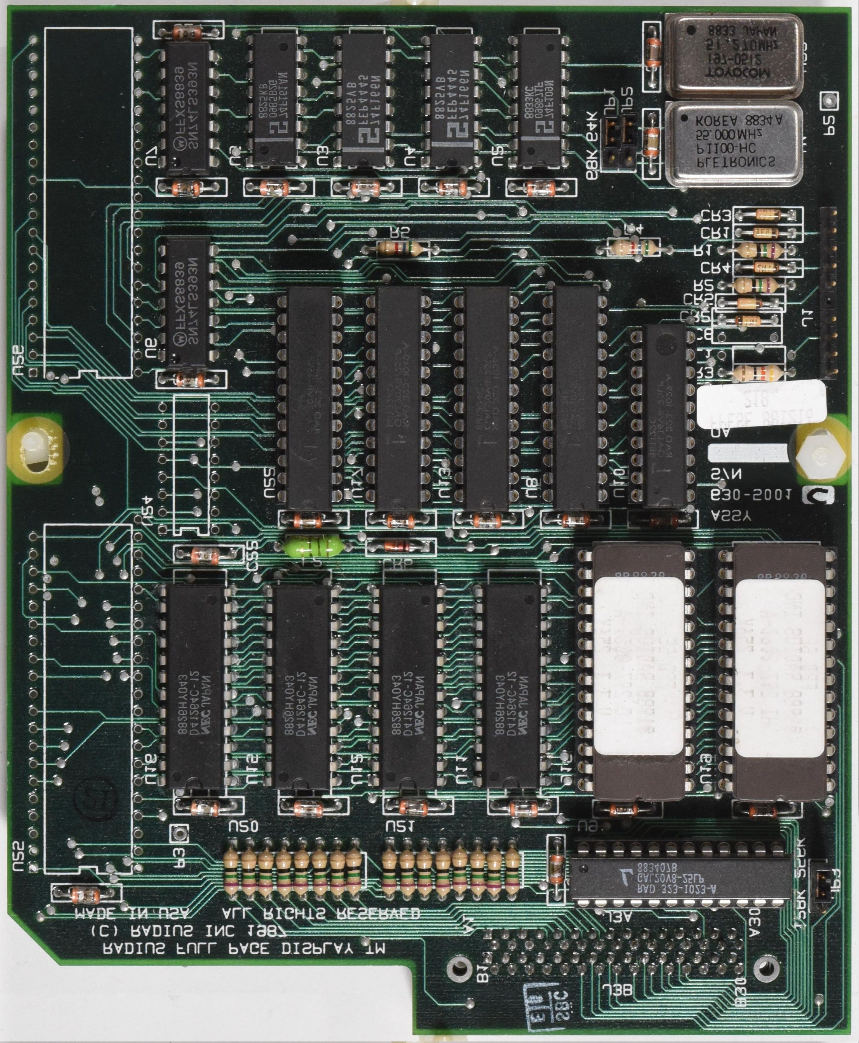

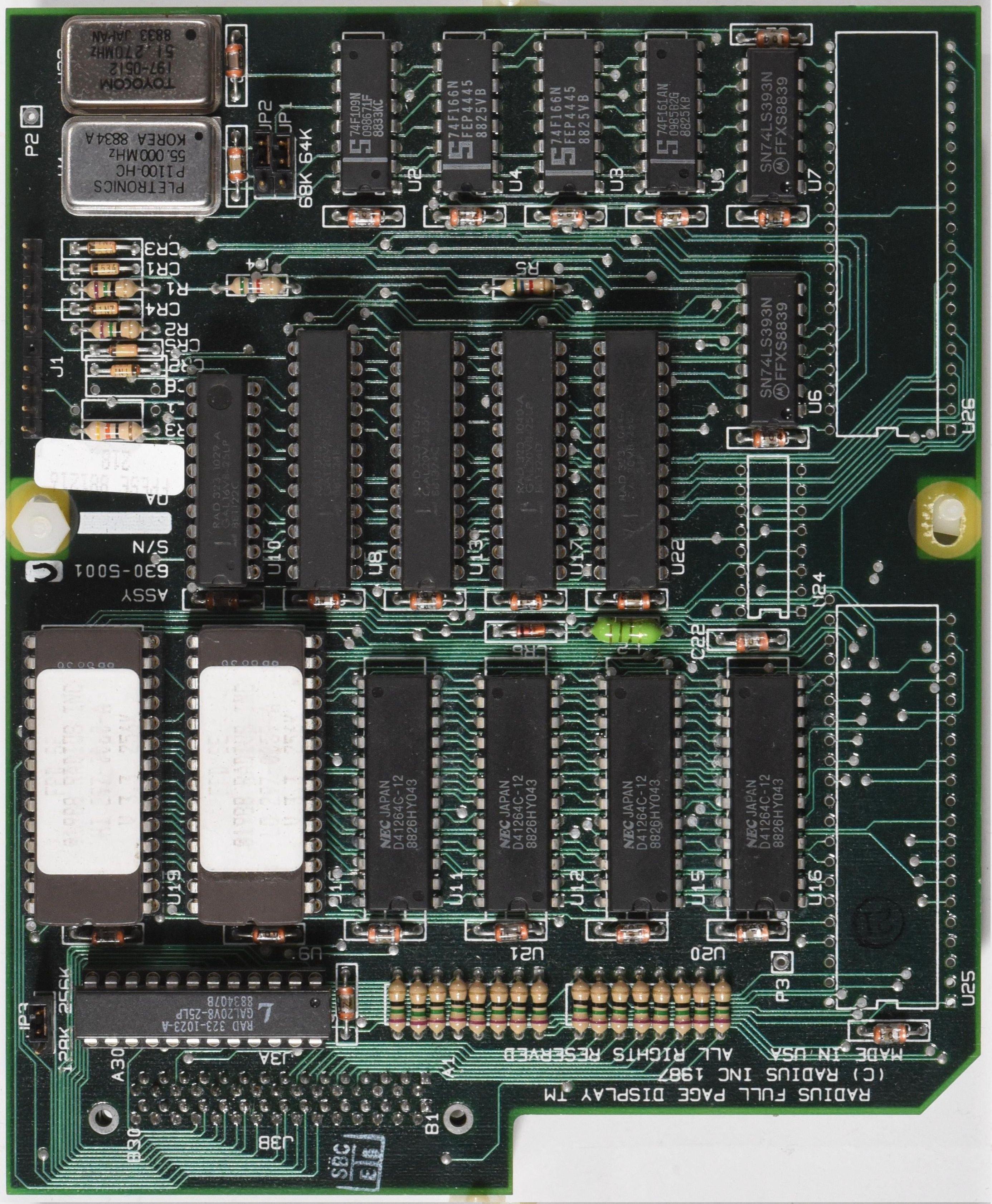

[Uploaded solder and component side pics Claude cleaned up for me]
That fits. A split with a cleared routing channel along the edge of the power plane was a common 4-layer trick, because it keeps the ground plane unbroken.
Two things to keep in mind for the meter test:
The needle only reaches surface copper. It can't get through the laminate to an inner plane. For the inner layer, test from somewhere that already connects to it:
  • a via inside the plane area (its thermal spokes, if you can see them under backlight, show it's tied to the plane)
  • a Vcc or GND pin: 14 and 7 on the 14-pin TTL, 16 and 8 on the 16-pin
  • your filed board edge, once you've done it
Trust only a dead short. A pin that connects straight to a plane reads about 0Ω. Between Vcc and GND, the TTL on the board can show a few tens of ohms, or a diode-drop reading in diode mode. That's leakage through the chips, not a connection. Check against both a known Vcc pin and a known GND pin, and go by whichever reads a clean short.
If it tests as the power plane: the faint bus is probably signal traces routed on the power layer itself, in the gap along the plane's edge. Signals on the power layer never appear on either outer surface. Any net that buzzes from via to via with no visible trace between them is a candidate for that bus.
For the clone: a board-house 4-layer stackup can match this directly, with GND solid and the power layer carrying the bus in a channel. Or you can move the bus to an outer layer if there's room. Either way works electrically at these speeds.

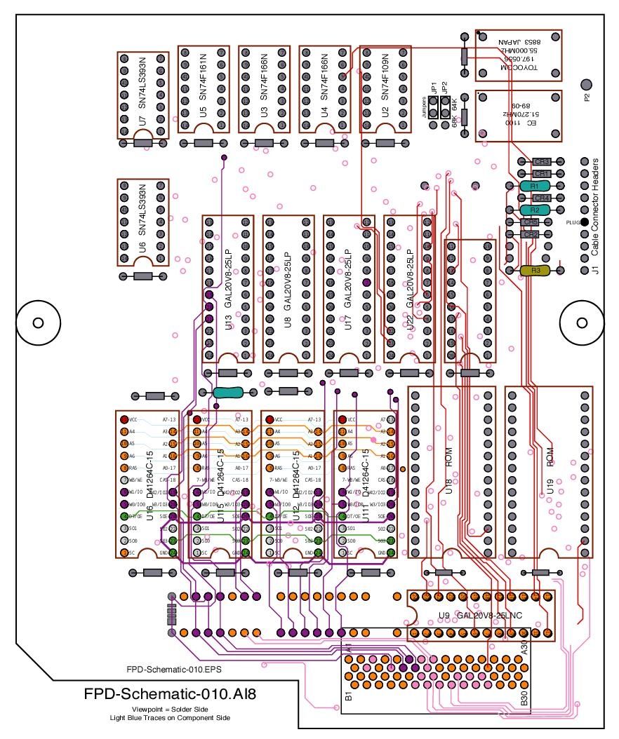

Thinking removing the extraneous bus for the alternate ROMs will be easy enough? That's just as we're removing the extraneous crystal can.
Yes, it should be about as easy as dropping the extra crystal. Both are option hardware for configurations you won't build. Check three things before you delete it, though.
1. Make sure the bus only serves the unused footprints. Alternate ROM footprints usually share the same address and data lines as U19 and Ux, so much of that bus may be the live ROM nets carrying on to the unused footprints. Those spare lengths can be cut, but the nets have to stay. Buzz each trace from end to end and sort it into one of two groups:
  • It only connects unused footprints: delete it.
  • It also reaches a live part: keep the net and trim off the part that runs to the unused footprints.
Watch the chip-select and output-enable lines in particular. If the alternate footprints have their own, they may come from a GAL output. Those GAL outputs will matter when you recover the fuse map.
2. Hardwire JP3, just as the crystal choice hardwires JP1. Removing the extra crystal fixes the frequency, and JP1 goes with it. With the alternate footprints gone, JP3 no longer needs to switch either. Wire the upper address line for 256K permanently, which is where it's set now and what the 27C256 dump expects.
3. Record it before you remove it. Capture the full bus as it exists in your schematic first, then delete it in a later revision. Your dev log keeps the original, and anyone following your work can see exactly what was removed and why.
Removing the bus also means the power plane no longer needs that routing channel along its edge, so it can be solid all the way across.

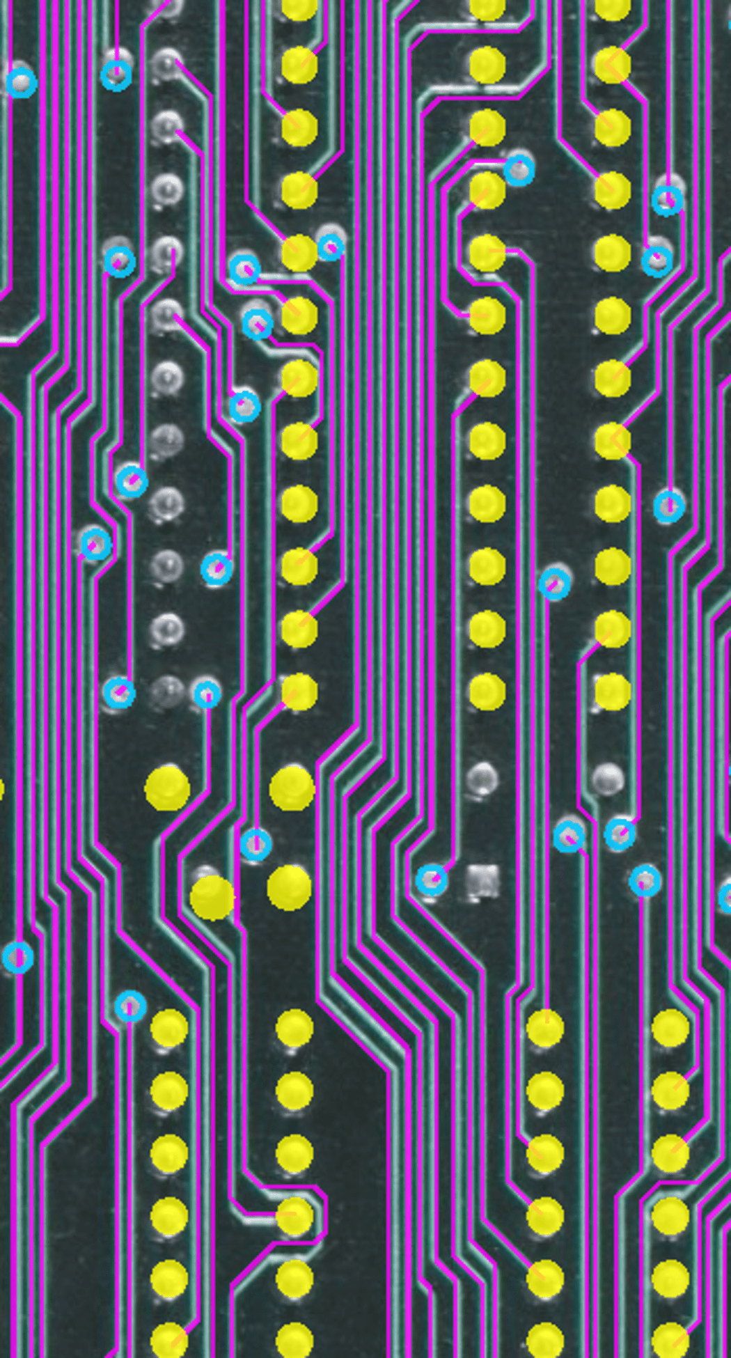

I mirrored your component-side photo and lined it up with the solder-side area from your first image. The faint traces aren't on an inner layer. They're component-side traces showing through the board.
What the comparison shows:
  • The component side has about eight parallel traces running diagonally down and away from the bottom pins of the empty U26 footprint.
  • A second group runs along the board edge and bends around the corner of the mounting pad.
  • The faint traces on the solder side have the same two groups, with the same angles and the same bend around the pad. The small offset between them comes from camera perspective, not a different route.
I should have checked this before agreeing with you. I'm sorry.
What it changes:
  • Inner layer: a solid plane can't sit under that spot, or it would hide those traces. Either the plane is cut back around the U26/U25 area, or that part of the board has nothing between the two sides.
  • Layer count: this doesn't prove the board is 2-layer. In a front-lit photo, a dark patch can mean solid copper behind it, or simply no copper behind it. If your "absolutely opaque" result came from backlighting, it still points to an inner plane somewhere, just not in this spot. Filing the edge will settle it.
  • Your removal plan: this is good news. The extra bus runs from U26, the empty alternate-ROM footprint, and it's on the component side. You can photograph and buzz it without guessing about hidden layers, and deleting it in the clone is easy.
No chance there, the component side traces are clearly “raised copper” above the substrate and the ghost bus is on one of the inner layers. I’ve etched traces on blank copper clad and I know what it looks like.
No, they're through vias. In the overlay, both vias appear on the solder side and on the component side, in the same spot. A blind via runs from one outer layer to an inner layer, so it would only show on one side. A buried via connects inner layers only and wouldn't show on either side.
It also fits the board's age. Blind vias need extra lamination steps. In 1987–88 that was costly and mostly limited to military or high-end work, which a consumer display card wouldn't have needed.
A through via still connects to the inner layer here. It connects on every layer where copper touches its barrel. From the photos, these two have a trace only on the solder side; their component-side pads look bare. So each via links a solder-side surface trace to the inner-layer bus. The unused component-side pad is just part of how a through via is made.
For your meter checks, the component-side pads are also bare copper connected to the same net. You can probe from either side.
Thanks for checking the card itself. We're square: you caught me on the inner layer tonight.
What's settled now:
  • The board has at least 4 layers.
  • The faint bus is an inner-layer net. It runs from the U26 area through ordinary through vias.
  • Those vias are your starting points for the meter: buzz from them to find where the bus surfaces at the other end.
  • The plan to remove the alternate-ROM bus and the extra crystal is unchanged.

Still waiting for parts, so took a look at the BigROM Bus removal campaign.
1) can you identify what ROM packages fits and find a pinout link for me to run down?
2) figured I’d check traces that may or may not be necessary to keep.
1) Which ROM fits the footprint
I measured U25 and U26 in your component-side photo. Both are 40-pin DIP footprints with 0.6" row spacing, 20 pins per side on a 0.1" pitch. Pin 1 is the square pad at the notched end of each outline.
That fits the 16-bit-wide JEDEC EPROM family in a 40-pin package:
  • 27C1024 (64K × 16)
  • 27C2048 and 27C4096, which use the same 40-pin layout with more address lines
This also makes sense for the board. The SE's PDS bus is 16 bits wide, and one x16 part covers what the Hi/Lo pair (U19 + Ux) does with two 8-bit 27C256s. Two footprints would mean more capacity or alternate ROM options. That's my inference from the package, not something the board confirms.
To confirm it with your meter, check the power pins against the datasheet. Pin 40 should go to +5V, and the ground pins should buzz to GND. If they match, it's the x16 EPROM footprint.
Datasheet links for the pinout:
2) Which red traces can go
At this resolution I can't reliably call each red trace from the drawing. Sort them yourself with this rule. For each U25 or U26 pad that has a red trace, count how many populated parts that net reaches: U19, Ux, the GALs, the VRAMs, or J3.
  • 0 populated parts: delete the whole trace.
  • 1 populated part: it's a stub. Delete the red run; the live pin keeps its other connections.
  • 2 or more populated parts: the empty pad is working as a junction. Keep the net and route it directly between the live parts.
Two things I'd look at first:
  • The long red runs under Ux and U19 toward the right edge. My guess is they head for J3 as data or address lines, which the live ROMs share. That means trimming the stub and keeping the net, not deleting the whole line.
  • Every via on a red trace. A via can carry the net down to the inner layer, where it may connect to something live that you can't see.
If you mark each U25 or U26 pin with its buzz result using your Firm / Ratsnest / WTF? codes, I can go through the list and sort every trace into delete, trim, or reroute.
That was my line of thought, figuring that any buried traces heading inboard can be rerouted to the top layer on that broad highway.
- Any trace routed only between the BigROM thruholes creating a ROM pair bus can be tossed immediately?
- I’m guessing that the long traces between ROM area and BigROM bus may or may not be required?
1) Traces only between U25 and U26 pins: yes, toss them. Two x16 ROM footprints sharing address and data lines is exactly what you'd expect. Check one thing first: that no pin on that pair-bus also has a via or a trace leaving the pair. If every pad on the net belongs to U25 or U26, it's dead copper.
2) The long runs between the ROM area and the BigROM: it depends on how each net is chained. For each long trace, find where the U19/Ux pin gets that signal from.
  • The ROM pin has its own route back to the source (J3 or a GAL): the long run only feeds the BigROM. Toss it.
  • The ROM pin's only connection is that long run: the signal goes source → BigROM pad → long trace → ROM pin. The empty footprint is acting as a pass-through, so the trace is required. Route it straight from the source to the ROM pin on your top-layer highway.
The meter won't separate these cases, because both show continuity. Count the copper at the ROM pin instead: one trace leaving it means pass-through, two or more means the BigROM leg is only a branch. Also check each via for a branch running through the inner layer.
Chip-select and output-enable lines: if a GAL output drives only the BigROM's chip-select or output-enable, you can drop that trace too. The unused GAL output just floats, and the fuse map doesn't change.
Your plan to move the inner-layer traces up to the highway works. It also leaves the inner layer free to be a solid plane.
Thanks for the datasheet links, they come up empty, but now I’ve got part numbers to search. Figuring pinout overlay will help a lot.
Sorry the links came up empty. A few search terms that should turn up the 40-pin x16 datasheets:
  • Am27C1024 (AMD)
  • M27C1024 (ST)
  • Intel 27C210, Intel's 64K × 16 part from the same period
The 27C2048 and 27C4096 datasheets use the same 40-pin layout. Either will do for your overlay.
When you place the overlay, find pin 1 at the square pad on the notched end of each footprint. Your drawing is rotated 180° from the photo, so pin 1 on U25 and U26 will land at the opposite corner from where it sits on the board.
Once you have a pinout diagram, send me a screenshot. I'll format it the way you like for pasting into Illustrator: left and right columns, pin number plus two spaces plus signal name, double-spaced.
Sounds great! The full board pics above are those you cleaned up for me. At that point the card was right side up and the ICs were upside down. Those pics were highest resolution and the easiest to locate.
Artwork is now IC notch upward, card upside down orientation. Here’s a better pic of the new traces. Data lines coded purple run through the resistor array and up the solder side to VRAM/Vias.
It looks like they branch from there to socketed ROM and U25. Expecting 14 more connections to appear across the South 40. WAG would be that the data bus runs (mostly on internal layer bus) to U26 in the North 40. Pinout overlay will tell.
This new orientation reads well. The numbers so far support your guess.
Sixteen data lines, everywhere:
  • Resistors: there are two banks of 8, which makes 16. That fits series resistors on D0–D15 of the SE's 16-bit data bus, sitting between J3 and the rest of the board.
  • VRAM: the D41264 is 64K × 4, so four chips give 16 I/O lines.
  • Socketed ROMs: 8 data lines each. One of U19/Ux carries the high byte and the other the low byte, which makes 16.
  • U25: a x16 EPROM would take all 16 data lines itself.
So your 2 found plus the 14 you expect gives exactly the full bus. If the pattern holds, every one of the 16 will reach the VRAM I/O, one ROM socket, and U25.
A quick test once the pinout overlay is in: if U25 is a 27C1024-family part, its 16 data pins should sit in two blocks of eight, split by a ground pin. That's roughly pins 3–10 and 12–19, but confirm against the datasheet. If your purple buzz hits land on those two blocks, you've identified the part. If U26 is a second x16 ROM, the same 16 lines will show up on the same pins there. Your guess that they travel north on the inner-layer bus would fit.
For the removal plan: the BigROM taps the data bus after the resistors. Cutting the U25/U26 branches leaves the resistor → VRAM and resistor → ROM paths untouched, provided each ROM pin still has its own route back to the resistors. It's the same pass-through check as before: if the only route to a ROM data pin runs through a U25 pad, that leg has to be rerouted.
Send the pinout diagram when you find it, and I'll format it for your overlay.
Here it is.
I've formatted the 27C1024 pinout for your overlay in 27C1024-Pinout-U25-U26.txt. It's split into left and right columns in physical DIP order (1–20 down the left, 40–21 down the right). Each entry is the pin number, two spaces, then the signal name, double-spaced. Active-low signals keep the datasheet's # suffix (CE#, OE#, PGM#), so no overline character has to survive the paste.
Once it's placed, check these on U25 and U26:
  • Data bus: your purple buzz hits should land on pins 3–10 (DQ15–DQ8) and 12–19 (DQ7–DQ0), with ground on pin 11 in between. If they do, the footprints are confirmed as x16 ROMs.
  • Power pins: pins 11 and 30 should buzz to GND, and pin 40 to +5V.
  • Pin 1 (VPP): in read mode this is usually tied to +5V or straight to VCC. That's another quick power check.
  • CE# (pin 2) and OE# (pin 20): trace these back to find which GAL outputs drive the BigROM. Those traces can go in the clone.
  • A0–A15: these probably share address lines with the socketed ROMs. Apply the pass-through check to each one before you cut anything.
Thanks, back to AI playtime!
Have fun, jt. Send the overlay over when the buzz hits are on it.

MagicBus Card arrived in good order, do these pics help?
Yes, they help a lot, jt. The photos settle what the board is and roughly what the connector footprint looks like. They aren't enough for the actual pin-to-pin map.
Name correction first. The silkscreen that reads "J38" is actually J3B, the middle row of J3. J3 is the 96-pin DIN connector (rows J3A, J3B and J3C, pins 1–32). The staggered double-row footprint is J2, the black JAE 60-pin connector (rows J2A and J2B, pins 1–30). I'll use J2 and J3 in the schematic so it matches the real board.
What the photos show:
  • Two-layer board, simple wiring. On the dark side, each DIN pin runs up to a pad in that staircase pattern. On the green side, a trace runs from that pad straight across to the J2 footprint. There's no logic on the board, only wiring, plus a few power runs along the lower right and one strap-like link near J2. So your adapter really is a MagicBus clone with different connectors.
  • J2 pitch, measured from the photo. The DIN connector's standard 2.54 mm pitch gives me a scale for the photo. On that scale, J2's contacts are about 1.27 mm (0.050") apart along each row. The legs fan out into four offset columns of holes, about 6 mm wide overall and about 38 mm long. That fan-out is why the spacing didn't match any perfboard grid. Treat these as a sanity check only: take the final numbers from calipers.
  • The dark-side photo is mirrored. The silkscreen reads backwards, so it looks like your usual reversed reference view. I'll keep that in mind for any pin I read from it.
Why I won't pull the netlist from the photos. Matching 60 pads in the staircase back to the right column out of 32 DIN positions, at this resolution, is too error-prone. Buzzing it takes about 60 quick meter checks on a board this simple. It can also catch power pins that connect to more than one place, which the photos can't show.
Check the connector gender. The MagicBus's DIN connector looks like the female receptacle, which would mean the SE logic board has the male pins. If so, the DIN96M right-angle part you pulled from the drawer won't plug into the SE's PDS slot. It might still suit the FPGA board plan. Worth confirming against the logic board before layout.
Next step: buzz each J2 pin (1A–30A, 1B–30B) to its J3 pin (row letter plus number), and mark any J2 pin that connects to more than one J3 pin, since those are likely power or ground. Add the 68kMLA pinout and caliper measurements when you have them. I'll then build the KiCad schematic, the netlist table and the J2 footprint, and flag anywhere your buzz results and the forum pinout disagree.
I can also make you a blank buzz sheet with J2 on the left and blanks for the J3 pin and notes, in your double-spaced paste format or as a spreadsheet.

Ordered a new multimeter that should tell me the difference between full continuity and weaker states.
Meanwhile, I cleaned up the sticker residue on the solder side with alcohol and discovered that a liquid emulsion gives better definition to the subterranean net. Can you crop, clean up and scale this shot to match the other images I’m using as templates for me?
The new photo didn't make it into the chat, so there's nothing here for me to work on yet. Can you attach two things?
  1. The new solder-side shot with the alcohol and emulsion cleanup.
  2. One of your current template JPEGs, ideally the solder-side one. That lets me match its pixel size, crop, orientation and grayscale format exactly.
If you'd rather skip the template, I can work from the specs we used before: crop to the board outline, 123 mm board width, the 50% true-size scale for the AI9 artwork, and 8-bit grayscale JPEG. Matching an actual template file is safer, though.
The meter sounds like a good buy. An ohms reading will tell you a lot more than a beep, especially on those faint nets under the ICs.

No worries about the early send. The new solder-side shot is cleaned up and lined up with your templates, in two sizes:
  • Radius-FPD-SE-Solder-Clean-1386.jpg is 1386 × 1697 px at 141 dpi, the same as your current solder-side template, so you can swap it straight in.
  • Radius-FPD-SE-Solder-Clean-2772.jpg is 2772 × 3394 px, the same pixel density as your component-side template. Your two templates aren't the same size (the component side is 2772 × 3365), so this one is there in case you want both sides at the same scale.
What I did:
  • Rotation and crop: turned it 90° so it faces the same way as the old solder-side shot, with the connector at bottom right and the angled corner at bottom left. The white background is cropped away.
  • Alignment: I didn't just resize it. I matched it point for point to the old template, using about 1,700 matching points on pads and vias. A 50/50 overlay of the two shows no ghosting on the connector pins, pads or traces, so it lines up with your existing artwork without nudging. It also keeps the old template's slight camera stretch, so the two stay consistent with each other.
  • Clean-up: color and brightness matched to the old template, plus light sharpening to bring out the trace edges the emulsion revealed.
Your yellow U-number tape labels are still in the shot. If you want them gone, I can paint them out in the gaps between traces, but I wouldn't paint over anything that might be a trace.
Not worried about the stickers, This is for a new buzz file for only the buried net. Thanks!
Sounds good. Keeping the labels means you can see which GAL you're over while you trace, which should help on the buried net.
Good luck with the new buzz file. Send it over once the first pass is done and I'll check it against the component-side and solder-side files for anything that doesn't match.

Done on the bench and the board
• Test stand: the SE logic board is on a plexi carrier on my open SE/30 test stand, with a BlueSCSI on a slide-in
carrier on the PSU. SE + MagicBus + FPD boots to the flashing question-mark floppy. A right-angle DIN 96
wire-wrap connector seats in the PDS slot.
• Board construction: it looks to be a 4-layer board with a solid inner plane. Much of the buried inner-layer net
is now mapped, and it serves the empty U25/U26 "BigROM" footprints.
• Artwork: pinouts for 20 ICs are on the board registration, with confidence-coded trace layers and draft block
and functional diagrams from 261029.
• Data bus map, drawn from the artwork: U16 = D0-D3, U15 = D4-D7, U12 = D8-D11, U11 = D12-D15.
ROMs: Ux = D0-D7, U19 = D8-D15.
• Syncs, buzz-confirmed 261031: J1 pin 9 V-sync traces through R1 to U8 pin 17, and J1 pin 7 H-sync through
R2 to U8 pin 18. Syncs come from U8, not U22 as first drawn.
• Clocks: Y1 51.270 MHz (64 Hz) and Y2 55.000 MHz (68 Hz), selected by JP1 as the pixel clock. Inferred
timing is 800 x 1000 totals, or 68.75 kHz / 68.75 Hz at 55 MHz. Not yet measured.
• MagicBus pinout: all 60 lines check against Apple's Table 13-1: 50 signals plus 10 power and ground. The
FPD never sees FC0-2, /VPA, /VMA, /BR, /BG, /BGACK, /PMCYC, /HALT, /IPL0, /IPL2 or /BERR.
